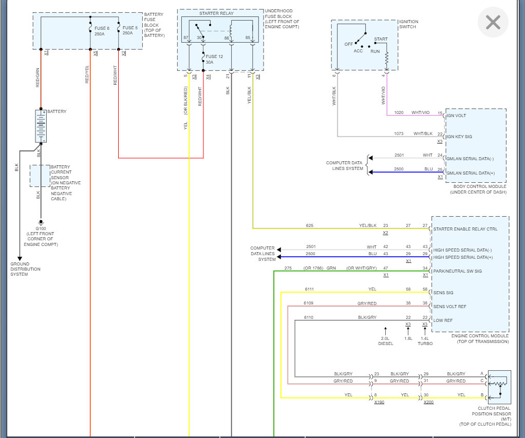

The car listed above is an eco tec. It will not start. There are lights on dashboard, but the starter is not cranking. I noticed also car central lock with key not working.
Jun 13, 2022 at 12:17 PM

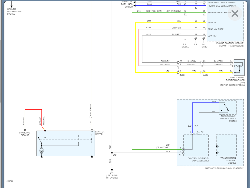

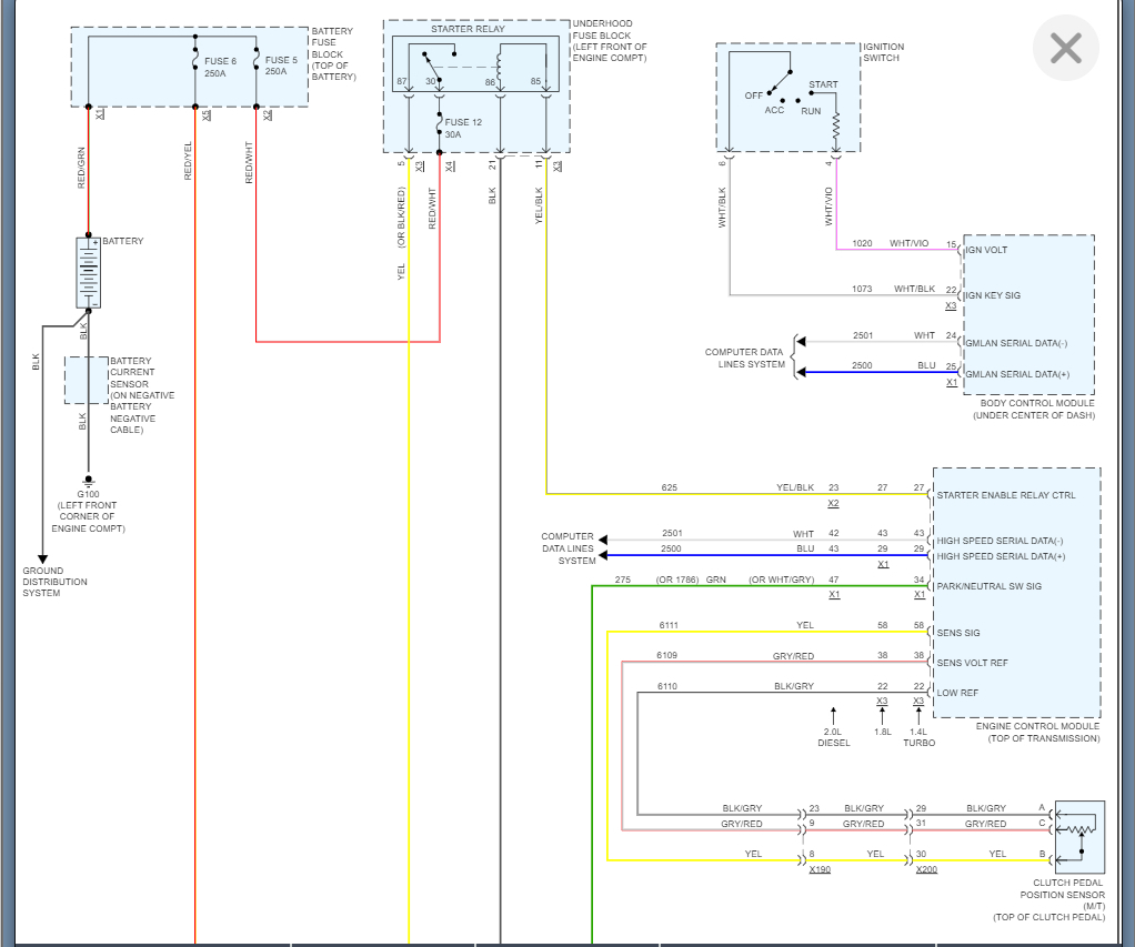

I doubt the key lock issue is related to the starter issue so let's start with the starter issue and then if that fixes the lock issue then that is great.
Let's check the voltage at the starter. You should have 12 volts on both wires when cranking the engine.
If you only have 12 volts on the B+ wire and not the yellow trigger wire, then we need to go to the relay and jump it and see if the starter turns over.
However, if you have 12 volts on both wires then the issue is in the starter, and we will need to replace it.
Let me know what you find with this, and we can go from there.

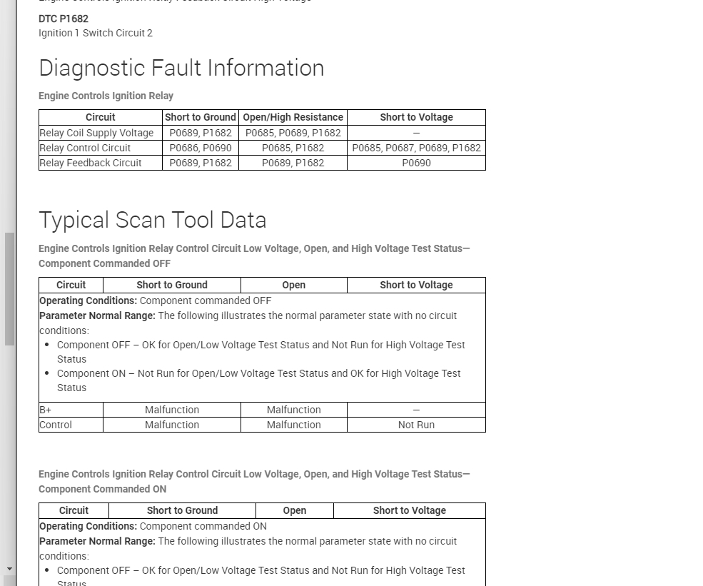

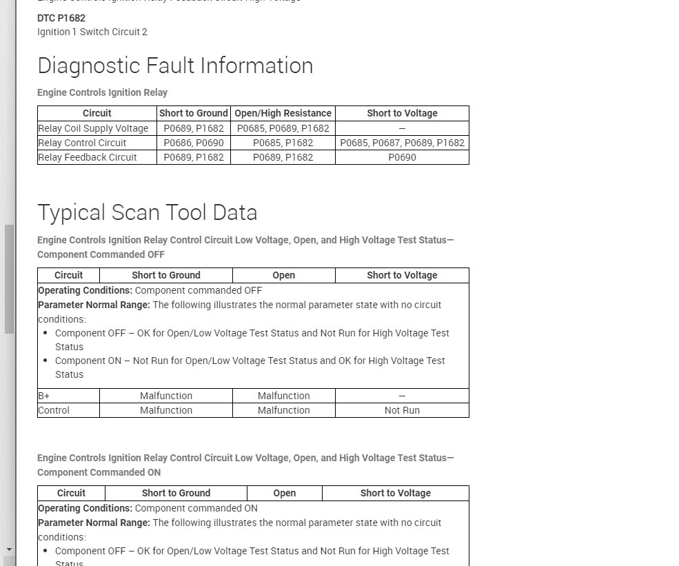

Put the scanner got 2 codes, P0300 random/multiple cylinder misfire and code P1682 driver 5 line 2..when the key is turn on ignition all the display on the dash comes on, but once you turn to start position, on the dashboard all display goes out, total black out...check the fuses in the engine bay found #5 fuse to have blown replaced it but nil fix, other fuses was okay.
Jun 14, 2022 at 4:36 AM

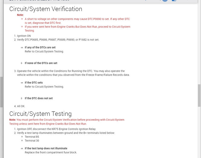

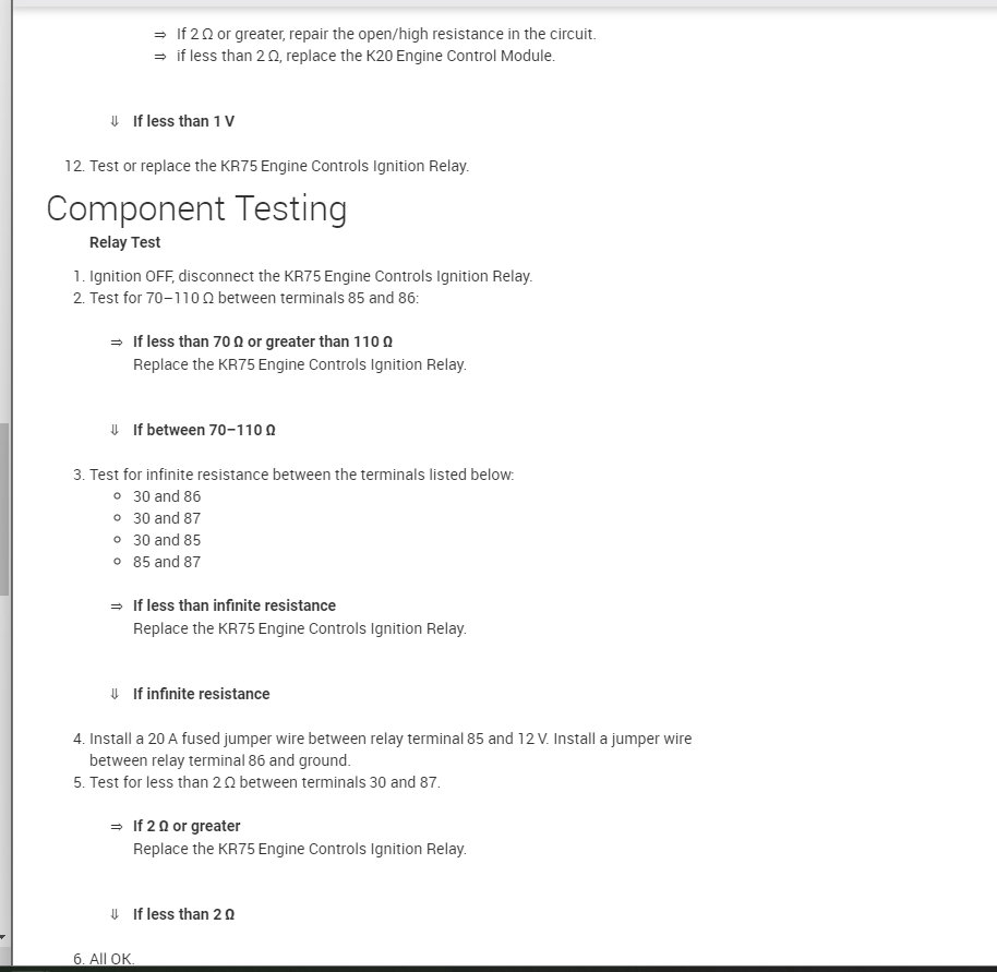

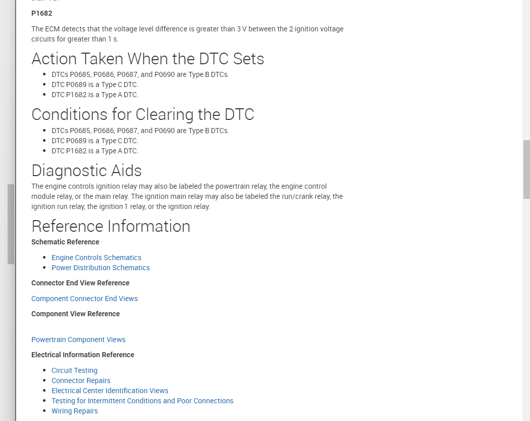

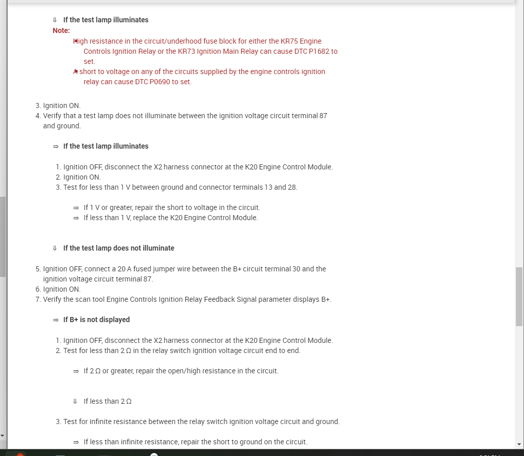

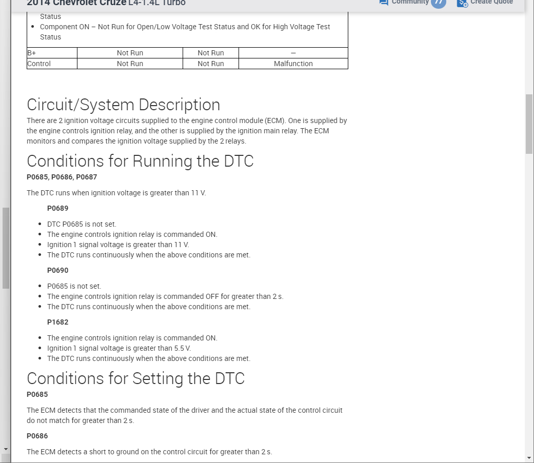

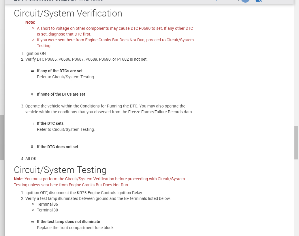

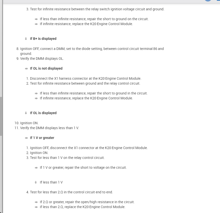

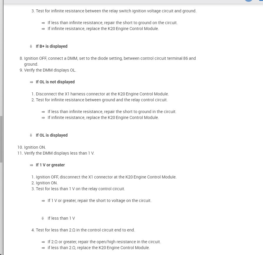

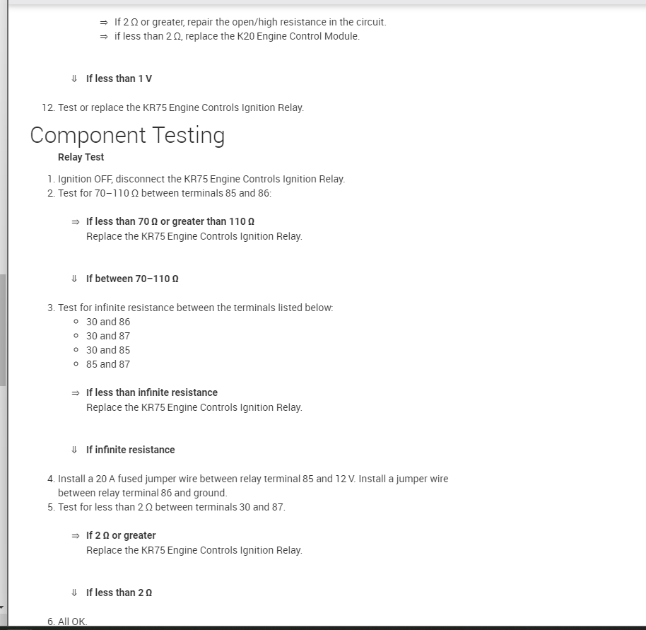

Okay. The P1682 is going to be the issue that we need to figure out.
I am attaching the testing that we are going to have to run through to figure out what is going on.
Please run through this and let me know what questions you have on this, and we can go from there.
Thanks

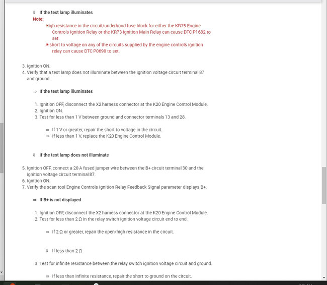

Your meter would need an amp setting in order to measure the amperage. However, measuring the amperage does not tell you if the battery is properly charged. All you are doing is measuring the number of amps the component like the starter is drawing. So, you are measuring the amount of current that is leaving the battery to power the component and not measuring the available current within the battery.
This is why we can check and see if the battery can send the proper amount of current but that still does not tell us what the total capability of the battery is. Only a battery load test will tell us this.
So, if this engine will not even crank, we need to go back to my previous post and focus on the relay code that you have and not the battery at this point.
The battery may be faulty, but it sounds like the starter is not even being commanded on, so you need to run through the diagnostic testing for that code.
