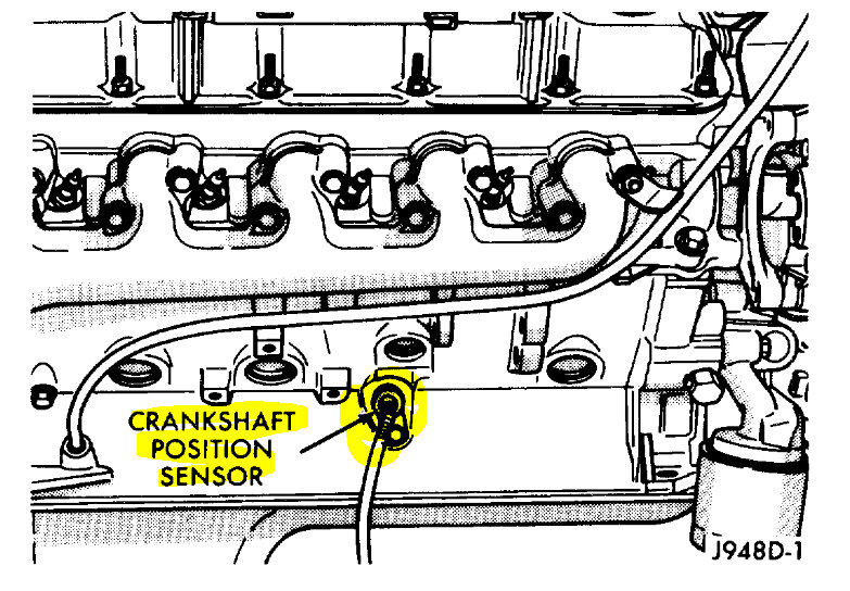

I have a feeling it is related to the crankshaft position sensor. It is located on the right side of the engine (the side you worked on). I attached a pic below of its location. Check the connector and wiring to make sure nothing was disconnected. Also, confirm the wires from it aren't damaged or pinched.
Next, if you have a live data scan tool, connect it and check if there is an RPM signal when cranking the engine. If you don't have one, pay close attention to the tachometer when cranking. You should see it move when cranking. If it doesn't, that reinforces the idea that the sensor is the issue.
Chances are the sensor is fine, but I think it is a wiring or connector issue. There isn't a lot of room to work and it's easy to damage something other when you do work on them. LOL
One other thought, I believe there is a ground at the front right of the engine block. It will be black in color. Make sure it is not damaged as well.
