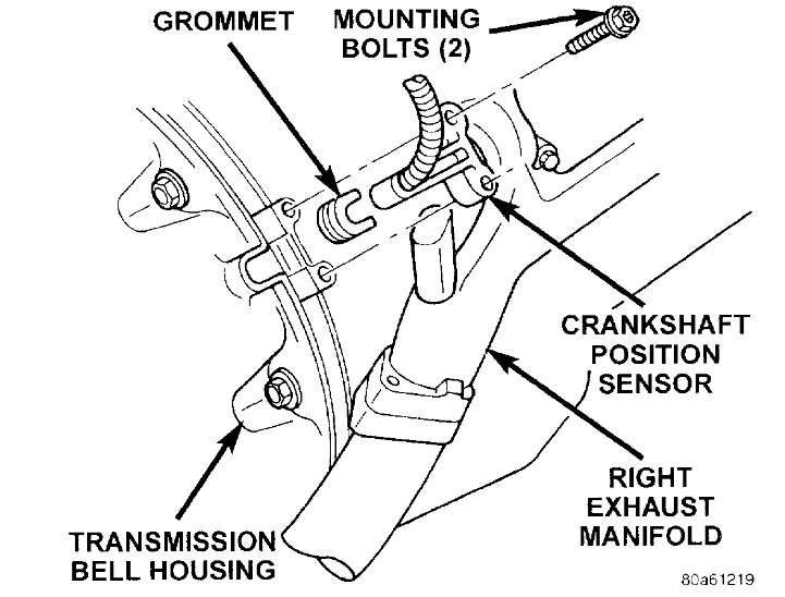

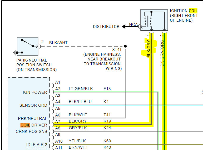

cranks won't start have no power to coil, no spark, swapped around ASD relay, checked fuses, computer working, also don't hear fuel pump engaging was starting fine before i replaced transmission, i have 12 volts to the green orange to the wire harness, until it splits to fuel injectors and coil.

Before we get wrapped around the axle, I have a suspicion you're finding the wrong conclusion based on when you're taking some voltage readings. Go back to the ignition coil or any injector on the dark green / orange wire. That comes from the ASD relay. Use a test light if possible as most digital voltmeters don't respond fast enough. You should see 12 volts there for only one or two seconds when you turn the ignition switch to "run", then it will go to 0 volts. What's important is that 12 volts must come back during engine rotation, (cranking or running).
If the 12 volts doesn't come back during cranking, the logical suspect is the crankshaft position sensor. It has to be removed to replace the transmission. Besides the possible physical damage, the air gap is critical. On older models, that was set with a thick paper spacer on the end of the sensor. On yours, it is fixed by the design of the mounting bracket, so no adjustment is possible. That doesn't mean it can't get bent by the ring on the torque converter.
The sure-fire way to know if the culprit is the crankshaft position sensor or the camshaft position sensor is to use a scanner to view live data. On Chrysler's DRB3, both sensors are listed with a "No" or "Present" to show when their signals are showing up. You're looking for the one that stays on "No". When either signal is missing, the ASD relay won't get turned on. That turns off the 12 volts to the ignition coil(s), injectors, oxygen sensor heaters, alternator field, and the fuel pump or pump relay. Aftermarket scanners have a similar way to show if the signals are there.

The ASD is good and working, fuel relay is good, all fuses are good. replaced transmission and this is the aftermath no start or spark maybe leaning to crank sensor but was not damaged and last month before taking transmission out had no problems with starting.

If you have a live data scan tool, see if there is an RPM signal when cranking the engine. If there isn't, then the CKP may have an issue. Considering it is mounted right at the bell housing of the transmission, there is a chance the wiring was damaged, or it was disconnected. See pic 1 below.
Also, power to the coil runs from the powertrain control module via a black wire with a gray tracer. Is that where you are checking for power? Did you check while the engine was cranking? See pic 2

no RPMs while cranking and i see no voltage to the black and grey while cranking kind of tells me it's the crankshaft position sensor is where to begin.

replaced crankcase position sensor and fired right up. thank you for your help. have a wonderful day.

Yep, no RPM signal usually indicates a problem with the CKP. I'm glad you got it taken care of and it's running.
