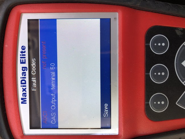

Friend of mine's car, wouldn't start but everything lights up on dash. i wasn't where the car was he scanned it and i saw a starter operation code present. it's almost always a starter code. I changed many of them. changed the starter still not turning over but there is a click from the starter when i tried to start it. It has a push button start. The starter operation code is not there anymore no other codes. But once when i tried to start it it gave this code. I also had a jumper on the battery in case it was weak but it isn't.

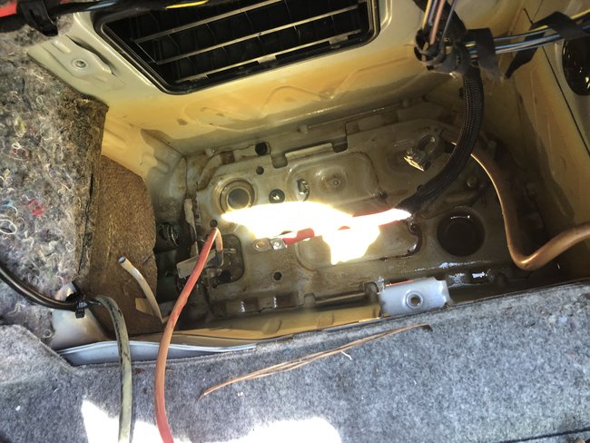

After further testing and digging found water on bottom around the battery, removed it and this what i found. If the large positive cable was barely connected around the corrosion or not connected at all how it is that i was getting a click at the starter? If the positive cable from the corrosion touched the body wouldn't that cause a fuse blow also?

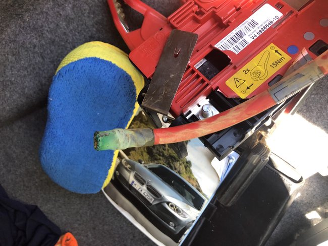

This too:

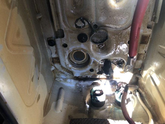

This is the cable:

Wow, good find.
Yes, that could definitely cause the issue.
Get that repaired and give it a try.

I found the parts online, but is there a way to find out what is behind the connectors? like from the other end? they are rusted bad and I am going to try to remove the nuts which I suspect will break.
Apr 16, 2020 at 11:51 AM
You have to release those nuts to get to the unit.
Try using a product called Freeze Off. It works great for dissolving rust. It is the best I have ever seen.
