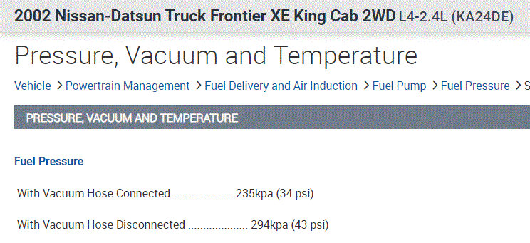

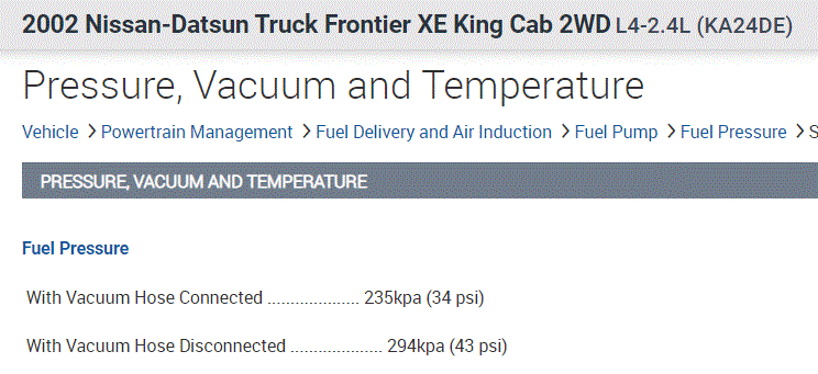

If that is good, then confirm fuel pressure is within spec. Here is a link that shows in general how to test fuel pressure:
If you look at the pic below, I attached the manufacturer's fuel pressure specifications.
See pic below.

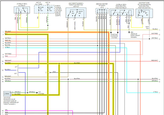

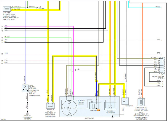

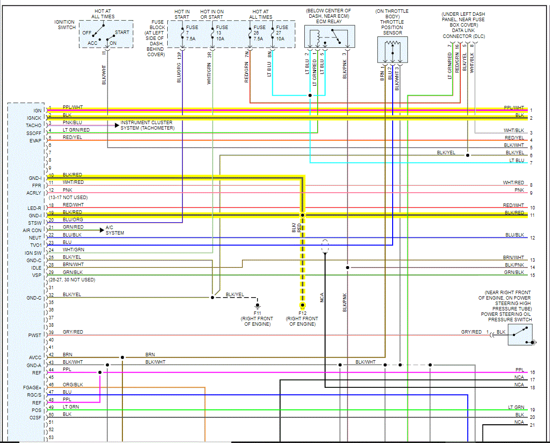

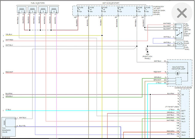

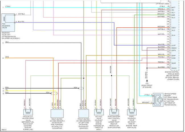

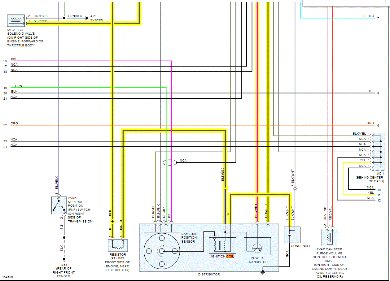

  • 110,240 POSTS
We may have a faulty ignition coil. Do me a favor, take a look below at the wiring schematics. I attached the entire schematic for the powertrain management. I highlighted wires I need to be checked. There is a purple wire with a white tracer which should have power. It powers the power transistor and the coil. See if there is voltage there. Let me know what you find.
If we have good voltage, then there is a chance the distributor needs to be replaced. It isn't serviceable other than the cap.
Afterthought... Make sure the rotor is in good condition and not corroded.
