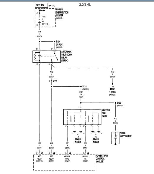

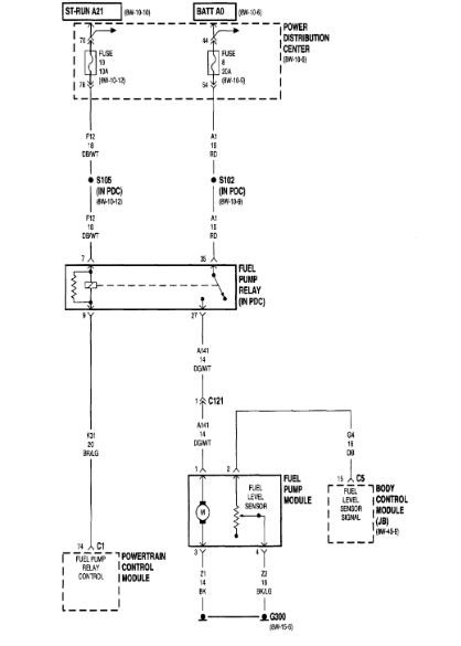

My car just stopped running when I was driving down the road. It will not start. There's no spark when we try to start it. I've put a new coil pack as well as new spark plugs in, and there's still no spark. There's no noise coming from my fuel pump either. I just don't know what to do.
Jan 15, 2019 at 6:36 AM
Good afternoon,
I would start by checking all the fuses for power on both sides with the key on.
I listed two diagrams for to view and the fuss to check.

We already did that. They all appear to be fine.
Jan 15, 2019 at 6:59 AM
No, you need to check for power on both sides of the fuse with either a voltmeter or test light.
