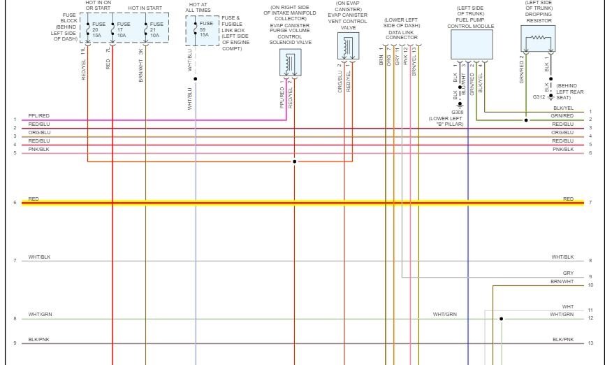

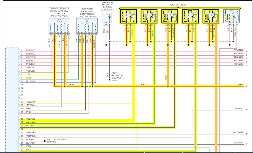

Good afternoon,
Do you mean the injector pulse is not a pulse signal but a constant signal?
Can you verify voltage to the ignition coil connector to verify battery voltage with the key on?

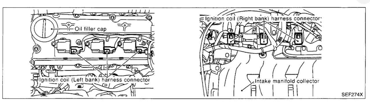

I attached a wiring diagram for you to view the coils.
Keep me updated with the results.

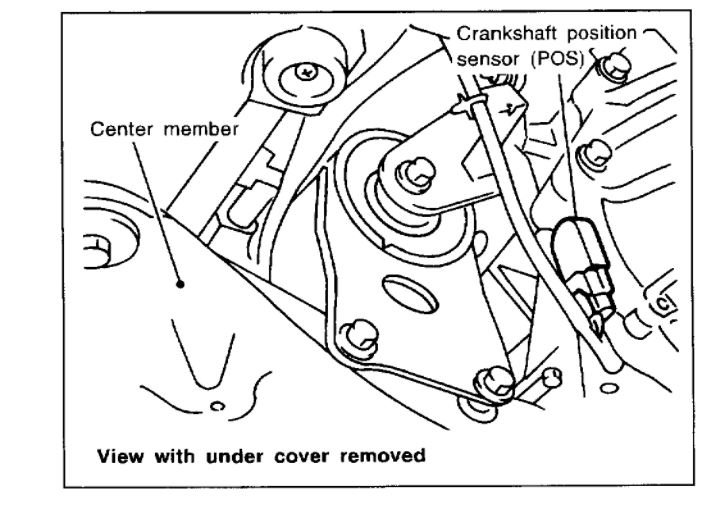

Yes! Thank you once again. I have succeeded to get another two ECMs but unfortunately it was doing the same thing of no spark on plug. Now i think of replacing the crankshaft position and reference sensor, if that didn't solve it, i will go back to recheck the timing,
Nov 16, 2021 at 9:59 AM

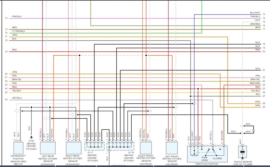

If it were timing, it would show low compression. Even if it were timing, you would still have sparked all the time.
I attached the location of the sensor for you.
Nov 16, 2021 at 10:15 PM

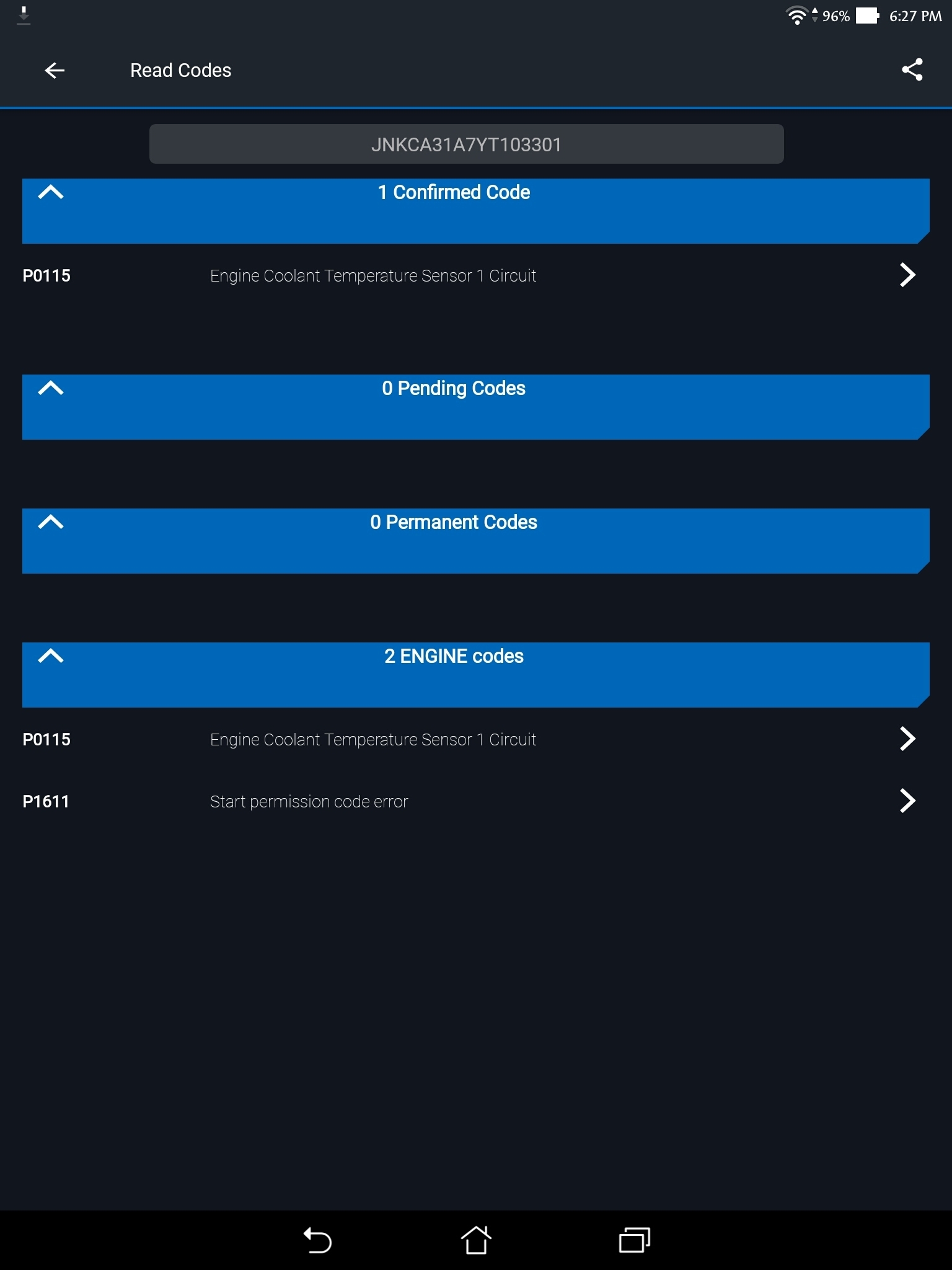

I am back to update you on how far I had gone with the vehicle. I brought 3-ECM and programmed it, and it was still doing the same. Then I put back the ECM of the vehicle and programmed it back. Then I scanned it and it was giving out these codes P0115-Engine coolant sensor and P1611-Start permission code error. So, what will I do to solve the situation?
Jan 28, 2022 at 1:28 AM
  • 110,241 POSTS

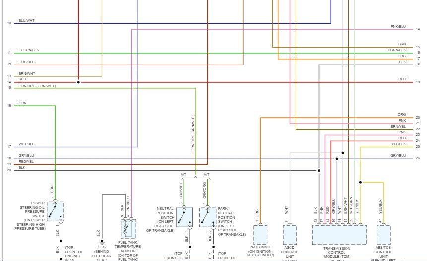

The issue is likely because the new ECM hasn't been fully initialized with the security system. Only IVIS (NATS) ignition keys with ID numbers that have been registered into the ECM and the IMMU allow the engine to run.
The idea that you replaced the ECM indicates it needed to be initialized. Have you performed initialization with CONSULT-II or equal and re-register all IVIS (NATS) ignition key IDs? That is what the P1611 indicates and is preventing the vehicle from starting, but I don't know if you have the tooling.
Let's see what Roy indicates as well, but I believe there is no way to relearn the key codes without dealer tools.

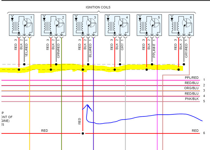

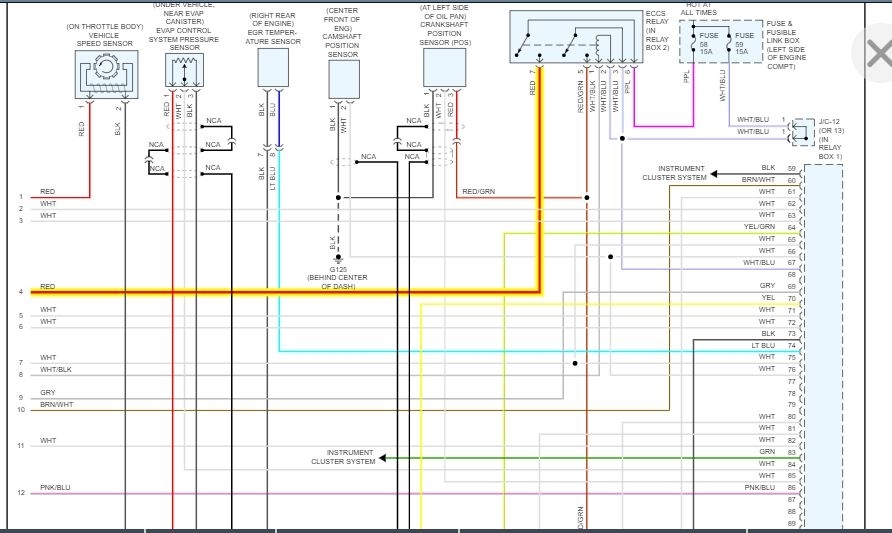

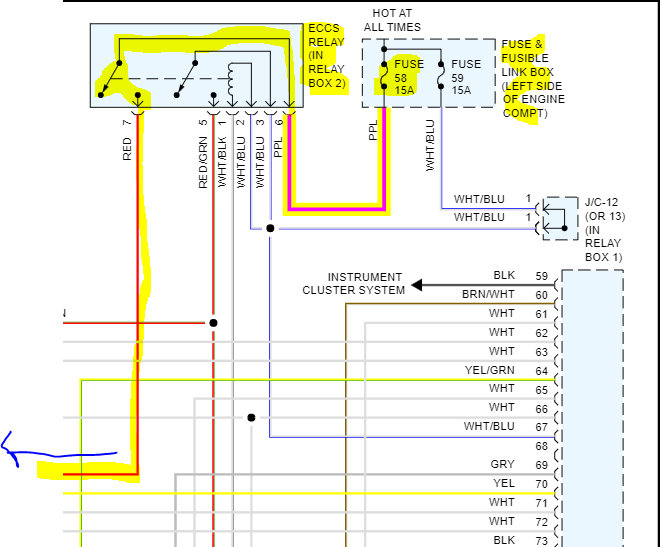

The coils all receive power from the ECCS relay, which in turn gets power to the secondary side of the relay from fuse 58. If you look at each coil, you will see a red wire. Those are the power supply. At the cylinder 3 coil, there is a splice which is what sends power to all the coils. With the key on, check for power at each of the coils' red wires.
So, if fuse 58 is faulty, that would prevent it. Also, a faulty ECCS relay can cause the issue. Or the primary side of the relay may not have power or ground. Power to the primary side is from the PCM. Once that power is sent and the ground is provided, the primary side of the relay's electromagnetic coil causes the secondary side to close and send power to the coils. Once the key is on, each coil should have 12v at the red wire. From that point, the ECM provides a ground path to each coil at specific times for fire the spark plug.
If you haven't already, check the fuse and relay I mentioned. If you have and both are good, use a test light to confirm power to and from fuse 58. If that is good, remove the ECCS relay. With the key on, two of the pins will have power. Confirm that for me. If they do, then check the relay itself.

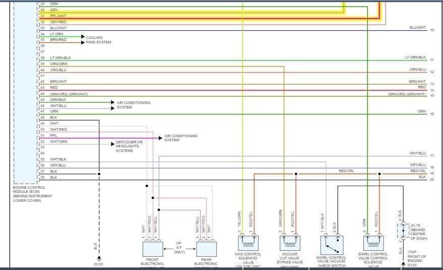

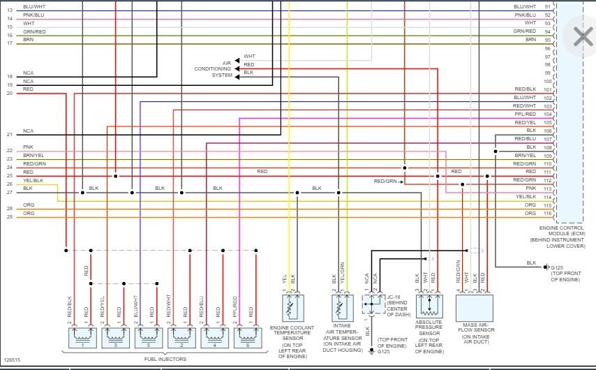

Here is a link that explains how to check for power at the fuse and how to check a relay:
Note: fuse 58 is in the under-hood fuse box on the left side of the engine compartment. The ECCS relay is in relay box 2. See pic 3 for location and pics 1 and 2 for schematic.
Let me know what you find.

I have checked the fuses, it all has power and I re-diagnosed it, it was showing 00: initial start, I have check the fault code on Alldata but I didn't see it. what could this mean?
Sep 12, 2022 at 3:47 AM
  • 110,241 POSTS
What is being used to retrieve diagnostic trouble codes? What you indicated, 00, isn't a code. Are you sure there weren't any other numbers after 00?

The code P1614 is for the immobilizer which prevents the engine from running unless the correct key is present. Do you have the correct key?

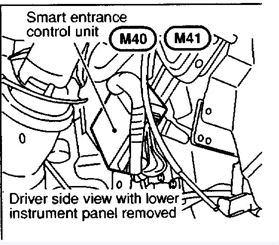

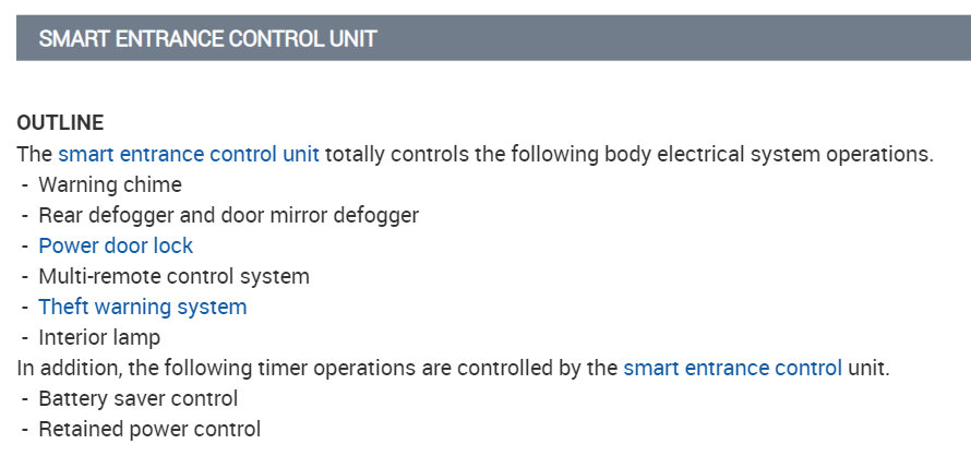

Where's Body Control Module of this vehicle located?
I brought another immobilizer and plugged it and i wanted to initialize it and it was saying "initialization failed" then i put back the old immobilizer and it was not recognize again by the control unit i.e the security indicator was no longer blinking or coming on when you turn ignition but if you put the new one, it will blink and if you turn ignition on, it will be steady. For this reason i want to change the BCM.
Dec 7, 2022 at 11:16 AM

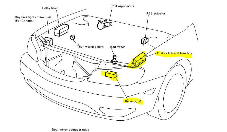

  • 110,241 POSTS
I believe they call it a Smart Entrance Module or controller. It is under the center of the dash. If you look at pic 1, it shows the items it controls and pic 2 shows the location.
If you are trying to look up the body control module, you won't find it on this vehicle.
Let me know if this helps.
Dec 8, 2022 at 10:10 AM
