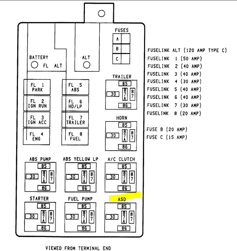

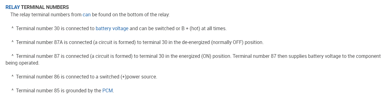

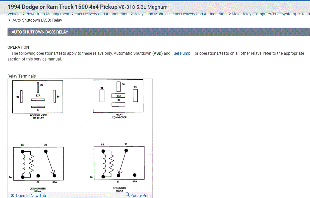

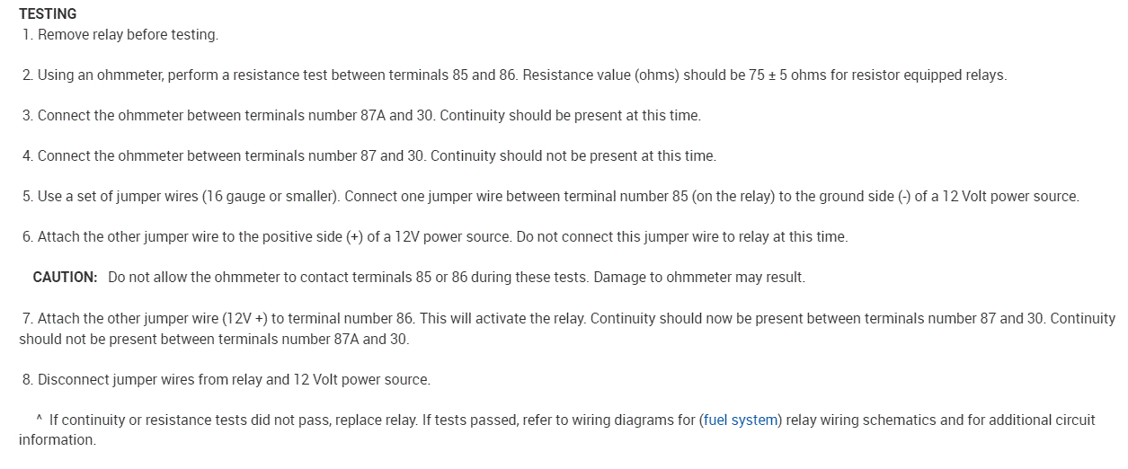

Have you checked the automatic shutdown relay (ASD)? That could be turning things off.
The ASD relay is located in the engine compartment. It is used to connect oxygen sensor heater element, ignition coil, alternator field winding, and fuel injectors to 12 volts + power supply. If it is not actuated, you won't have spark or fuel.
I attached a pic below showing the ASD relay. It is under the hood in the fuse box on the driver's side.
The last three pics are the directions for testing the ASD. Do this and let me know the results. Additionally, here is a link you may also find helpful:
Let me know what you find.

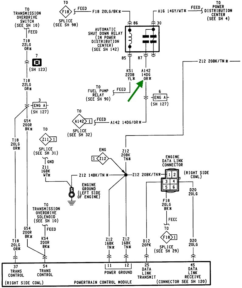

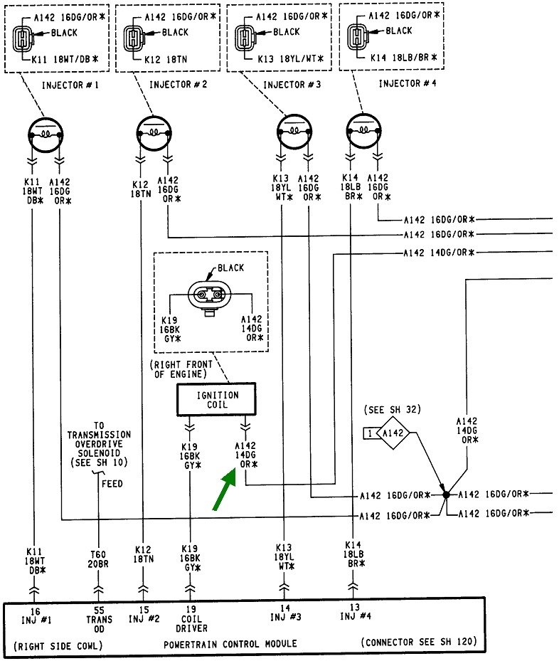

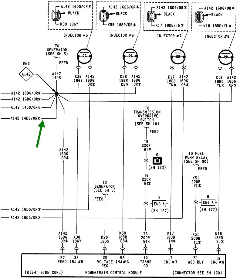

The best place to start is by observing the action of the automatic shutdown, (ASD) relay. You can test at any wire that is the same color at every injector, the ignition coil, or even the two smaller terminals on the back of the alternator. A test light works best for this. Digital meters respond too slowly at times. Look for the dark green / orange wires. Back-probe any one of them through the rubber seal alongside the wire. You should see the test light turn on full brightness for one second when you turn on the ignition switch. If you do not, we have to look at the fuse feeding that circuit. I'll search for the diagram if we need it and post that for you.

I posted these diagrams only to show the various places to find the dark green / orange wire. There are seven more diagrams for the engine controls that I can post if you need them. Let me know what you find up to this point, then we'll figure out where to go next.
