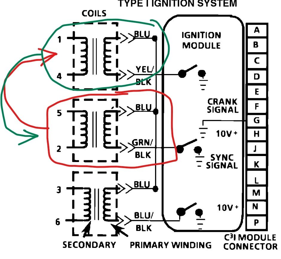

I just bought this car and after a few miles of driving it misfires and I have found cylinders 2 and 5 have no spark coming out of the coil pack. I determined this by pulling the plug wire.
I tested the coil pack for continuity and have matching numbers on a cold engine verses the hot condition once the problem occurs. So, I do believe the coil pack itself is good.
I can't find out how to check the ignition control module or wire to and from the cam and crank sensors.
I don't want to buy an ignition module or fire the parts cannon at this thing.
I am a certified diesel technician and do know my way around.
Please any troubleshooting help would be appreciated.

Okay, the coils are a common failure item as is the ignition module itself on those. They are a waste spark system so each coil fires a pair of cylinders. In this case 2 and 5 fire together. The fastest way to test if it's the coil or the module is to swap the coils. Pull the wires off the 2 and 5 coil, remove the screws and pull the coil off. Repeat for the 1 and 4 coil. Put the 1 and 4 coil in the 2 and 5 location and the 2 and 5 in the 1 and 4. Connect the plug wires back up. Start the engine, misfire is now on one and four, the coil is bad. Misfire stays on two and five, the module is bad. The other sensors do nothing but tell it cylinder position, if they work for one cylinder, they work for all. It's common for the coil connections to the base plate to corrode but far more common is for the coils to fail internally. FYI, I like to use only OE coils, I have had bad experiences with many aftermarket units. Same with the ignition module.

Thank you. That worked.
