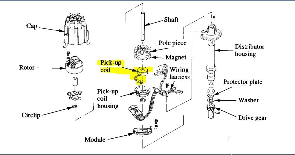

I know the vehicle has a crank angle sensor that is built into the distributor. It is also known as a pick up coil on this vehicle. If that fails, you won't get spark and to replace it, you need to dismantle the distributor. However, before we jump the gun and start throwing parts at it, we need to determine if there are diagnostic trouble codes which can help.

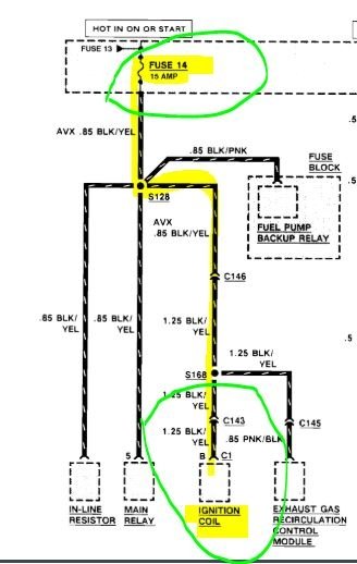

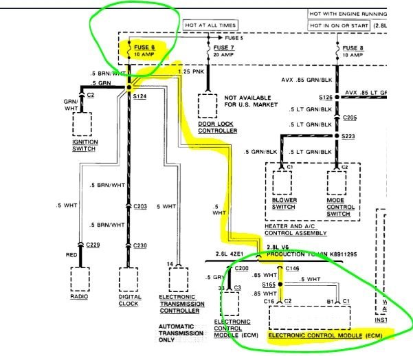

Next, I need you to check a couple fuses. See pictures 1 and 2.
If the fuses are good, my first suspect is the sensor (pick up coil). See picture 3. I highlighted the part I am referring to.

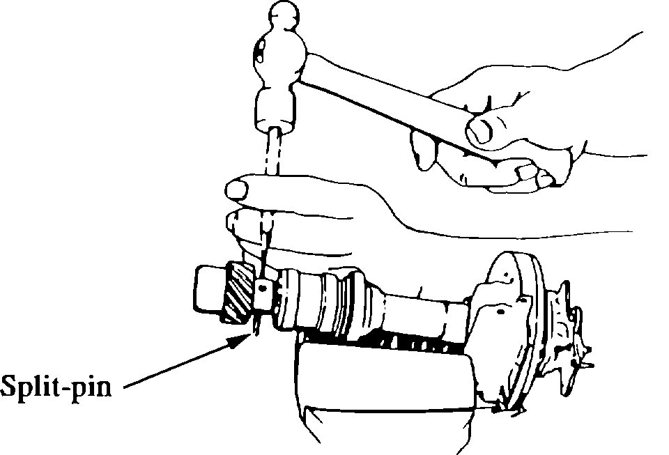

4. Remove the split-pin (Figure 2) securing the drive gear to the shaft.
a. Remove the drive gear, washers, and protector plate.
