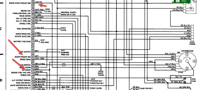

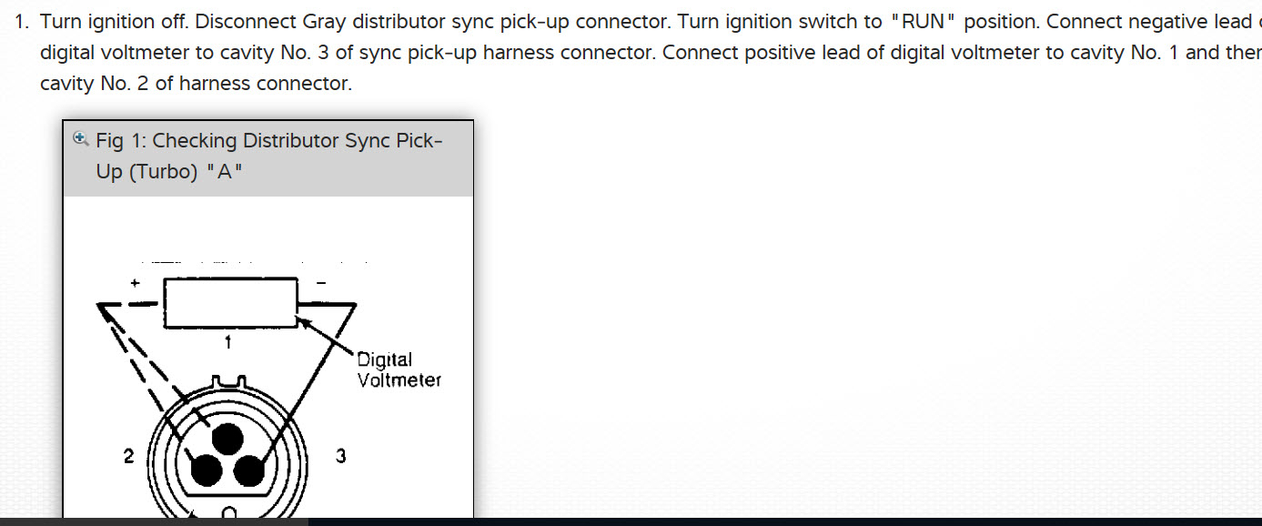

I have a 1988 Chrysler Le Baron 2,2 turbo cabrio and I already bought it broken (thought it was gonna be easy to fix it and enjoy the car) and I have no more ideas what could that be.
The engine won't start, there is no spark. I receive the error code 54 and have no more ideas for it.
The starter is ok, it's cranking, but the engine will not engage.
The fuel pump relay seems to be working, as I can feel it "click" on when the key is turned to start the car. I also hear it working when I stand close to the tank. Fuel filter looks like it must have been replaced recently.
I have the power module and the turbo logic module as 2 separate parts (as in 86-87 models).
It happened few times that the engine started while cranking, then it worked for a while and turned off suddenly. I even got it once working for like an hour and then I had to tug it back home. So sometimes something happens and the spark shows up, but it happened only like 5 times.
Already tried:
Replaced pickup sensor under the distributor cap for a new one.
Replaced the ignition coil for a new one.
Checked fusible links: they are ok.
Checked all wires: they are ok.
Checked on the two small wires on the back of the alternator during engine cranking: one of them has full battery voltage.
Checked the map sensor: it is ok.
Removed the rubber from the inside of the power module, checked all of the connections: they are ok.
Replaced one of transistors in the power module for a new one.
Remove the distributor cap and watch if the rotor turns during cranking: it does turn
The computer might have been already replaced once because there is written: "81 dodge b4 600"
I think it could be the logic module, but before replacing it I want to be 100% sure that I checked every other possibility, because it is an expensive adventure.
I will appreciate every useful hint, hoping for finally getting it repaired.

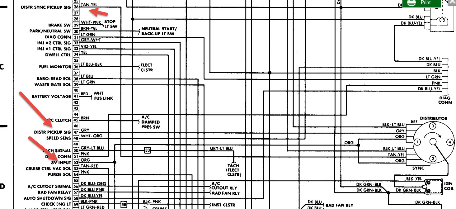

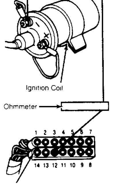

there is no code 54 however there is a code 53 which means the smec is bad see pics for diagnosis also make sure your auto shutdown relay is good.

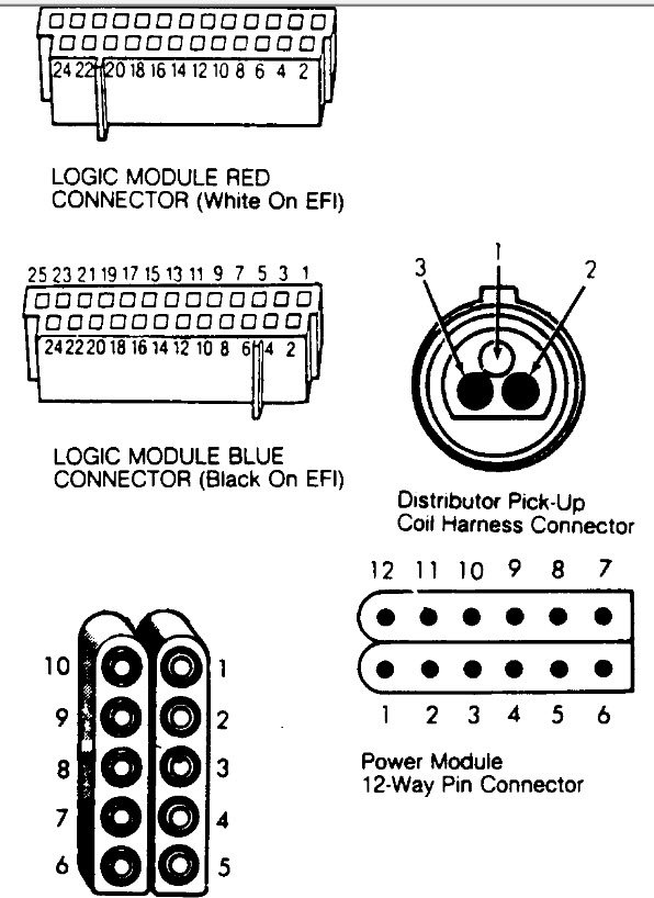

I don't have SMEC as cars built in 88-89, I have power module and logic module in 2 separate parts.
Power module has two sockets, one 10-pin, second 12-pin and is located unter the hood.
Logic module has two sockets, 25 pins each, one blue, one red and is located next to passenger's feet.

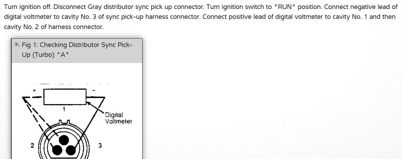

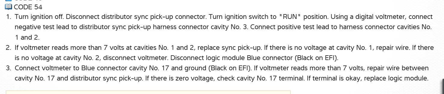

our site under electrical tells how to check a relay or type in search engine how to check a relay. as far as a smec our manual shows one on lh front fender but i'mnot gonna argue the point car is to damn old. see pics for diagnosing code 54

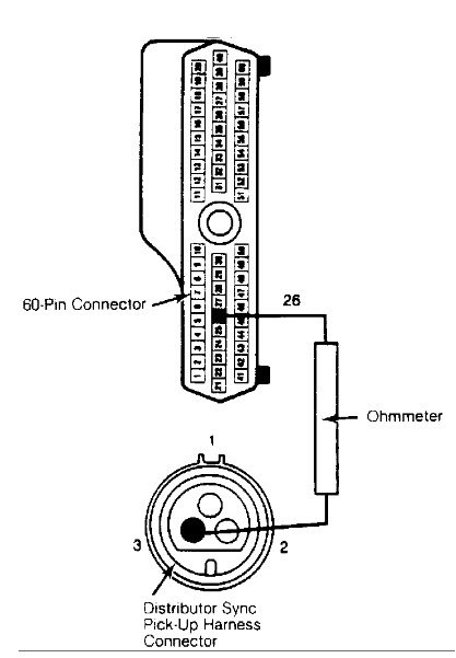

I diagnosed code 54 according to your screenshots, I have around 8 Volts on both connectors (No. 1 and No. 2) which would mean broken distributor sync pick-up, but I have just replaced it for a brand new one.
Is it possible that a brand new part is broken? I am sure it didn't get broken while being installed. The rotor spins when cranking the engine.
Can we have here some other issue?
May that be some wire or can it be the logic module failure?

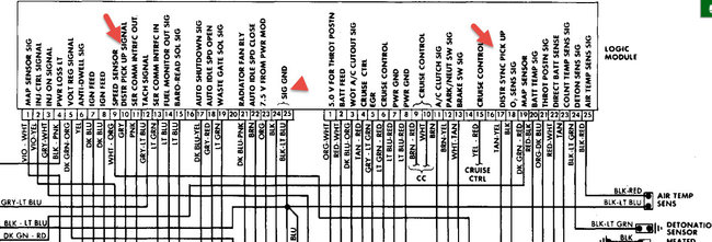

there should be a production date on your car, if spark goes to dist then it's either the rotor or dist cap. if you don't have the correct system on your car then the part may be incorrect did you check the wire going to smec? that may be frayed or grounding out. it may be your logic board is bad as well. or your pickup is a cheap one and not made to specs. a lot of Chinese junk is like that.

Maybe I should double-check the installation as the error indicates the camshaft position sensor? I mean the wiring from the camshaft sensor plug to the ECU plug
But where can I get the diagrams from? I tried to find some in the internet but there were none. Do you have any?

if there is no spark to dist and rotor turns and none to plugs then either a rotor or dist cap. as long as it spins the sensor should work. Blk/ lt blu powers other sensors

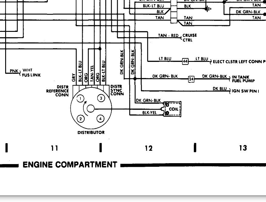

I've just checked the voltage on the ignition coil:
after turning the ignition switch it's 0,7 V less than the battery voltage for one second
BUT it's gone when cranking the engine, it's 0,2V then.
The ASD relay is turning on for 1 second when turning the ignition switch.
About the year of production: the nameplate is in German, but on the windows there's 87.
I told you I don't have 60-pin SMEC. All of the screenshots you attached are for 88.

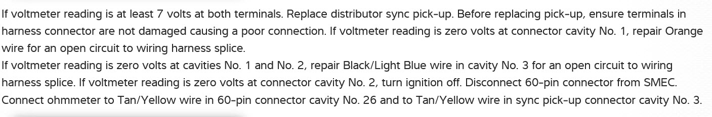

here iis one from an 87 which in previous replies I asked for a production date which you did not give. happy hunting
Apr 1, 2016 at 5:03 AM
HMAC300
  • 48,601 POSTS

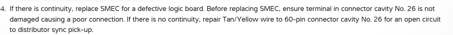

here's more I hate this new system
Apr 1, 2016 at 5:07 AM
HMAC300
  • 48,601 POSTS

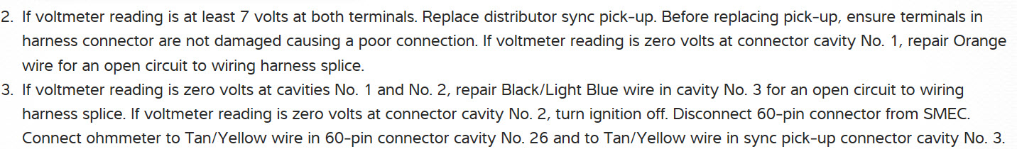

more too

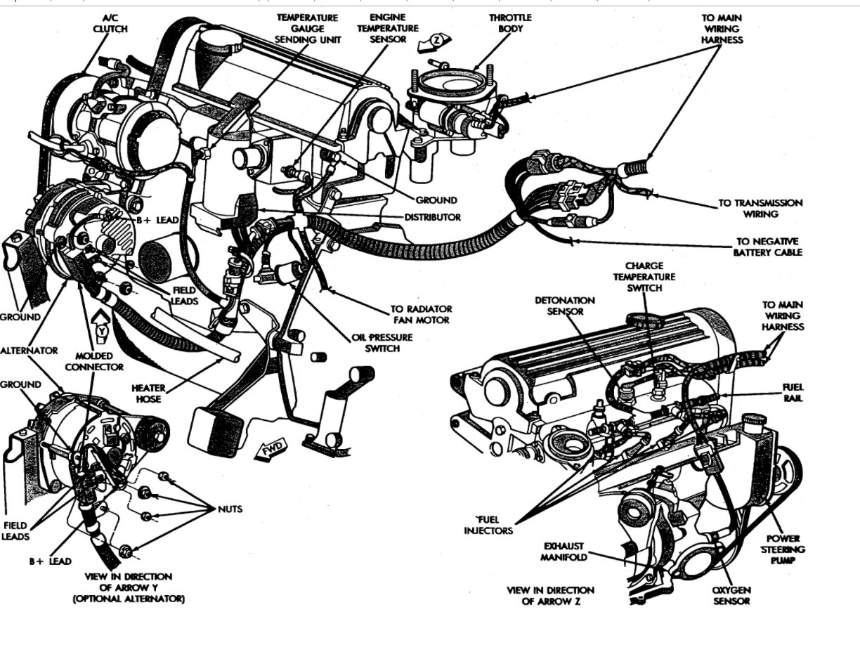

I would try changing the engine temperature sensor, it sounds like it is shorting out.
Here is a guide that will help show you what you are in for when doing the job and a diagram (below) on it location on your car.
https://www.2carpros.com/articles/coolant-temperature-sensor-cts-replacement

I made a mistake in our manual they don't list code 54 but I went to a different area and found code 54 it's a distributor problem see pics for tests to do to diagnose this. if it leads to what is called a smec that is the computer as faulty. follow tests in order of pics.
