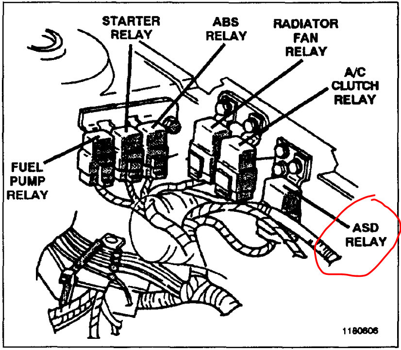

1993 DODGE SHADOW
108 MILES • 2.2L • 4 CYL • 2WD • AUTOMATIC
CITCIT
No spark doesn't sound like fuel pump coming on.
Jan 12, 2020 at 10:46 AM
  • 110,240 POSTS
The first thing I suggest is checking the automatic shut down relay. I attached a picture of the component and its location. It's under the hood on the driver's side inner fender.
This is to shut down fuel and spark in the event of an accident. You can replace it or here is a link to test a relay.
