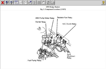

The car turns over fine but does not appear to have spark. I replaced the plugs, cap and rotor. I also had the coil checked. It is o.k. What else could be checked? Thank you, Carl

For a start inspect and test the auto shutdown relay, ASD relay this one powers the coil/injectors/fuel pump. When you turn key to On -do you hear the fuel pump. also do this crank engine over and listen to the injector/s are they clicking? If not on both double check the ASD relay it has to go thru there to power all 3 of them. The computer energizes the ASD relay. See below
https://images.2carpros.com/forum/automotive_pictures/12900_asd_relay_2.jpg
