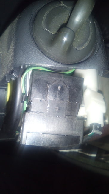

BRIAN567
  • 26 POSTS
I do not know if that is even the ignition switch I am hitting. It is just some kind of black box right under your key slot. Has a white plug inside next to it.
Thursday, November 8th, 2018 AT 2:46 PM
  • 52,797 POSTS
You need to check the connections to be sure it is not a bad connection or a pin in the connector.
Thursday, November 8th, 2018 AT 2:52 PM
BRIAN567
  • 26 POSTS
Yeah I am checking that right now. I mean it is definitely a short in there. Anything you have to smack with a ratchet to get power is not good, lol.
Thursday, November 8th, 2018 AT 2:54 PM

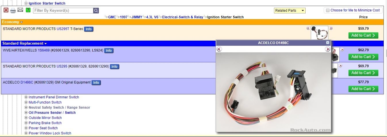

BRIAN567
  • 26 POSTS
So the ignition switch I looked at from AutoZone does come with connectors. I am looking on YouTube on how to replace the ignition switch.
Thursday, November 8th, 2018 AT 2:57 PM
  • 52,797 POSTS
Rock auto
Thursday, November 8th, 2018 AT 3:04 PM
BRIAN567
  • 26 POSTS
Yep. That is exactly the black thing that I have to smack to get power to the Jimmy. Except they are plugged in still. Obviously
Thursday, November 8th, 2018 AT 3:13 PM
  • 52,797 POSTS
Yep, and that one is an original AC Delco.
Thursday, November 8th, 2018 AT 3:20 PM
