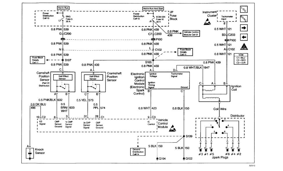

My vehicle shut off while driving the other day. It cranks but does not start. Battery is perfect. Dashboard gauges will not move at all and will not shift out of park.

Good afternoon.
Did you check for power to the coil?
See if you have voltage to the positive side of the coil with the key on.
Did you verify fuel pressure as well?
I attached a wire diagram for you. Check the pink wire to the coil and the module with the key on.

We did a spark plug test. There is no spark at all. We are going to try changing the ignition coil and see if that works. We just do not understand why the dashboard gauges do not work and why it will not shift out of park.

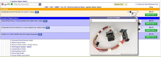

So it turned out being a faulty ignition switch. We removed the plastic cover under the ignition and turned the key to the on position. Then we smacked that area with a wrench and the entire dashboard cluster had power and the vehicle started right up.
