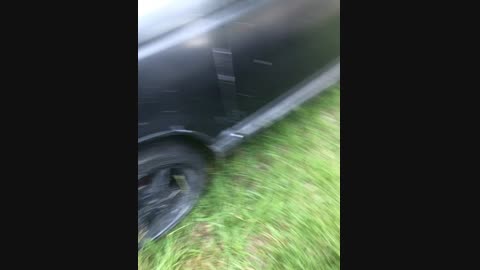

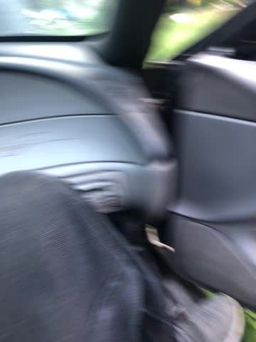

I have done all I can do. I have changed everything I could and asked around and tried every YouTube and backyard mechanic way to get it started and nothing. I got new crank and cam sensors on it went out today. Got a new CCRM and for some reason it is buzzing like crazy. I have torn this car apart and everybody points to the anti thief light, but there another problem; If I leave the key on the light goes off and it still will not start. I have had the key programmed and nothing still. I dropped the tank to check the fuel pump and it works but will not come on. It does not get any sparks just cranks. Please help.

Nice work with the video makes my job much easier.
With the CCRM buzzing like that I would say the car has a ground problem from the battery to the frame to the engine block. Please check to make sure all ground straps/wires are in good working order. Once you have checked the grounds we can start on the wiring next.
