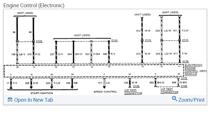

My truck is sporadically. At the times it will not start. there is no spark at the coil. I have replaced the coil pack, ignition sensor, fuel filter, o2 sensor, plugs and wires and tested the pump. It will turn over but not crank most of the time. After sitting for a day or so it will crank and run fine. I have checked for a vapor lock as well and nothing seems to correct the problem. Any ideas?
Aug 13, 2017 at 3:21 AM
DIESEL&AUTOTECH
  • 5 POSTS

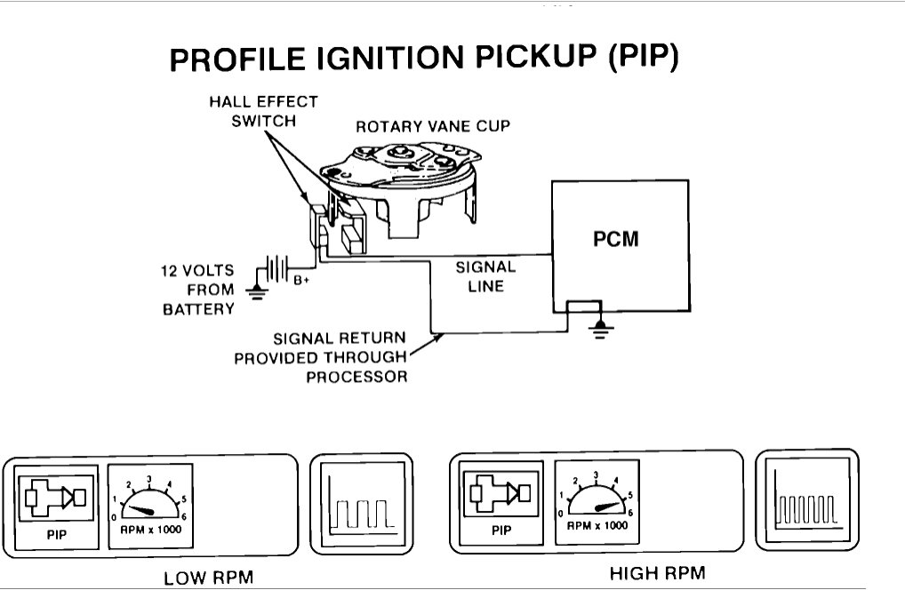

I would lean more to crank sensor. My truck had same issue with no check engine light. Took me a day to realize it was the crank sensor registering but no signal output. This guide can help us
Aug 13, 2017 at 4:28 AM
  • 55,732 POSTS

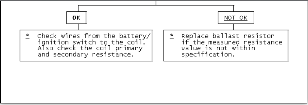

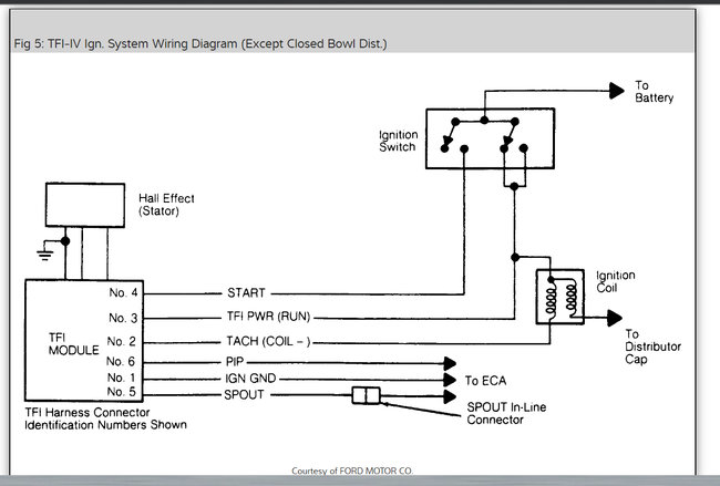

DIESEL&AUTOTECH is right. The crankshaft angle sensor or PIP can cause the problem you have described.
Here is a diagram (below) that will help you get the problem fixed. This hall effect sensor goes out all the time.
Please let us know what happens, we are interested to see what it is.

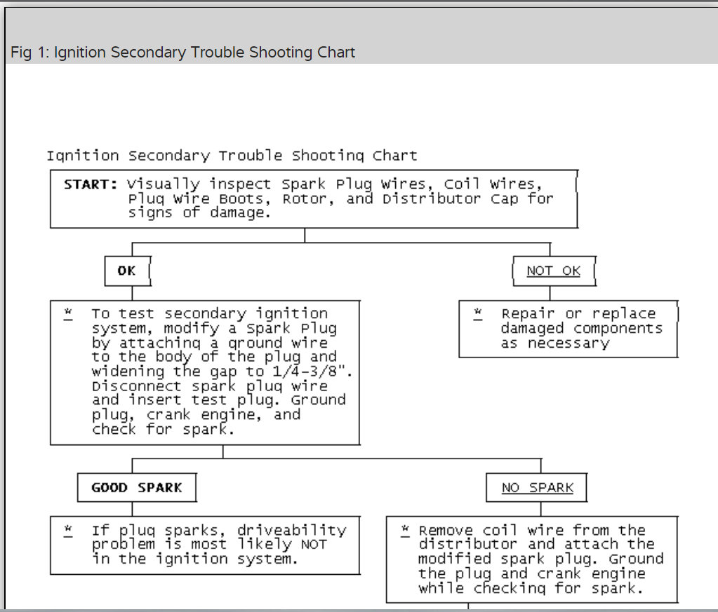

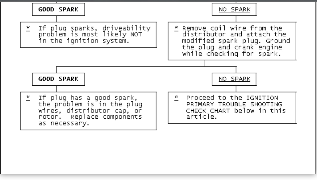

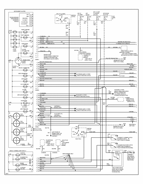

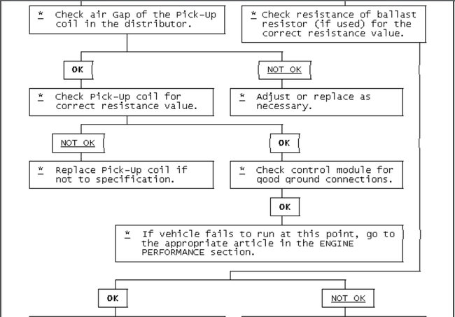

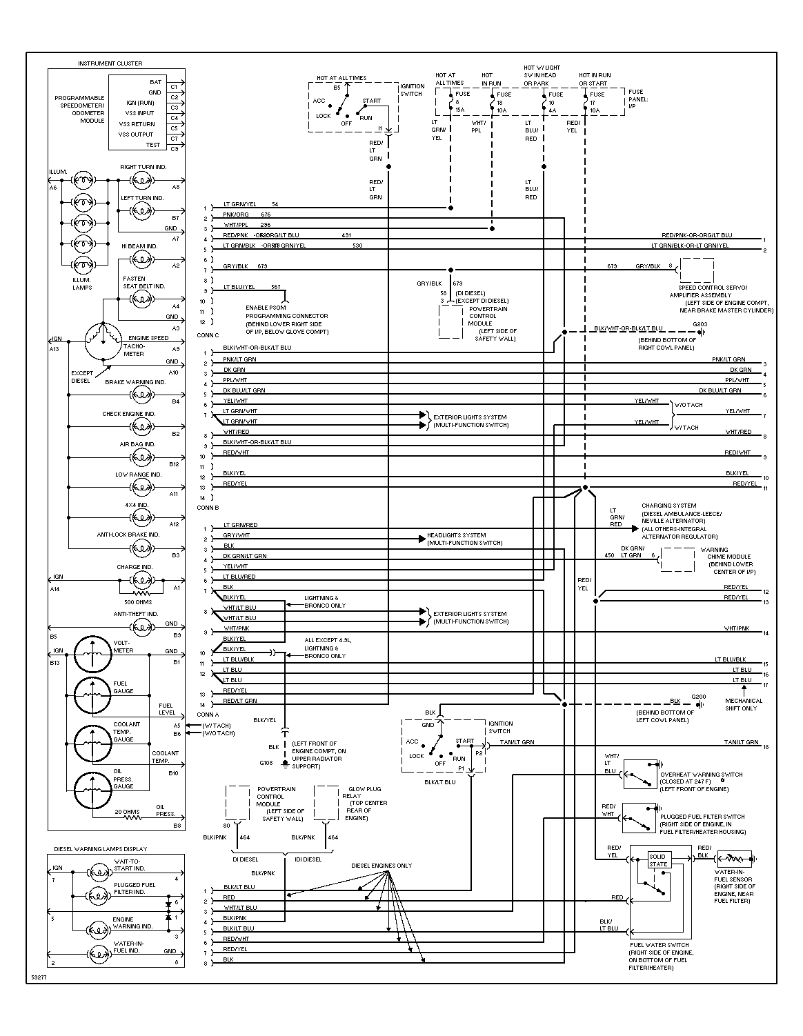

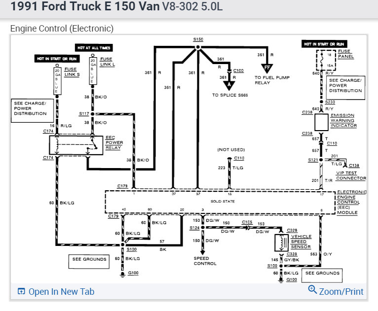

Here we go!
Mega complicate stuff in there!

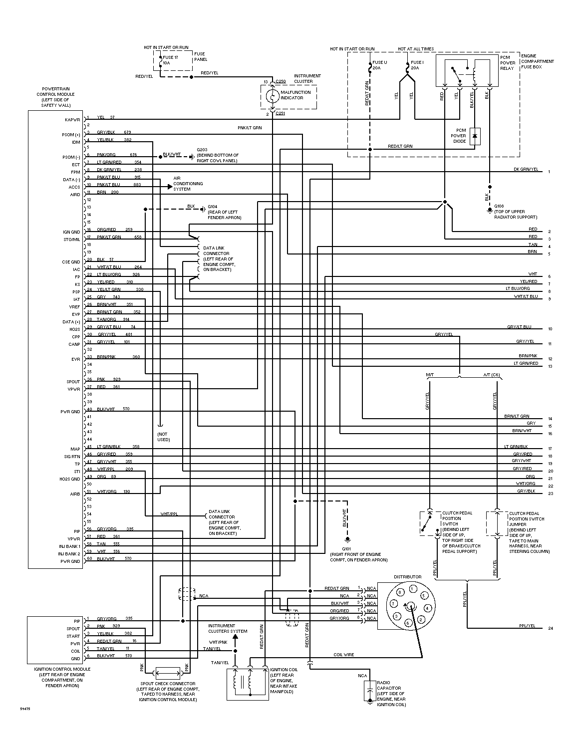

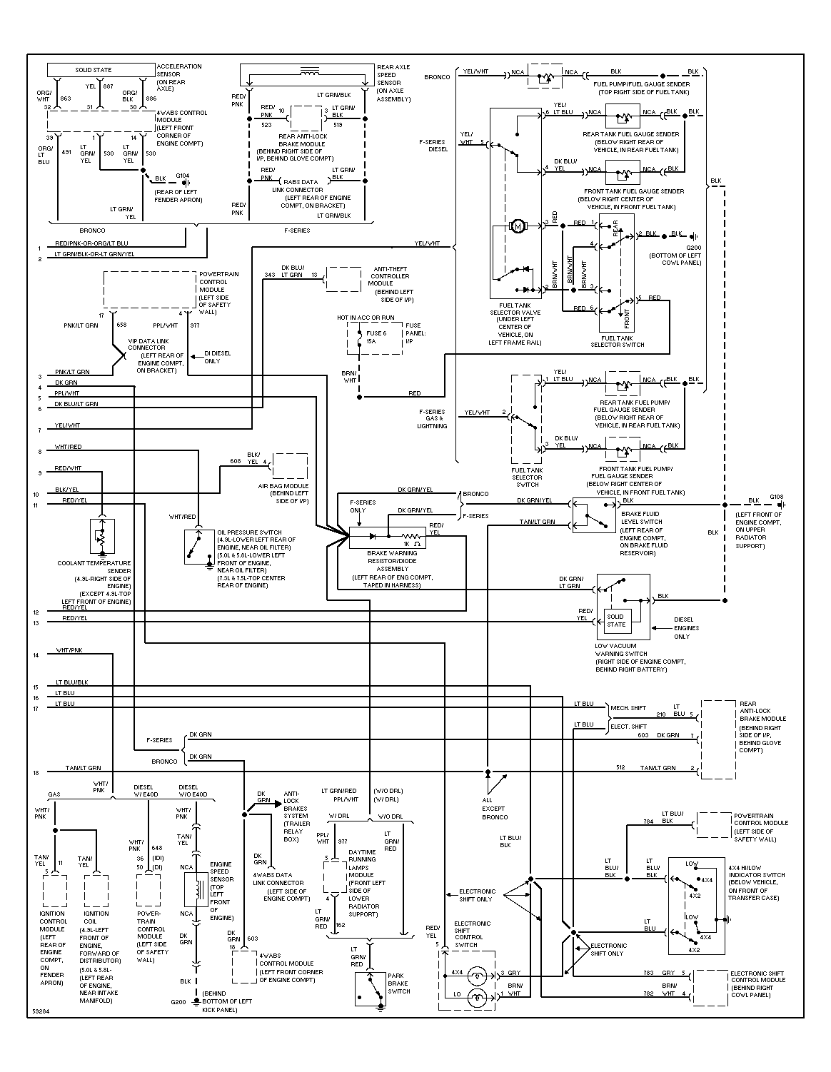

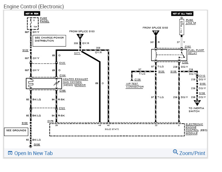

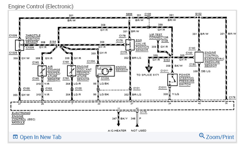

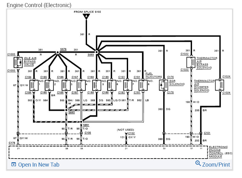

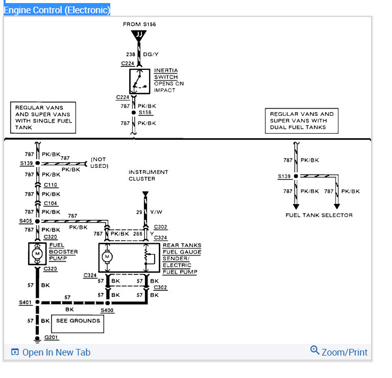

I need more specific trk info....heck, i have no clue what some of it means! But if you tell me, i can get the correct diagrams
I went ahead and grabbed 3 diagrams, the later 2, should both be correct for all 150s they are the instrument cluster (broke into two diagrams)
The 1st is "mfi" 5.0 engine performance (i grabbed that one, it's the 1st diagram!) Other choices were "sfi" and even more listed transmission types, to acquire the correct engine performance diagrams (in all, i have about 6 choices w/ a 5.0)..........so what it boils down to is, i got the right diagrams......or you are gonna have to send more info so i can! Mfi?sfi? Tranny? Will help me a bunch!
I did a quick scan of the 1st diagram, the coil pic, shows it going to another diagram...the gauges....that's sorta how i made my choices on grabbing the instrument diagrams
There's like a hundred diagrams for various engine applications...that's why we need to get specific!
Sorry if i ain't really helpin' real good, thus far
Let me know if you cannot read these, as i do not know what size they will be when i post.....i can explain a "private" "safe" way to get them to you.....don't just blurt out your private info here!

If you could supply the correct info for your truck, i will try to get the right diagrams....someone (it may not be me) should be able to figure something out. You may be correct (or not) about the multifunction or the ignition switch. Looks to me like tracing thru the diagrams, might be cheaper than, throwing parts, or last resort hiring someone else to do it.
Can you read the above diagrams? Was the "mfi 5.0" the correct diagram?

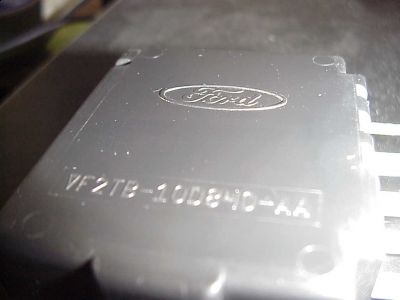

JIMWARMEY

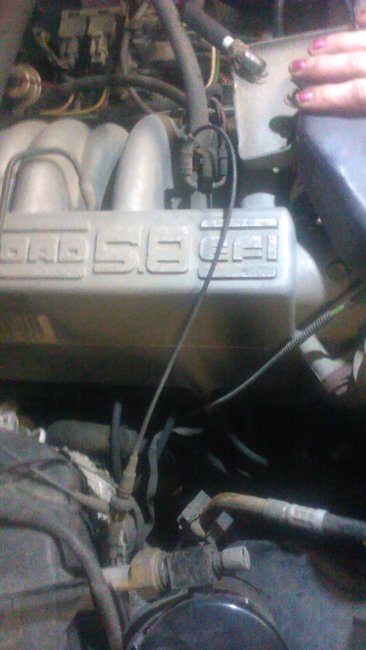

Electrical problem 1992 Ford F150 V8 Two Wheel Drive Automatic Hi i'm having problems with my F-150 i was driving and switched fuel tanks then it shut off and i dont even get fuel or a spark either. i was told this is probably a pcm unit problem, but i've tried several stores and no one has any idea about a pcm unit for this car. i pulled out what i thought was the pcm the part number is VF2TB-10D840-AA is this the right part to replace or am i totally looking the wrong way.
https://images.2carpros.com/forum/automotive_pictures/456343_MVC002L_1.jpg
https://images.2carpros.com/forum/automotive_pictures/456343_MVC001L_1.jpg
Oct 14, 2020 at 7:06 AM (Merged)
BLACKOP555
  • 10,386 POSTS

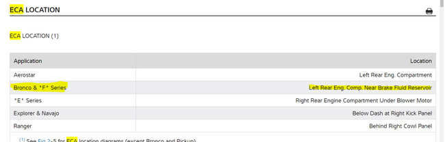

no way is that a pcm.
the pcm is where the big harness of wires connects to under the hood. will have cooling fins on it. should be driver side of vehicle.

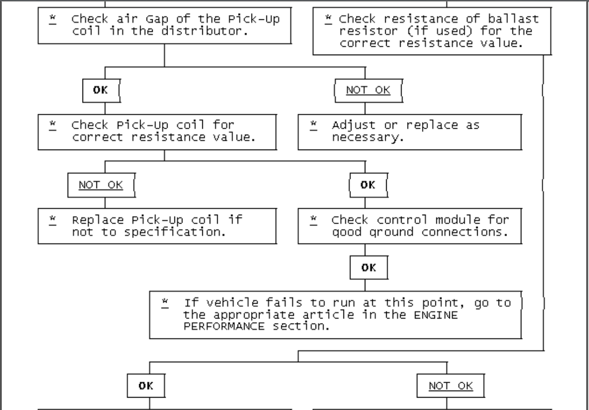

This could be a number of things from the Ignition Control Module (ICM), The Power-train Control Module (PCM), The Spark Output (SPOUT) connector, spark plug wires, or the spark plugs themselves. But, in the diagrams down below I have included an Ignition System Troubleshooting flowchart for you to go through. Please go through it and get back to us with what you find out.

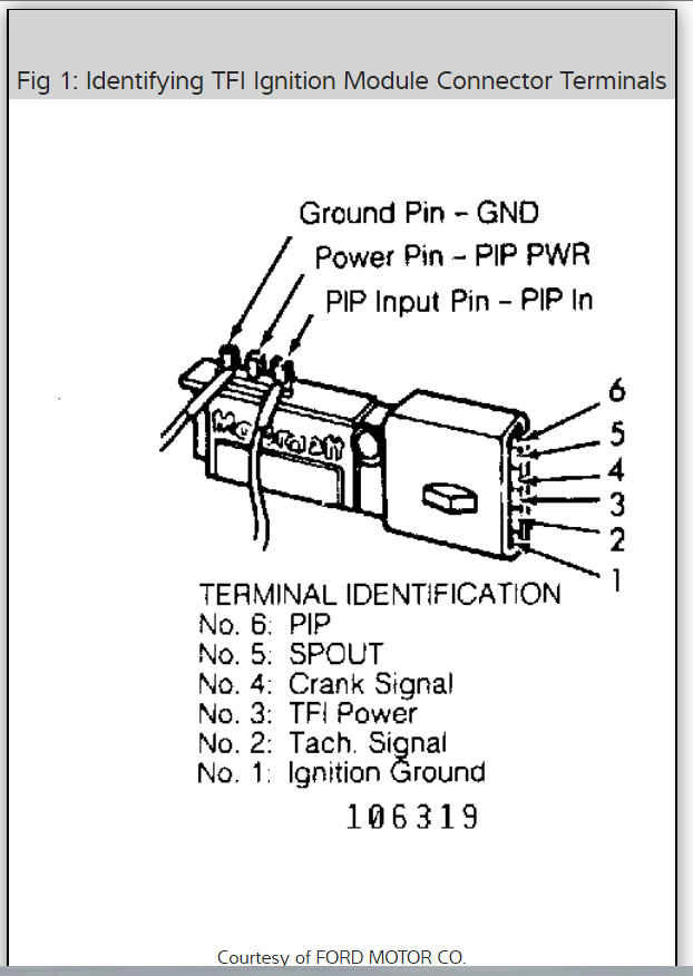

SCGRANTURISMO
  • 4,897 POSTS
Hello again,
Okay, Can I get you to check the wire coming from the #1 cavity on the TFI Ignition Module Connector. Please run this wire back and check to make sure it has a good tight connection, and it is not damaged and there is no corrosion present anywhere. I have included a diagram of the connector and component locations in the diagrams below. Please get back to us with what you find out.
Thanks,
Alex
2CarPros

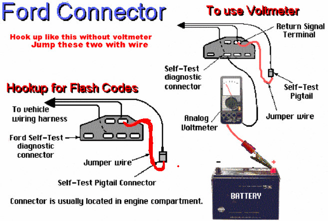

OK, first thing I would look at is the Distributor Cap & Rotor, when was last time replaced. Look inside is there corrosion in the contacts if so would replace along with rotor. While there if can have someone turn engine over and watch to see if rotor spins, if doesn't then most likely will need new distributor.
Other possibilities -
If Check Engine Light is On
TPS - Throttle Position Sensor
IABV or IAC - Idle Air Bypass Valve or Idle Air Control Valve
The engine needs to be at normal operating temperature for testing.
The self test connector is on the drivers side inner fender well. Check Pic for shape of connector. Then hook up a jumper wire as shown in the diagram below. Turn your key forward to the RUN position (KOEO, key on, engine off), and after a few seconds the codes will begin to flash through Engine Light or if you have hooked up a voltmeter, the needle on the voltmeter will indicate the digits of the trouble codes in sweeps of the needle. Record all codes and identify them as KOEO codes.
Code will be shown in blinks of the light or sweeps of the needle.
Example:
2 digit Codes
1 fast flash, with 2 sec pause, then 2 fast flashes is code 12
2 fast flashes, with two sec pause, then 3 quick flashes is code 23.
3 digit codes
1 fast flashe, 2 sec pause, 3 fast flashes, 2 sec pause, then 2 fast flashes is code 132
If there are more there will be a 4 second pause before the next code starts.
After the KOEO codes finish. Continuous codes follow after a 6 to 9 second pause, a fast flash, and another 6 to 9 second pause. Write these codes as continuous codes. Then remove key and the jumper wire.
You won't be able to perform Key On Engine Running test(KOER) at this time.

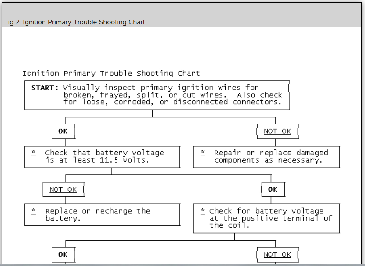

I have a 1991 F-150 that is not getting a spark from the coil. Tester light on Tach output bright and pulses when cranking. TFI module computer tested ok. Coil resistance checks OK. Checked wiring harness. What am I missing?
Oct 14, 2020 at 7:07 AM (Merged)
WRENCHTECH
  • 20,760 POSTS
If your getting a power signal to one side and a pulse to the other, that would indicate a bad coil or coil wire. Also, if you used a test light with an incandescent bulb, you can fry the ignition module in a heartbeat. You need to use either a noid light or computer safe test light.
TEXASTURKEY
  • 11 POSTS
I tried changing the coil wire with a good one and still no joy in Mudville. I checked the resistance of the primary and it is 1 ohm and the secondary is 8.9K which puts it with in specs. Do you think it is still not functioning?
WRENCHTECH
  • 20,760 POSTS
If it gets the proper signals and no spark comes out, then the coil is bad. Just be sure about your testing.

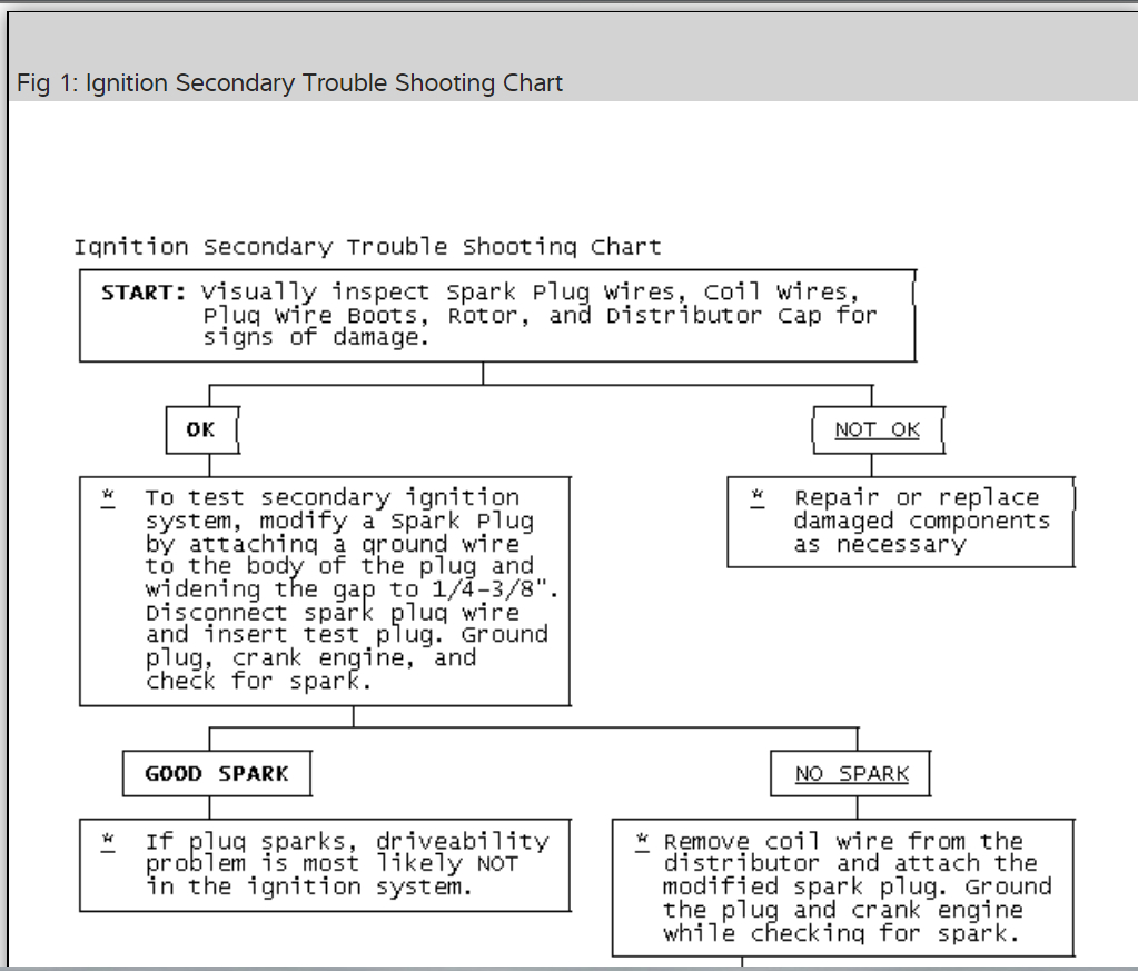

first things first. go out and buy a spark tester. then check spark directly from coil. if its there then check for spark coming out of each spark plug wire. make sur eyou ground out the tester good. note back what color the spark is. shoudl be bright and blue. not orange or yellow.

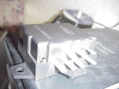

I have a 1990 Ford f150 158,000 miles that I can't get started. The truck turns over but there is no Spark. The alternor has charge. Put in a new battery, plugs, wires, distributor cap, rotor in cap, coil and a part i dont remember the name( it's on the side of the truck and the positive and negative cables are connected to it). Any suggestions on what to do next to get it started? Starter? Timing chain?
2CARPRO JACK
  • 11,533 POSTS
Most likely an ignition module.Those are very toughy and go out for no real reason.Should be mounted to the side of the distributor where the electrical plug goes.You must disconnect ehneg batttery cable before replacing it or you may burn up the new one
