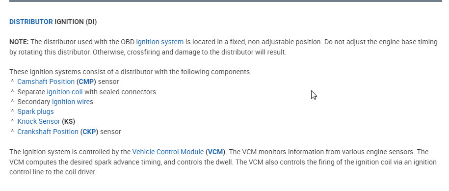

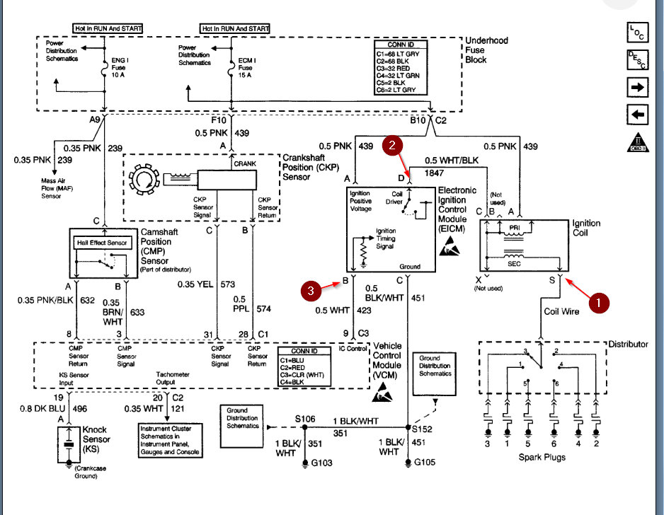

This could be the VCM but when you say you replaced the starter control module, I assume you mean the Ignition control module? If so, we need to make sure the crank sensor is sending signal as the VCM will pulse the EICM based on this signal. This module is pulsed, it closes the coil and this is what tells the coil to fire.
Basically crank the engine and tell me what voltage you have at each of the points on this diagram.
Let me know and we can go from there. Thanks
