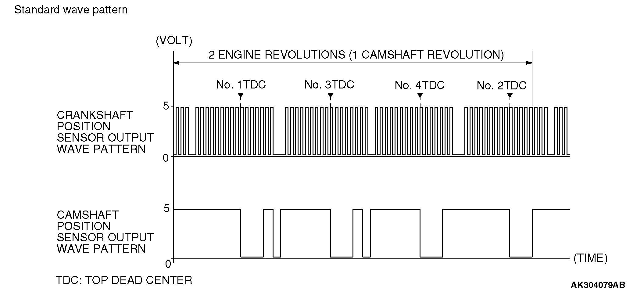

The ECM or PCM determines which ignition coil should be controlled by means of the signals from the camshaft position sensor which is incorporated in the camshaft and from the crankshaft position sensor which is incorporated in the crankshaft. It also detects the crankshaft position to provide ignition at the most appropriate timing in response to the engine operation conditions.
What I would start with is simply checking to make sure you are getting signals from both sensors I mentioned. If you have an oscilloscope, here are the directions for testing the cam sensor and crank sensor. The attached pics correlate with the directions.

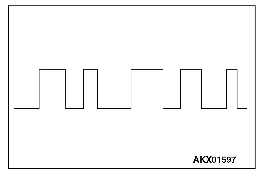

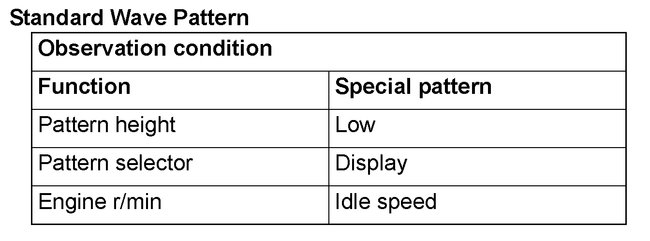

OSCILLOSCOPE PATTERNS AND WAVE-FORMS
INSPECTION PROCEDURE USING AN OSCILLOSCOPE
CAMSHAFT POSITION SENSOR
pic 1
Required Special Tools:
- MB991709: Test Harness
- MB991658: Test Harness
- MB991923: Power Plant ECU Check Harness
Measurement Method

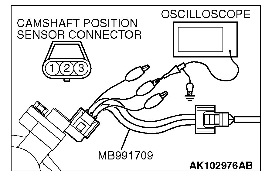

1. Disconnect the camshaft position sensor connector, and connect the test harness special tool (MB991709) between the separated connector (All terminals should be connected)
2. Connect the oscilloscope probe to camshaft position sensor connector terminal No. 2.
pic 2

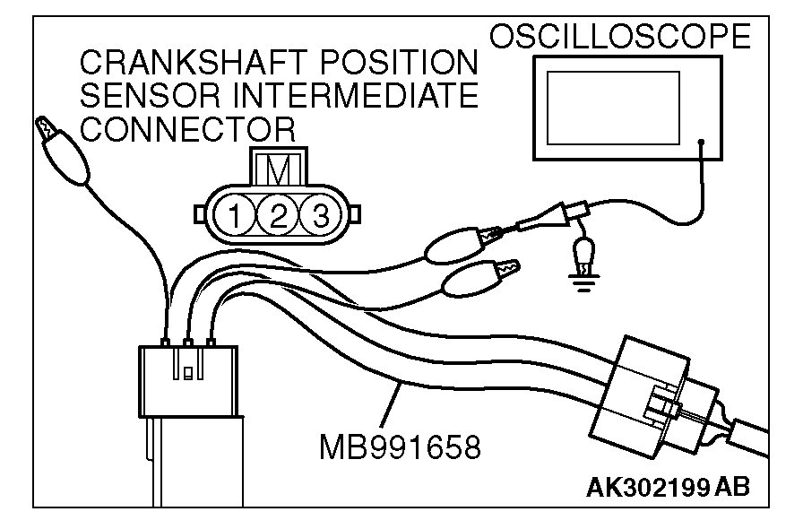

3. Disconnect the crankshaft position sensor intermediate connector, and connect the test harness special tool (MB991658) between the separated connector.
4. Connect the oscilloscope probe to crankshaft position sensor intermediate connector terminal No. 2.
Alternate method
pic 3

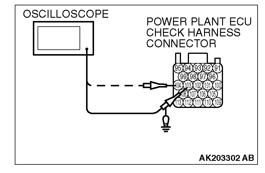

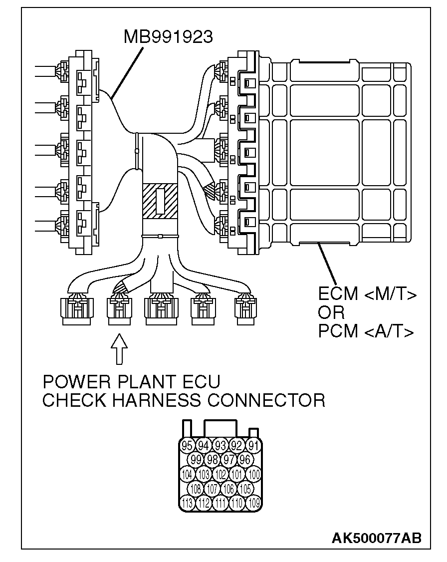

1. Disconnect all ECM connectors or PCM connectors. Connect the check harness special tool (MB991923) between the separated connectors.
pic 4
2. Connect the oscilloscope to check harness terminal No. 104. (Check the camshaft position sensor signal wave pattern.)
pic 5
pic 6
3. Connect the oscilloscope to check harness terminal No. 103. (Check the crankshaft position sensor signal wave pattern.)
Wave Pattern Observation Points
1. Check that cycle time becomes shorter when the engine speed increased.

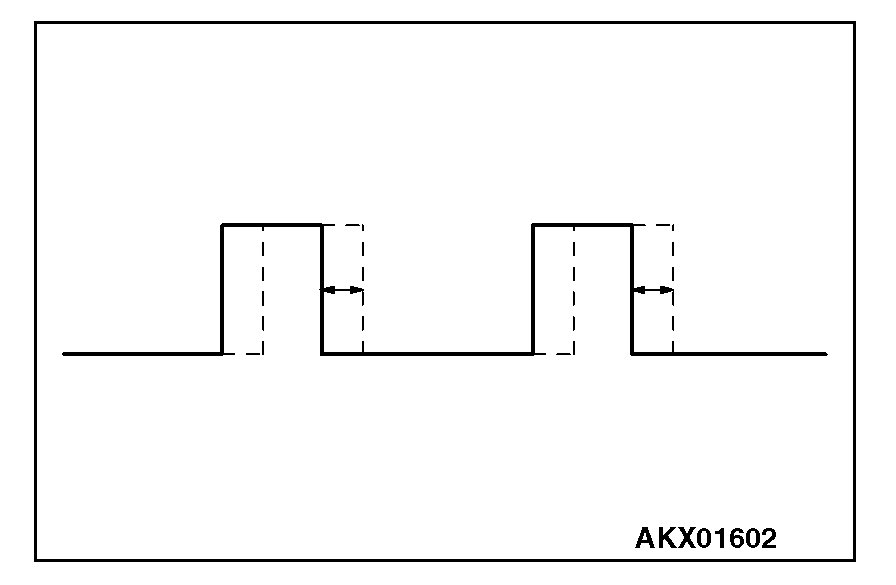

Examples of Abnormal Wave Patterns
pic 7
Example 1
Cause of problem
- Sensor interface malfunction.
Wave pattern characteristics
- Rectangular wave pattern is output even when the engine is not started.
pic 8
Example 2
Cause of problem
- Loose timing belt.
- Abnormality in sensor disc.
- Wave pattern is displaced to the left or right.

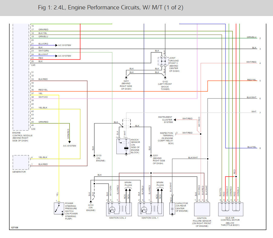

Here are specific directions for testing the coil and power transistor.
2007 Mitsubishi Eclipse L4-2.4L (4G69)
Ignition Coil
Vehicle Power-train Management Ignition System Testing and Inspection Component Tests and General Diagnostics Ignition Coil

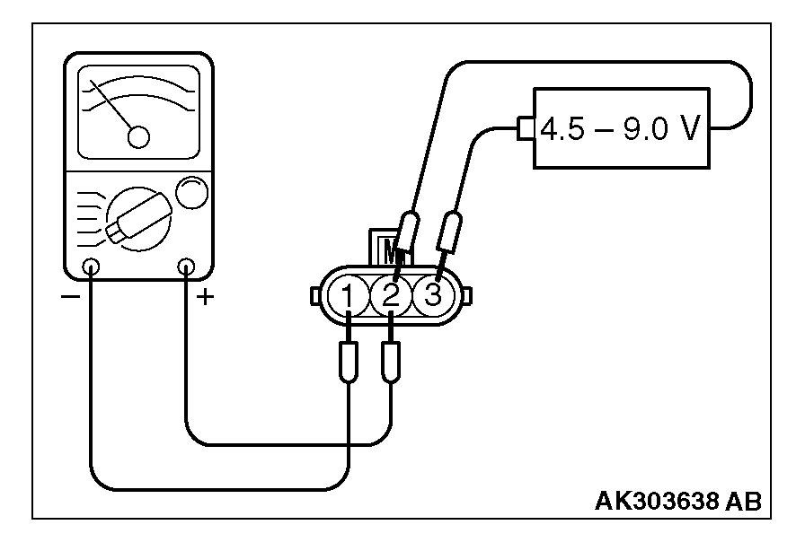

IGNITION COIL
IGNITION COIL CHECK
Check by the following procedure, and replace the coil if there is a malfunction.

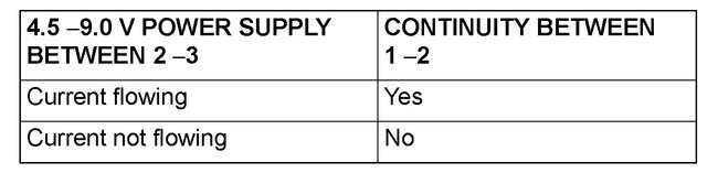

PRIMARY COIL AND IGNITION POWER TRANSISTOR CONTINUITY CHECK
NOTE: An analog-type ohmmeter should be used.
NOTE: Connect the negative probe of the ohmmeter to terminal 1.
CAUTION: This test must be performed quickly (in less than 10 seconds) to prevent coil from burning and ignition power transistor from breaking.
pic 9
1. Connect and disconnect 4.5 - 9.0 V battery between terminal No. 2 and No. 3, and observe the ohmmeter whether there is continuity or not.
pic 10
2. If results do not agree with the table, replace the primary coil and ignition power transistor assembly.
SECONDARY COIL CHECK
NOTE: It is impossible to check the secondary coil through the continuity check as a diode is integrated in the secondary coil circuit of this ignition coil. Accordingly, check the secondary coil in the following procedure.
1. Disconnect the ignition coil connector.
2. Remove the ignition coil and install a new spark plug to the ignition coil.
3. Connect the ignition coil connector.
4. Ground the side electrode of the spark plug and crank the engine.
5. Check that spark is produced between the electrodes of the spark plug.
6. If no spark plug is produced, replace the ignition coil with a new one and recheck.
7. If spark is produced with the new ignition coil, replace the old one as it is faulty. If no spark is produced again, the ignition circuit is suspected as faulty. Check the ignition circuit.

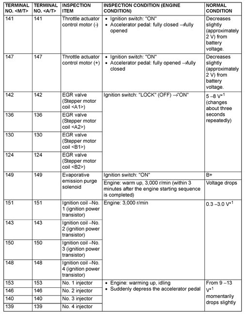

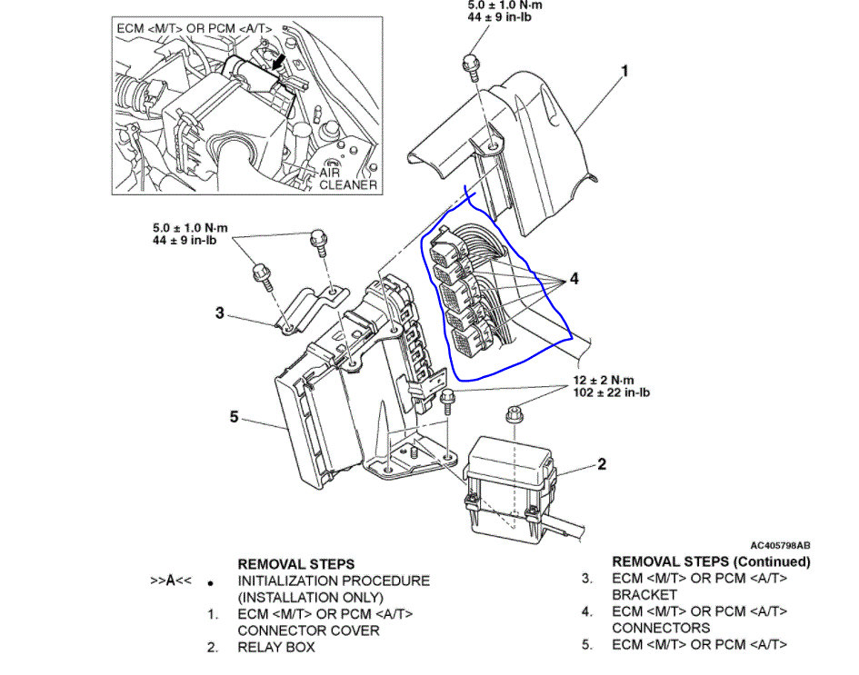

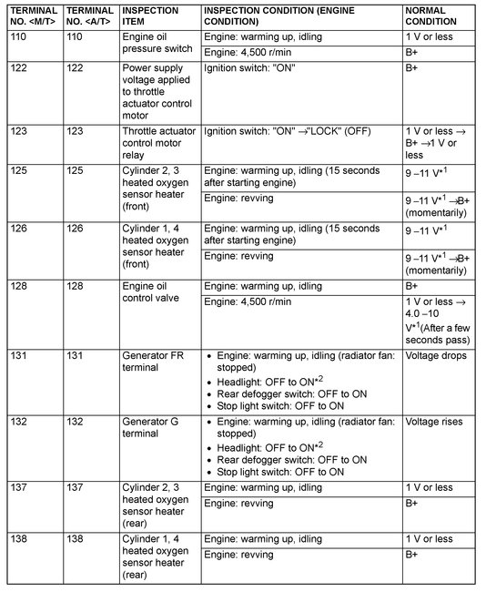

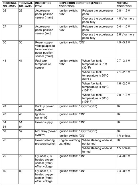

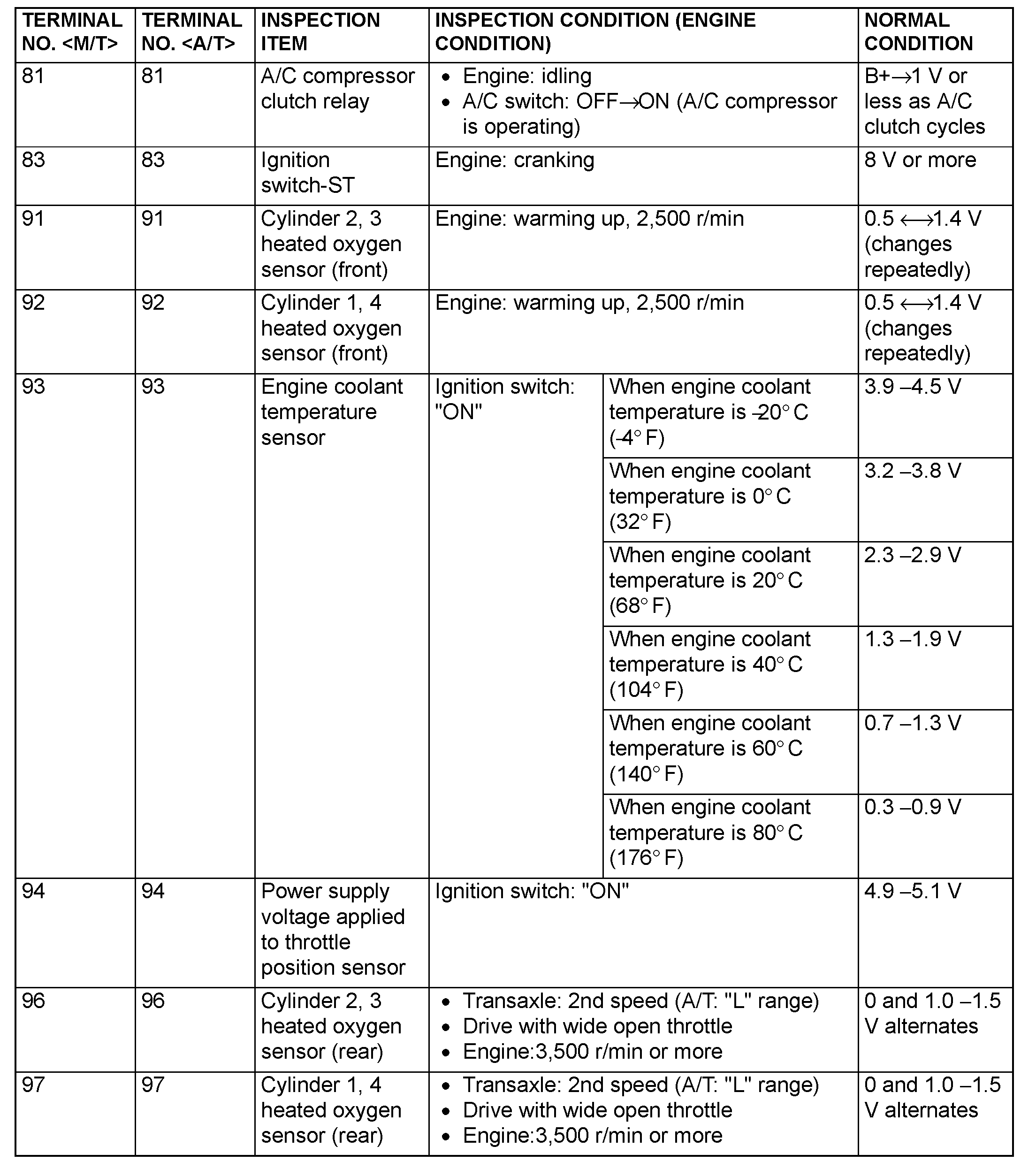

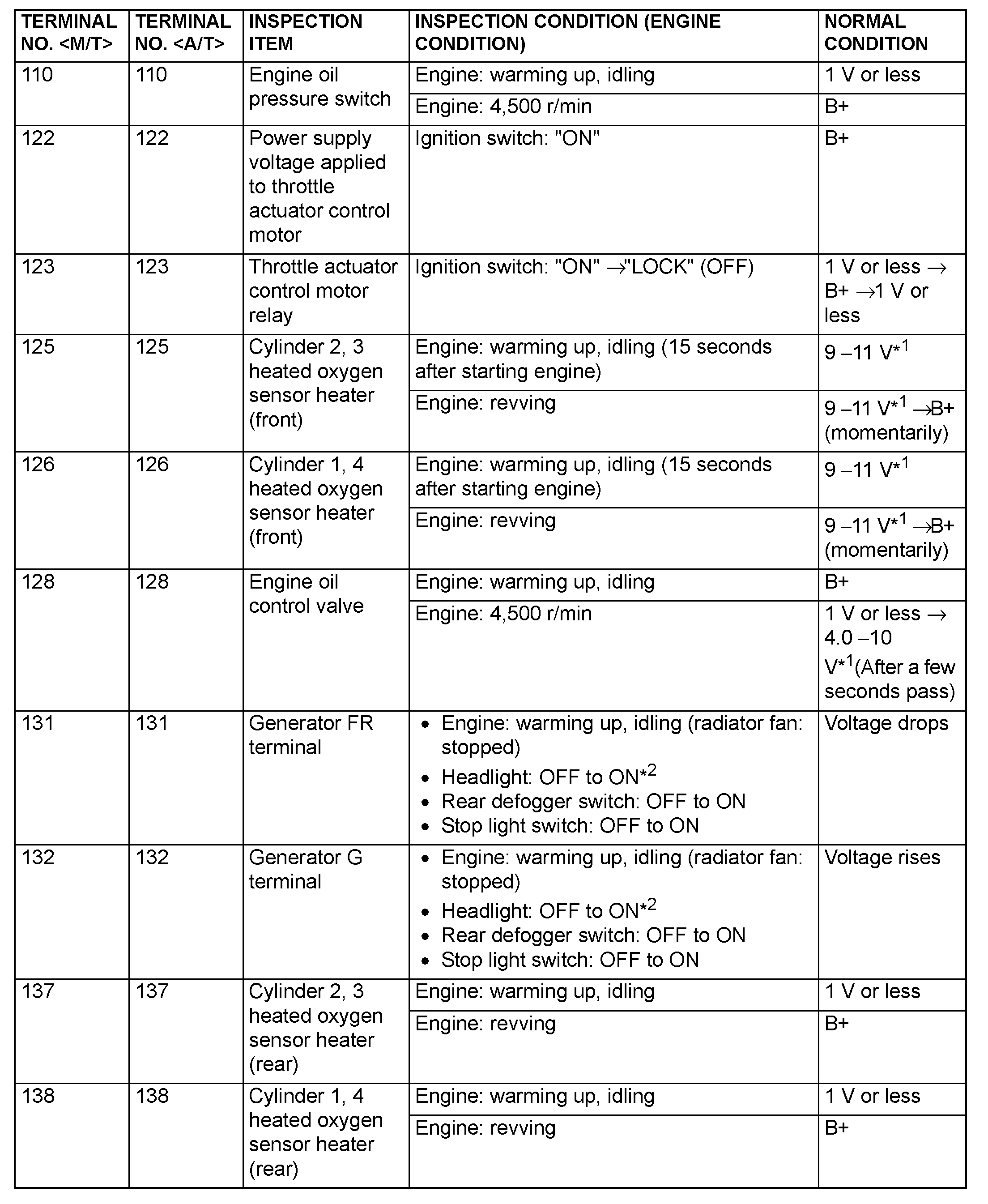

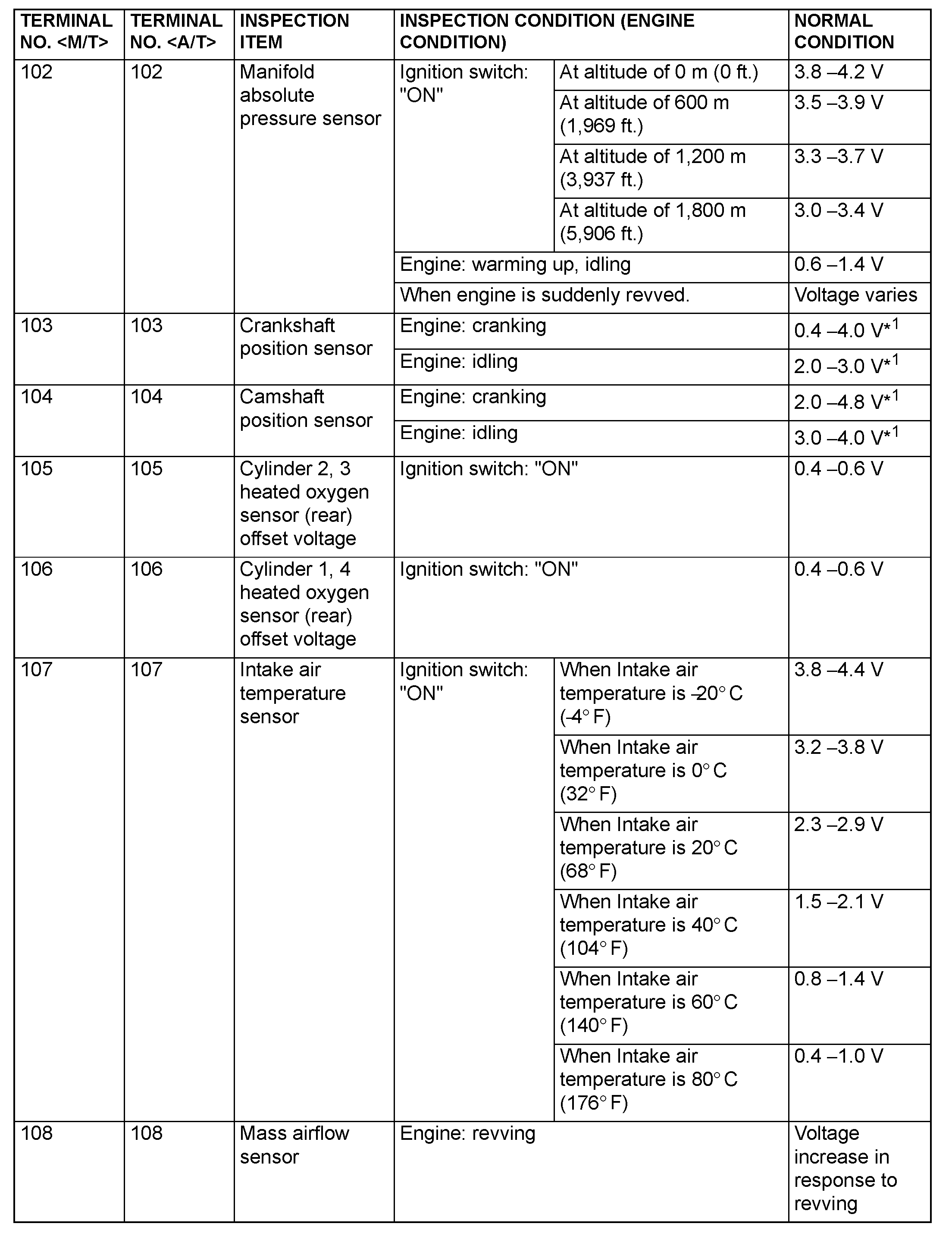

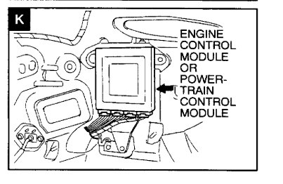

I noted you are looking for connector info related to the ECM. My manual shows a five connector ECM. The last pics are related to and the 5 connector. It shows terminal voltages.

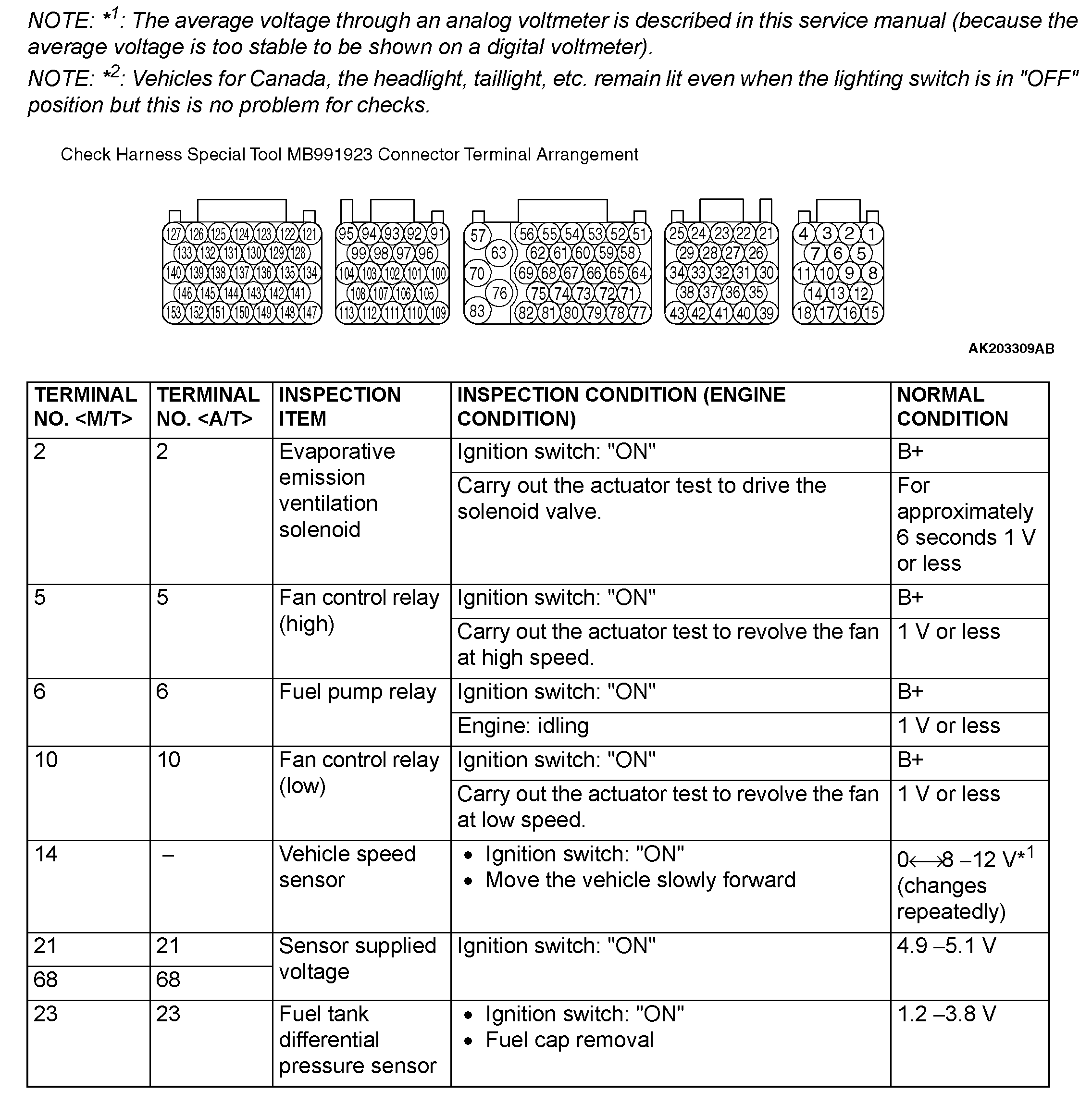

Terminal Voltage Check
Vehicle Power-train Management Relays and Modules - Power-train Management Relays and Modules - Computers and Control Systems Engine Control Module Testing and Inspection Pinout Values and Diagnostic Parameters Terminal Voltage Check
TERMINAL VOLTAGE CHECK
CHECK AT THE ENGINE CONTROL MODULE (ECU) OR THE POWER-TRAIN CONTROL MODULE (PCM)

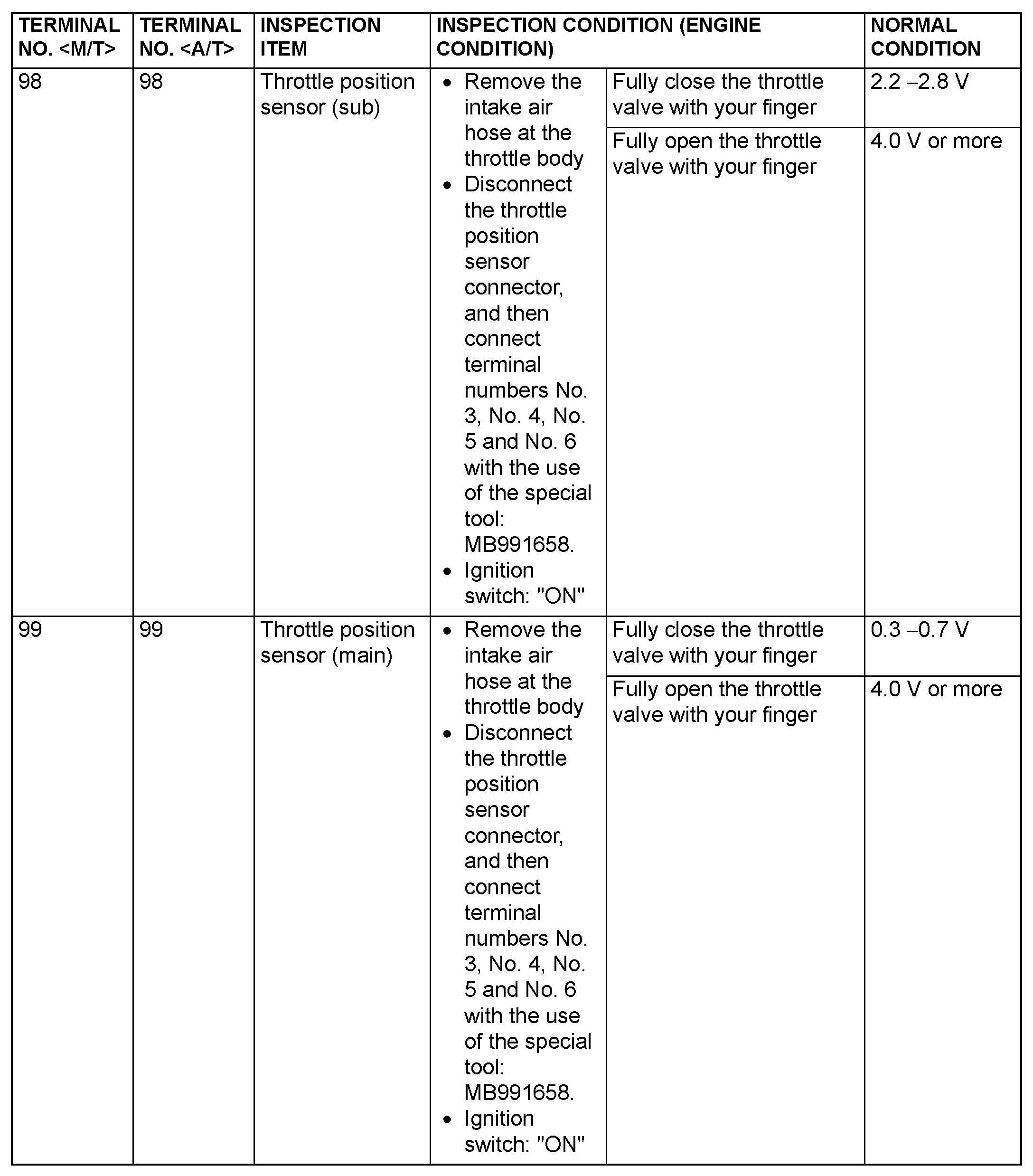

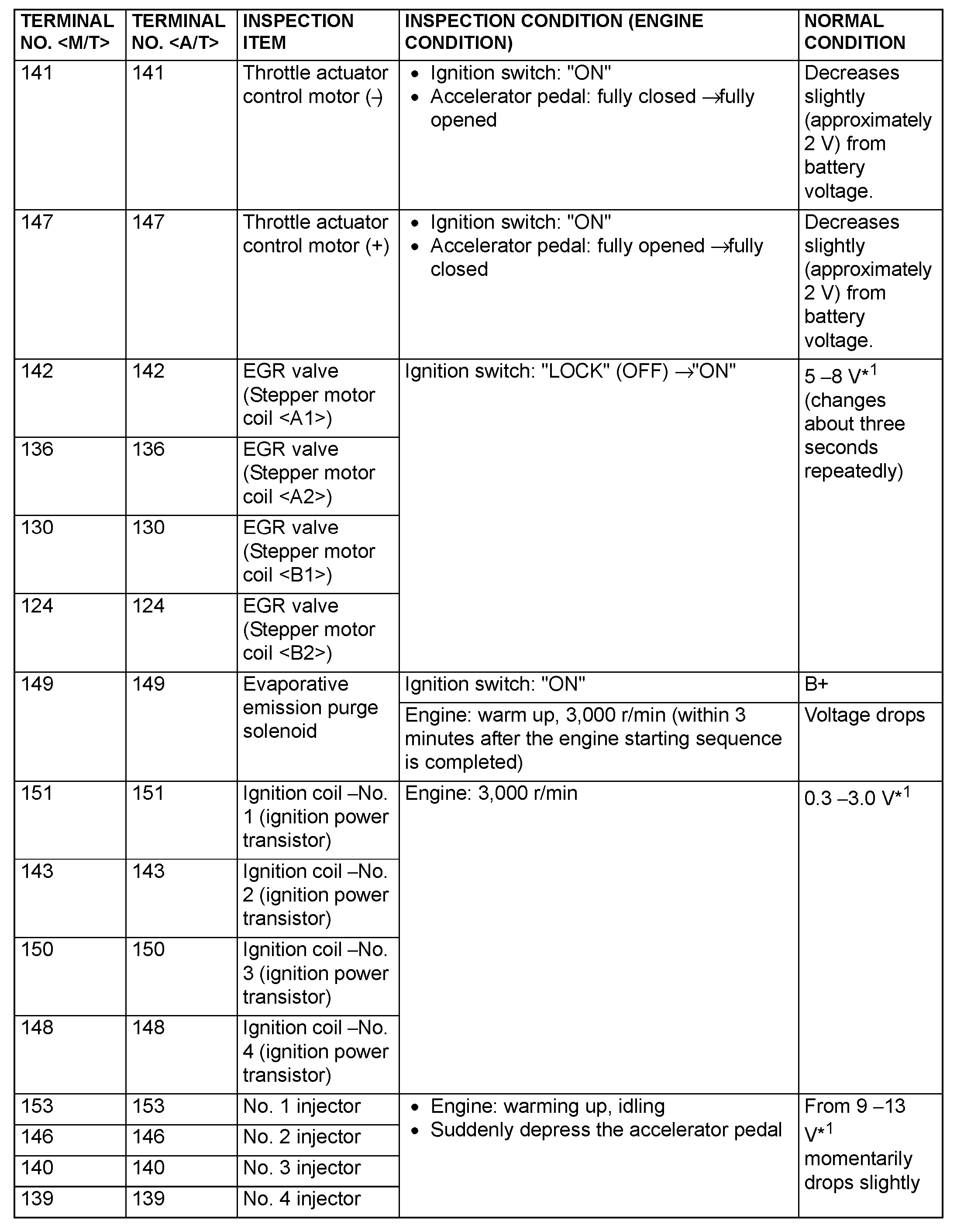

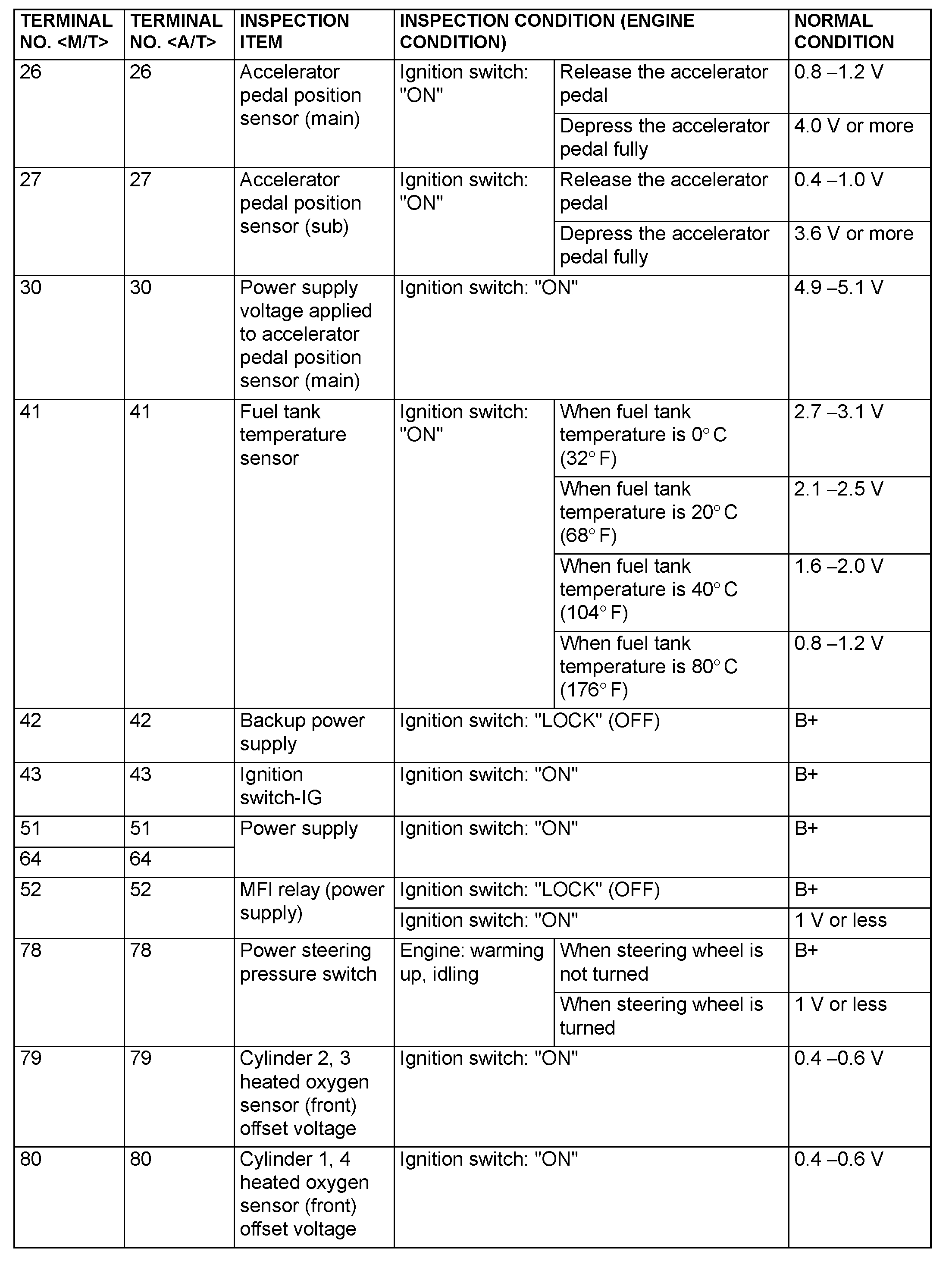

1. Disconnect the ECM or the PCM connectors B-18, B-19, B-20, B-21 and B-22, and connect check harness special tool MB991923 between the ECM connectors or the PCM connectors.
2. Measure the voltage between each check harness connector terminal and check harness connector ground terminal (No. 25 or No. 29).
Check Harness Special Tool MB991923 Connector Terminal Arrangement Part 1
Pic 11
Check Harness Special Tool MB991923 Connector Terminal Arrangement Part 2
pic 12
Check Harness Special Tool MB991923 Connector Terminal Arrangement Part 3
pic 13
Check Harness Special Tool MB991923 Connector Terminal Arrangement Part 4
pic 14
Check Harness Special Tool MB991923 Connector Terminal Arrangement Part 5
pic 15
Check Harness Special Tool MB991923 Connector Terminal Arrangement Part 6
pic16
Check Harness Special Tool MB991923 Connector Terminal Arrangement Part 7
pic 17
TERMINAL VOLTAGE CHECK CHART
_______________________-
Pic 18 shows the ECM I have in the manual.

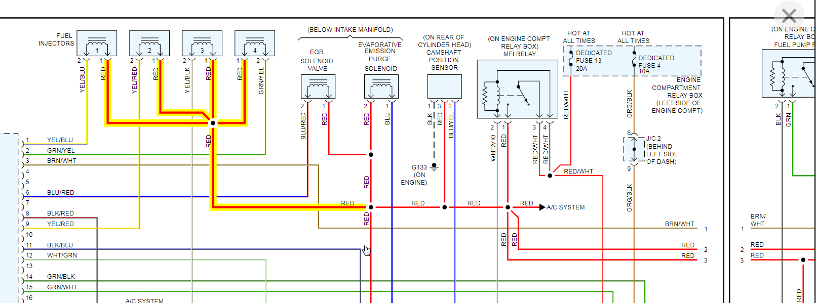

My problem is no spark no injector pulse. I tested my coils and have 12 volts on the lead and -.4 on the signal. I made the dumb move of replacing anything related to spark(ckp,cmp,ecu,fuses and relays checked,harness checked, coolant sensor) Now I found a frayed wire on the right side of the head that runs with the wire going to the O2 sensor, the wire DOES NOT go to the sensor tho. I cannot find where this wire broke from the wires a bare wire wrapped in a copper foil jacket then is wrapped but the plastic around the o2sensor wires. I believe its a ground but dont wanna go putting it anywhere, does anyone know what this wire is or know what my problem is??????????????
Oct 20, 2020 at 5:28 AM (Merged)
MERLIN2021
  • 17,250 POSTS
Copper foils are usually radio antenna wires, how is the reception? Can you scan for codes? These guides can help us fix it

If thats now fixed, injectors are working?
HATESMITSUBISHI
  • 6 POSTS
no I have no injector pulse, but have good fuel pressure to the rail

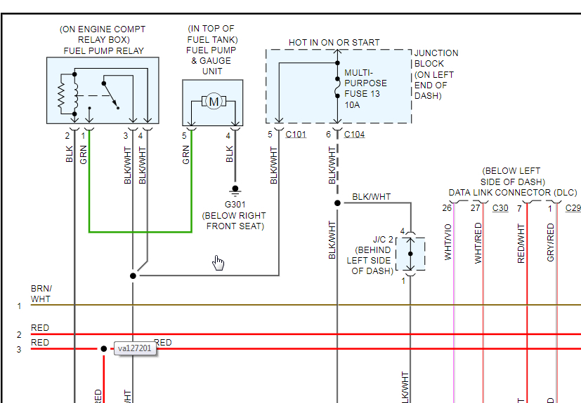

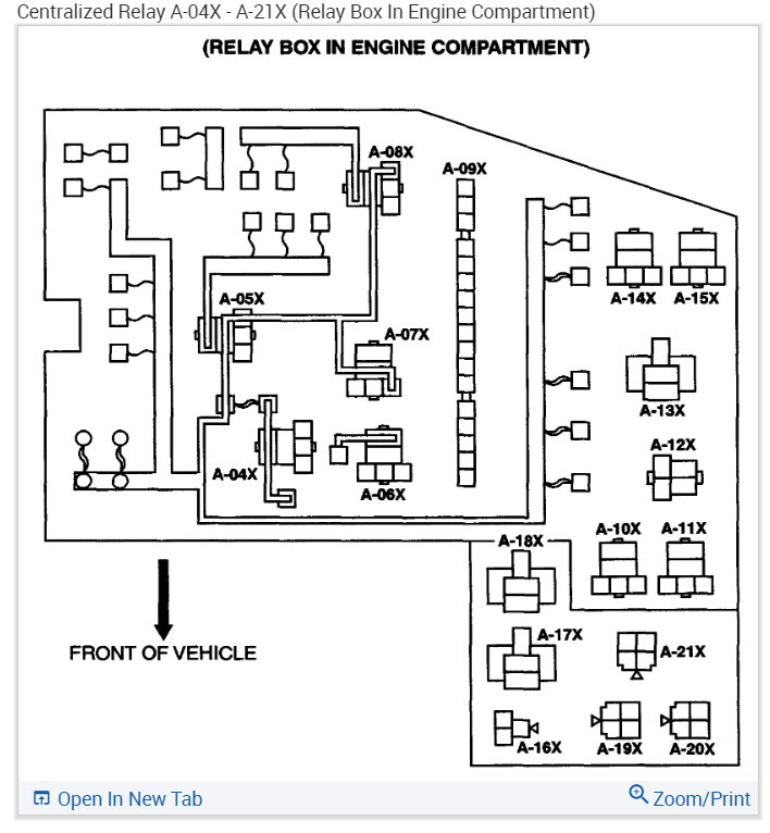

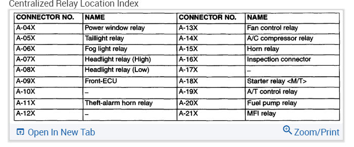

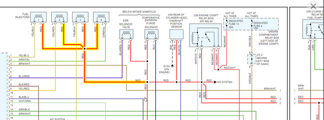

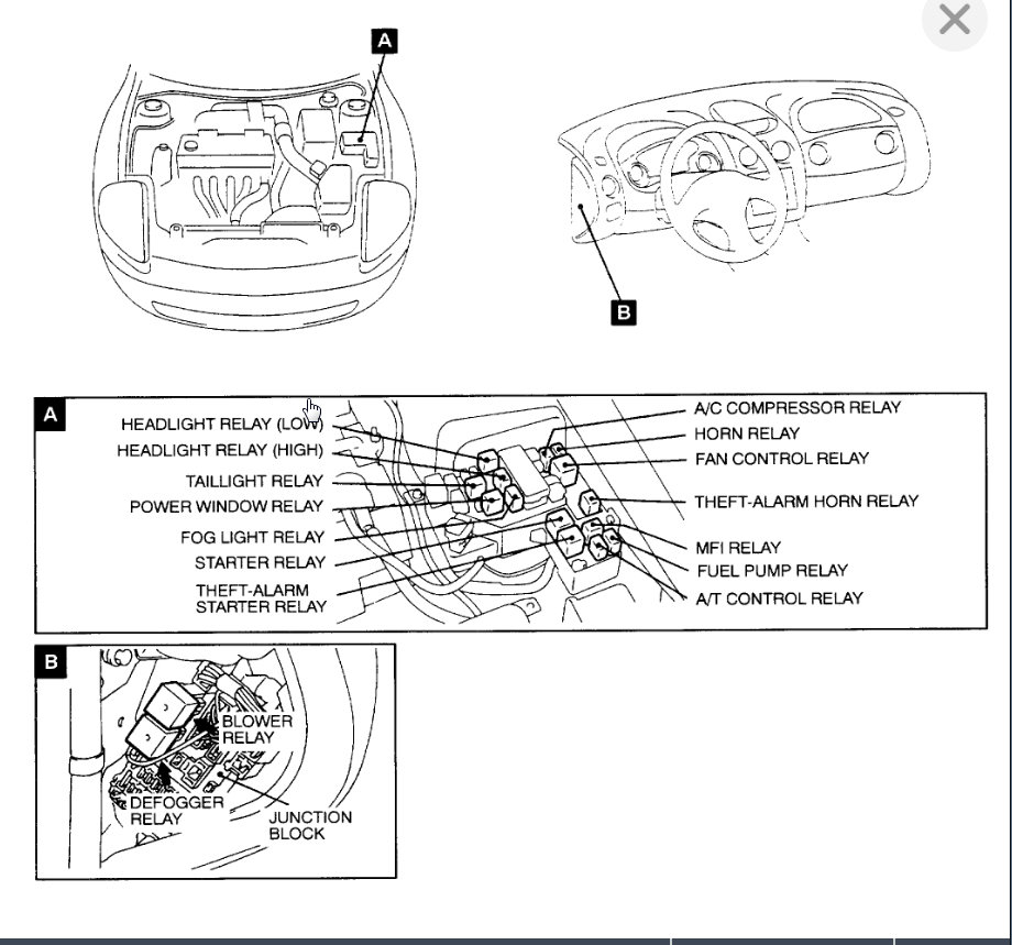

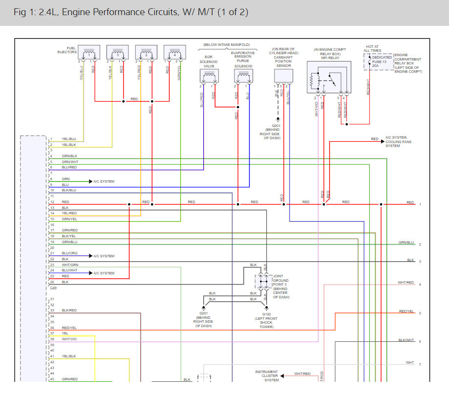

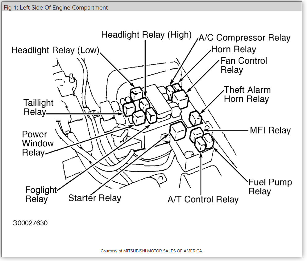

I have a 2001 Mitsubishi eclipse gt v6 3.0 and well my car won't spark, it cranks but that's about it. I think it's the ignition distributor, I check it and the rotor was burned I changed it but still no spark, they tell me to change the module but I can't find it, only the whole distributor complete.
Oct 20, 2020 at 5:29 AM (Merged)
  • 75,992 POSTS

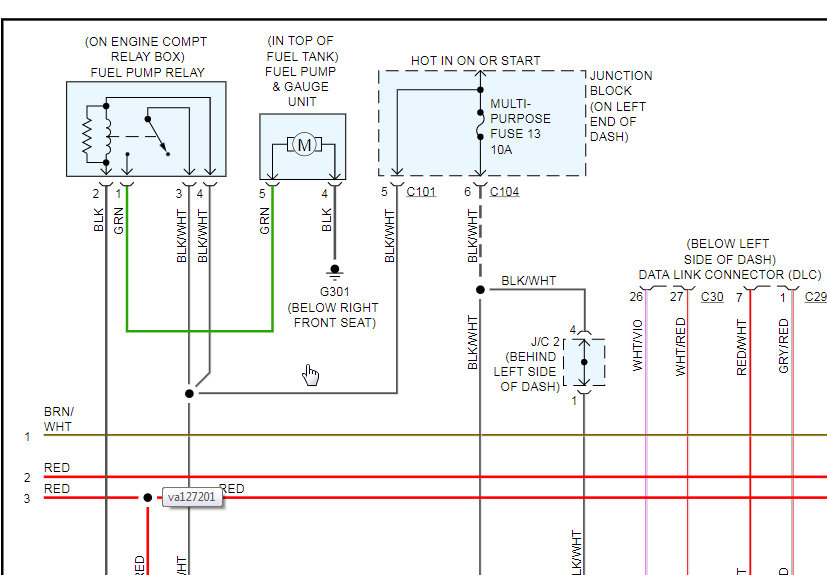

This sounds like the MFI relay is not working here is a guide to help you confirm and the location of the relay below.
Check out the diagrams (Below). Please let us know what you find. We are interested to see what it is.
JASONNGARCIA
It has a rotor that would be the problem it's activating the ignition turning it over in the ignition system but no spark out of distributor
XXLV2NYXX
Thank you for this post, I changed out the relay and it fired right up, I love this site!

At first the car was getting no spark and no fuel, so I used a code reader and showed a bad crank sensor. I replaced it, still didn’t work so I switched the PCM from my parts car and put it in this car. And now it’s just getting no fuel. The fuel pump is new. It’s not receiving power and also the fuel injectors are not getting power. We were able to start it with starter fluid. And now we’re at a stand still.
Have you verified the fuel pump relay? Clearly the PCM is not energizing the injectors because if you don't have power to them they share a power feed with a number of other components. Please see the attached diagrams.
Let me know if the relay checks out and we can move on. However, if this is no good then the PCM will not energize the injectors so we need to eliminate it. Thanks

Okay. Have you scanned it for codes? We need to find out if the PCM is telling us why it is not turning the fuel on but if not, we need to look into wiring but hopefully we have code because that will make this easier. Thanks
EASTONDIX
  • 7 POSTS
I did show a code (p1610) for an faulty immobilizer. When I switched the pcm I switched the immobilizer and the ignition with it.
Okay. Can I ask how you confirmed there is no fuel so that I don't ask you to do something that you have already done?
EASTONDIX
  • 7 POSTS
Used a test light on the fuel injectors connections and also listened for fuel pump to prime itself and didn’t hear anything.
Okay. So that normally happens when the PCM is not commanding them on. What was the original concern or how did this all start? Was the car sitting for a while? Did you just buy it with no spark and fuel? Was the car running and then just stopped? I am just trying to wrap my head around what COULD have happened so we can start testing those theories rather than just running around any possible cause. Thanks

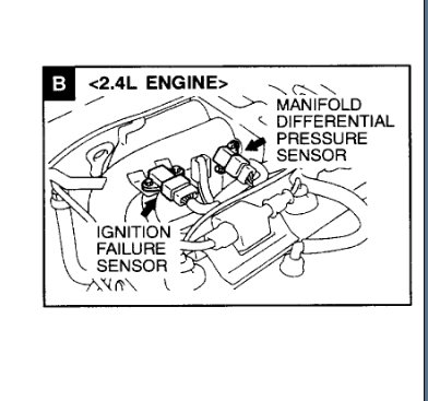

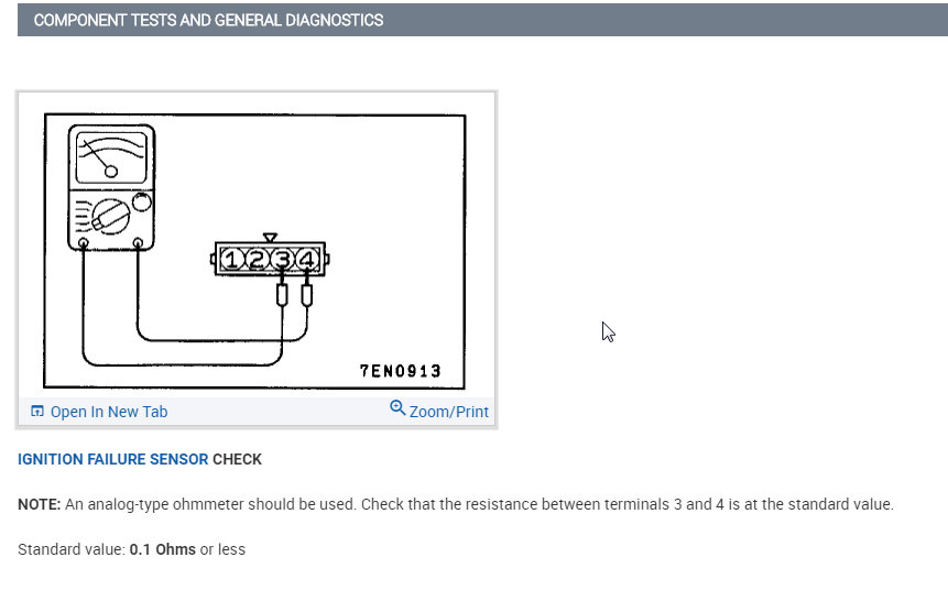

Okay. We need to check the ignition failure sensor. This can prevent the injectors from firing.
As for the other issues with the gauges, that doesn't seem to correlate with this issue. The ECT is a direct feed to the combination meter (cluster) and so is the speed sensor. This would indicate the cluster is the issue but let's try to figure out the no start first and if it fixes the others, great. If not, we can readdress those.
Here is another post that is similar:
https://www.2carpros.com/questions/mitsubishi-eclipse-2000-mitsubishi-eclipse-no-pulse-to-fuel-injectors
EASTONDIX
  • 7 POSTS
The ignition failure sensor checks out good.
Okay. What I cannot connect is what would disable the fuel pump and injectors. However, I just thought when you used a test light to see if the injectors were pulsing did you put the clamp end of the test light on ground or the positive battery post? When checking your power wiring at one of the injectors, you test for power with key on and the clamp on negative battery. When testing for control, you need to crank the engine and probe the other wire on the connector with the clamp on positive. The PCM is ground side control and you need to supply power in order to see if the PCM is grounding it.
This is done incorrect all the time so I just want to make sure. If we are getting injector pulses then we are just dealing with a fuel supply issue rather than a larger control issue.
This would make more sense since it is running on starter fluid.

Okay, I bought the car listed above 5 speed with this no spark issue I didn't get really any details for the kid I bought it from because it had been through several owners since it stopped running. but I was banking on it being crankshaft position sensor. so I tow the car home and when I'm taking it apart I get to where the crank sensor wire goes down between the metal bracket and the engine block I find that the 3 wires have been pinched and split open and where all 3 shorting to each other. so I thought for sure that's where the problem was. but since then I've changed the crank sensor, cam sensor, coil packs plugs, and wires. Still no spark and checked all fuses repeatedly, but I still have no spark. engine just cranks. I hooked up a obd2 and it give a code for bad EGR valve that's it. any ideas of what to try next would be greatly appreciated.
  • 55,394 POSTS
It either sounds like the wiring still might be messed up or you have a MFI relay that is not working. here is the engine wiring diagrams and a guide to help you check the connection and to help test the relay with the relay location below:
and
JASON EDDY
Thanks for your answer and diagrams but honestly I've hit a side wall with this no spark issue. I mean I'm not new to working on cars by any means but when it comes to electrical wire chasing issues or relays to figure out the no spark issue I'm just not the guy for that. so anyway this Mitsubishi eclipse is a 2000 2.4 gs manual transmission the engine has good compression in all cylinders. I just can't figure out this spark issue so my new question for you is. I have another 2002 Eclipse 2.4 gs automatic transmission that the engine needs a lot work head gasket, balance shaft belt broke ,has something ticking in the engine anyway that all being said I need a car so is it possible for me to just pull the engine out of the 2000 eclipse gs 2.4 (engine has good compression just no spark) and put the engine in the 2002 eclipse gs 2.4 and (this car runs but needs engine replaced so with swapping engines. my no spark issue should be gone; so swapping the engine out makes sense to me so other than having to use the original intake manifold off the 2002 Eclipse everything else looks to be identical so can I do the swap. I'm really sorry for the long story I was just trying to give as much information of the problem and my ideas of getting a vehicle running. I live in the Pacific Northwest it rains 9 moths out of the year. any input is greatly appreciated. thank you
  • 55,394 POSTS
The no spark will follow the car so a new engine probably won't work. If you have repaired the wiring and the sensor is good with the MFI relay in working order the PCM could have gone bad due to the shorted wiring. Here is how you replace the PCM in the diagrams below. Check out the diagrams (below). Please run this test and get back to us.
