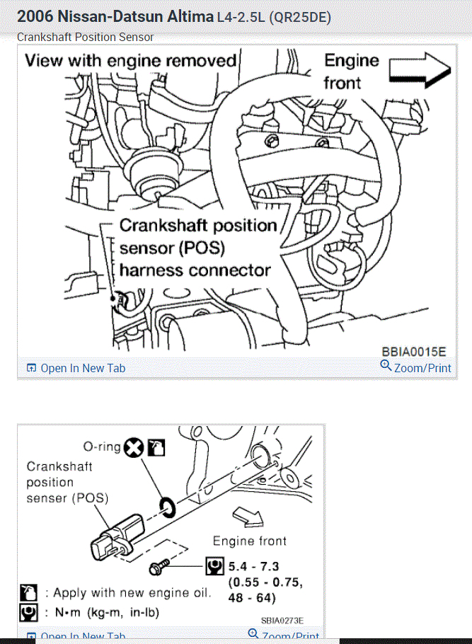

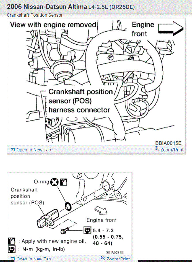

I have the car listed above it ran hot turned the car off, went back later after it cooled to add water cranked the car only ran for a second. now have no spark, will not start. The motor doesn't seem to be turning fast enough. what can be wrong? Help please have been doing everything that I know how.
Jun 2, 2021 at 8:28 AM
  • 110,194 POSTS
How badly did the engine overheat? Is it possible for you to record it cranking and upload it for me to hear?
As far as the no spark issue, the most common cause is a faulty crankshaft position sensor (CKP). If you have a tachometer in the vehicle, see if it moves at all while cranking. Also, if you have a live data scan tool, you can check to see if there is an RPM signal.
If there is no RPM signal or the tachometer doesn't show movement, this is the likely cause.
Here is a link that explains what a CKP is and how it works. I thought it may be of interest to you.
https://www.2carpros.com/articles/how-a-crank-shaft-angle-sensor-works
Also, I attached a pic of its location on your vehicle below.
If you determine there is no signal from the sensor, here is a link that explains how in general one is replaced. It will be a good reference for you.
Let me know what you find or if you have other questions. If possible, record it cranking so I can hear it. If the engine was hot enough, you may have blown a head gasket as well.
See pic below.

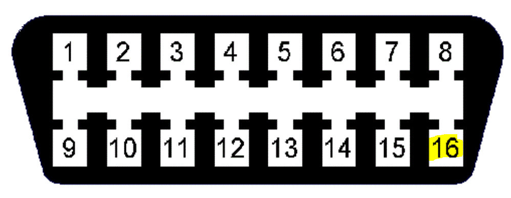

Now the computer won't communicate with my scanner I can't get any codes. is the car's computer bad? was getting some codes couple of days ago.
Jun 2, 2021 at 6:26 PM
  • 110,194 POSTS
Do you remember what codes were present? Also, does the scanner power up normally?
If you look at the pic below, it shows the DLC. I highlighted pin 16. That pin should have 12v at all times. Check for power.
Pin 4 is chassis ground, so check it for continuity to ground.
Let me know what you find.
