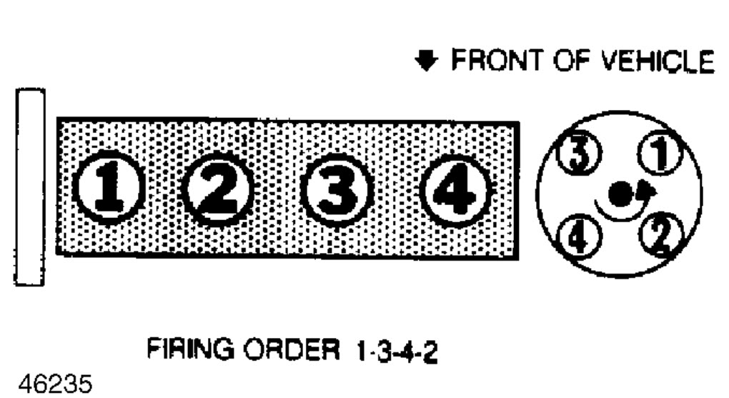

I bought a new distributor for my car and I made a mistake. I took the spark plug wires of the top of the distributor and i cannot remember how they were on. I need a step by step or a picture to help.

See picture. He is a great tip; next time use your cell phone and take a picture before you begin the repair that way you have it for reference when putting things back together.
