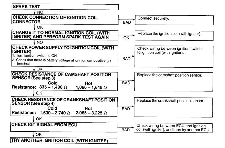

Just replaced motor, turns over will not start. No spark.
Oct 3, 2018 at 3:39 PM
Good morning.
Below are the tests for no spark condition.
The igniter is a common failure for this issue.
On-vehicle inspection
Note: "Cold" and "Hot" In these sentences express the temperature of the coils themselves. "Cold" is from -10 °C (14°F) to 50 °C (122 °F) and "Hot" is from 50 °C (122 °F) to 100 °C (212 °F).
Inspect ignition coil (with igniter) and spark test
Check that the spark occurs.
1. Remove the ignition coils (with igniter).
2. Using a 16 mm (0.63 in.) plug wrench, remove the spark plugs.
3. Install the spark plugs to each ignition coils (with igniter), and connect the ignition coil connectors.
4. Disconnect the 4 injector connectors.
5. Ground the spark plugs.
6. Check if spark occurs while engine is being cranked.
NOTE: To prevent gasoline from being injected from injectors during this test, crank the engine for no more than 5 - 10 seconds at time.
If the spark does not occur, do the test as follows:
7. Using a 16 mm (0.63 in.) plug wrench, install the spark plugs.
Torque: 18 Nm (184 kg.cm, 13 ft.lb)
8. Install the ignition coils (with igniter).
