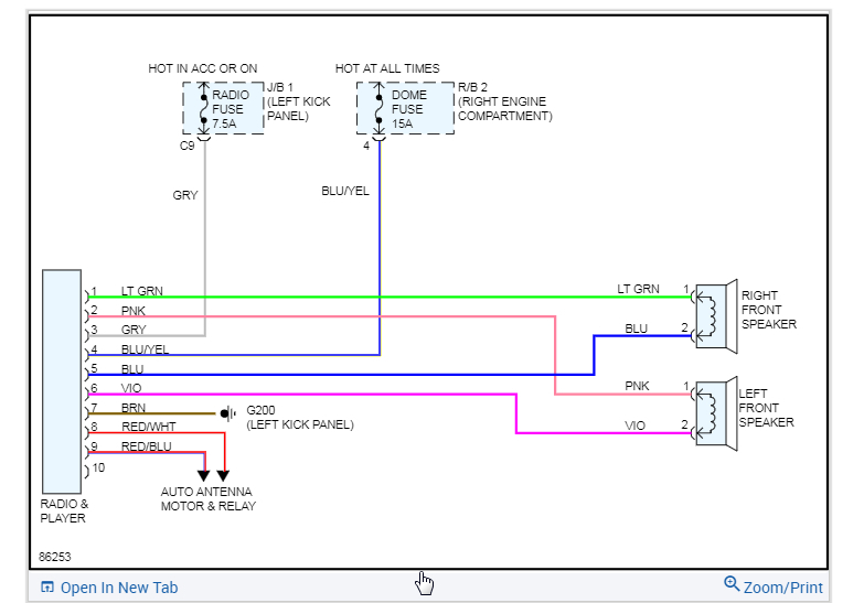

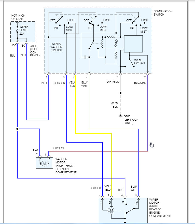

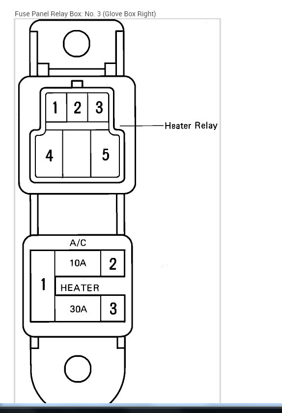

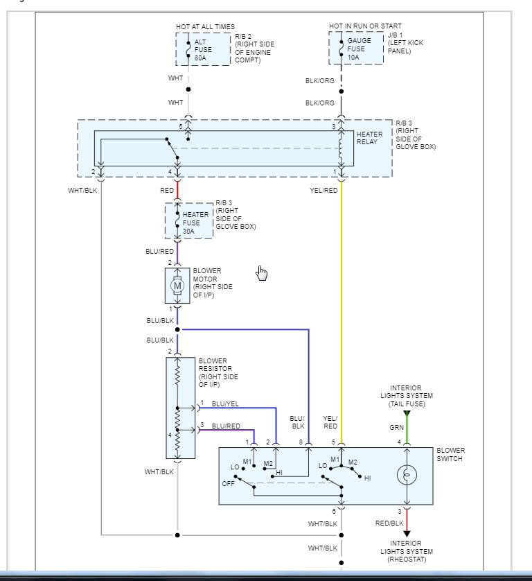

I got my truck jumped, I don't know if it's related? My wipers, radio and AC/heat will not work? Check the fuse? And the lighter never worked.
Aug 12, 2020 at 1:26 AM

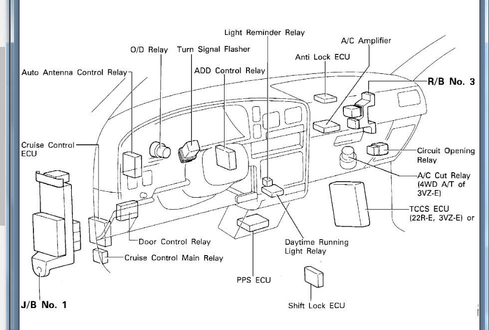

Looks like you may have a couple fuse issues. These systems have separate fuses so we need to check them and make sure they are okay. They are all located in the junction box 1 so let's check there first.
