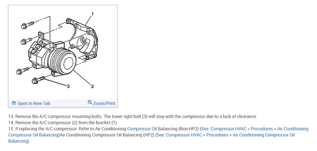

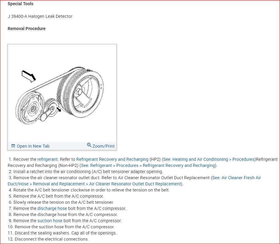

Intermittently cold air will blow for a few minutes. I check Freon and low side reads avg around 50 and high side does not read. I have tried to add Freon and it seems to be full. The compressor does cycle off and on. I evacuated the system and pulled a vacuum on the system and it held 28 for over 12 hours.
May 11, 2019 at 9:54 PM
  • 55,423 POSTS

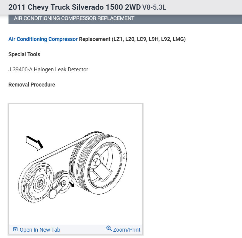

If the compressor runs with refrigerant inside and does not build pressure the compressor has gone bad here is a guide to help walk you through the steps of replacing the it and recharging the system with diagrams below to show you on your truck.
https://www.2carpros.com/articles/replace-air-conditioner-compressor

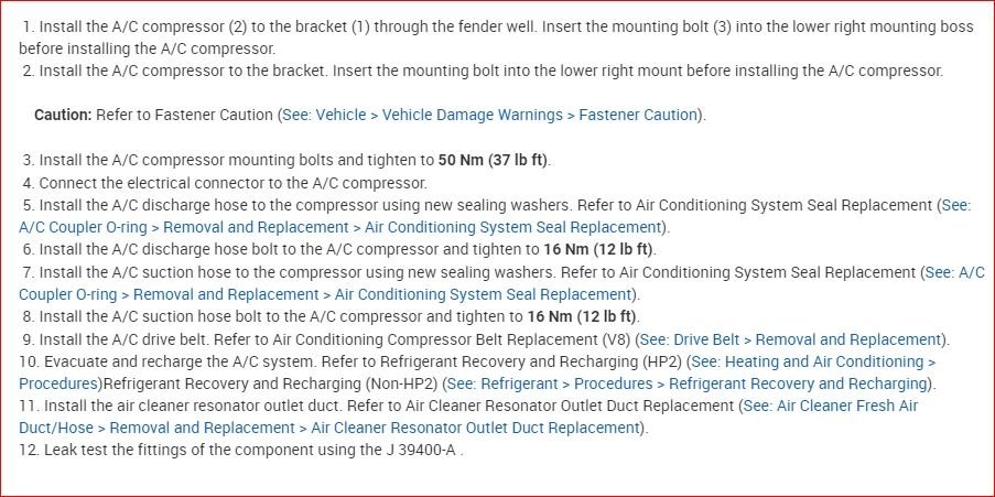

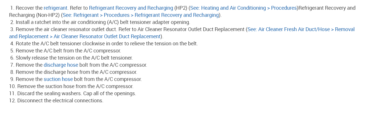

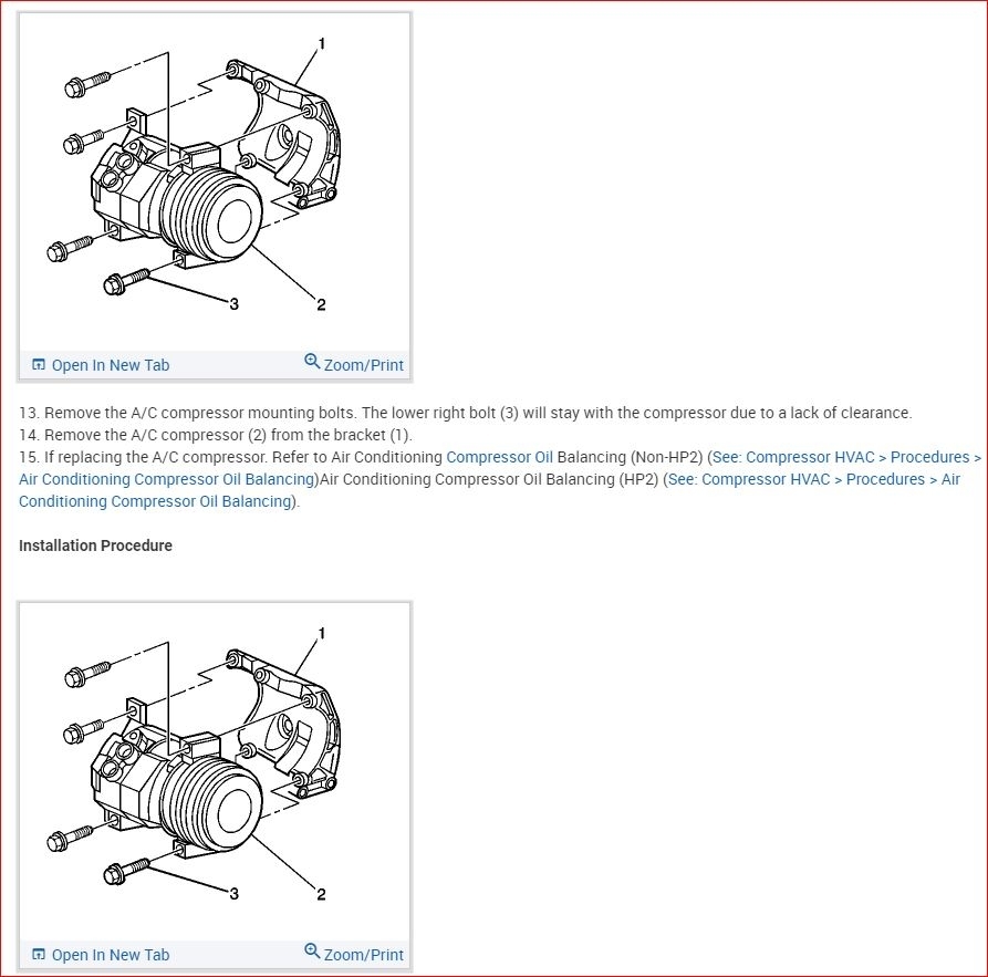

Hi Cmangum,

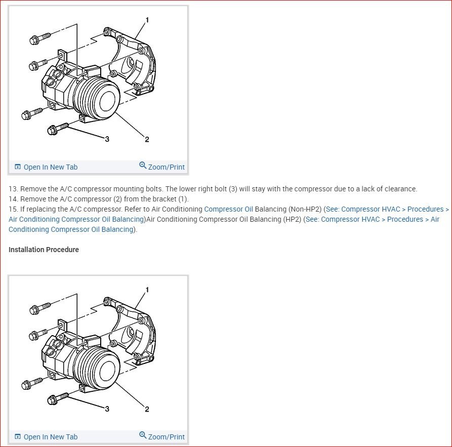

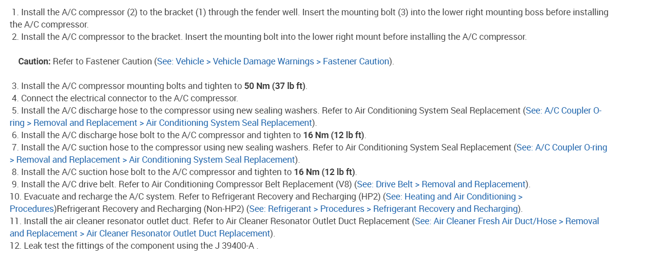

More than likely your high gauge is reading a very small amount of pressure but due to it being a higher pressure gauge it looks like it is not reading. If you have pressure on the low side, you will have some amount of pressure on the high side. More than likely it is pretty close to being even pressure on low and high side which basically means you compressor is not building pressure. The fact that you pulled it down and it held a vacuum shows there is no leak but the compressor itself is not building pressure. Any time the compressor is cycling but no pressure is building, it typically means the compressor is not doing anything but spinning. There is a slim chance that you have a complete restriction but that normally always presents itself as a very high pressure on the high side.
I included the procedure to replace the compressor because based on this info, that is the direction it appears to be going.
Let me know if I am missing something or didn't understand what your issue is. Thanks

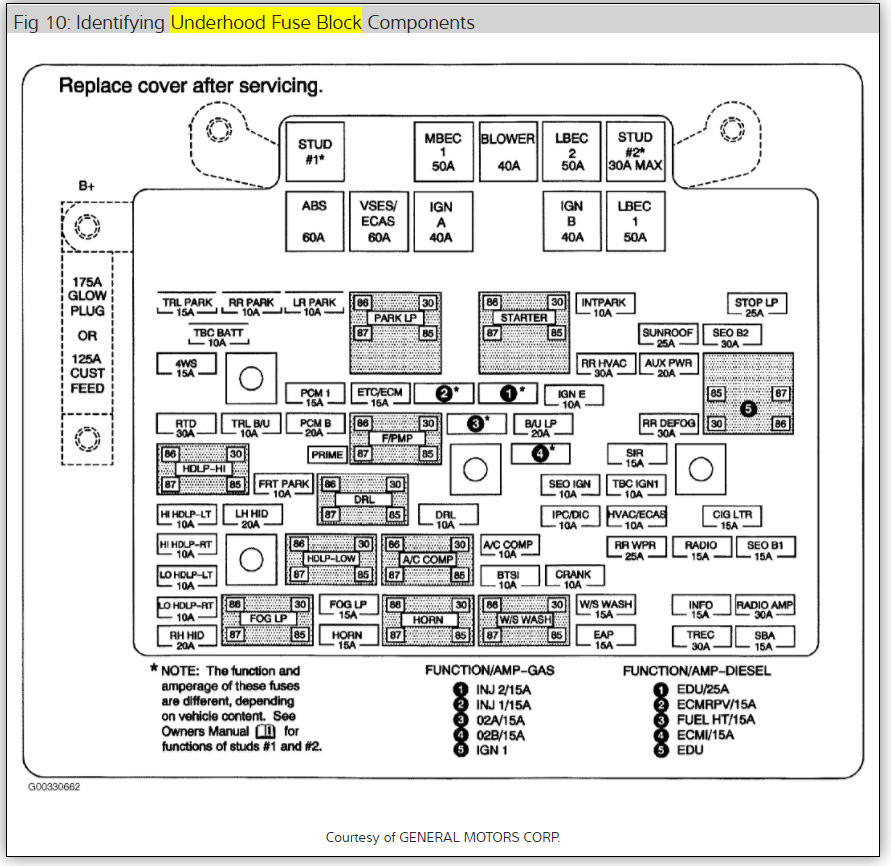

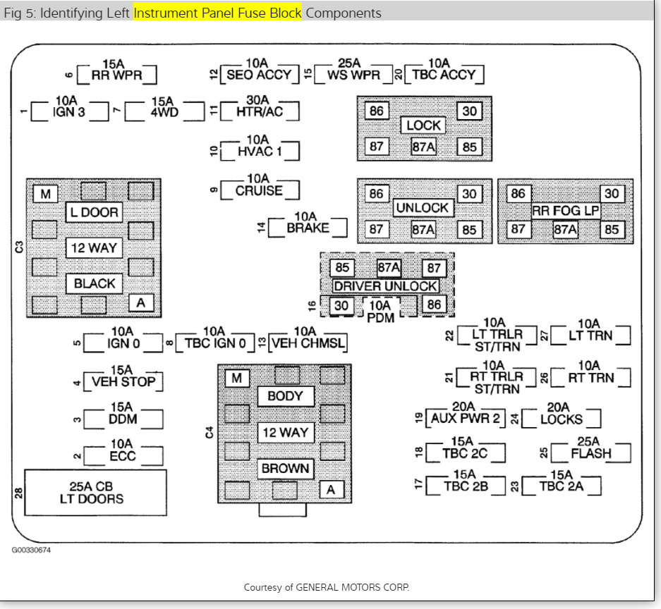

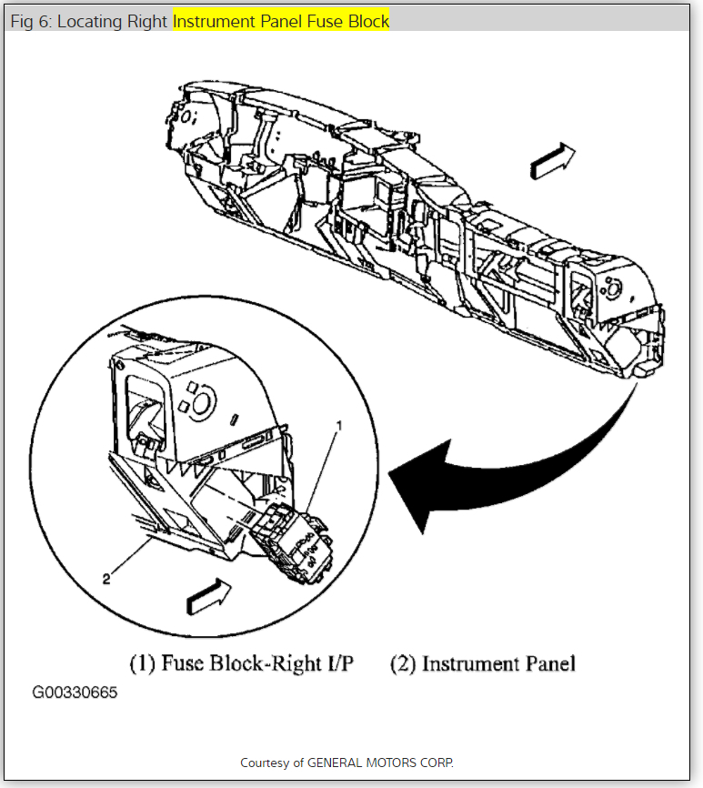

I have auto climate control and AC will not turn on, can't get compressor clutch to engage. I have tested and replaced relay and fuses, tested low pressure switch, jumper switch. system is charged and ready. Not getting any power to the compressor. I do have issues with the ambient temperature on the mirror, it goes up while driving to about 30 or 40F higher than actual if that is in any way relevant to the situation. I've tested voltage at connection on top of compressor 0v running and not running.
Apr 30, 2021 at 6:23 AM (Merged)
WRENCHTECH
  • 20,761 POSTS
It sounds like the compressor is out the relay is not working here are two guides to help us see whats wrong and how to fix it.
and
Check out the diagrams (Below). Please let us know what you find. We are interested to see what it is.

AC was working great, then over a period of a week or so diminished until now it just blows hot air. The compressor cycles off and on when I turn the air on, it will run for about three or four seconds, then off for about ten or twelve seconds. Over and over. Everyone says it is out of refrigerant, but I am not so sure.
Apr 30, 2021 at 6:24 AM (Merged)

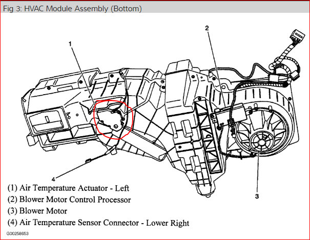

DANNY L
  • 5,648 POSTS
Hello, I am Danny.
It sounds like you might be having a problem with the air temperature actuator. It is located on the HVAC unit under the dashboard. It is an electric motor that controls air flow through a door using different ducts. I have attached a picture (circled in red) and tutorial on how to replace. Hope this helps and feel free to ask any questions if needed. Thanks for using 2Carpros.

NBATES50
That would be a blending issue would it not? I watched the AC compressor while my wife turned it on. It will run a few seconds, then kick out for eight to ten seconds. The compressor clutch will cycle on and off like that until you turn the AC off.
There is one other issue I forgot to mention. This started about the time the AC started going out. Sometimes, especially with the fan set to high, it will just stop blowing. Several seconds later, it will come back on by itself and start blowing again. It will do that even with the AC off and just set to "blow air". Does not do it all the time though.
I hate to spend $40.00 on a can of gas just to have access to a gauge to check the gas level, but I will almost bet it is full of gas. I tend to believe it is an electrical problem. Maybe the relay for the AC? Maybe it is weak and will not hold a latch when energized, and will keep trying, but just cannot hold a latch "on". I will attempt to find the AC relay and test it. I will sure do that before buying a can of gas.
Thanks

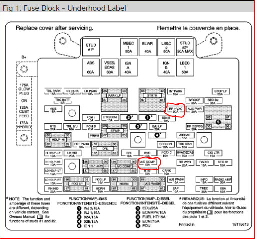

DANNY L
  • 5,648 POSTS
Hello again.
Okay, I have attached a picture and circled in ted two locations to check. I have also attached a link to show how to test a relay. Hope this helps and thanks again for using 2CarPros.
Danny-
