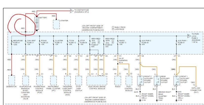

I have no power when turning the key after doing an alternator change and also a big 3 upgrade.

The big 3 upgrade is upgrading the 3 main charging wires. And there is absolutely no power.
Sep 29, 2019 at 12:44 PM
  • 110,244 POSTS
Welcome back:
If you have nothing, either you lost power to the under hood fuse panel or ground. Something should work even if the alternator was replaced. See pic 1 and 2. Since nothing is working, this is where I would start.
Sep 29, 2019 at 1:04 PM
SANTIABEYTA1266
  • 15 POSTS
Thank you so much man!!! I think you narrowed down the problem good enough to solve it. Thanks again!

It was the wire you were talking about. Can I ask one more question?

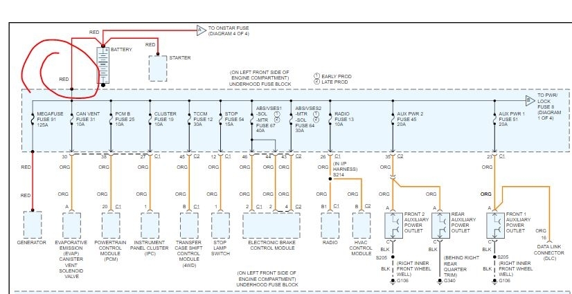

No sir it is related. I was just wondering how to tell if the megafuse is bad?
Sep 30, 2019 at 1:55 PM
  • 110,244 POSTS
Welcome back:
What to do is check for power at both ends of the fuse. If there is power only at one side, remove the fuse and check it for continuity. Here is a link that explains how to check one:

My megafuse was out. Replacing it solved the problem.

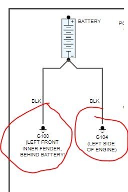

If the battery is good, I need you to confirm there are no loose or corroded terminals on or from the battery. When you say the lights dim or go out, that is either a weak battery as Ken mentioned, a loose or corroded connection, the starter is bad, or the engine is locked and the starter can't turn it.
What I need you to do is check if there is power to the starter. On the starter you will have a large wire straight from the battery positive. Is should have 12v all the time. There will also be a smaller wire which only gets power when the key is in the start position. I need you to confirm that is what is happening. If it is getting power, remove the starter and have it bench tested. Most parts stores will do it for free with hopes of selling a new starter. If it passes the bench test, see if you can turn the engine at the crankshaft using a socket and breaker bar to confirm it can turn.

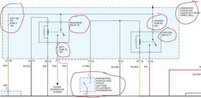

Also, I attached a portion of the starting system schematic. I circled thing I need you to check.
Let me know what you find.
Nov 3, 2019 at 9:13 AM
SANTIABEYTA1266
  • 15 POSTS
There is a constant power to the starter but no power to the smaller terminal when turning the key.
Nov 3, 2019 at 9:14 AM
  • 110,244 POSTS
Welcome back:
We now need to back track. Have you checked the fuses and relays I mentioned?

If there is another relay in the box with the same part number, switch them. Or, here is a link that shows how it's done:

Okay, I am so sorry I took so long. The relays seem to be good. I switched them out and still nothing. Also a correction to the lights thing, the lights turn completely off for like a second and go back on instantly after. I also really don't know how to check the neutral safety switch.

No problem on the delay. If the lights go out and then come back on, it isn't the safety switch. Something is causing a power loss. Most commonly a bad ground at the engine or at the battery. Are you certain the starter isn't getting power via the smaller wire connected to the S terminal on the starter? It will only get power when the key is in the start position.
