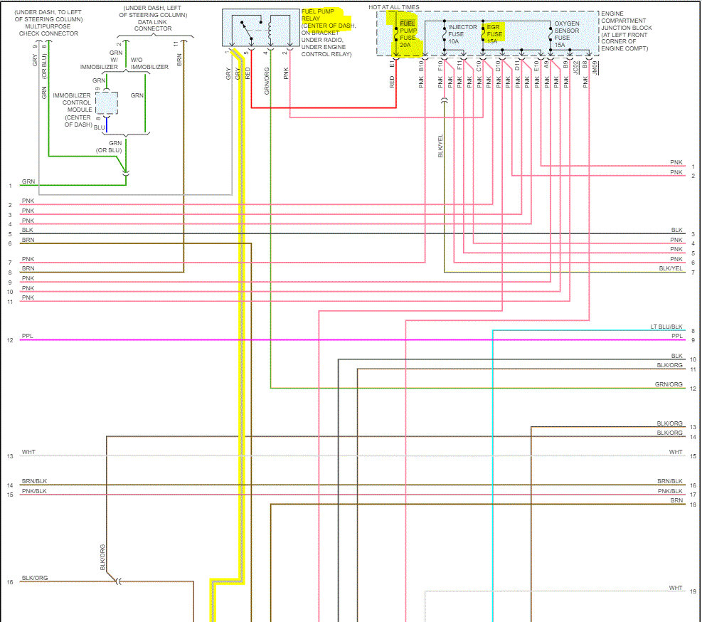

No power to fuel pump
2004 HYUNDAI SONATA
111,546 MILES • 2.7L • 4 CYL • 2WD • AUTOMATIC
TEENA BYERS
I have replaced the fuel pump, fuel filter, camshaft, and crankshaft. it turns over, it does not start. though I don't know what else to look for. what else to check for. I don't know why it's not getting no fuel to the fuel pump. it worked fine never gave me an issue and then I just woke up the next day and it just turned over it wouldn't start. I've been working on this car for 2 months now. I could really use some help. Anything is great. thank you

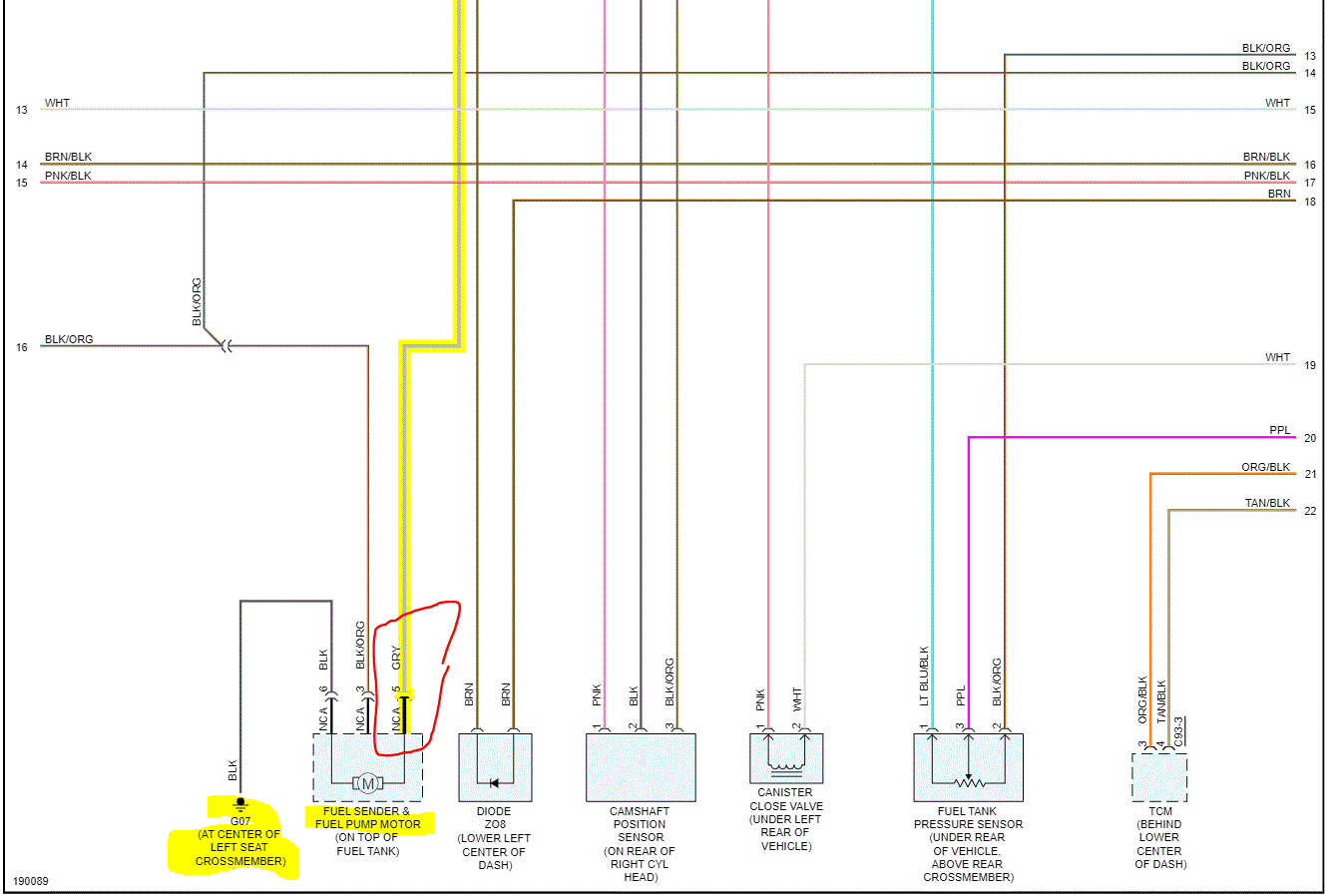

If you are not getting power to the pump, check a few of the basics. First, there are two fuses that must be good and must have power both to them and from them.
In the under-hood fuse panel, locate the fuel pump fuse and the EGR fuse. Make sure they are both good. If they are, confirm they have power to them. Here is a link you may find helpful:
Next, remove the fuel pump relay and switch it with a different one in the box having the same part number. If there isn't one, here is a link explaining how to check a relay:
If everything checks good, I need you to check the gray wire at the fuel pump for power. Power will only be present for a couple of seconds when the key is first turned on, so you will need a helper to turn the key. Here is a link you may find helpful when checking wiring:
If there is power, confirm the black wire, which is ground for the pump, has continuity to ground.
If you have power and ground, the pump (new one) is likely bad.
Let me know what you find. Also, I attached the wiring schematic related to the tests I just reviewed for your reference.
See pics below. Note: I had to cut the schematic in half to make it readable for you. I did overlap the two so you can follow from one to the next.
