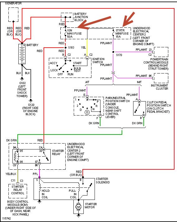

The problem I am having with my car is that I am getting no power to start it. When I turn the key to the on position, the dash cluster does not light up. The radio, headlights, windows, horn, cigarette lighter, and inside lamps all work, but when I turn the key to the on position right before I turn the key to engage the starter, there is no power. I can hear the fuel pump engage, but there is no power to the ignition. I had the headlights turned on while I tried to start the car and the lights did not dim at all. That is telling that there is no power being pulled from the battery to engage the starter. The battery is good. I tested the starter and it is good. I replaced the alternator because it was bad. It will be helpful to know that I had my car running and tried to jump off my riding lawn mower. The symbols for the posts were worn on the mower battery and I ended up putting the cables leading from the car on the wrong posts of the lawn mower, but it was only for a split second. The car continued to run and I did not think anything of it. Once the lawn mower was cranked, I turned the car off and mowed my lawn. When I went to start my car the next day is when I noticed the problem I now have. I bought an ignition relay switch, but I cannot find out where to install it. I have checked the fuses by the driver's side door and under the hood and they are all good. Has anyone experienced this problem also and solved it? If so please help me out here. I really need my car back up and running. Thank you in advance.

It sounds like a starter motor has gone bad, but to be sure let go over this guide to see if it helps.

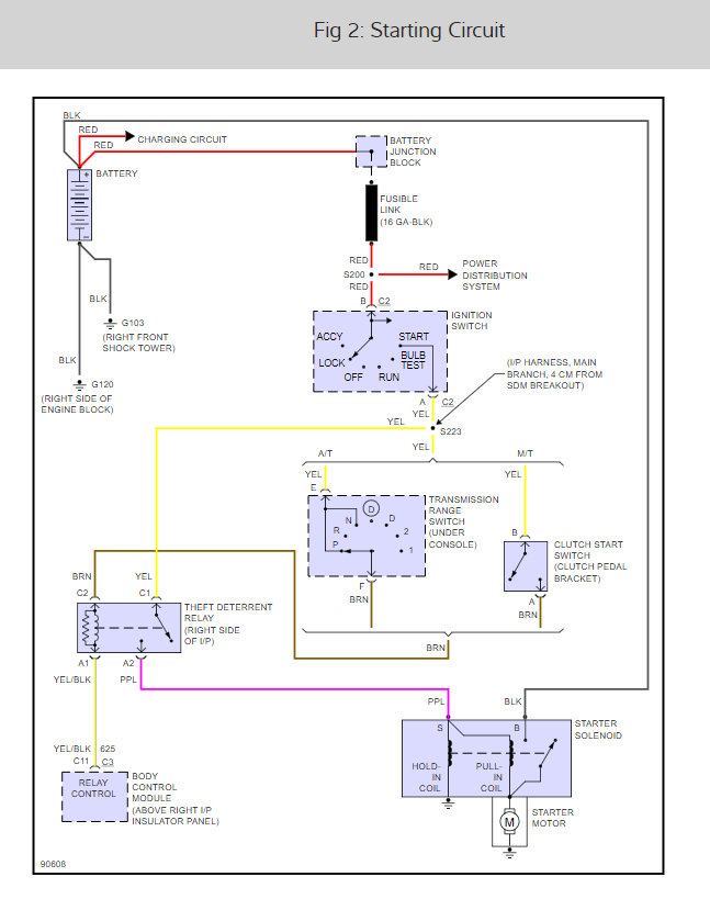

Looking at the diagram it looks like it has a junction block after the battery where the fusible links are on this one, not at the starter. Here is the starter wiring diagrams so you can see how the system works and a guide to help you see where you are losing power.

The power feed for the ignition switch comes directly from the fusible link on the red wire, from there the ignition switch feeds all the "keyed" fuses.

I am accustomed to solving issues on my own and I do not ask for assistance likely, but in this case I need all the help I can get. Just like I am taking your advice and I have never met you. Anyway, this morning I ran a wire straight from the fusible link from the junction box to the under the hood fuse box to the ignition fuse. The car started (as I suspected it would) but it would not turn off. That is a problem. Like I said, all the fusible links from the junction box are good and hot, but the pink wire at the ignition switch is not hot. Between the fusible link at the junction box and the ignition switch there has to be a fuse, relay, or something, because there is no pink ignition wire coming from the fusible links. What does the P100 symbol mean on the diagram you posted? The diagram is accurate, but that P100 could be exactly where my problem lies. Thank you so much for your help so far. I am confident you can help me pin point exactly where the open circuit is in my ignition system.

P100 is the bulkhead connector at the firewall.

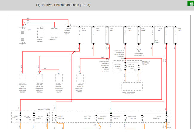

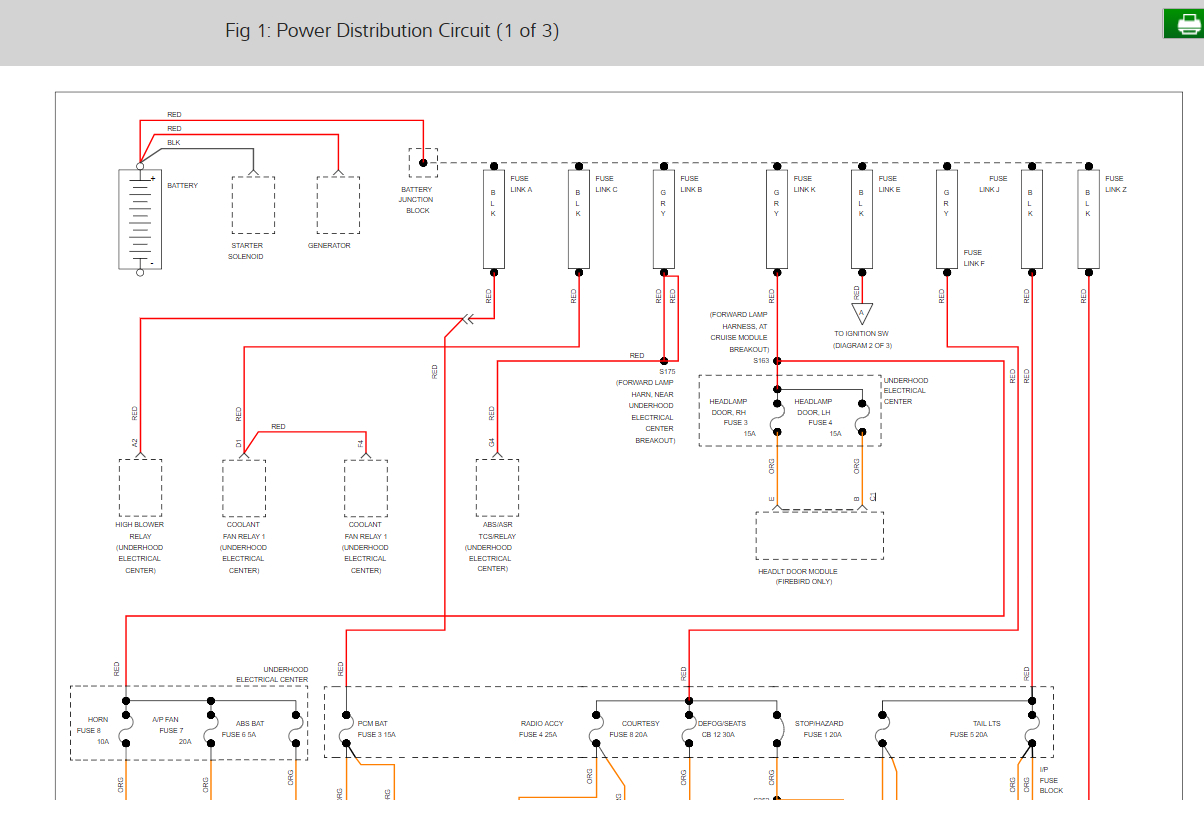

The main supply goes into the ignition switch and then the ignition switch feeds the inside fuse box. Access that connector from under the dash. It is probably bolted together with a single bolt through the center, accessed from under the dash.
Please check fusible link "E". Here is a wiring diagram below so you can see what I am talking about:
This guide should help as well.
Check out the diagrams (below). Please run some tests and get back to us.

Thanks for the guide and wiring diagrams. You hit it on the money the fusible link was out. I replaced it and the ignition switch and the car works great! I love this site.
