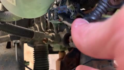

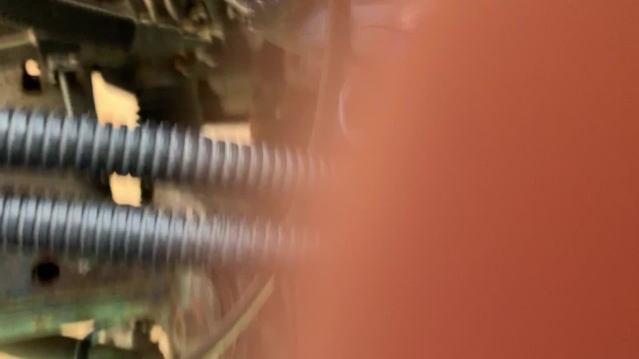

4WD Transfer Case Motor Encoder. Do you think it could be this on my truck and that’s why I am not getting any power to front actuator?

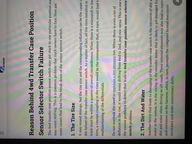

But see I can hear the transfer case motor make noise, but I been doing research on the 4wd transfer case motor encoder to and it was saying there’s a sensor or something inside, look at this too I found and I did put a 6” lift and then a 3” body lift and I got bigger tires too,

So because I have bigger tires on my truck do you think that’s why my 4wd isn’t working and that sensor in transfer case motor is shot?

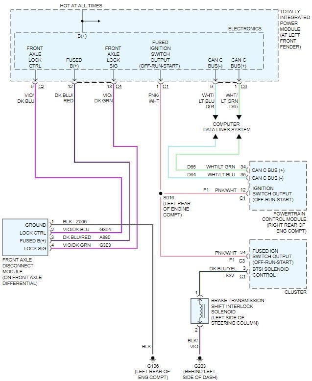

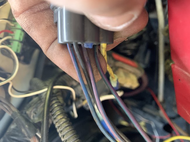

So could you tell me what all four wire the colors and what they do that hooks into front actuator?

Ken. So the blue with brown strip is the one that’s getting power the other wires nothing. I went to the transfer case motor checked with there I believe there is three wires and the purple with yellow strip does not got any power down at transfer case motor.
Oct 8, 2019 at 9:05 AM
STEVE W.
  • 15,345 POSTS

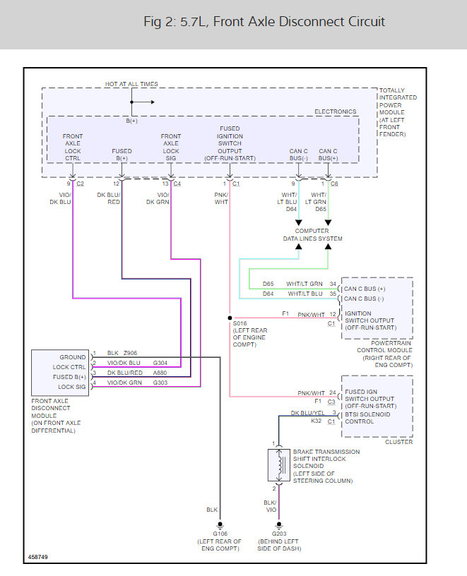

There is only one wire that should have power. The Dark Blue with read stripe should have power all the time. The black wire is a ground wire, It should go up through the harness to a ground point on the chassis. The other two wires are selective ground wires. The system works electronically. When you select 4WD the body control module sends a signal to the transfer case and the front axle disconnect actuator. The transfer case shifts and as it locks into 4XH it sends a signal to the BCM telling it to move the front axle disconnect into lock position. The BCM sends the signals to the axle through the TIPM. The Violet with Dark Blue wire is the control wire, it is switched to ground to control the actuator, The Violet with Dark Green wire is the signal wire which tells the TIPM and BCM that the interlock has locked into 4WD.
The way to tell if there is a problem in the system is easy. Get a simple test light, Connect it to battery positive and check that the black wire is grounded. If it is, the light will come on when you touch the pin in the connector. Now move the test lamp to pin two, shift the transfer case into 4WD. The light should come on as the system shifts into 4WD. Now once it is locked into 4WD move the test lamp to pin 4. The light should now be on as this is a switch inside the actuator. I suspect that the issue is in the wiring between the TIPM and the front actuator, or the actuator itself has failed and isn't switching. To release, the signal is sent to the actuator and inside it reverses the polarity to the motor and move the actuator moves the opposite direction.
