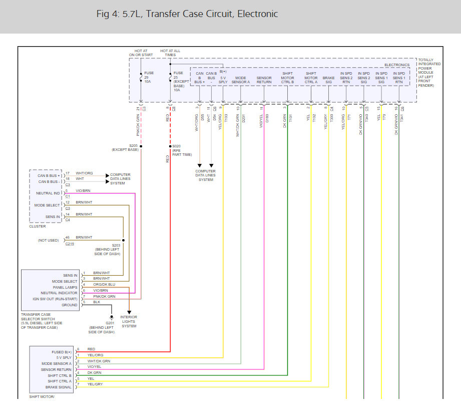

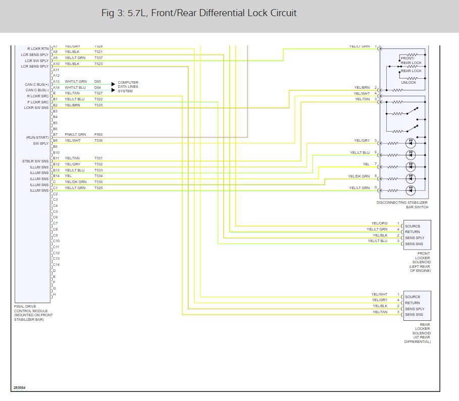

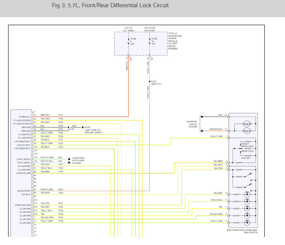

There are four wires and one wire has power all the time. And I can hear the transfer case one making noise. So any idea why there isn’t any power going to front actuator? I put a 6” lift in my truck and a 3” body lift too. so I don’t know if that would have anything to do with why no power going to other 3 wires.. help

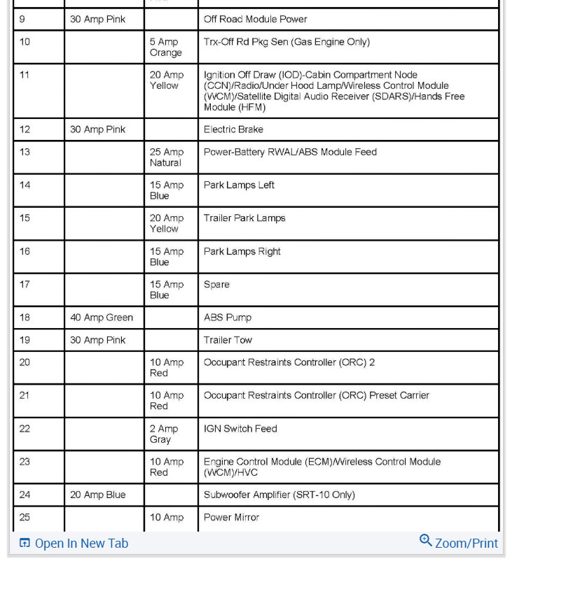

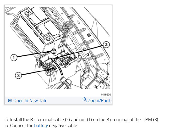

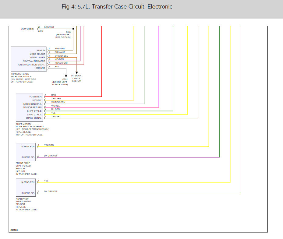

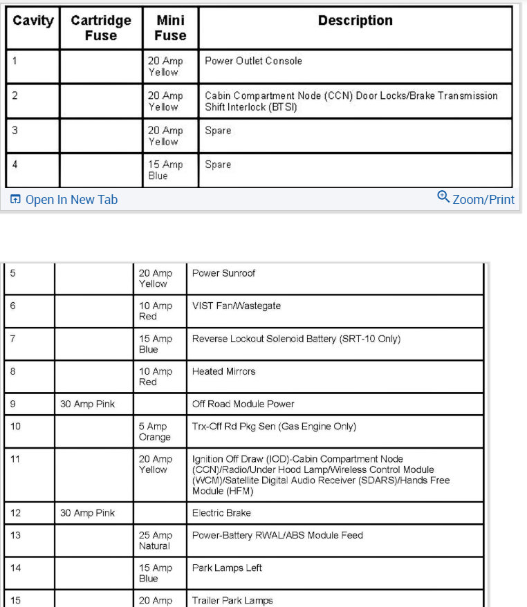

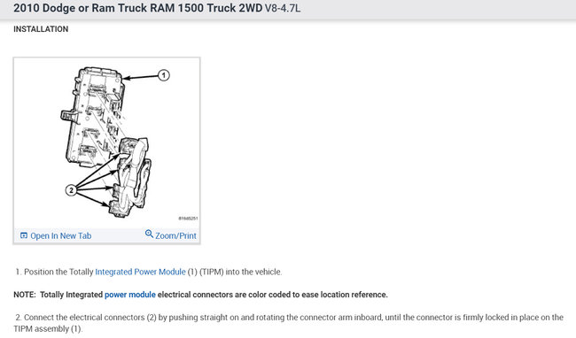

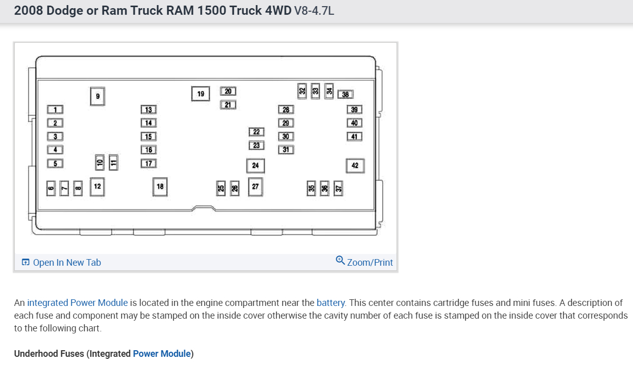

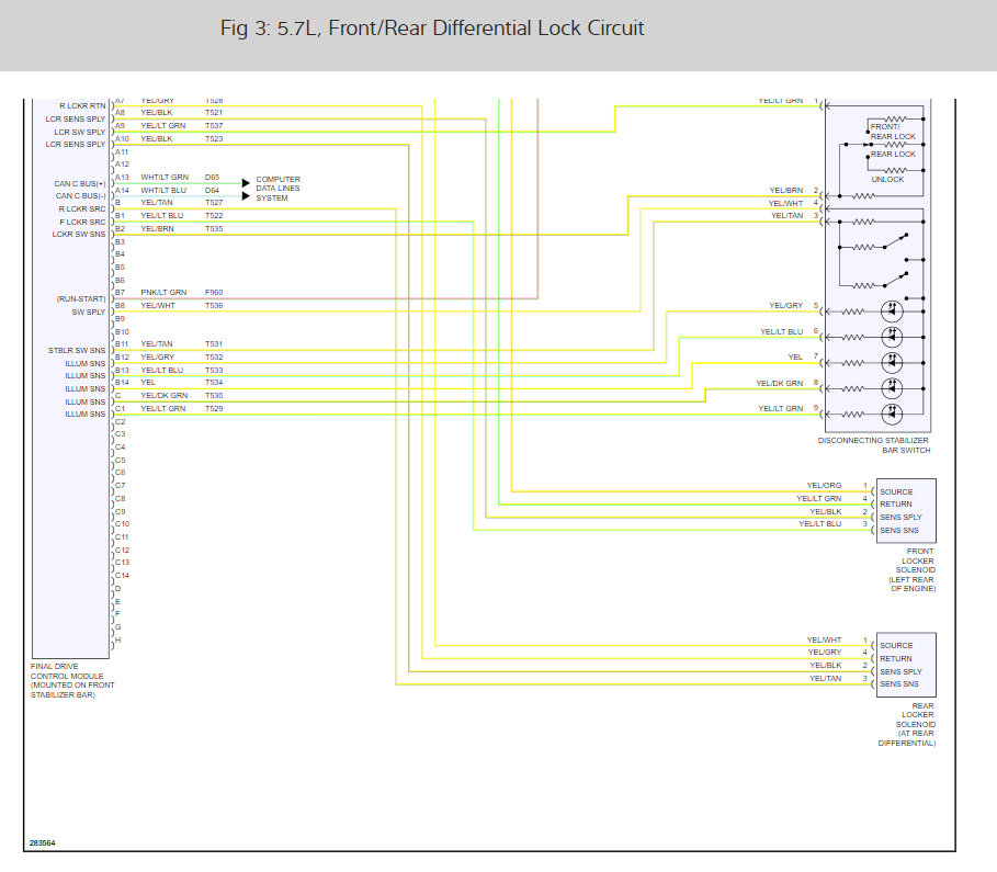

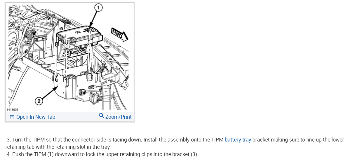

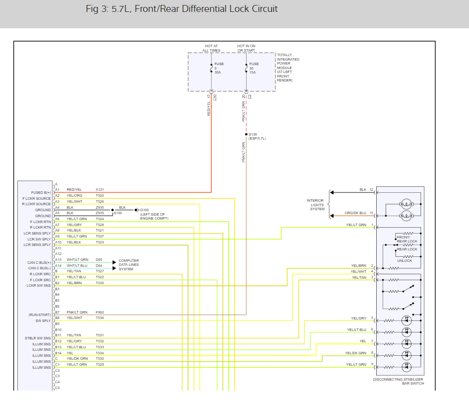

There are fuses and the TIPM that control the 4WD system. can I ask if the problem happened directly after the lift? If so lets check the fuses and grounds. here are the transfer case and 4WD actuator wiring diagrams so you can see which fuses to check and how the system works. I have included the fuse location as well and TIPM replacement instructions which is easy because it self initializes.

This sounds like a typical TIPM that is out. All fuses are good? I would try the TIPM.
Sep 9, 2019 at 3:55 AM
MATTIE0393
  • 40 POSTS
Yea, but that was replaced and I asked Dodge dealer if they program it and they told me yes if it wasn’t programmed that my truck wouldn’t be starting.

With the key on can you check for power from 12 and 1 at the TIPM please let me know what you find. Check the wiring diagrams above.

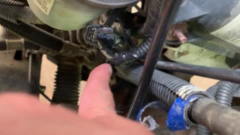

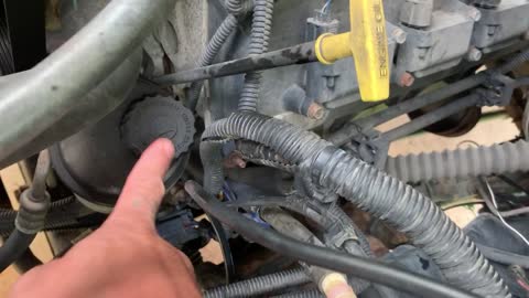

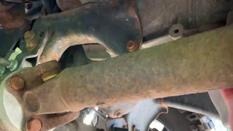

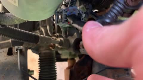

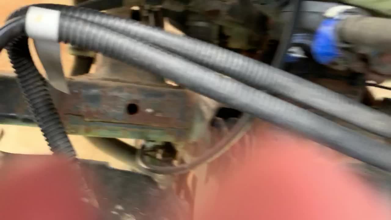

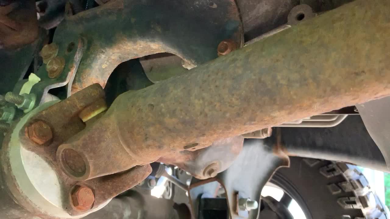

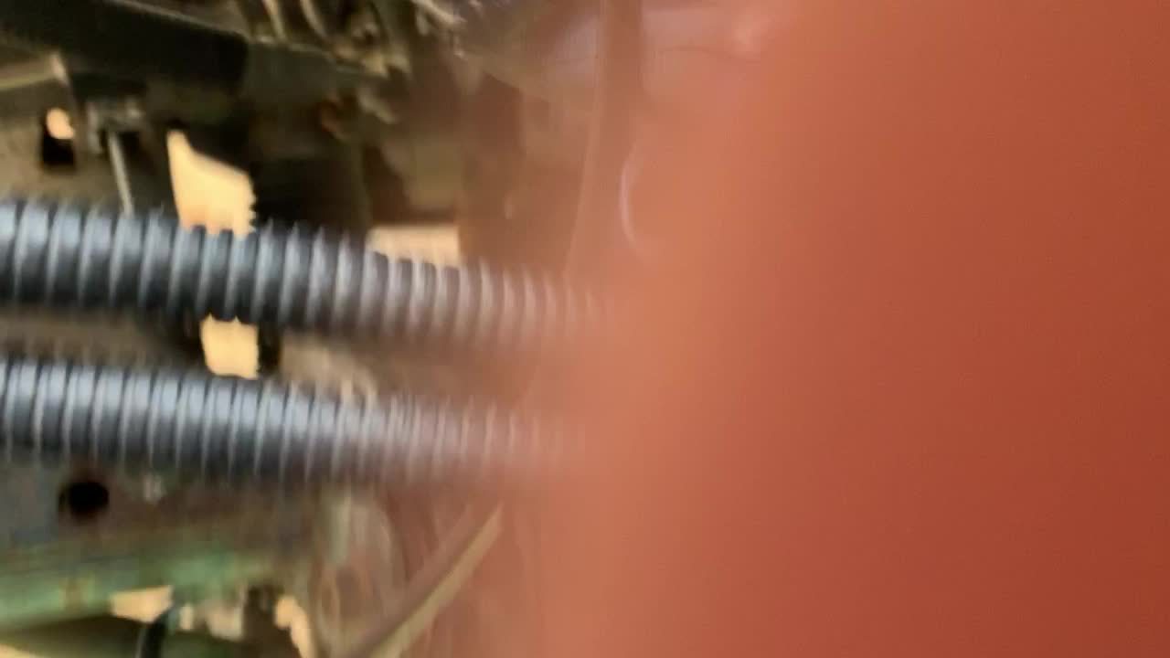

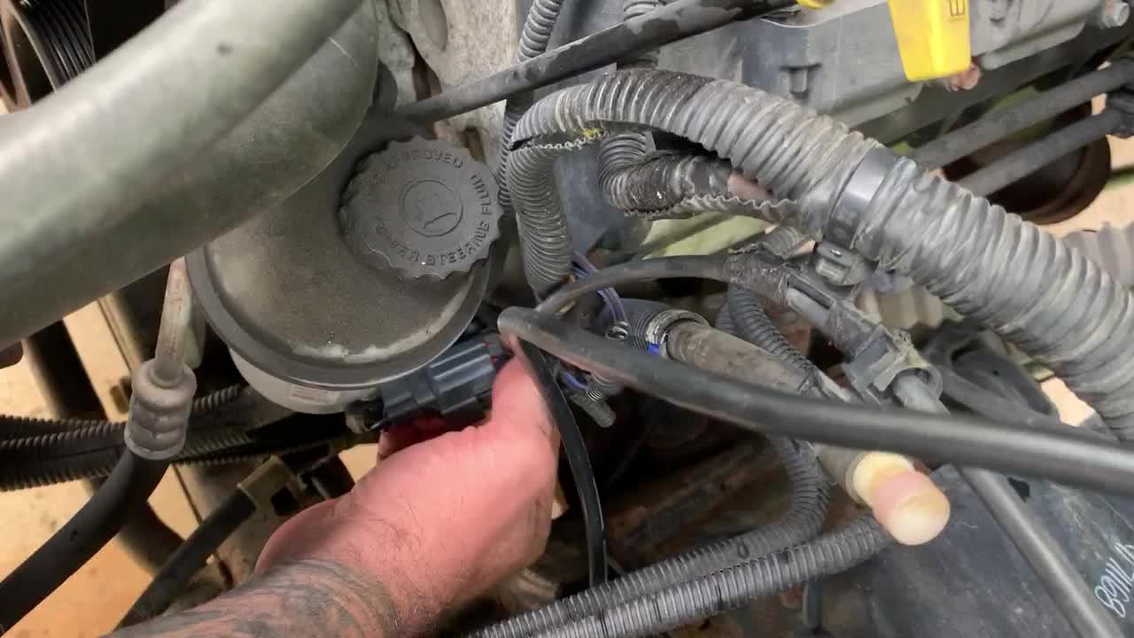

This wire harness goes up kind of battery and fire wall and there is no power except one wire. I can try and get better video tomorrow right now it’s storming out bad here.
Sep 11, 2019 at 10:45 AM
  • 55,721 POSTS
Okay sure sounds like the TIPM is out.

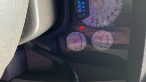

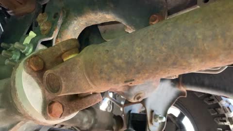

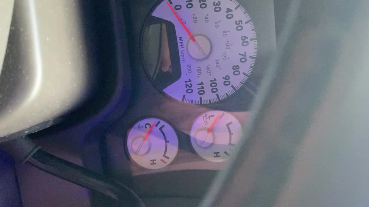

Can you tell us what the vehicle is doing when you shift it into 4wd? Does the 4wd indicator in the dash continue to flash after you turn the knob or does it flash and then turn solid?
This may shed a little light on what the vehicle is seeing.
Here's how the system functions...... The 4wd shift knob is hardwired to the cluster. When you change knob position, the cluster reads this change and sends a message over the vehicle network to the TIPM. Once the TIPM sees a command to shift from 2wd to 4wd, it first activates the shift motor on the transfer case which should engage the front drive shaft. Once the TIPM sees the mode change completed via the position sensor in the t-case shift motor, it then activates the Front Axle Disconnect(FAD) motor. If it never sees the mode change in the t-case, it's never going to actuate the FAD.
With the truck in 2wd, have someone slowly drive the truck forward so you can watch the front driveshaft. Make sure it's not moving in 2wd. Then have your helper shift to 4HI and see what the driveshaft does. It should start spinning at this point. If it doesn't, we need to start looking at the t-case shift motor or its wiring.

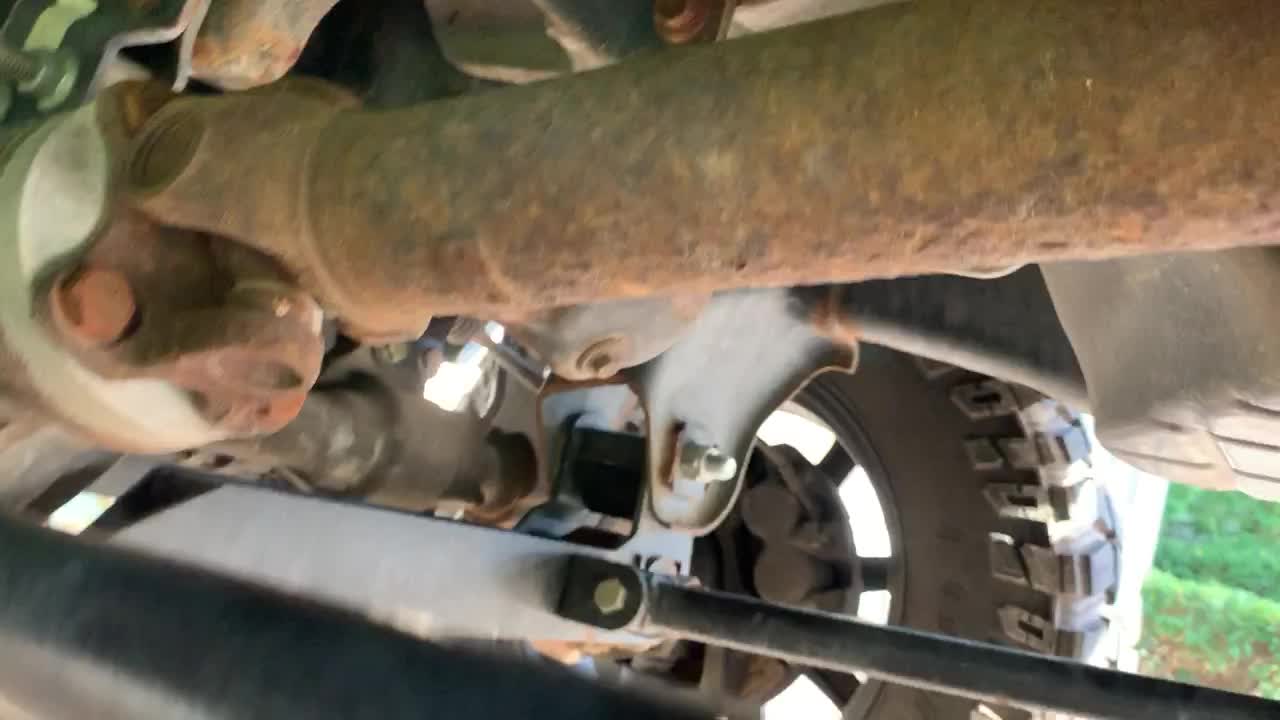

Masterwrench, I just posted a video for you.
Sep 16, 2019 at 8:52 AM
MATTIE0393
  • 40 POSTS
When I lock the four wheel drive in the front drive shaft turns when lock in 4wd. And when not locked in it does not move.
Sep 16, 2019 at 9:04 AM
MASTERWRENCH
  • 258 POSTS
Those videos are perfect! Thanks for verifying that. When you have it shifted into 4 Hi, does it feel like it's in 4wd when making turns on dry pavement?

No it doesn’t do anything. I checked for voltage and I am only get voltage out of the one wire. From front actuator and I follow the wiring harness up to where it hooks up to and I am only getting power to one wire there is two if you want I can take a video later to show you what I am talking about. if you do not know.

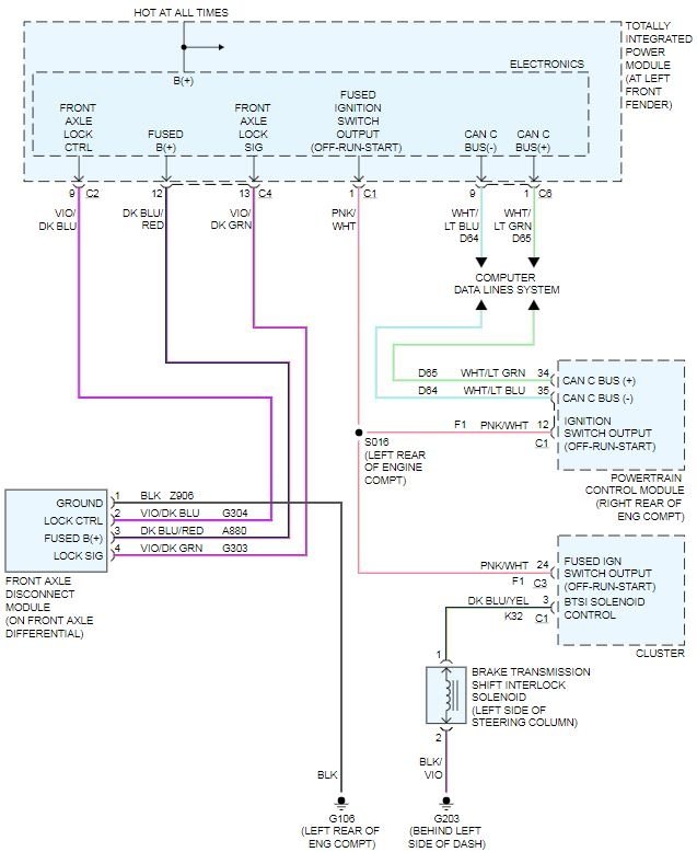

Okay. That helps rule a few things out. At this point, we know the shift motor is responding to the switch and changing modes the way it supposed to. The fact that it shifts back and forth between 2 Hi and 4 Hi suggests that the position sensor on the transfer case is most likely working the way it should too.

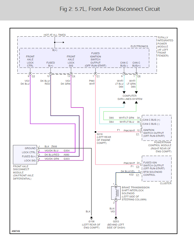

This brings us back to the front axle disconnect(FAD). You mentioned only having power on one of the wires at the disconnect actuator. Are you measuring this with a volt meter or a test light? There should only be one circuit there with full 12v on it. So if you're using a test light, it's only going to light on that one circuit. Take a look at the attached wiring diagram of the FAD system. Pin 3(dark blue w/red tracer) at the FAD connector should have 12v with the ignition key on. Pin 4(violet w/dark green tracer) is the signal circuit and should have some amount of voltage on it which will change with FAD position(not sure the value as it's not specified in the service manual). Pin 2(violet w/dark blue tracer) is the motor control circuit and should have either power or ground while it's engaging or disengaging.
That being said.... With everything connected, measure the voltage(with a voltmeter) on Pin 2 which turning the shift knob from 2 Hi to 4 Hi. The easiest way to do this is by sticking a paperclip or small pin in the back of the connector to attach your positive lead. Check out the links below for additional information on using a voltmeter and testing circuits.

Sorry for the delayed response. At this point you have one of three things occurring in the four wheel drive system.
1. Tcase position sensor not working. This would prevent the TIPM from determining what position it's in which would cause it to not engage the FAD (not likely based on findings above).
2. Internal FAD actuator failure.
3. Wiring issue between the TIPM and the FAD.
To really narrow it down much further from this point, you would need a scan tool that allows you to monitor the position sensors in the TIPM. If you are able to get access to one, you would need to look at t-case position. It should match the position of your shifter knob. If it never changes to 4HI and continually displays "shift in progress" after you've placed the knob in 4HI, that indicates a position sensor failure at the t-case. If it changes state the way it should, I would suspect a failed FAD actuator at that point.

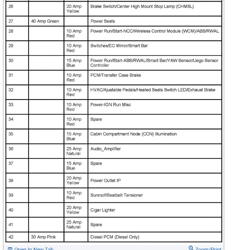

I might check to see again on the fuse what fuse should I look for for my four wheel drive .

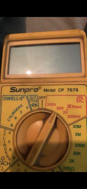

Have you checked checked voltage on Pin 2 of the FAD connector with it plugged in and while shifting from 2Hi to 4Hi? I know you posted a picture of your meter above, but the screen was blank.

Anyone knows what or if there is a fuse for my front actuator 4x4 and if so what is it called?
Sep 24, 2019 at 8:46 AM
  • 55,721 POSTS
Look at the wiring diagrams it shows everything.
Sep 24, 2019 at 12:34 PM
MATTIE0393
  • 40 POSTS
I checked all fuses and all good. now what should? I do could it be a ground?
