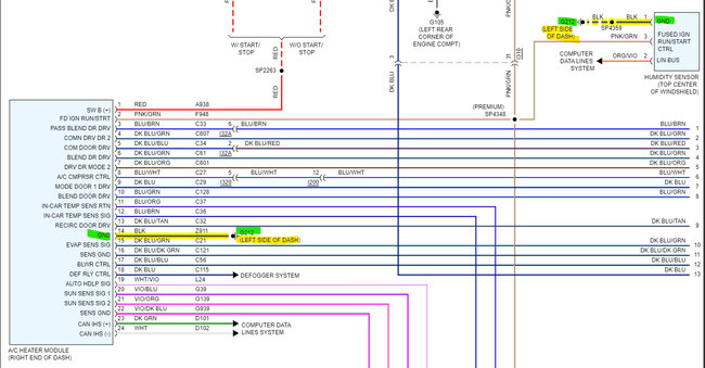

I have no A/C, heat, defroster, vent fan or anything. I've replaced the humidity sensor and the HVAC control panel. I have two codes; one says lost communication with humidity sensor and the other says I lost communication with the HVAC control module.

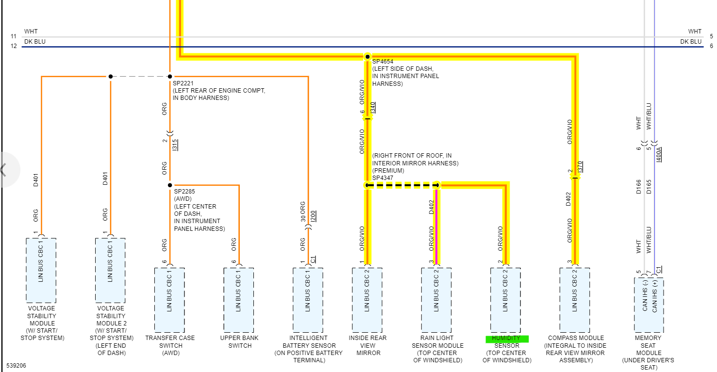

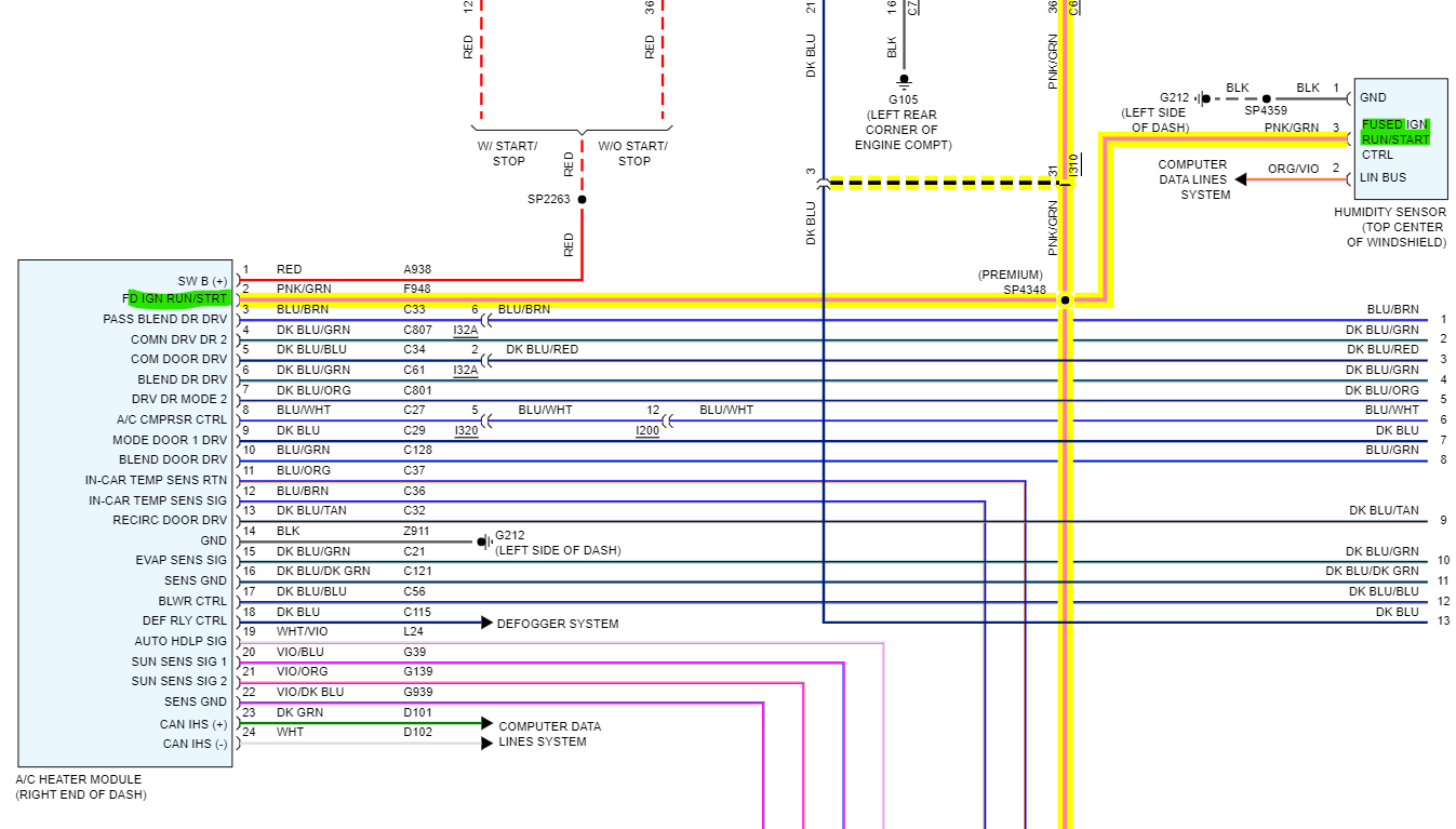

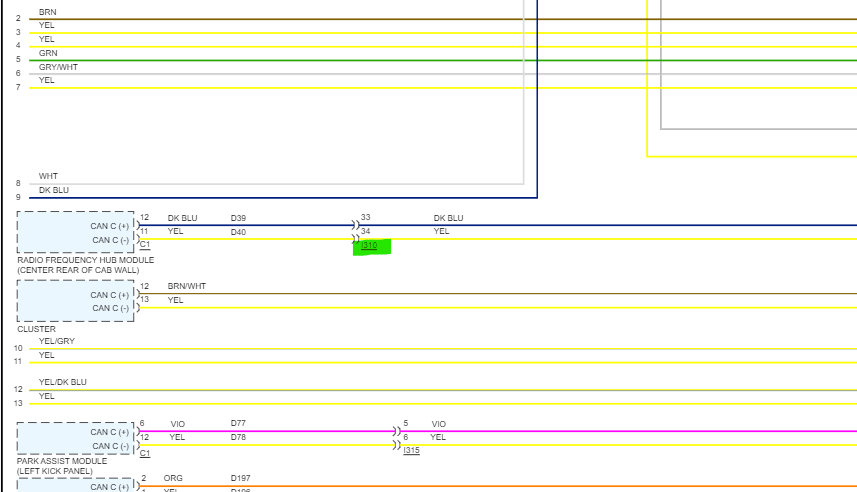

Hello, can you give us the exact codes? This way we can look up the code setting criteria and other information. But looking at the wiring diagram, the HVAC control module and the Humidity Sensor get powered up on the same feed wire coming from Fuse 99 10amp. So, see if that fuse has power and take it out and see if it looks like it got hot, or if it is blown you may have had one of those two modules short out. If it has power with the key on, next check at the back of the HVAC module on pin 2 and pin 3 of the Humidity sensor for power. If that fuse is blown, that's the cause of your lost comms. If the fuse blows again, then there is a short to ground somewhere on that pink/green wire.
That dotted line highlighted is a connector there (1310), and since the pink/green wire is pin 31 on that connector, its most likely a bulk connector with a lot of wires running through it. We can use that as a testing point if there happens to be a short to ground on the circuit.
I think you're going to find you are just missing power to those two modules, if there was an actual communication issue, you would have codes for the other modules on the LIN bus that the Humidity sensor communicates on as well as other CAN bus codes because that's the network that the HVAC communicates on.

U0164 and U1190.

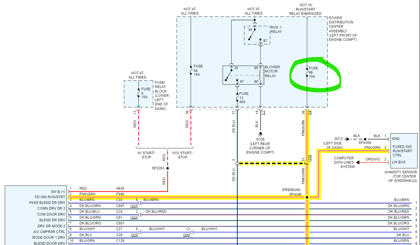

Did you check for power on pin 2 of the HVAC control (pink/green wire) for 12 volts? Its also pin 2 on the Humidity sensor, should be 12 volts as well. You have to verify it with a multimeter and make sure its a full 12 volts. If theres voltage drop on that wire and its only getting 9 volts for example, it wont be enough for the module to communicate. The LIN bus from the Humidity sensor is a 0 to 12 volt signal.

Which power and ground wires did you check? The red wire on the HVAC? The pink/green wire is the one you need to go after; it powers both those modules from fuse 99 on the same wire. It's and Ignition switch feed.

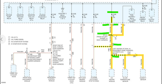

Okay, go after the pink/green wire next with the Key On.
You haven't lost comms with any other modules and that one power wire ties the 2 modules together,
Do you have an oscilloscope?
The 2 modules run on different networks, the HVAC module has lost its comms on the Interior CAN bus network and the Humidity sensor communicates on the LIN bus, they are completely different signals, that's why I think there is a loss of power on that Ignition feed wire, if they are both missing power we'll need to trace it back to fuse 99.

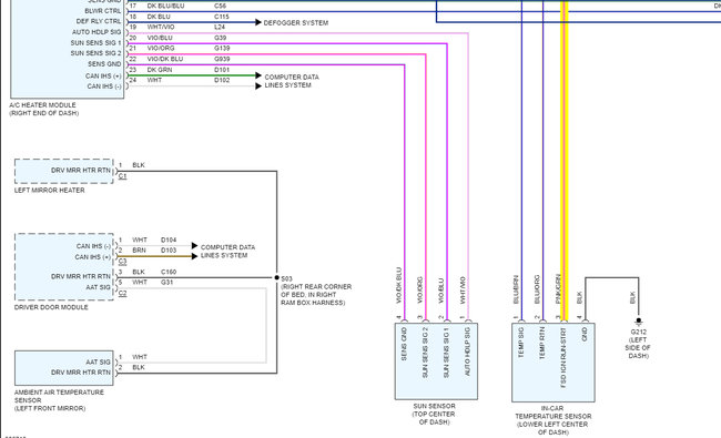

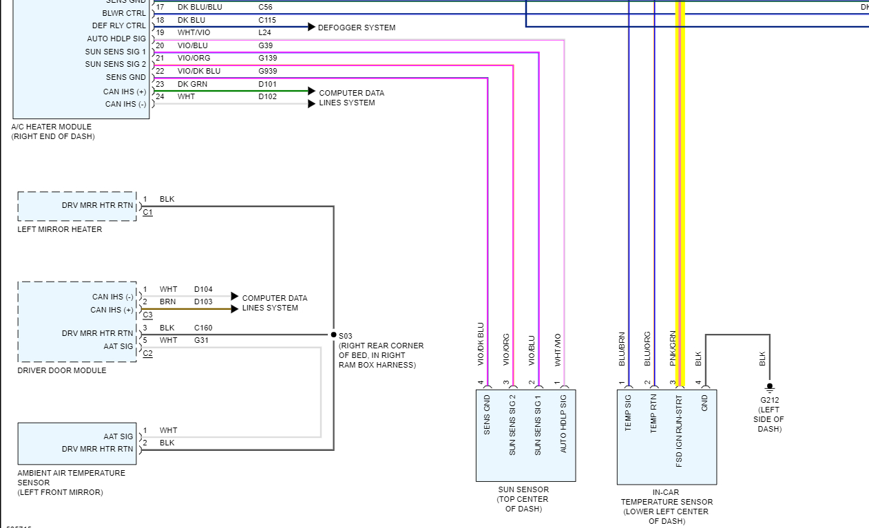

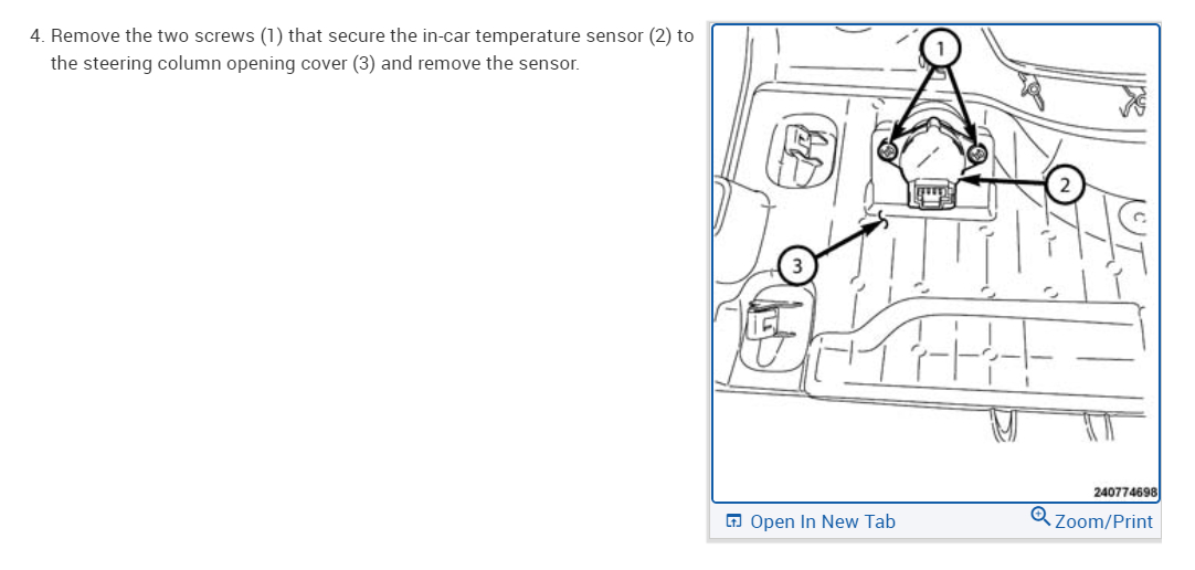

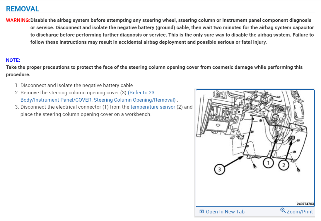

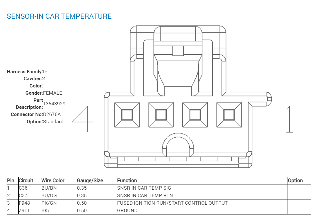

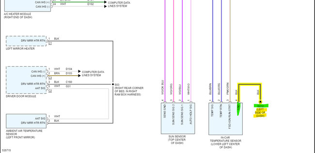

It also goes to this in-car temperature sensor. it might be that the temperature sensor is shorted out and pulling the 12-volt feed down. so you might have to unplug that at some point. I'll try to find its location.
The last 4 diagrams are the in-car temperature sensor.. Should have the same Pink/Green wire running to it with 12 volts.
Okay, the temperature sensor is not on any network, its hard wired in, so its just like a thermistor that changes resistance with temperature. Just like a Coolant Temp sensor, so it could pull down the 12 volts without potentially blowing the fuse.

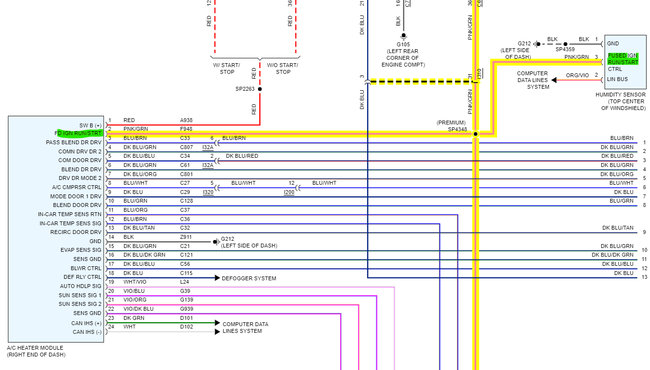

So, I have 12 volts at the red wire on the humidity sensor and the HVAC control module. I have 12 volts at the green/pink wire on the HVAC control module and only 9 volts at the green/pink on the humidity sensor.

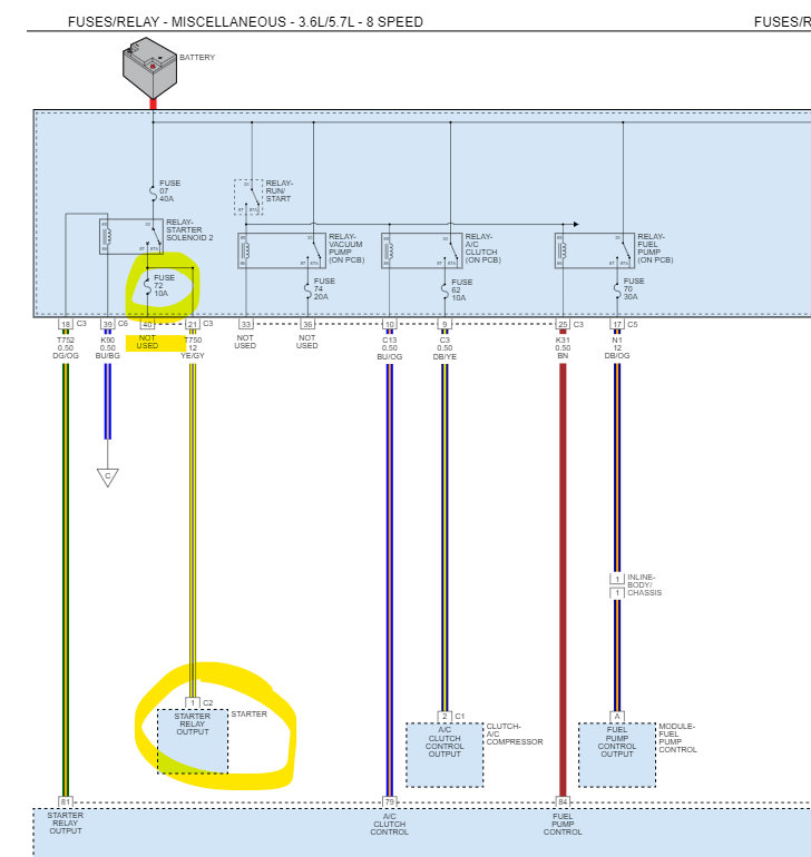

On a side note, rechecked all the fuses. Not sure if it should have power or not, but the fuse for the PCM 10 amp is grounded on both sides.

Does the PCM fuse have a number too, I don't see one labelled PCM, I'll keep looking, but there might be a number on the fuse box label as well..

F72 is the fuse number. And I checked it with the test light. And it shows grounded on both sides when i hook to the positive battery terminal. I was just checking fuses for the third time and using a test light this time. And yes, the pink wire with green stripe has 12.46 volts at the hvac control module and that same wire has 9 volts at the humidity sensor. And I'm not sure about the start/stop being enabled. I haven't changed anything though. Where would I find the place to check that?

Okay, it appears fuse 72 will only be hot while cranking, and it goes to the Starter motor, so that's why you're reading ground on both sides of the fuse. I think it would light the test light if you cranked the engine over. It looks like you're getting ground through the starter motor, so we won't worry about that right now, we need to concentrate on these 9 volts and trace that down.

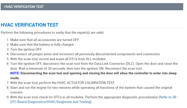

Also did you do any type of verification test on the new hvac module, or any programming?
There is a verification test listed for new modules, Im also going to have you check the actual CAN bus network with a multimeter to see if there is activity coming out of the module, separate from the rest of the network.

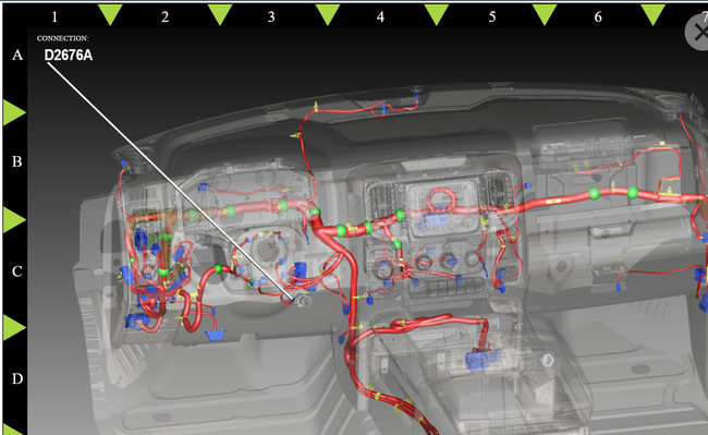

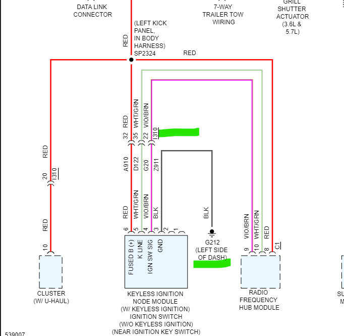

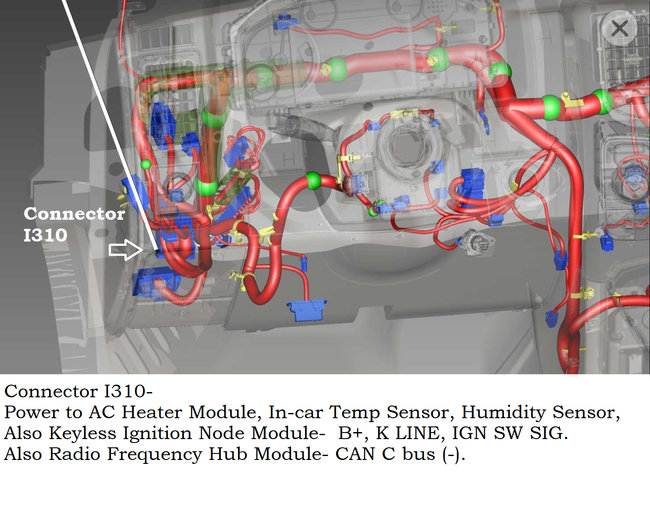

Okay, I've narrowed it down to a couple of connectors. This connector I310 is a bulk connector in a place that can possibly be exposed to moisture intrusion, down by your left leg as in diagram 1. It has the power feeds to the Hvac Module, Humidity sensor, In-car Temperature sensor, plus an Ignition switch feed, K Line network, CAN C Bus Network Low side, for the Keyless ignition Node Module and Radio Frequency Hub Module (for remote start). I don't know what else runs through this connector, so I wouldn't just pull it apart, It may have SRS (airbag) wiring running through it. And you don't want to set any of them off. But this connector may have corrosion inside of it effecting some pins and causing voltage drop across it. (Diagrams 1 through 4)

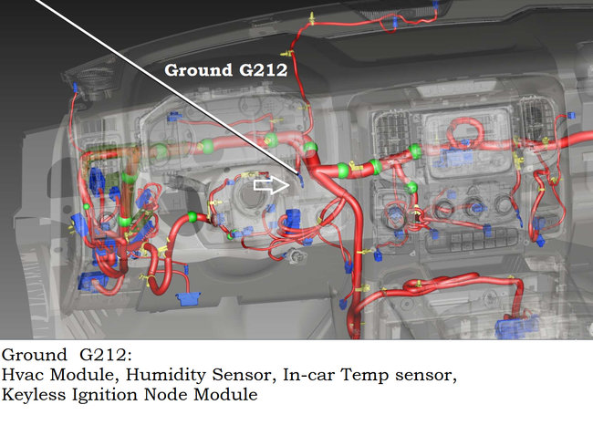

The 2nd possibility is a Ground G212 although it doesn't explain the 9 volts reading. Its Ground for the Hvac module, humidity sensor, In-car temp sensor, And the Keyless Ignition Node Module. (diagrams 5 through 7).

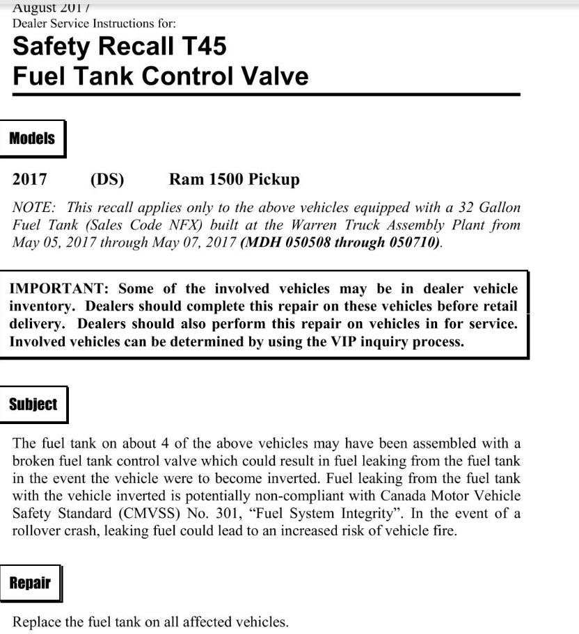

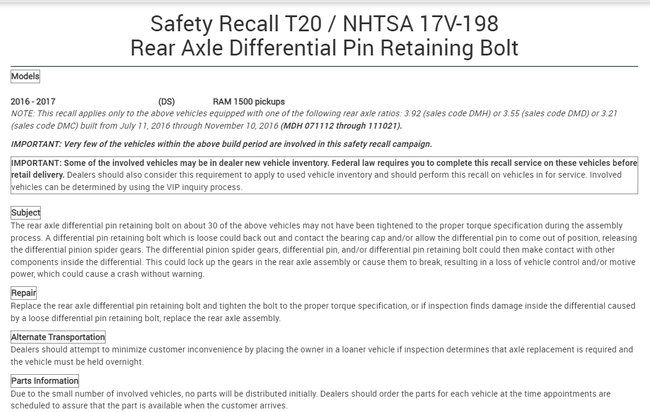

I found a bunch of safety recalls I'm going to post as well.

Okay, with the 9-volt issue, I think checking the Connector I310 first would be a good idea, If you had a bad ground to any of these modules, you would still have a 12volt feed depending on where you were using for ground with the meter. The 9 volts makes me suspect a connector issue or splice, but since you are now having issues with the remote start, which runs through the I310 connector too. The network in this truck is pretty complex, but it's tough to say exactly what's going on since you have 12v at the hvac module, The last page above is the verification for the hvac module.
At this point I would try erasing all the codes and see what comes back right away. You can also try the wiggle test with that connector and see if any hvac control comes back. It's the one connector that ties all the issues together, my next test would be to de-pin the CAN bus network pins out of the hvac module and keep it powered up by check if a signal was coming out of the module itself, that way none of the network would be connected and you could see if anything was coming out of the CAN bus pins. I assume you have tried erasing the codes after the new modules were installed. And by the way there are 9 safety recalls I have for you. Pages 1 and 2 go together, and 9 and 10 go together. These are Safety Recalls, that's why I am posting them, if they were regular recalls I wouldn't be as concerned.

So, an update. Pulled the I310 pin. Didn't see any noticeable issues. Plugged it back up and cleated the codes. Everything started working properly and all the codes are gone. Maybe it will last. Big thanks!

Okay, if that's where the issue was, and there was no corrosion, then it's a pin fitment issue on that connector. Normal vibrations from driving and the engine can cause things to loosen up over time, if the issue shows up again go right to that connector and see if the female pins are spread or loose at all. They're probably small pins, communication pins usually are since they carry very low current. Glad it's working for you though.
