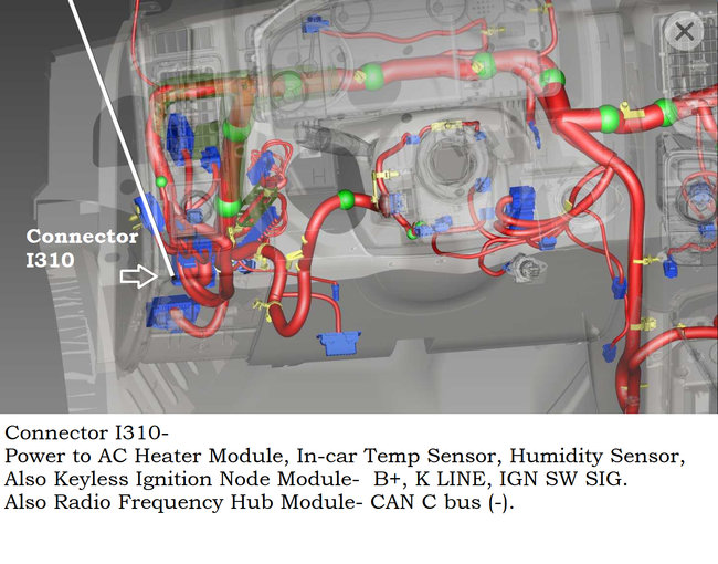

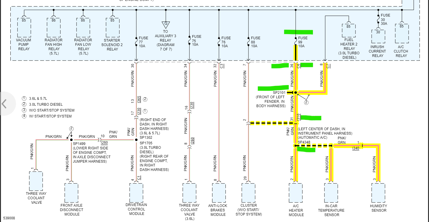

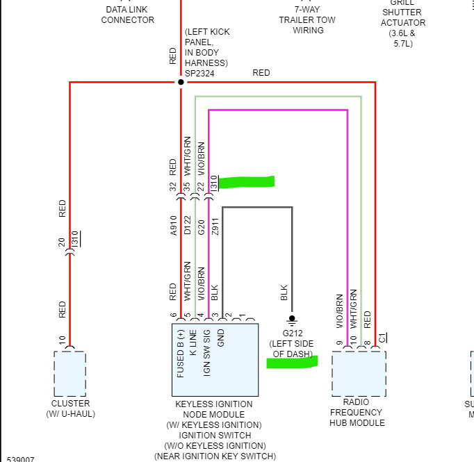

I replaced the dual climate control HVAC panel and the humidity sensor based on the codes and the fact that I had power at the plug at the control panel but no power in the control itself. And I used new parts and not used ones so I didn't check them. I have an alpha obd2 scanner/programmer and I paid for the extra access. So I can scan all the systems on the truck. The only thing it will not let me access is the hvac system. It says it can not communicate with it.
Thursday, August 4th, 2022 AT 3:41 PM
AL514
  • 4,793 POSTS

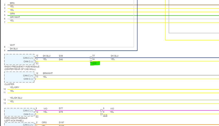

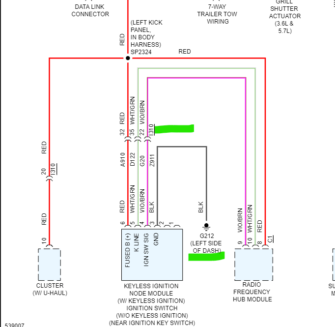

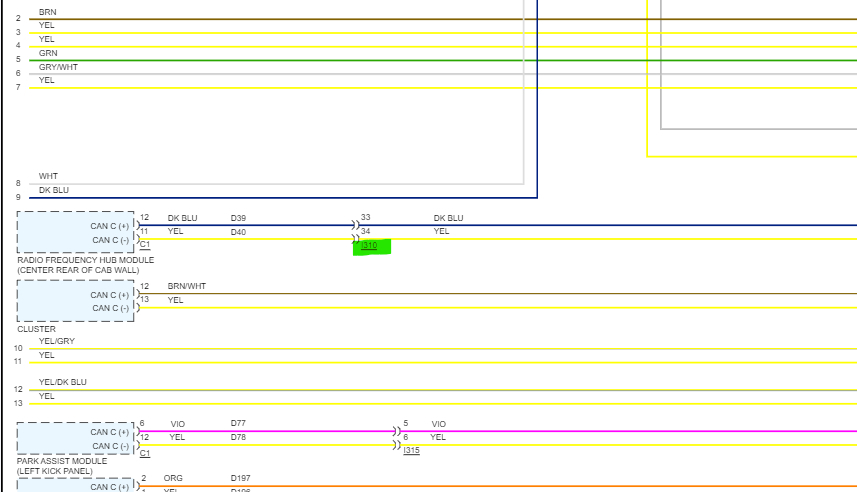

Okay, I've narrowed it down to a couple of connectors. This connector I310 is a bulk connector in a place that can possibly be exposed to moisture intrusion, down by your left leg as in diagram 1. It has the power feeds to the Hvac Module, Humidity sensor, In-car Temperature sensor, plus an Ignition switch feed, K Line network, CAN C Bus Network Low side, for the Keyless ignition Node Module and Radio Frequency Hub Module (for remote start). I don't know what else runs through this connector, so I wouldn't just pull it apart, It may have SRS (airbag) wiring running through it. And you don't want to set any of them off. But this connector may have corrosion inside of it effecting some pins and causing voltage drop across it. (Diagrams 1 through 4)

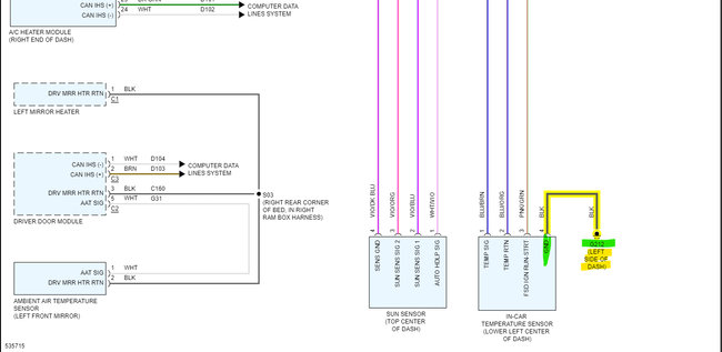

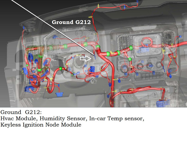

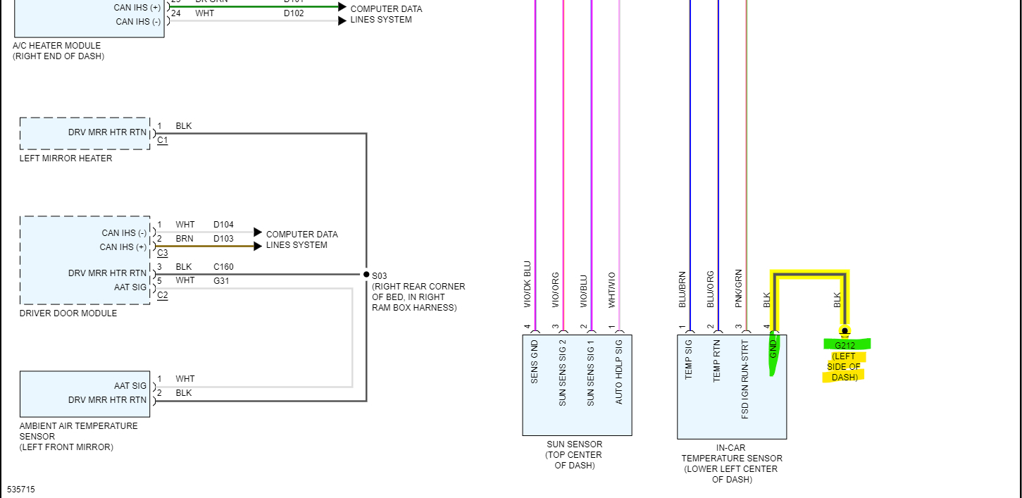

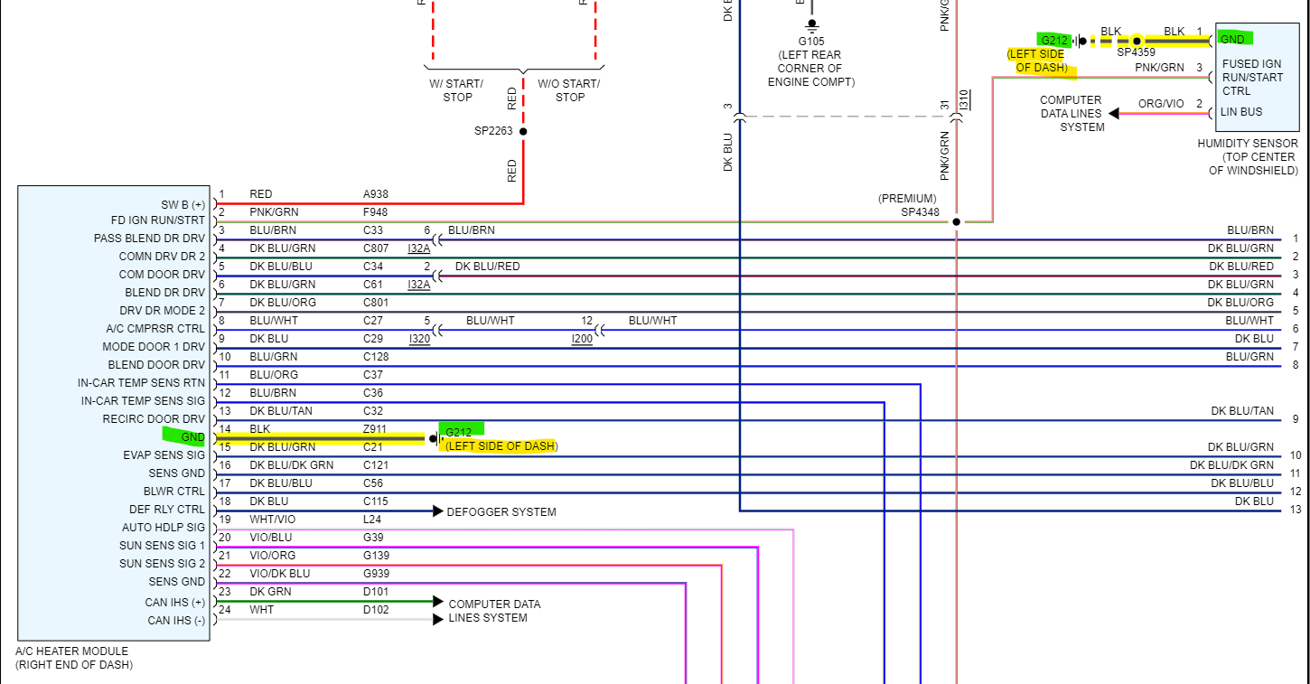

The 2nd possibility is a Ground G212 although it doesn't explain the 9 volts reading. Its Ground for the Hvac module, humidity sensor, In-car temp sensor, And the Keyless Ignition Node Module. (Diagrams 5 through 7).

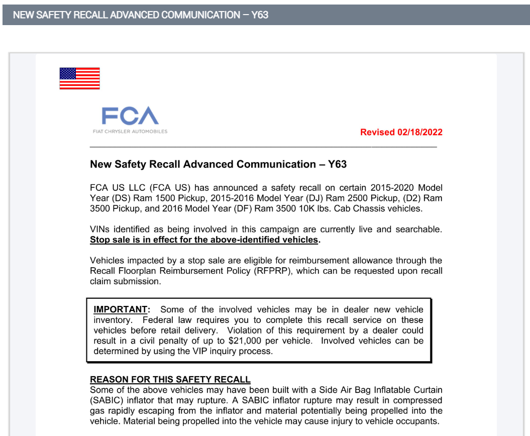

I found a bunch of safety recalls I'm going to post as well.

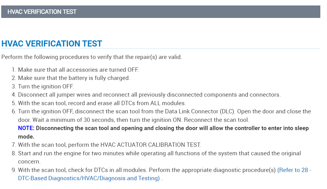

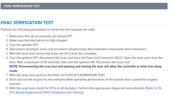

Okay, with the 9-volt issue, I think checking the Connector I310 first would be a good idea, If you had a bad ground to any of these modules, you would still have a 12volt feed depending on where you were using for ground with the meter. The 9 volts makes me suspect a connector issue or splice, but since you are now having issues with the remote start, which runs through the I310 connector too. The network in this truck is pretty complex, but it's tough to say exactly what's going on since you have 12v at the hvac module, The last page above is the verification for the hvac module.
At this point I would try erasing all the codes and see what comes back right away. You can also try the wiggle test with that connector and see if any hvac control comes back. It's the one connector that ties all the issues together, my next test would be to de-pin the CAN bus network pins out of the hvac module and keep it powered up by check if a signal was coming out of the module itself, that way none of the network would be connected and you could see if anything was coming out of the CAN bus pins. I assume you have tried erasing the codes after the new modules were installed. And by the way there are 9 safety recalls I have for you. Pages 1 and 2 go together, and 9 and 10 go together. These are Safety Recalls, that's why I am posting them, if they were regular recalls I wouldn't be as concerned.

So, an update. Pulled the I310 pin. Didn't see any noticeable issues. Plugged it back up and cleated the codes. Everything started working properly and all the codes are gone. Maybe it will last. Big thanks!

Okay, if that's where the issue was, and there was no corrosion, then it's a pin fitment issue on that connector. Normal vibrations from driving and the engine can cause things to loosen up over time, if the issue shows up again go right to that connector and see if the female pins are spread or loose at all. They're probably small pins, communication pins usually are since they carry very low current. Glad it's working for you though.
