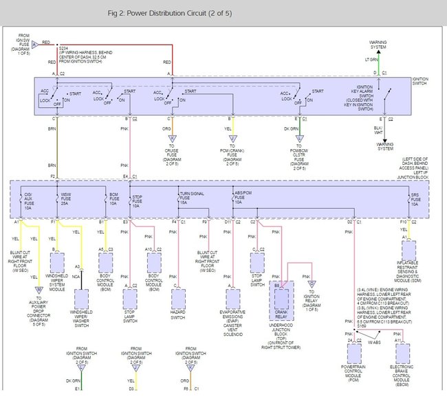

Make sure battery connections to battery, starter and ground are clean and tight. this guide can help
If problem persists, a fuse is blown, check all fuses and fusable links in fuse box in engine compartment.

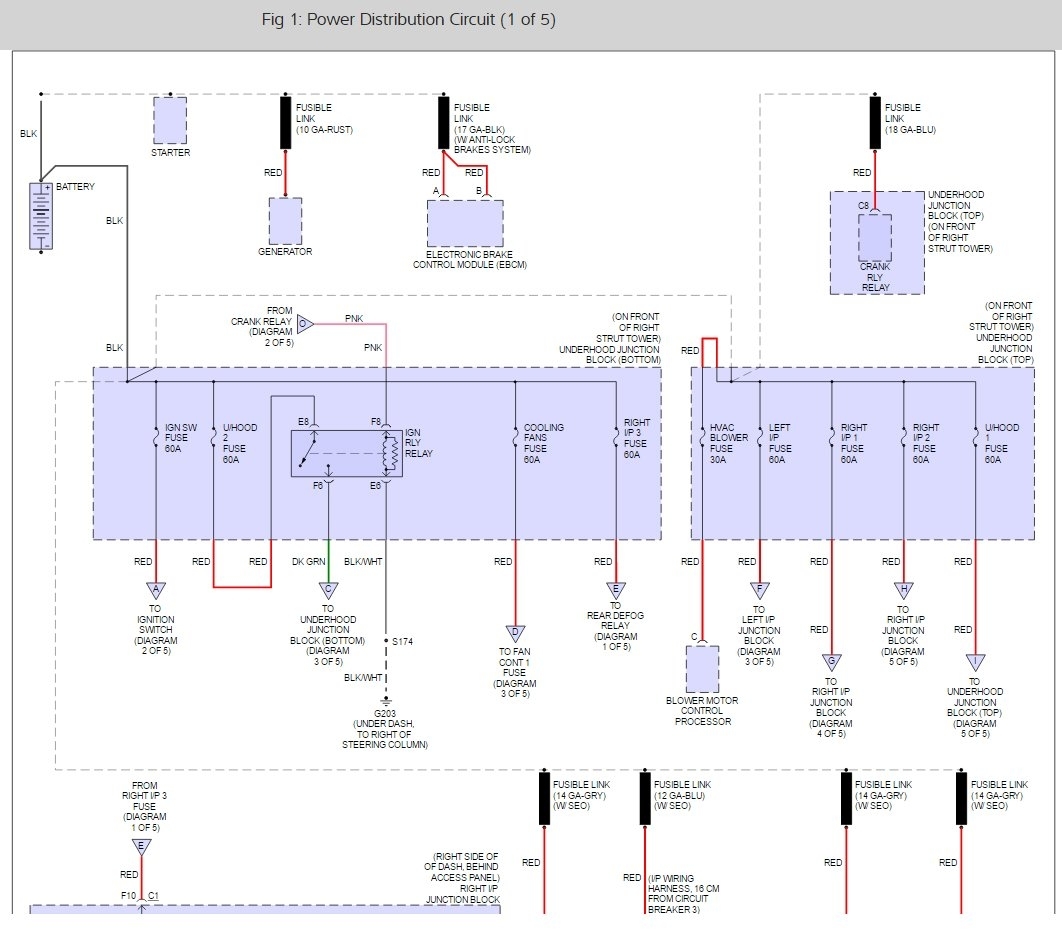

WANDA ANDREWS
My positive battery cable was burnt in half by the belt. I replaced the positive cable and checked all the fuses. The car has no power. When connecting the cables back the cables arced twice.

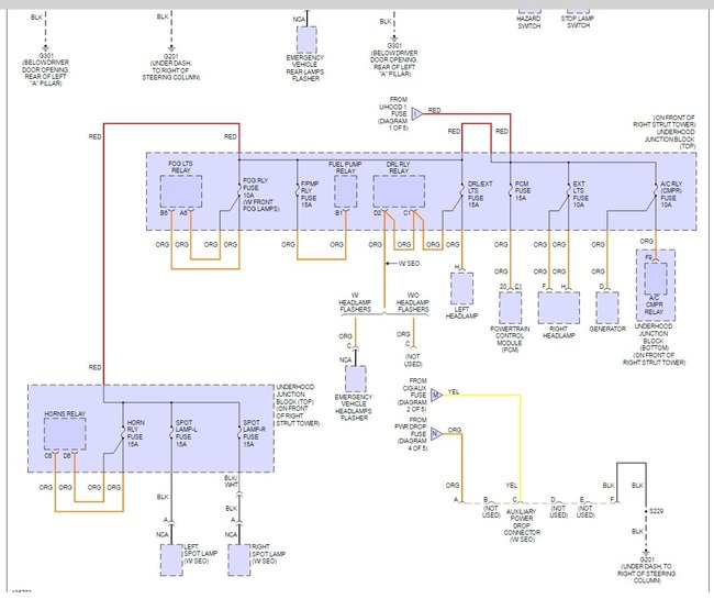

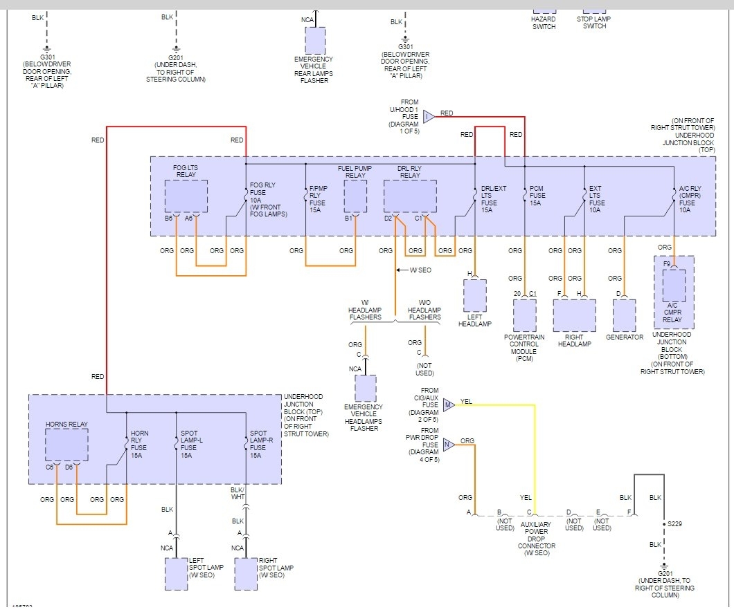

  • 54,832 POSTS
Hey WANDA.

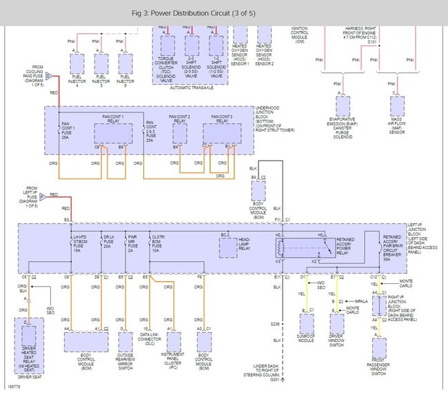

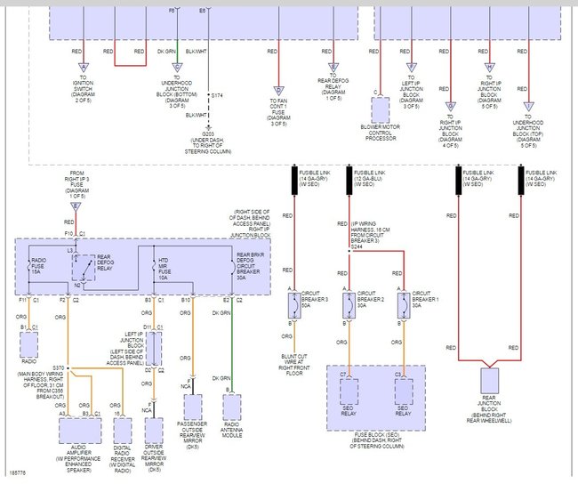

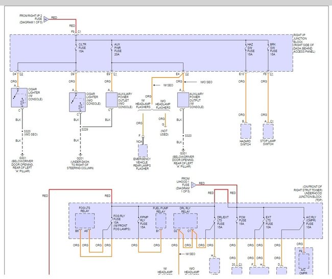

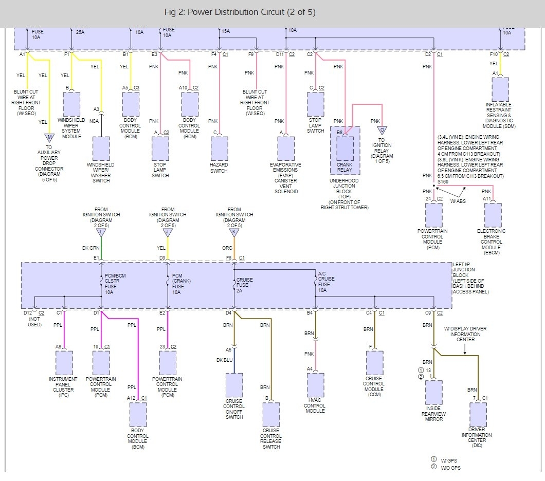

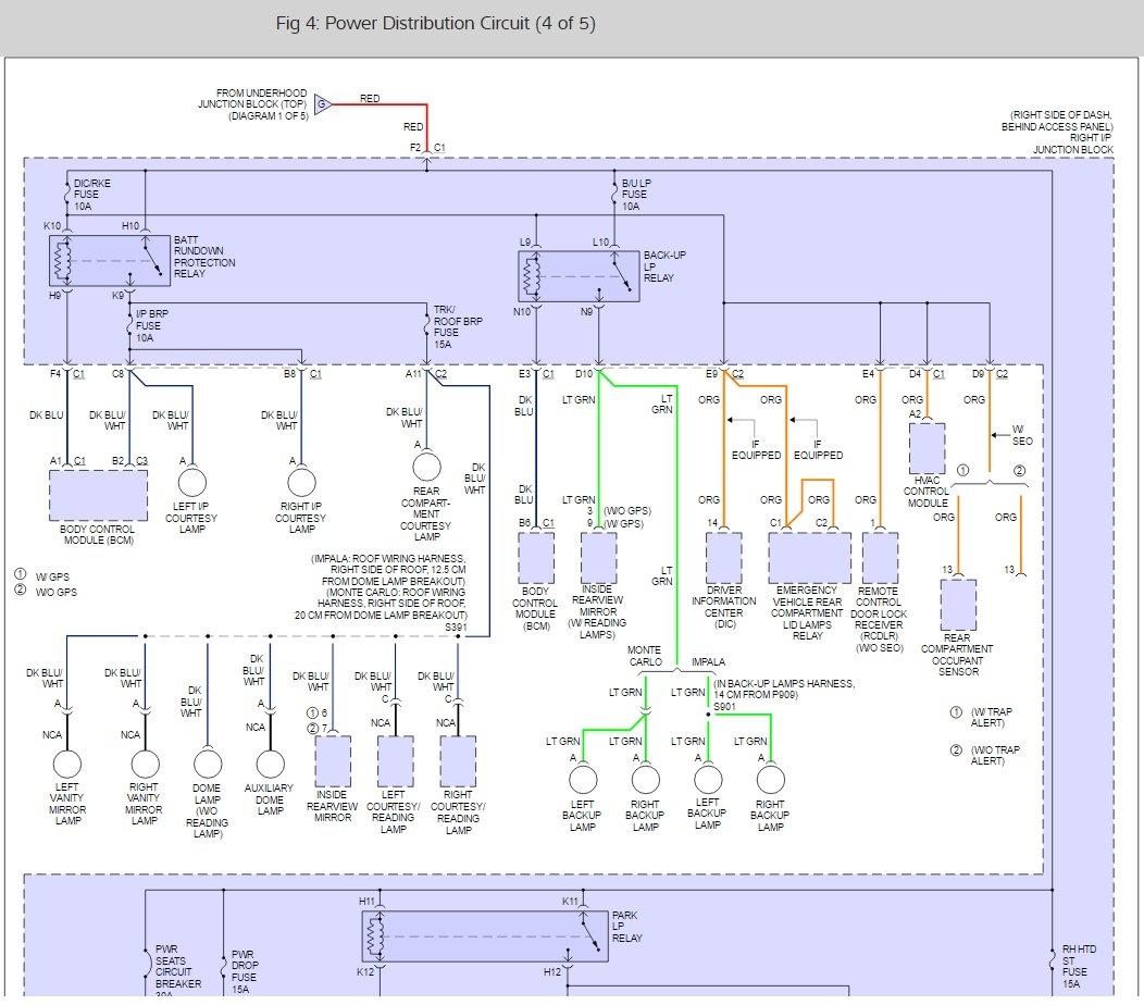

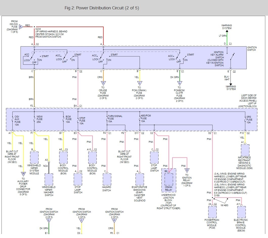

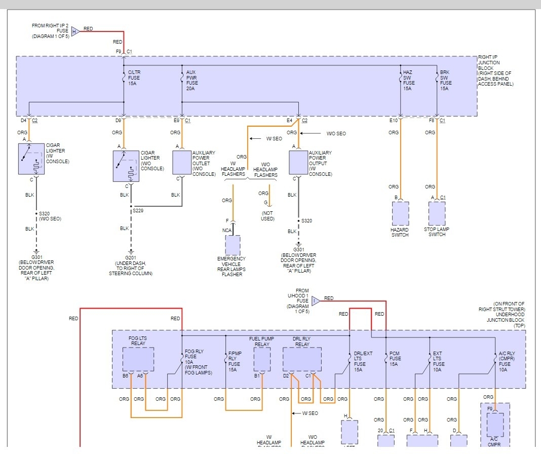

It sounds like you you might have blown a fusible link. Here are some wiring diagrams and a guide to help you do some testing to see if you can find the problem.
Please run some tests and get back to us so we can continue helping you.

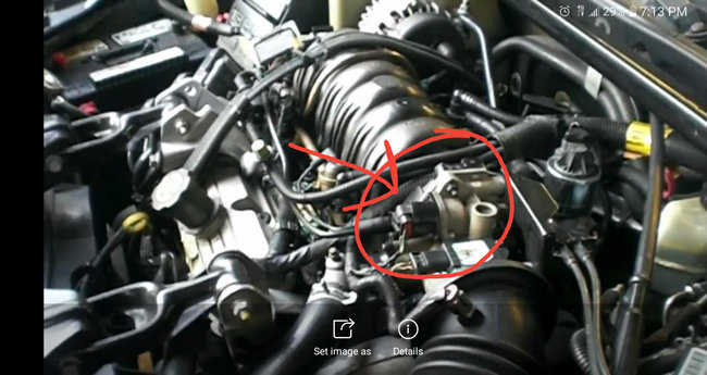

BRYAN WARD
My car has no power to locks, radio, lights or anything else. The only thing that comes on when I turn the key is the check engine light. I just bought my battery, new, a month ago and have been driving around fine except just replaced the mass airflow sensor right when this happened. I tried jumping the battery with no luck. I've looked everywhere but can't find anything that is exactly my problem. I'm at my wits end so if anyone can help it would be much appreciated. Thank you
May 11, 2021 at 12:37 PM (Merged)
BRYAN WARD
Whatever this is, is ticking every 7 seconds or so when I wiggled the writing attached to/around my battery. Until I disconnected the clip. Not the MAF sensor but the one beside it a little higher.

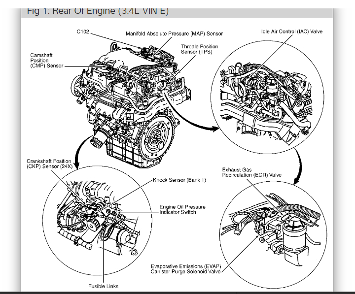

SCGRANTURISMO
  • 4,897 POSTS
In the diagrams down below I have included a diagram showing the locations of all the input sensors for vehicle. Please use this guide to match up the problemed sensor and get back to us with what you are able to find out.
