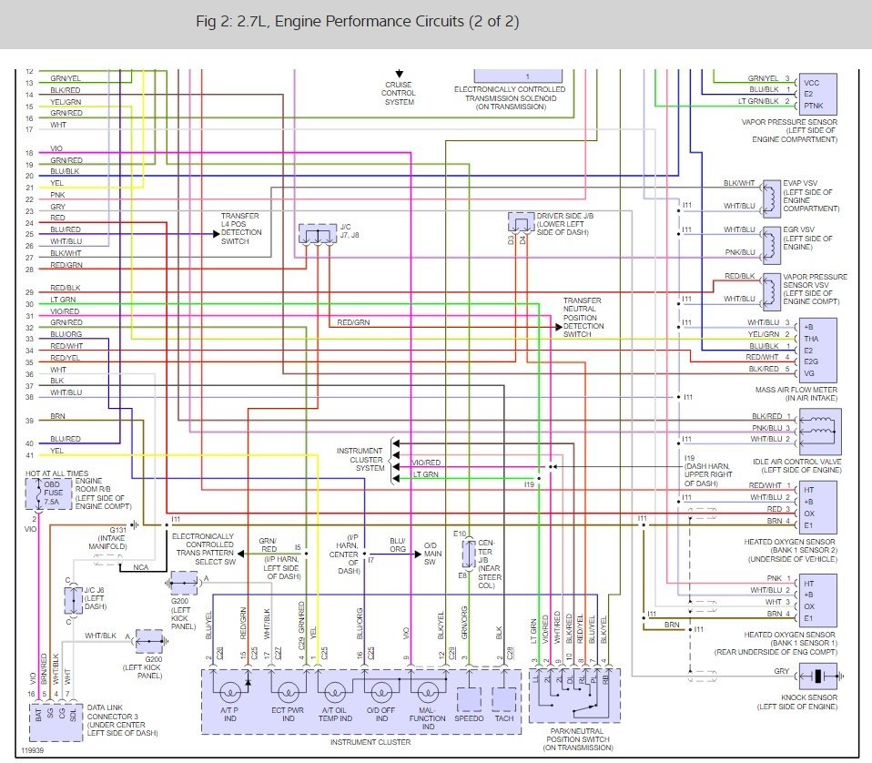

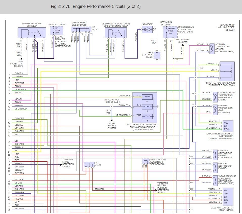

Try staring my vehicle but did not want to start, so I tried bleeding it, but find that there is no fuel going to the injectors. The fuel line is okay. Also, the fuel filter is alright but the last problem is that there is no fuel coming out or the fuel pump. Is there any else besides electrical?

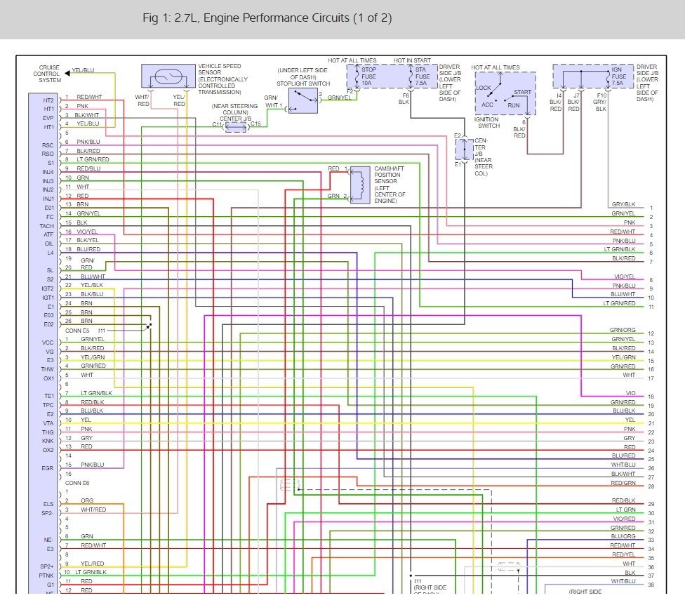

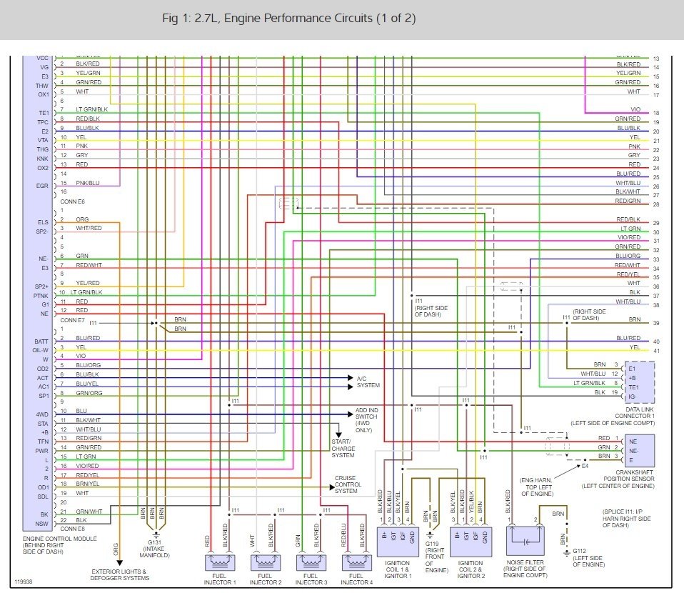

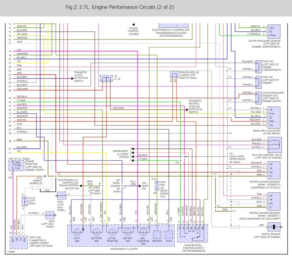

It sounds like the fuel pump or circuit open relay has gone out, to be sure we will need to run some tests. Also check the fuses that run the system as well.
Here is a guide and a wiring diagram (below) that will help you do some testing.
and
and
and
https://www.2carpros.com/articles/how-to-replace-an-electric-fuel-pump
Please run some tests and get back to us so we can continue helping you.
