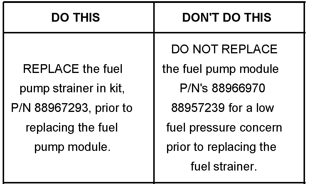

Also, there was a technical service bulletin (TSB) regarding driveability issues and no start conditions due to fuel pump related issues. The strainer on the fuel pumps would become blocked and required replacement. Here is the actual TSB:
_______________________________________
TECHNICAL
Subject:
Vehicle Hesitates, No Start, Lack of Power, Low Fuel Pressure (Test Fuel Pressure and Replace Fuel Pump Module Strainer)
Models:
2002-2003 Chevrolet Malibu
2002-2005 Chevrolet Cavalier
2004-2005 Chevrolet Classic
2002-2004 Oldsmobile Alero
2002-2005 Pontiac Grand Am, Sunfire
Supersede:
This bulletin is being revised to add a additional step to retest the fuel pressure after the strainer is replaced. Please discard Corporate Bulletin Number 05-06-04-026 (Section 06 - Engine).
Condition
Some customers may comment that the vehicle hesitates, does not start, and/or has lack of power.
Cause
The vehicle may have low fuel pressure caused by a restricted fuel pump strainer.
The current fuel pump has a 100 micron strainer.
Correction
Follow the service procedure below to test fuel pressure and replace the fuel strainer with a 200 micron strainer.

^ If the fuel pressure IS between 345-414 kPa (50-60 psi), fuel system pressure is not the cause. Refer to the appropriate SI Document for additional diagnostic information.
^ If the fuel pressure IS LESS THEN 345-414 kPa (50-60 psi), continue with the next step.

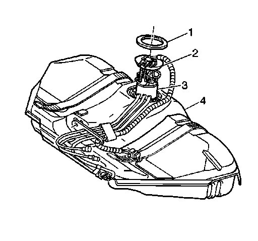

6. Remove the fuel pump module. Refer to Fuel Pump Module Replacement in SI. Use the appropriate SI Document depending on model and year.

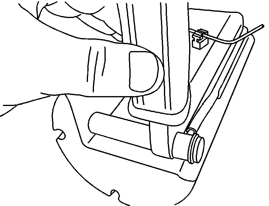

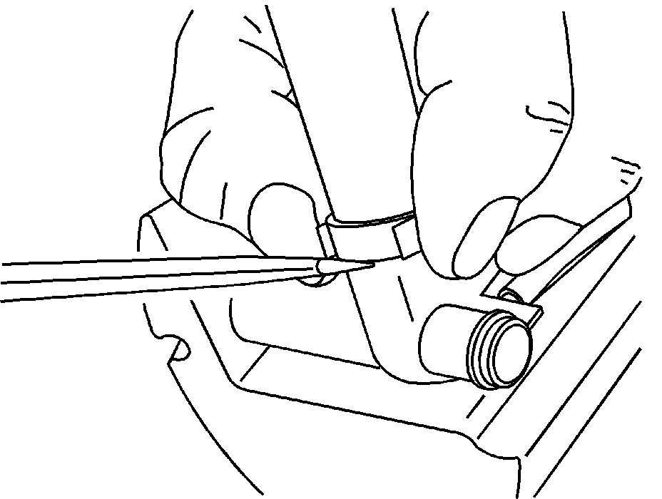

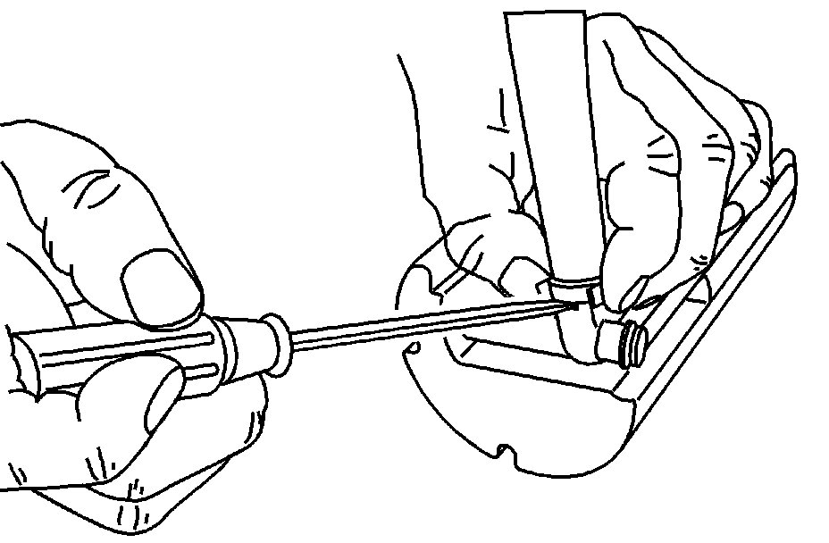

10. Insert the tip of a small screw driver between the strainer and the pot and push the screwdriver up slowly while rotating the screwdriver to pop off the strainer.

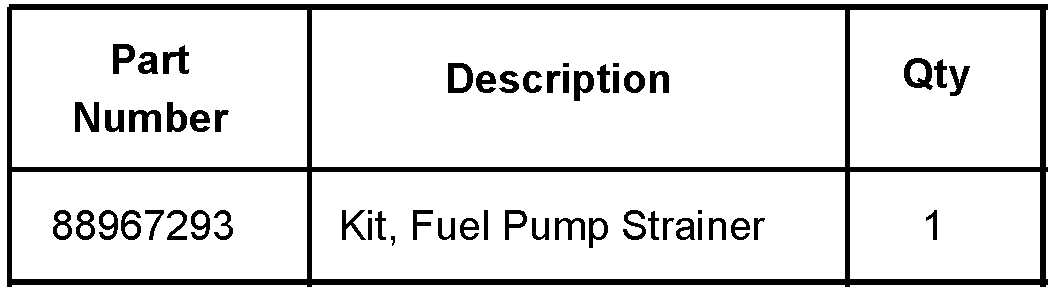

11. Install the new strainer from kit, P/N 88967293, as shown above until you hear a positive click sound.
12. Double check that the strainer is installed properly and there is no damage to the pot before reinstalling the fuel module.

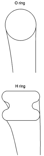

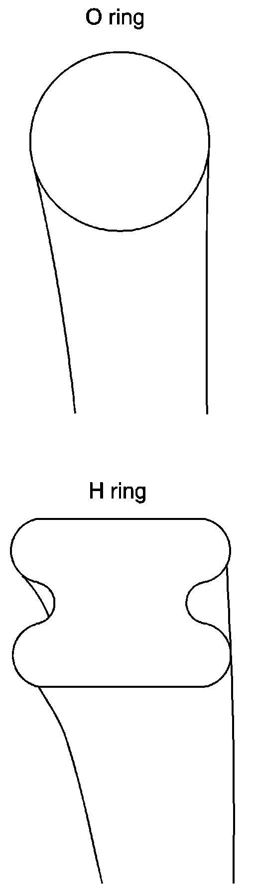

DO NOT reuse the old fuel pump module seal.
13. Remove the old fuel pump module seal from the fuel module.
Important:
The strainer kit, P/N 88967293, includes two new seals. It is critical that the same design seal be reinstalled that was removed.
14. Install the same design seal from kit, P/N 88967293, that was removed from the fuel pump module.

I mentioned the TSB because I wanted to be sure the pump was the issue and not a plugged strainer. The last picture is of the tank and fuel pump components being removed.
