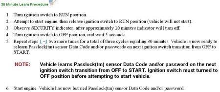

One more thing, try a different key this may be a anti-theft problem. The fuel pump is definitly not running right? The car does not start and stall right? The battery is at full charge and good correct, this may affect the anti theft. If there is anyway that you can get your hands on a code reader it may be very benficial. We may need to run through this, I'm just posting it while I have it handy
https://images.2carpros.com/forum/automotive_pictures/30961_passlock_1.jpg
https://images.2carpros.com/forum/automotive_pictures/30961_mitchel_18.jpg
