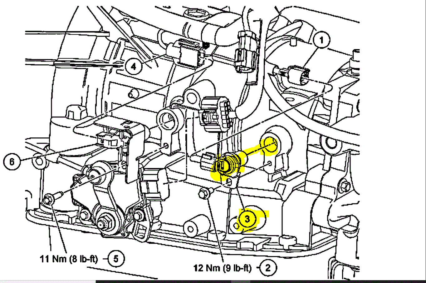

The P0720 indicates the output speed sensor isn't working. That is the likely cause of the speedo issue.

There is one thing you can check. The output speed sensor is on the left side (driver's side) of the transmission. Check the wiring and connector for damage, corrosion, and make sure the connector is tight. See pic 1 below for the location.

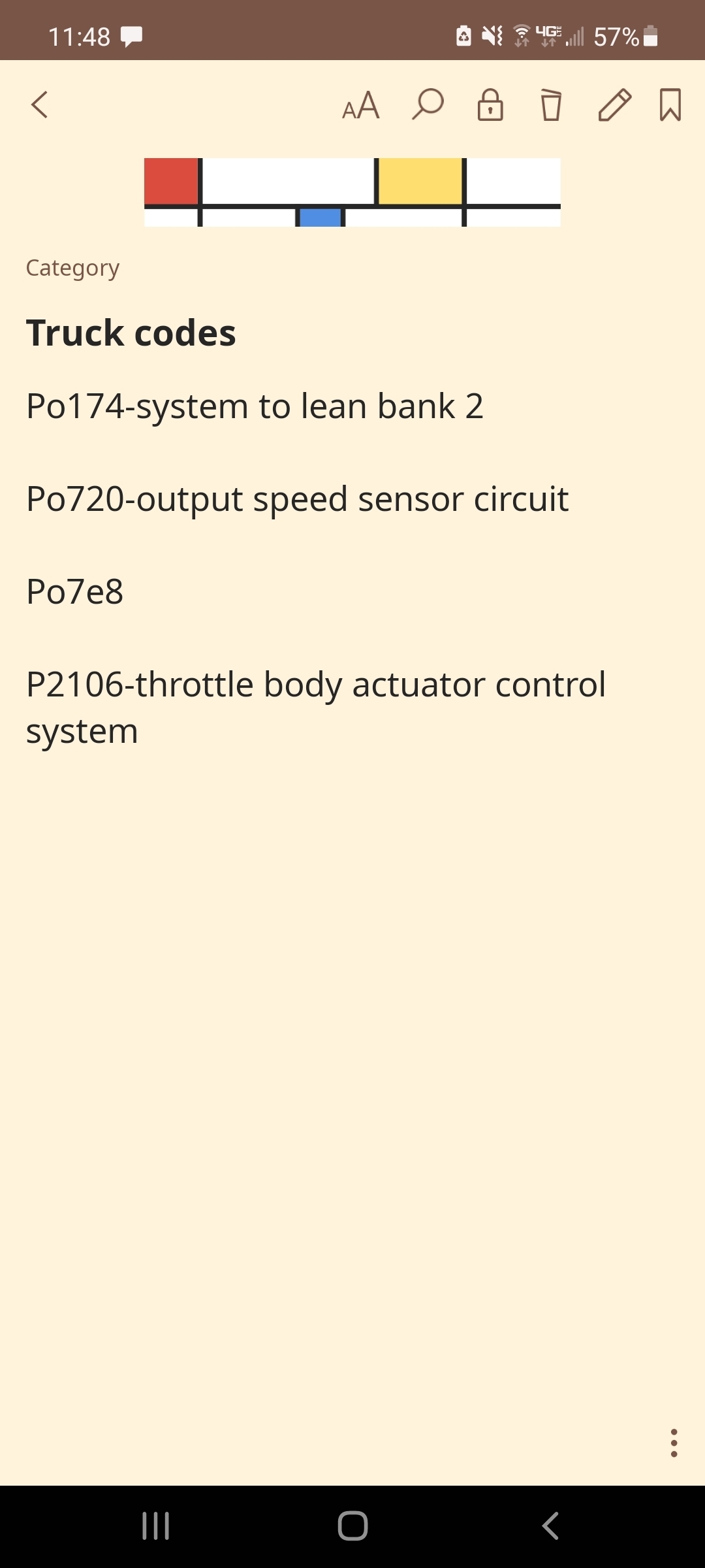

DYLANPETRIE19
These are the codes I got off my scanner the p07e8 did disappear after a couple of minutes of my vehicle running and my truck will go forward, but it acts like there's not enough power but if I manually put my truck into 1 gear it drives better and I'm able to move it.
