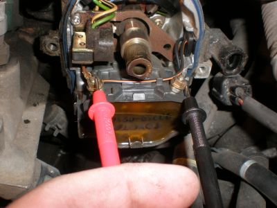

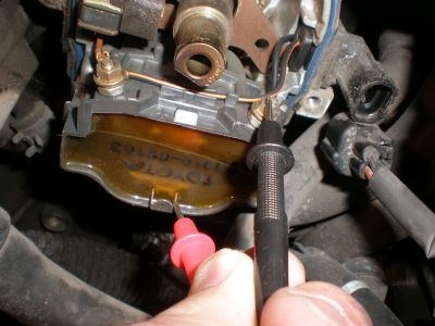

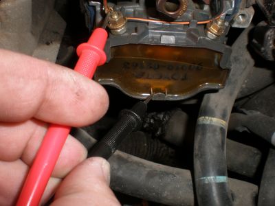

I unplugged the two cables going into the Distributor and set the Volt meter to 20k on the Ohms.
I believe this to be the coil!?
https://www.2carpros.com/forum/automotive_pictures/411849_PA030679_1.jpg
When I tested the positive and the negative it was sporadic, it didn't really give be an solid number.
Does this mean the coil is bad?
https://www.2carpros.com/forum/automotive_pictures/411849_PA030682_1.jpg
When I tested either the negative or the positive to this pole it gave me 11.54 - 11.68 on the ohm reader.
https://www.2carpros.com/forum/automotive_pictures/411849_PA030683_1.jpg
https://www.2carpros.com/forum/automotive_pictures/411849_PA030684_1.jpg
Another thing; Ive put this together to try and get a spark and when I open it up again the rotor doesn't seem to have moved from its original position. Ive tried this numerous times and each time it is in the same position. Does it just default back to the position when the engine in off?

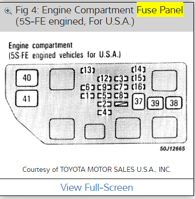

Its not the gas, stations go through way to much to have bad gas problems anymore. I sounds like you have an EFI relay that is going out which supplies power to the ECM I just fixed a car just like this which had the same problem in the shop the other day.
Here is a guide to show you how to check the relay
-1
Monday, February 22nd, 2021 AT 10:08 AM (Merged)

Yep, it fixed the problem thanks for the help on this I know it was an old thread.

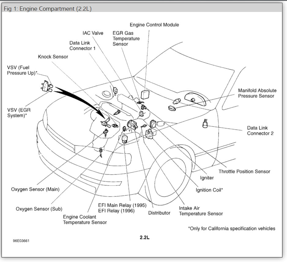

MANDYLGCLARK
  • 6 POSTS
Can you tell me exactly where the data link terminal is -I'm not sure where the bonnet is. And will this give me a code even if the check engine has never come on?
Monday, February 22nd, 2021 AT 10:09 AM (Merged)
STEVEW84
  • 673 POSTS
Bonnet=hood.I think the data link connector is near the strut mount.
