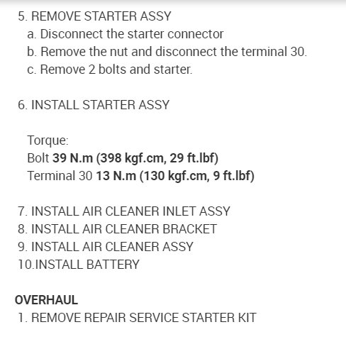

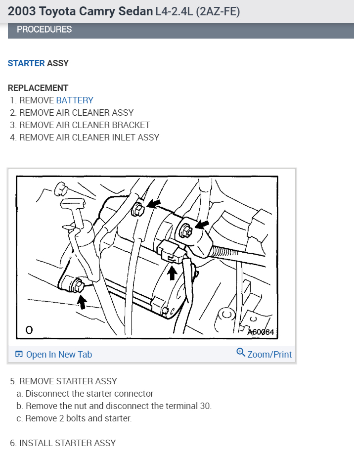

I need to replace the starter motor to my 2003 camry. The vehicle does not crank over so I want to do the job myself.
Oct 31, 2010 at 7:34 PM
BLUELIGHTNIN6
  • 16,542 POSTS
This guide will help walk you through the steps of replacing your starter with instructions in the diagrams below to help you for your car.
