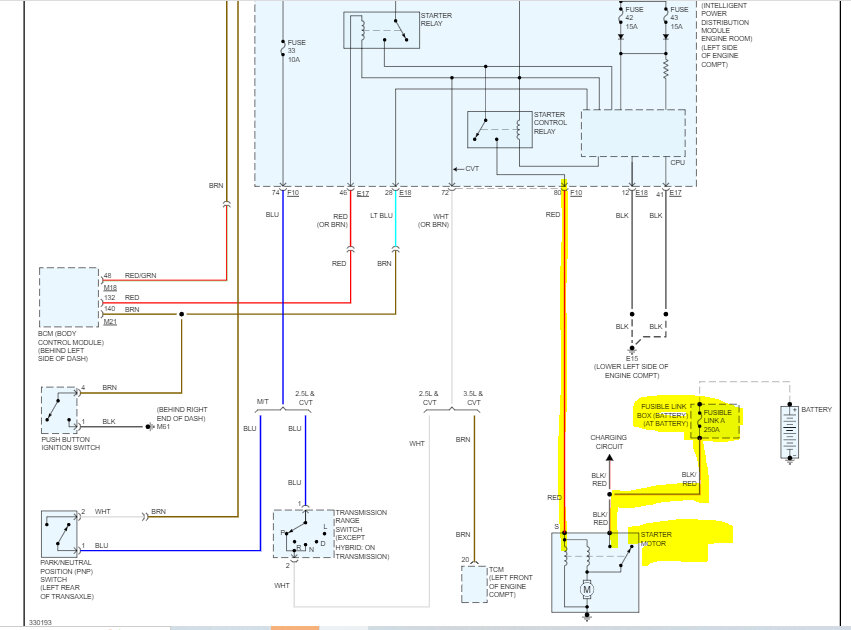

The load test showed no fault in the battery. I checked the voltage as well and it’s pushing 12 volts. There was slight corrosion on the positive node. I’ve checked fuses today and tried some tricks with the starter to no luck. I’m thinking it has to be some kind of electrical/wiring issue somewhere. The alternator and battery were both replaced in the last year. My brake switch is also good. The car recognizes my key and recognizes what gear I’m in. I also noticed when I rolled the car that I had to hit the brake pedal hard to stop the car, not sure if this correlates.
Jan 25, 2023 at 11:36 AM
  • 110,240 POSTS

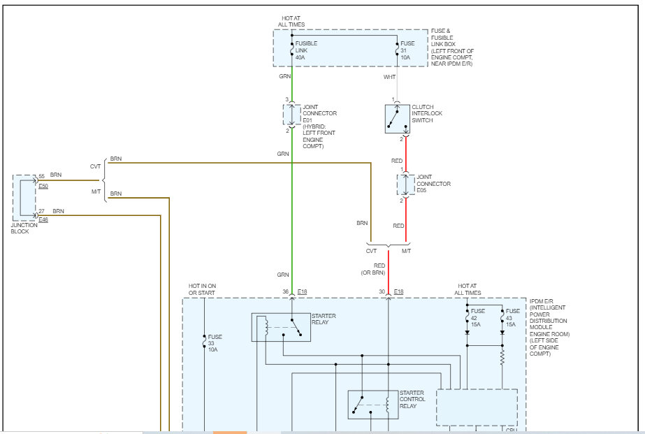

If the starter clicks, chances are it is either bad or we have an engine issue.
Do me a favor. I attached the starting circuit wiring schematic, so you have a reference. At the starter will be a heavy gauge black wire with a red tracer. It should have battery voltage at all times. Check that for me.
Next, there is a smaller gauge red wire that will not have power until the key is in the start position. Have a helper turn the key to start while you check if you are getting power to that wire.
Let me know the results. Also, if you could record the click you are hearing and upload it for me, it may be helpful
See pics below. Note: I had to cut the schematic in half to make it readable for you. I did overlap the two so you can follow from one to the next.

So, I’ve managed to make some progress. It appears my ECM fuse was blown. I replaced it and it blew again after 5 minutes. I replaced it a 3rd time and it’s going for about an hour now. I’m assuming there’s a short somewhere in the wiring?
Jan 26, 2023 at 5:45 AM
  • 110,240 POSTS
Is it fuse 42 in the under-hood IPDM? Also, I need to know if this is a coupe or sedan, if it is a hybrid or non-hybrid, and if are you located in CA. All of these factors play a role in the wiring schematics.
Let me know. Also, let me know if it is still working.
Jan 26, 2023 at 6:21 AM
JASON1098
  • 7 POSTS
It was fuse 42. It’s a sedan and non-hybrid. Car bought in Ohio. It was running then died on me at an intersection, replaced the fuse again and it ran again. I’ve had to do the idle relearn procedure after as well.
