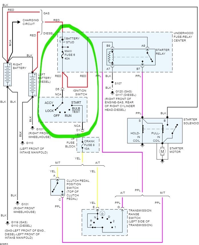

Okay, it sounds like power isn't getting through the ignition switch. Grab the test light, connect it to a ground. Pull the crank fuse, Turn the key to start, check both terminals, one should light it if there is power there. I'm betting it doesn't light. Now go to the ignition switch. Find cavity D1 with a yellow wire in it. that is the crank signal. Use the test light and probe that connection while turning the key to crank. If you have power there the light should come on, if it does the wire between that pin and the crank fuse is bad. If no light, find the red wire at terminal D5 and probe it, it should have full time power. If not, then the red wire between the connector and the fuse box is bad. Now because the starter does crank when you touch the crank fuse, we know that the maxi fuse is good as it supplies both, it has to be the wire. However, that wire only triggers the relay so you could just find another hot wire and run a jumper wire to handle it unless you want to dig out the dash harness to trace out that wire to replace it.

I tested yellow wire and it is hot. Tested red wire from there to starter relay and it is hot. Tested all fuses under the hood and all are good.
Apr 9, 2023 at 4:22 AM
STEVE W.
  • 15,308 POSTS
Okay, so you have power on the red wire into the switch. And when you turn to start the yellow wire gets power? Are you using a test light or a meter? If you jump power to the crank fuse, it turns over, correct? But is there power to the crank fuse when you turn the switch to start? If not, then that yellow wire coming into the crank fuse or the terminal under it that has the problem.

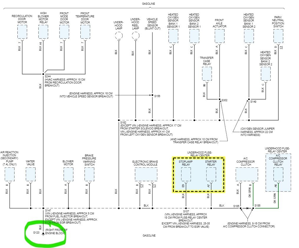

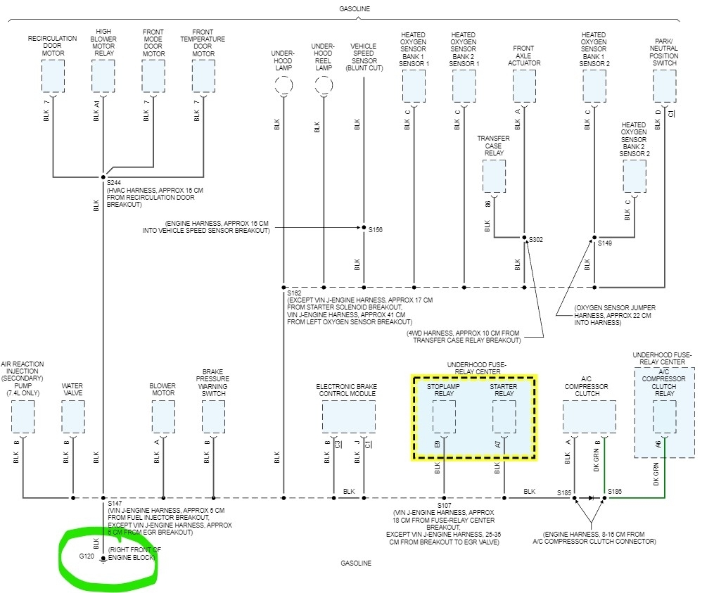

Okay, that isn't good. Without the key in the start position there should only be a single hot terminal that comes from the battery and when the relay closes it then sends power to the starter. The other two will be the control side of the relay and it seems the ground side has shorted to power. That is why it won't start with the key, with battery voltage on both terminals they cancel each other out and the relay doesn't trigger. So, we need to find the ground wire, it is black and should go from the fuse and relay center out to a ground connection at the right front of the engine block. It is the ground in this diagram. It shares that ground with multiple other items, one of which is the transmission position sensor.
I would find the bolt it connects to, then remove it, now test to see if you have battery voltage on it, if you do go to the items indicated and unplug them and see if one of them is shorted to power first. Like the AC relay, the brake light relay, the O2 sensors, possibly one of those got pinched when the engine was reinstalled.
Apr 10, 2023 at 1:26 AM
BROKE DOWN
  • 6 POSTS
Steve W. You were right on with your advice. Ground on front of the block was not making good contact. Thank you so much.
