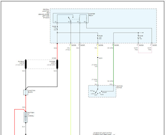

My truck won’t crank or start. I have replaced the battery, the alternator, the ignition, switch, neutral safety switches the belt, the starter it tested fine, replaced or checked all fuses and relays tested all the wires. I have no power going from the fuse box to the S post on the starter zero voltage tester the wires there’s no resistance and fuses numbers 30 through 33 have no voltage, however they used to but now they’re not working. need help I have to move. My truck been given a three-day warning six days ago.
Dec 26, 2023 at 8:12 AM
  • 55,455 POSTS

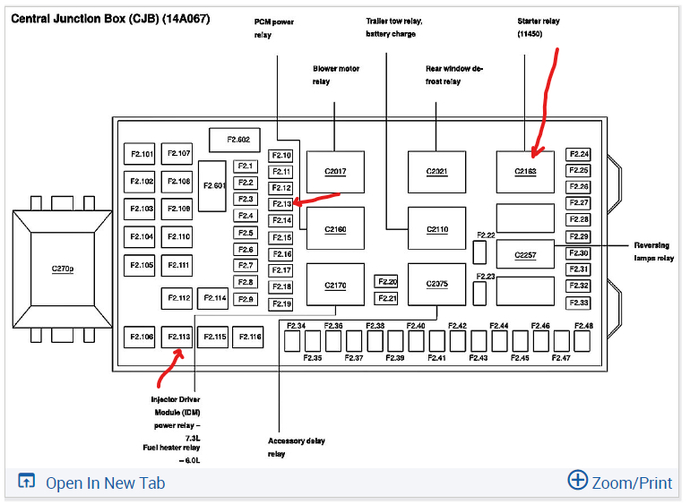

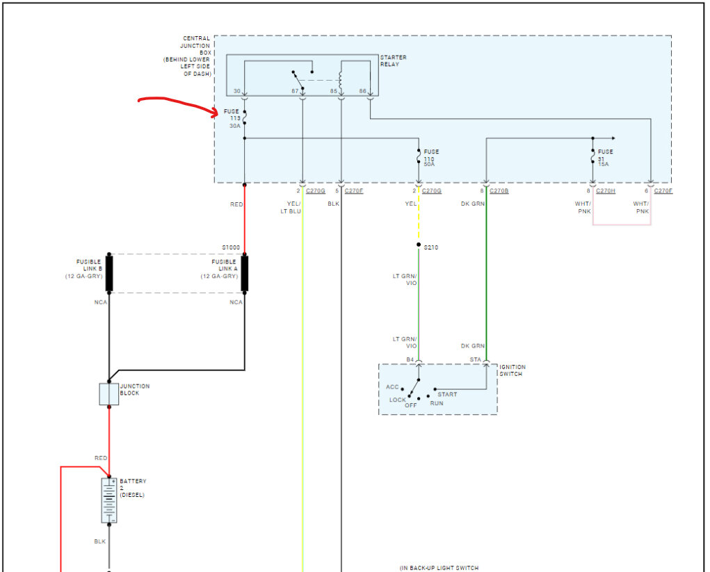

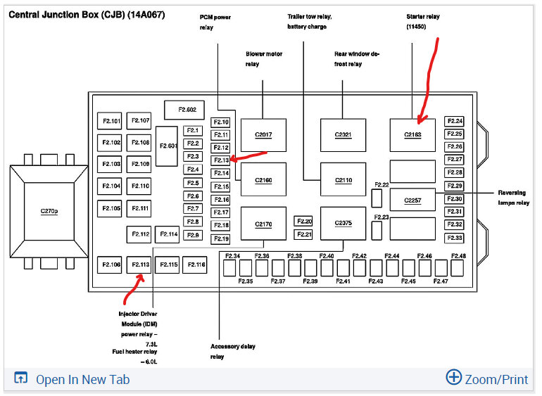

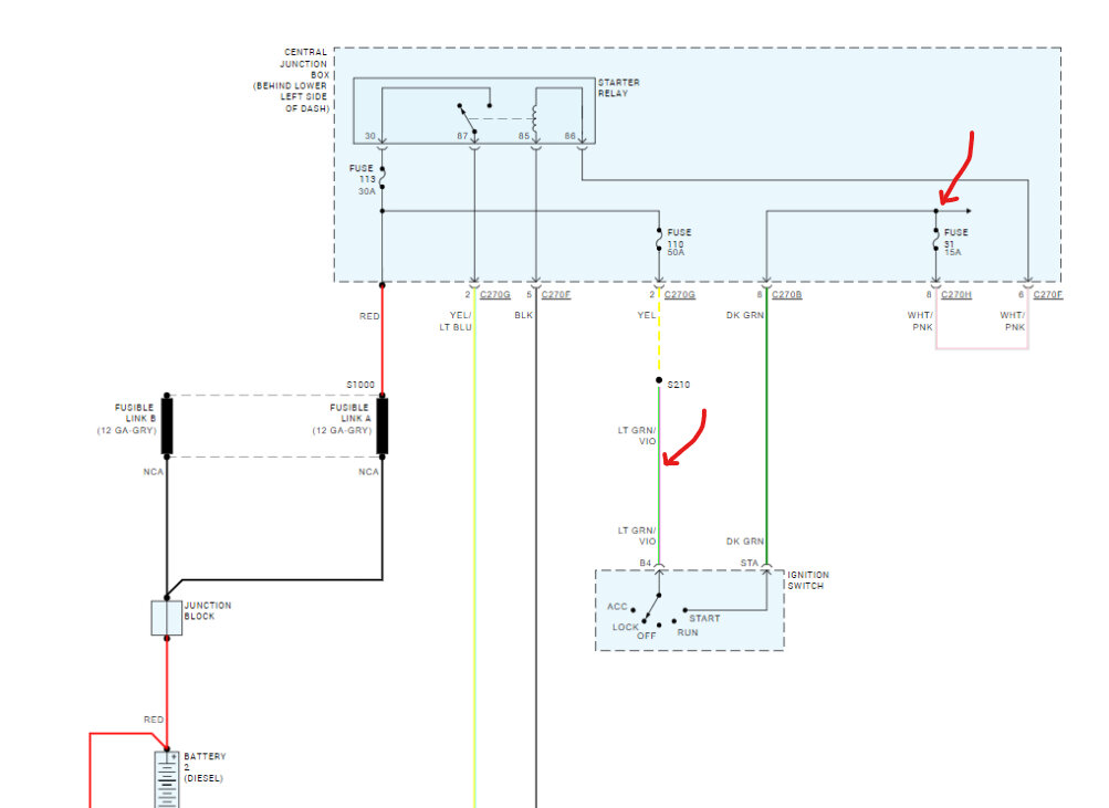

Yep, that is no fun let's get it running for you. can I ask if you tried to crank the engine over in neutral? Also, please check fuse # F2-113 and fuse # f2-31 in the fuse panel under the dash on the left side.
This guide can help:
If the fuses are okay let's swap out the starter control relay which is in the fuse panel under the dash on the left side as well.

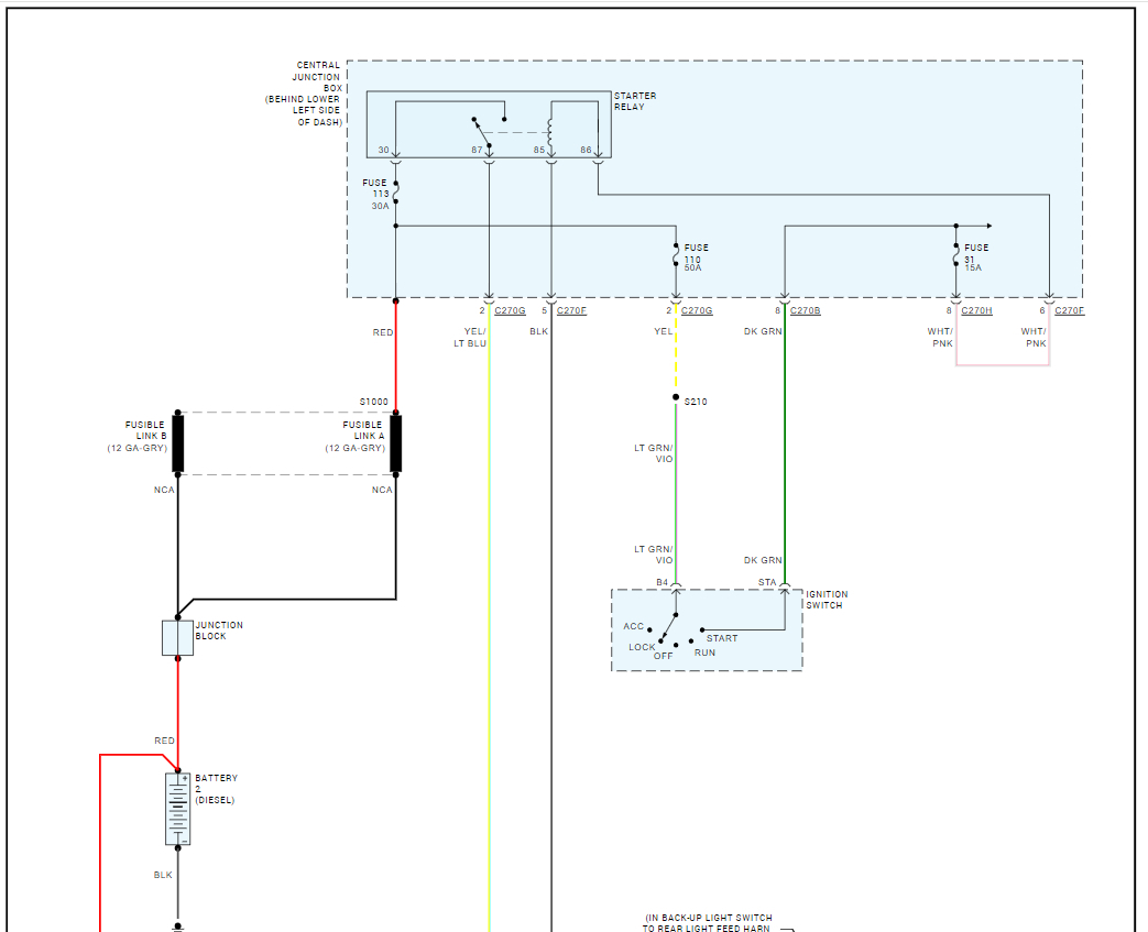

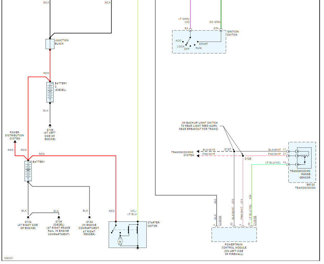

Here is a guide that can help, and I have included the starter wiring diagrams so you can see how the system works:
Check out the images (below). Please upload pictures or videos of the problem so we can see what's going on.

I don't see the video and if a fuse only has power on one side the fuse is no good. Do you have power at fuse f133? Please use this guide to check for power:

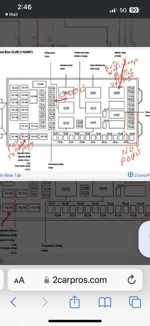

Dang, I uploaded 2 videos and 3 photos of some connections hanging down that have never been plugged in. I don’t see fuse f133 on the map however all fuses and relays are working except for the following f2.46 f2.30, f2.31, f2.32, f2.33. The fuses are good just no voltage.

Update: when I pulled a fuse out F246 there is power at the prong, but when I put a fuse in, I’ve tried several there’s no power on the end of the fuse, and I did see a little bitty spark when I put the fuse in I do have headlights, and the prong is live only when I turn the headlights on.

It takes time for the images and videos to upload from your phone so give it time please. Did you see the fuse panel images in the post above, it does not have a f133 fuse? It sounds like the central fuse panel might be bad.

Yeah, I noticed that. So, I waited for each to upload before I did anything else. But all things are pointing that way. Can you show me on the chart where f133 is there is a number 33, but chart has it labeled f2.33. Anyways I’m not sure if I talked about how and when this happened. I was listening to music without the engine running. I have a pretty good sound system, so I thought I’d better start the motor to charge the battery. It was dead. I jumped it with a jumper box started fine. Drive home and when I went to start it was dead and hasn’t moved since. I tried to jump but got nothing. It’s just odd how it would have fried at that moment. I guess I’ll go to the junk yard and try to find a replacement. They don’t have any my year so do you know if any other years will match my truck?

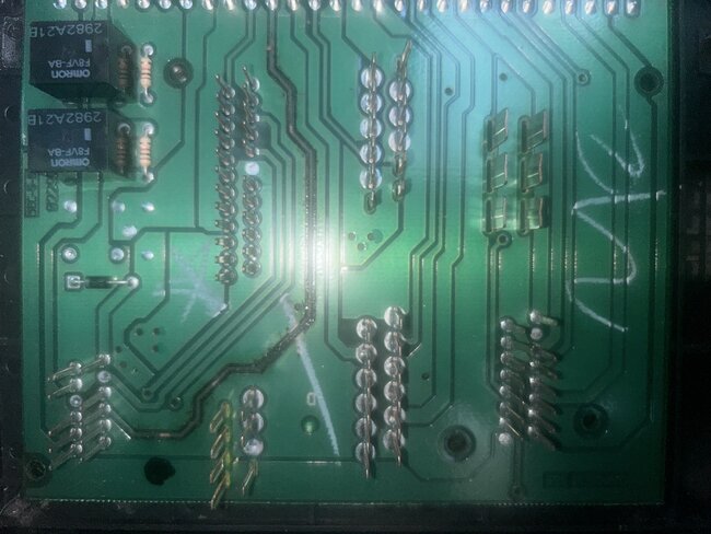

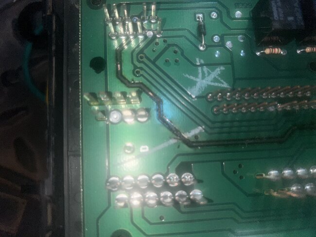

WHITEWULLFF
  • 51 POSTS
Couple pics of inside fuse box does look burnt in one spot.
Dec 30, 2023 at 7:43 AM
  • 55,455 POSTS

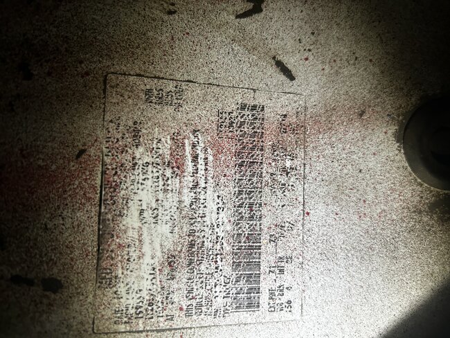

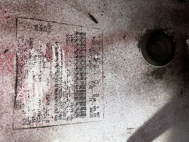

Sure, here is the fuse in question and you might have found the problem because the circuit board does not look good at all. Can I ask what is the production date of the truck, it should be in the driver's door.

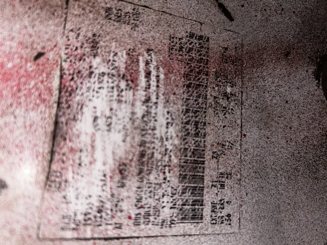

Sorry for the delay, I ordered a fuse box it took a week. Put it in still nothing. Here is a pic of the sticker on inside door but it’s hard to read.
Jan 9, 2024 at 1:06 PM
  • 55,455 POSTS
Do you have power at the f113 fuse?
Jan 10, 2024 at 8:29 AM
WHITEWULLFF
  • 51 POSTS
There is no f113 fuse. At least nothing is labeled f1 anything on the diagram for my fuse box. They are f2. I just spoke to the Ford dealership. They don’t want to take my truck because it’s too old. He said this year of trucks having problems with the wiring harness or too much resistance in the battery cable. He also said the cable going from battery to battery I don’t know what that means as I only have one battery.

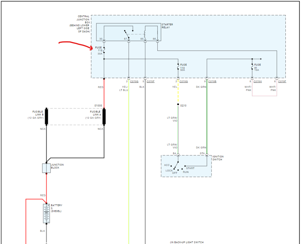

Also, I see where your diagram says f113not sure which 30amp fuse it is but I’ll check for power down that row.
Jan 12, 2024 at 11:47 AM
  • 55,455 POSTS
Do you have power at terminal 30 of the starter relay?
Please go over this guide:
Please go over this guide and get back to us.

You should have power at both prongs, is the fuse blown? and you should have power at terminal 30 if not this is your problem. Please reference the starter relay wiring diagrams above.

Sorry for the confusion when you said terminal 30, I thought you meant fuse 30. I measured battery voltage on the two inlets in the junction box where the starter relay plugs in. I tested only the two terminals that you use to jump. They both have battery voltage. But now when I try to jump nothing happens. The one fuse terminal in question is noted in my drawing I believe is 113. The upper prong lights up but the lower prong or terminal is dead. Also, in drawing the small fuses have no power. I think somehow 113 is connected to the other fuses through the motherboard. This is exactly what my first fuse box did and why I replaced it. So, I need to know which wires feed those terminals. Either that or I burned up a second fuse junction box. I haven’t taken it apart to check.
Jan 14, 2024 at 7:01 AM
  • 55,455 POSTS
So, if you turn the ignition key to the crank position can you feel the starter relay click?

Okay, let's check for power at fuse # 31 with the key on, also if you have power there please check the ltgrn/vio coming out of the ignition switch in the crank position which you can get to by the steering column.

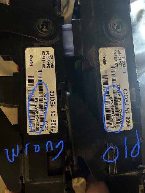

So, it turns out that eBay vendor sent me the wrong cjb. I’m sending it back today. It does seem odd though that it has the exact same issue with the wrong junction box. Either way I will be back as soon as I receive the correct one.
I also stumble on a very long forum page with some people having trouble finding the correct cjb for example mine 2c7t-14a067ap vs 3c3t-14a067bh and many variants could be problematic locating the one my truck will accept as well as I may have to have it reprogrammed. They also talked about replacing the ECM and other components. I know I’m getting ahead of myself here I’m just hoping it isn’t worst case scenario. Regardless I appreciate all of your guidance and will be back as soon as I get the new part.
