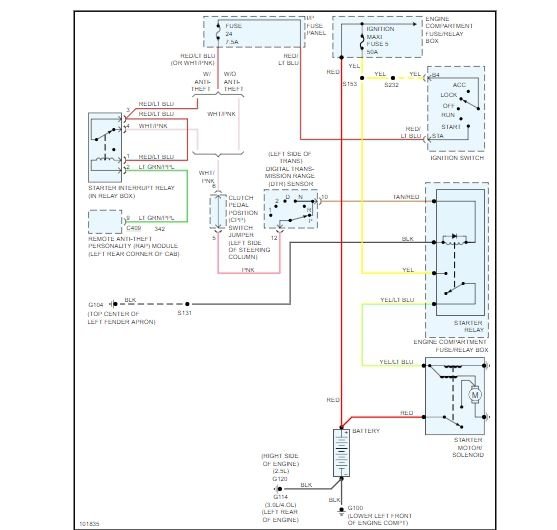

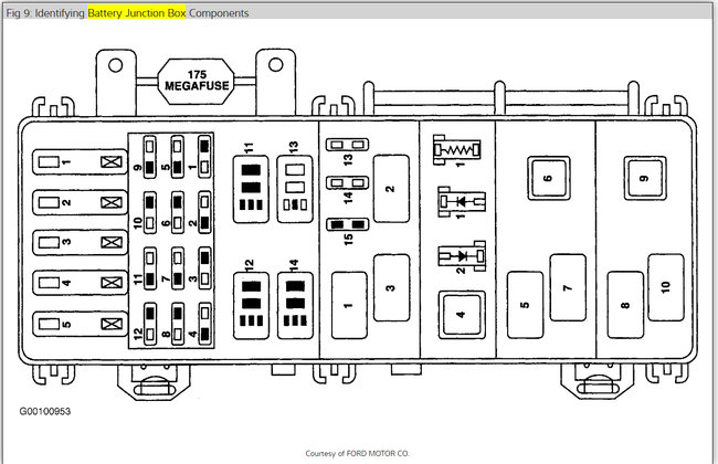

Truck starts when starter relay is bypassed. Relays are good, fuses are good.

This sounds like the starter relay is having problems or the battery needs to be load tested these guides can help us fix it.

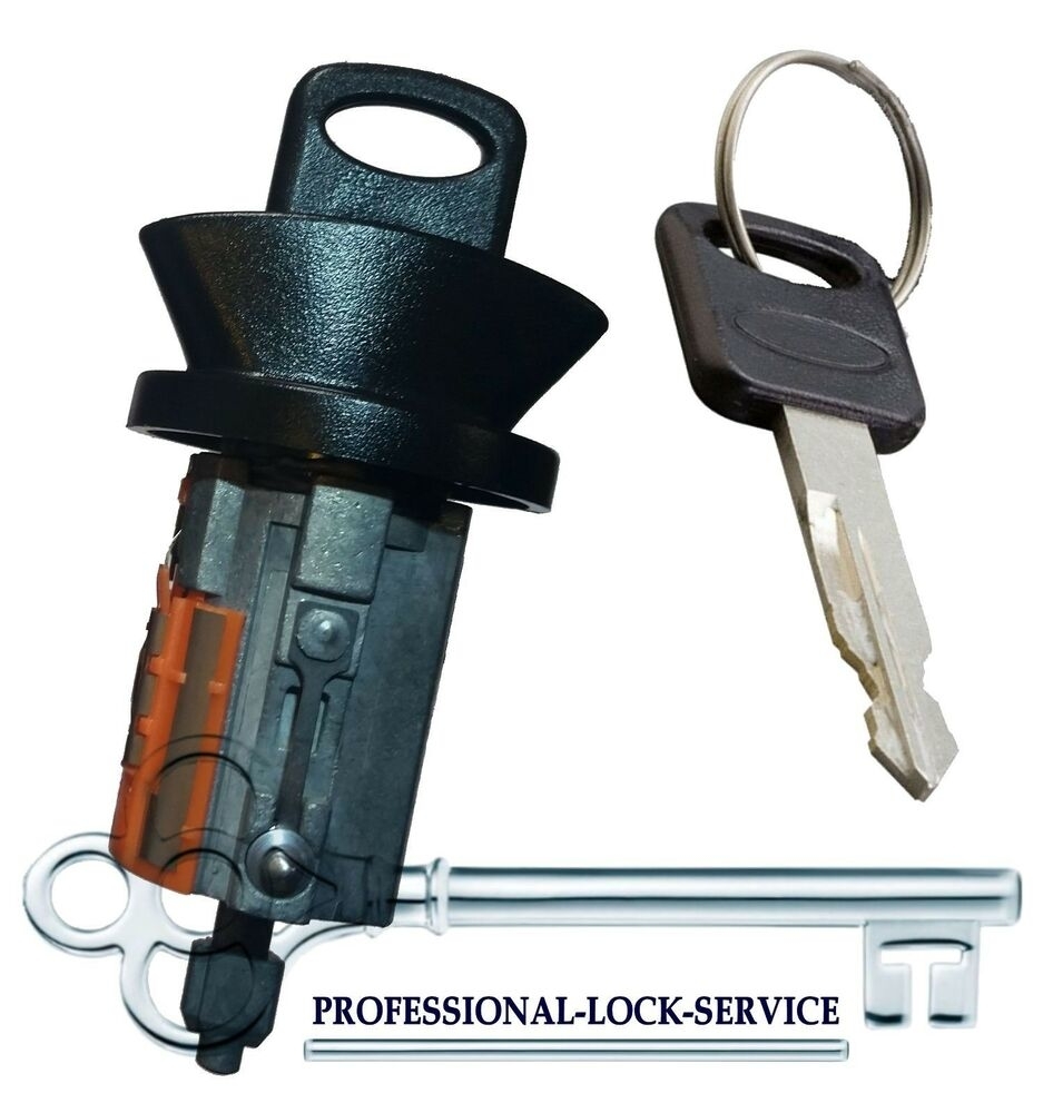

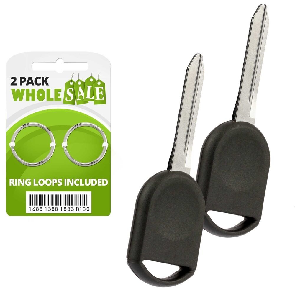

It depends if this vehicle is equipped with the passive anti theft system (pats) or not, diagnosis wise, on how we approach diagnostics. What does your key look like? I've attached pictures of two examples of key types, the first on the left is pats and the other is non-pats. Check out the diagrams (Below). Let us know what happens and please upload pictures or videos of the problem.
Aug 19, 2019 at 6:06 AM
AUSTIN KIRK
  • 6 POSTS
The key I have is like the picture on the right.
Aug 19, 2019 at 6:11 AM

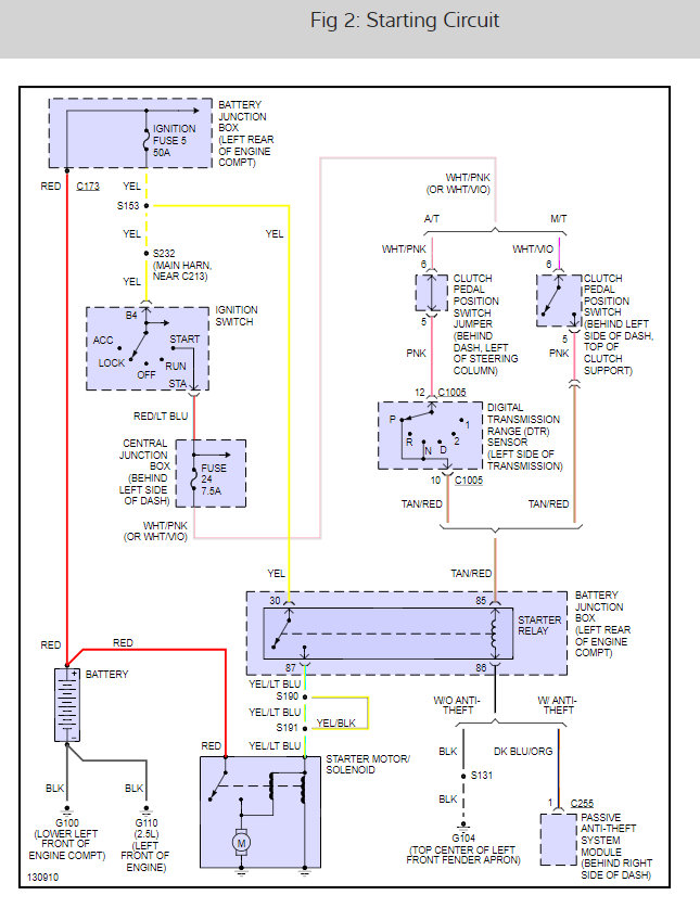

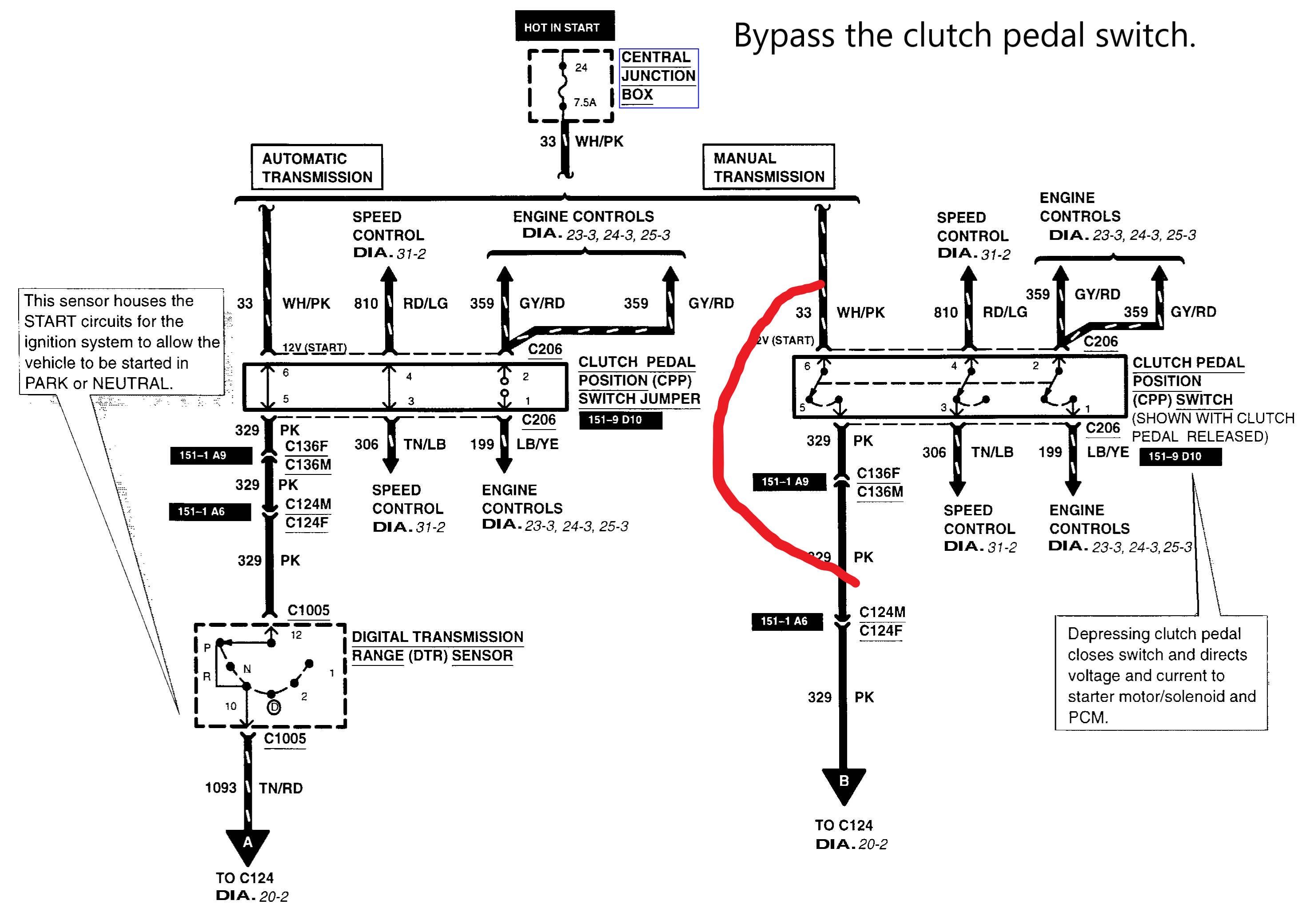

I attached two illustrated diagrams of the starting system and a quick way to narrow down your search for the problem. First is to bypass the clutch switch, and if this works then you'll need to verify that the switch is getting power etc. The second is supplying the relay with a ground. I this works then you'll need to either find the faulty ground or just supply your own ground. I have actually had issues with the pins at this relay so you may have this thing beat at the relay box. This guide can help us fix it
Please run down this guide and report back. Good luck!
Aug 19, 2019 at 6:39 AM
AUSTIN KIRK
  • 6 POSTS

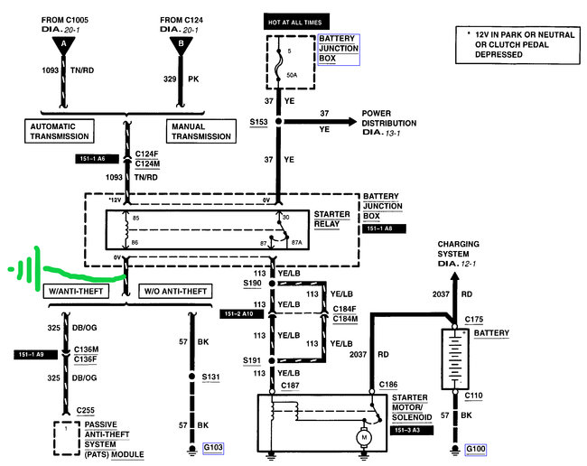

I have done the first task with no action. Also the clutch switch and my ignition switch are both brand new. I just added a ground on the 86 pin of the starter relay, that did not work either.
Aug 19, 2019 at 7:36 AM
BMDOUBLE
  • 1,139 POSTS
Are you using an inline relay tester to hook the ground and bypass? or are you going at it from underneath the relay? because I've had green corrosion on the under side of the relay wiring that I've had to overlay. Also verify 12 volts available at the 85 and 30 pin, I'm sure you have at at the 30 pin because you bypassed the relay there, at least it sounds like you did. If you have good voltage at the 85 and 30 pins, ground at the 86 pin and still no action, the relay is bad.
Aug 19, 2019 at 8:43 AM
AUSTIN KIRK
  • 6 POSTS
I went underneath the relay to tap in a ground. The connections there are not corroded. Also I do have 12v at the 30 pin and at the 85 pin I do not have voltage until I turn the key. And the voltage at the 85 pin is not 12v. Its not consistent but its lower voltage. I need to check the ground at the 86 pin. I have swapped the starter relay and the blower relay and the problem still persists.
Aug 19, 2019 at 9:06 AM
AUSTIN KIRK
  • 6 POSTS
At the 85 pin when the key is in and the clutch is in the voltage is 0.37volts. When I turn the key the voltage goes to 3.7 volts at the 85 pin. The 86 pin has continuity to ground.
Aug 19, 2019 at 9:14 AM
BMDOUBLE
  • 1,139 POSTS
So somewhere on that circuit that goes to the 85 pin there is resistance or the clutch switch is faulty. You can either overlay that circuit or trace out where the resistance is. There should be a solid 12 volts there. If there is low voltage when the clutch switch is bypassed, the circuit has resistance for sure.
Aug 19, 2019 at 11:59 PM
AUSTIN KIRK
  • 6 POSTS
Thank you so much. You are awesome. I appreciate your help with this. Now I need to find the source of the resistance.

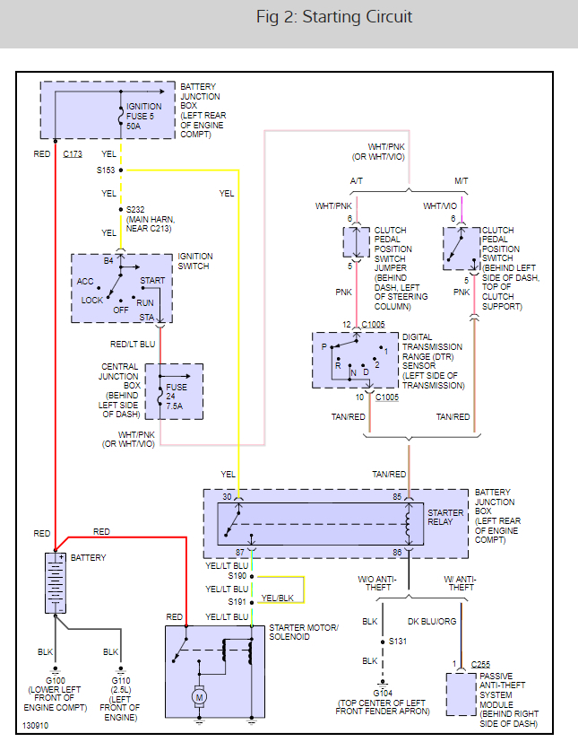

Have tested starter, starter relay and clutch safety switch, all tested okay. Vehicle will start if jumping starter relay with key on. Not sure how to test if ignition is the problem. Is there anything other than the ignition and what I have described to be the cause of this issue?
Mar 8, 2021 at 9:27 AM (Merged)
  • 55,732 POSTS

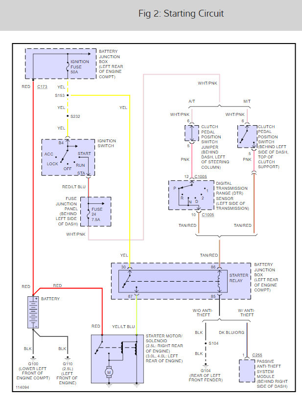

I will help you get the problem fixed. You must be losing trigger signal somewhere. Here is a guide to help you do some testing. It sounds like the ignitions witch has failed.
Below is a wiring diagram for the starter.

I suggest you load test the battery when it is hot to determine is the battery is the issue. It may be a weak battery.
I also attached a wiring diagram of the starting system. Verify power to the starter solenoid when cranking.

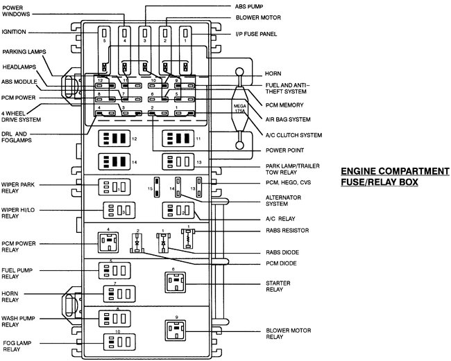

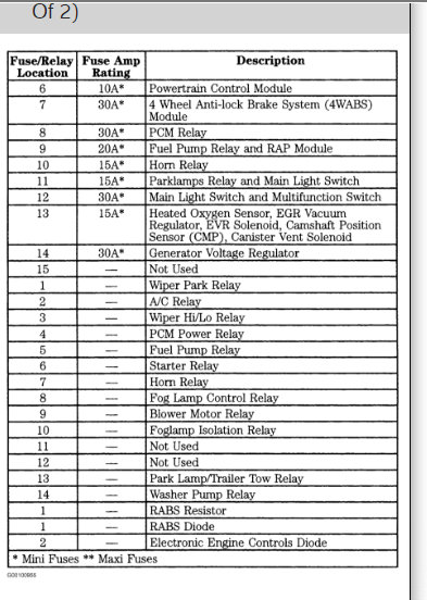

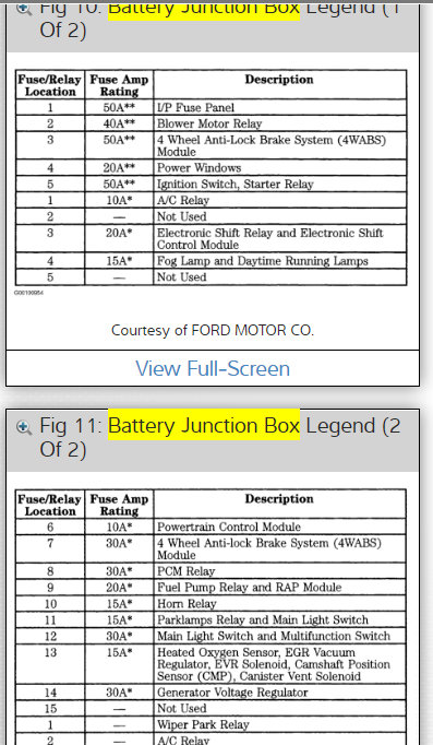

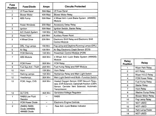

Since you did a major repair, I suspect that something was left disconnected. First, since there is now power to the vehicle, my first guess would be the main ground from the battery. Check to make sure you reattached it or if it was damaged.
I attached a portion of the wiring schematic for you to review. It indicates two grounds from battery. First, check the one that is lower left of the engine block.
Next, check the 50 amp maxi fuse (number 5) in the under hood power distribution box. See pictures 2 and 3. This guide can help us fix it
Check out the diagrams (Below). Please let us know what happens. Let me know what you find. Joe
