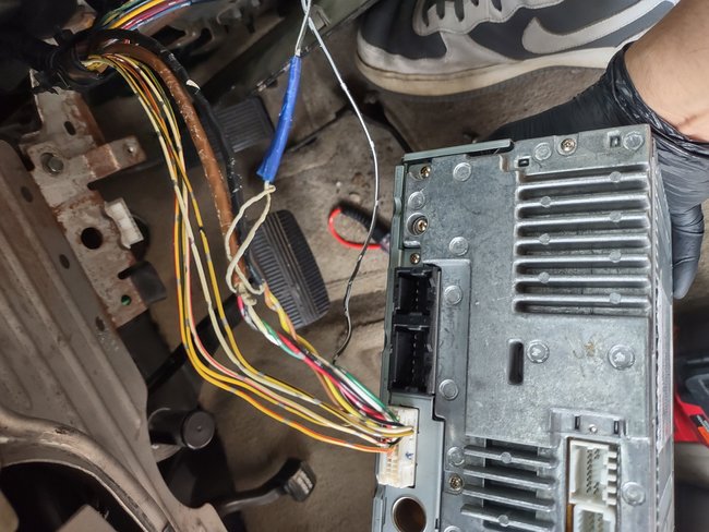

So, I went to replace my factory radio with an aftermarket radio. Switched out the radio and now my car won't crank over. All the lights work and my battery is good, my starter is good. The car was running perfectly fine before I went to switch out the radio.

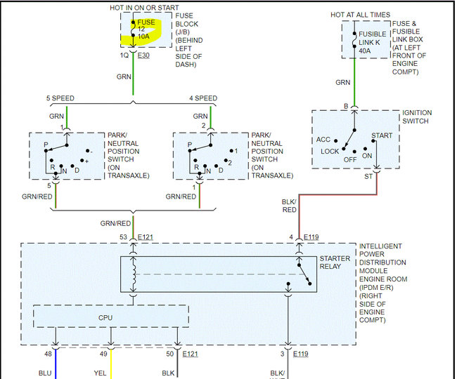

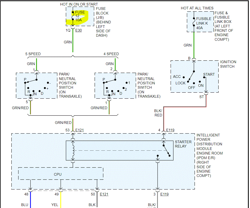

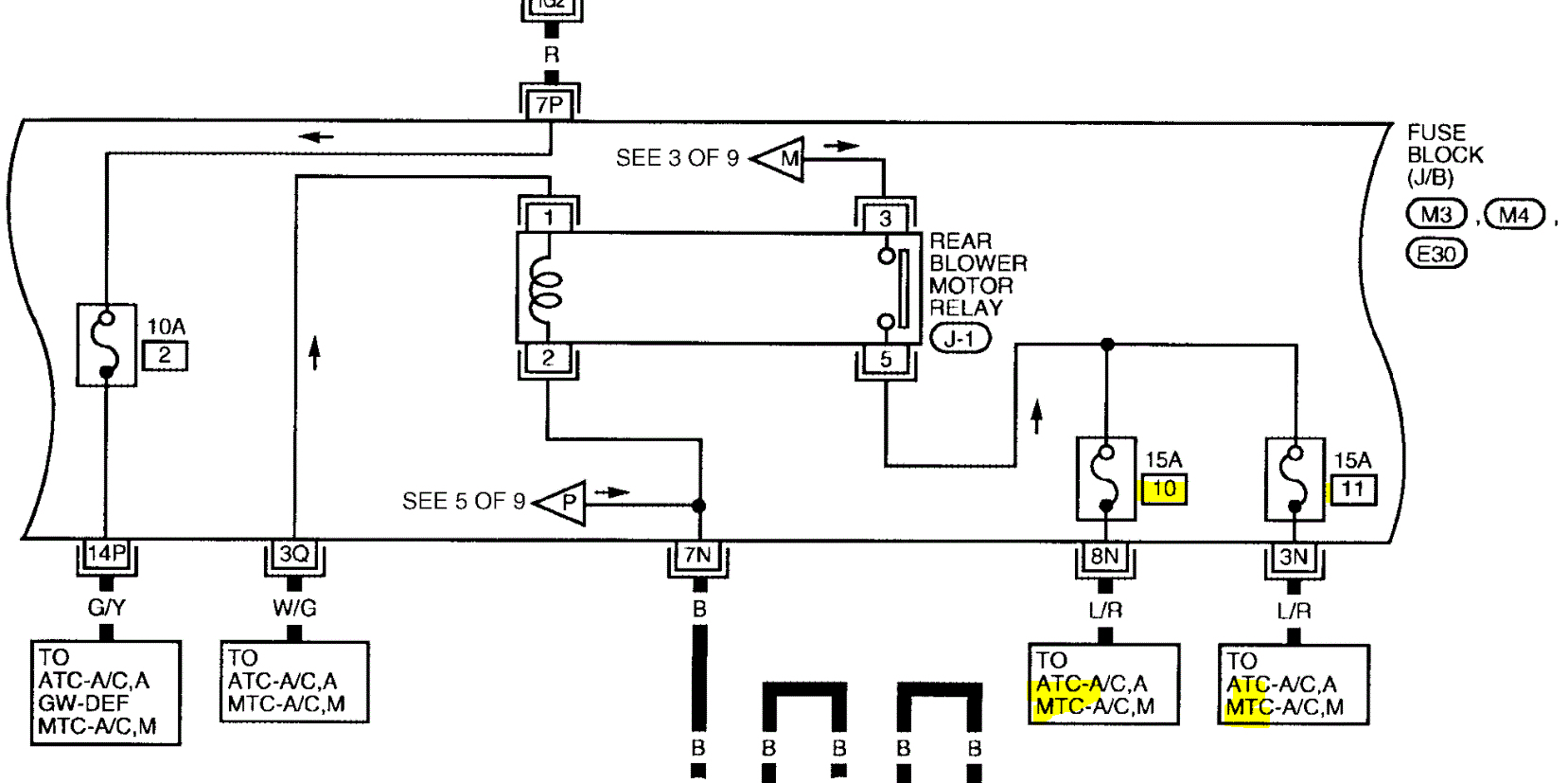

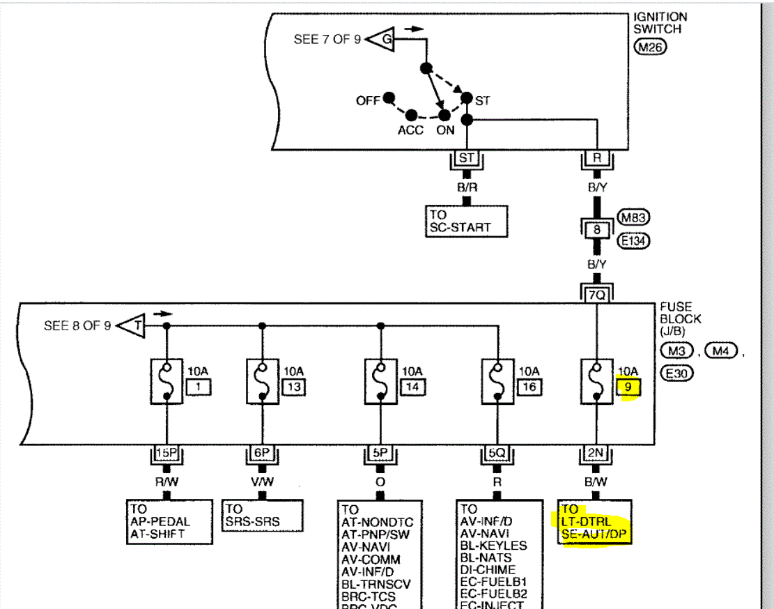

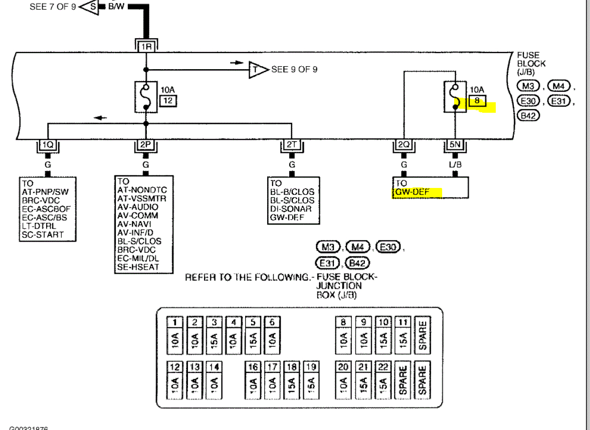

If you mean the starter isn't engaging, I need you to check fuse 12 in the fuse box under the dash on the left side.

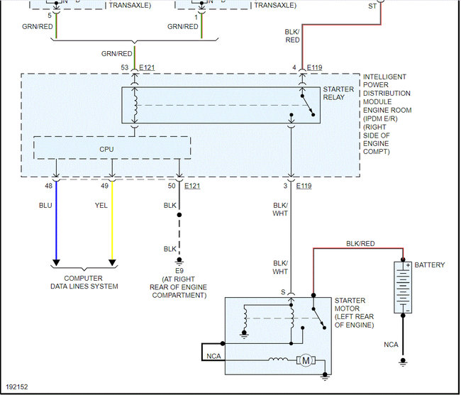

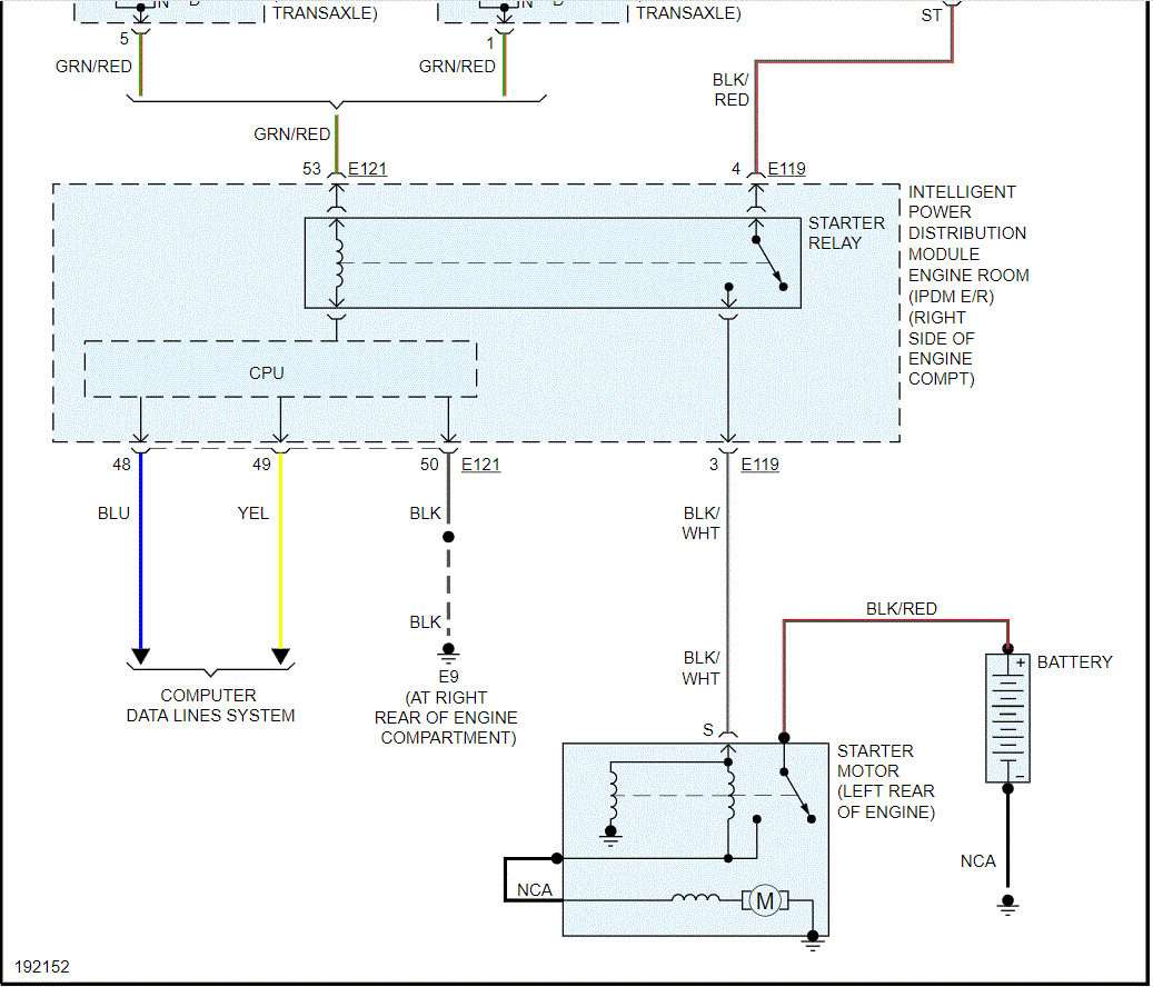

I attached the wiring schematic for the starting system. I had to cut the pic in half to make it readable, but I did overlap them so you can follow them.
Check the fuse first and if it appears good, I need you to confirm there is power to and from it. Here is a link you may find helpful:
Let me know what you find. Also, let me know if all other electrical components are working.

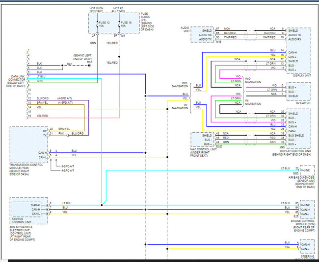

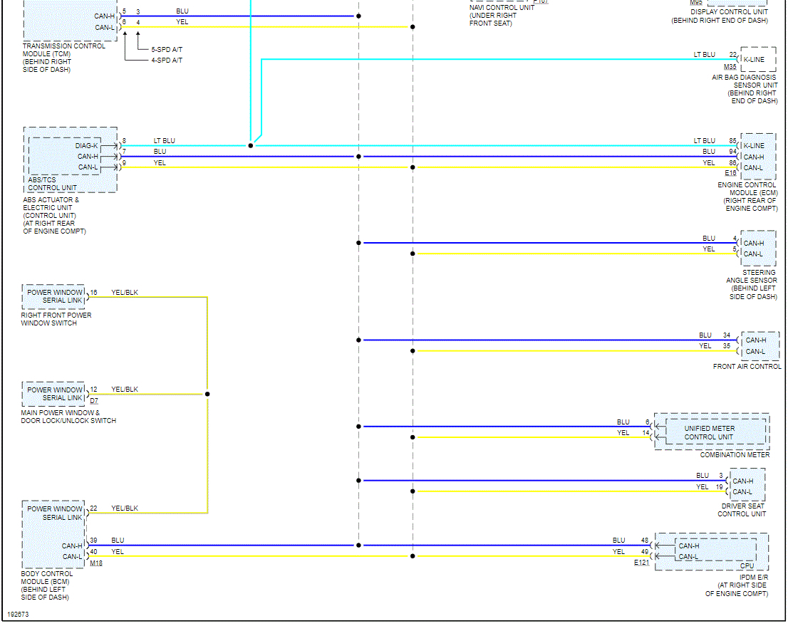

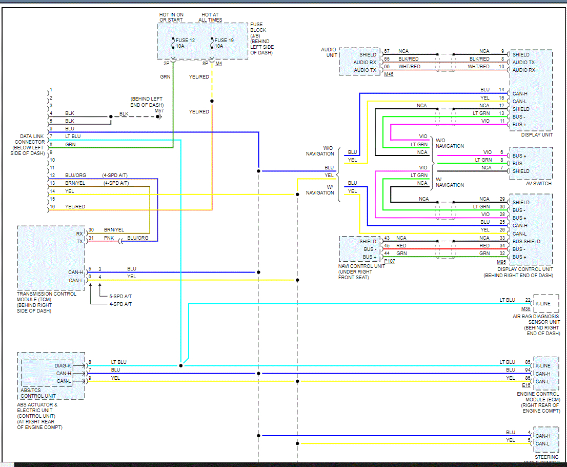

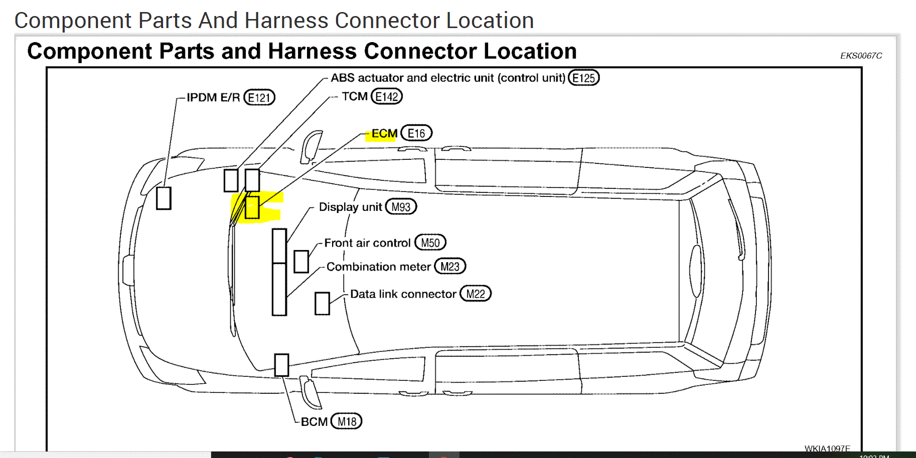

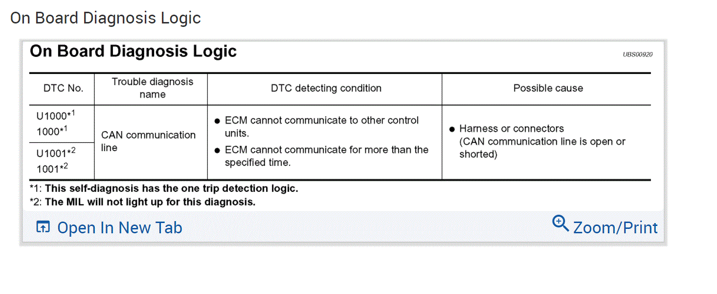

Something with the CAN is causing the issue. When you have the codes related to the NATS and the CAN, you have to start with the CAN (U1000 and U1001).
With that in mind, I don't feel it is the ECM. Instead, somewhere you must have by accident damaged or disconnected the CAN communication line.
First, please understand that when I look up the P codes you provided, the first thing it says is if a U1000 or U1001 is present, start with diagnosing those codes first.

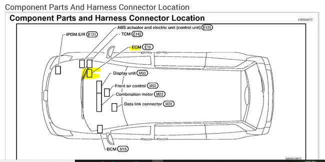

If you look at pic 1 below, it explains what could be causing the U codes. Pic 2 shows the location of the ECM. Since you were working in the dash, that is where I feel the problem is and not the ECM itself. Note there is a NATS antenna amplifier center dash and the BCM is on the left side of the dash.
Pics 3 and 4 are the wiring schematic for the CAN bus system. Note there are only three wire colors used, light blue, blue, and yellow. Also, note they are all connected via dashed lines. That indicates they are all connected in a network and able to communicate via those few wires.
Now, when checking for problems, you need to check the wire colors (only three) that connect at the ECM. Make sure nothing was damaged, disconnected, or cut. At some point, there is an open circuit meaning no connection. That is why your vehicle won't start.
If you look at pic 2, I highlighted the ECM location. On the opposite side of the dash is the BCM (body control module), and in the center of the dash is the NATS antenna amplifier. . Since you are having codes related to the NATS, I have a feeling the communication between the ECM, BCM, and the NATS antenna amplifier (center of dash) has been damaged.
If you look at pics 3 and 4, the wiring schematic shows how things are connected. Check for damaged or disconnected wires in that system. Note that I had to cut the pic in half to make it readable. I did overlap them so you can follow easier.
Again, don't purchase an ECM or PCM. I feel it is unlikely that either is bad.

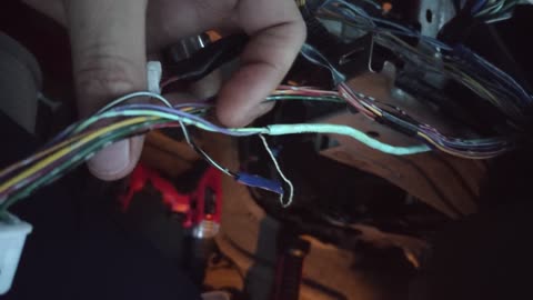

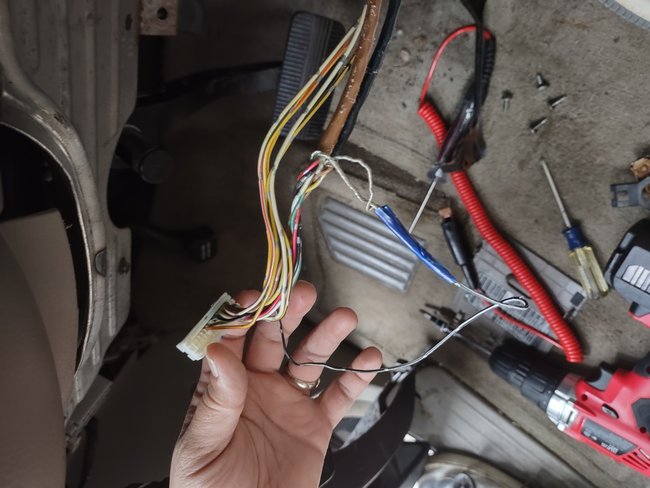

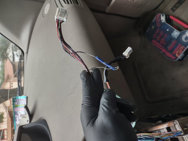

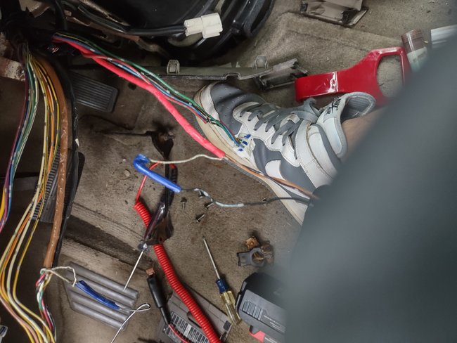

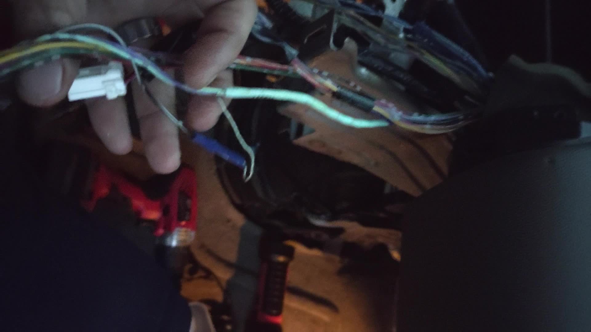

I had my car towed to my house yesterday and I started to look for the open circuit, and started to smell something burning inside my dash. Since it was already dark out, I took my keys out of the ignition and called it a night. Will look again today after work.
May 17, 2021 at 2:04 AM
JERRY LEDESMA
  • 22 POSTS
So this is where I'm at. What to do now?

Are all the wires melted? If that is the case, the harness will need to be replaced. Let me know.
May 17, 2021 at 2:22 PM
JERRY LEDESMA
  • 22 POSTS

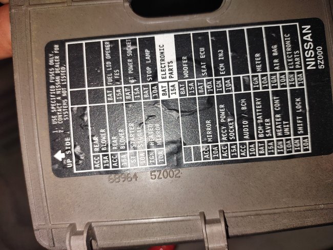

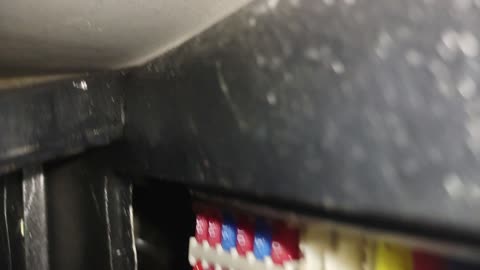

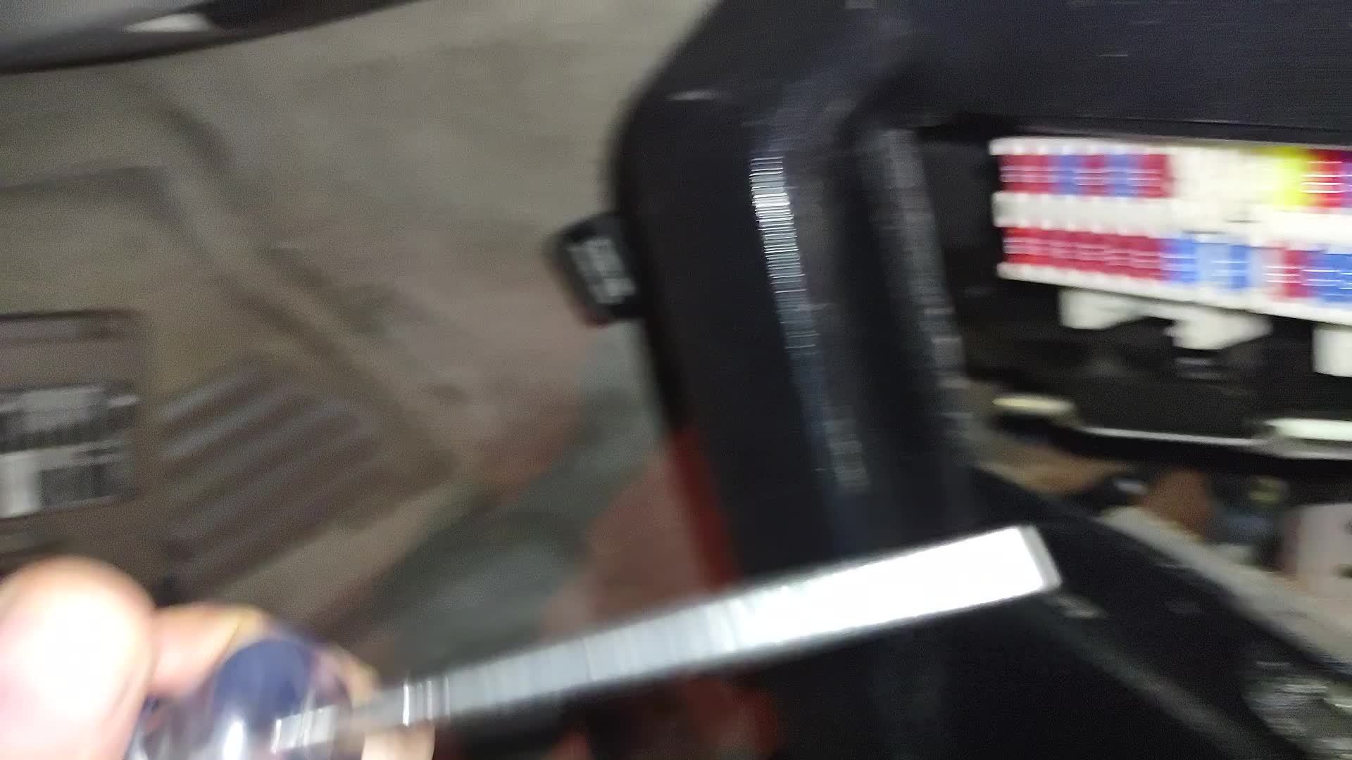

No. I didn't see none that were melted. And what about that fuse box. The first 4 fuses, (11,10,9,8) have no power and when I turned the key to the on position, I started to smell something burning.
May 17, 2021 at 4:13 PM
JERRY LEDESMA
  • 22 POSTS
There are more wires with electrical tape on them that I haven't got to yet.

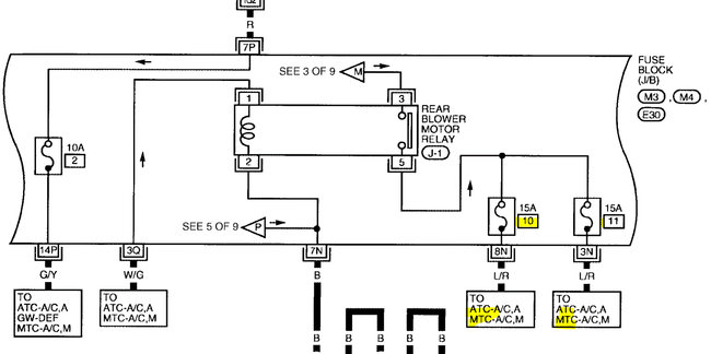

The four fuses have nothing to do with the radio. They are for the rear blower motor, daytime running lights, and the defogger. Just for curiosity, are any of them working? As far s the burning smell, can you tell approximately where it is coming from?
See the pics below.

The smell is coming from inside kind of where the shifter is. And as for the 4 fuses, one of them says it's for my "Starter Signal". Could that be the cause? It's been raining slot where I'm at so I haven't gotten a chance to look again plus my battery is dead. Will have to charge it.
May 18, 2021 at 12:45 PM
  • 110,244 POSTS
I will have to check my other manual for fuses. According to the one I reviewed, they aren't for the starter. but that doesn't mean it isn't wrong.

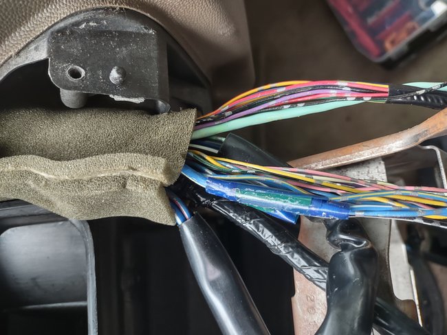

I have already done that test. And yes, my test light stays on brightly. But, when I started pulling out fuses one by one, my test light would not turn off. I probably checked all fuses at least 3 times and could not locate the draw. But I only checked fuses and not the relays.
May 18, 2021 at 4:46 PM
JERRY LEDESMA
  • 22 POSTS
And this isn't the first time my battery has gone dead, I've had to recharge it about three times already. If you look at the image I sent you of my fuse box lid you'll see that fuse number 9 says it's for my starter signal.
May 18, 2021 at 4:50 PM
JERRY LEDESMA
  • 22 POSTS
It seems like every wiring harness that has electrical tape on it has been messed with. wires cut, and put back together I'm afraid to keep going. What should I do? I'm starting to think I might have to have the car rewired which I hope that's not the case.
May 19, 2021 at 4:24 AM
  • 110,244 POSTS
I would not be honest if I said there is an easy fix. I'm not sure what all has been done. They may have wired in a remote start. The two things I would say could be done would either be to follow the wiring schematics and follow one wire at a time to confirm it's correct or replace the harness.

My absolute biggest concern is the smell you get of something melting or burning. One of the wires is likely shorted to ground and getting hot enough to melt the insulation. In all honesty, that shouldn't happen if the correct fuse size is installed. It should blow before the wiring getting that hot, but again, it's hard to tell what has been done.
