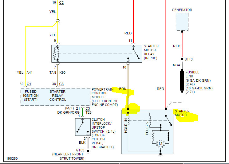

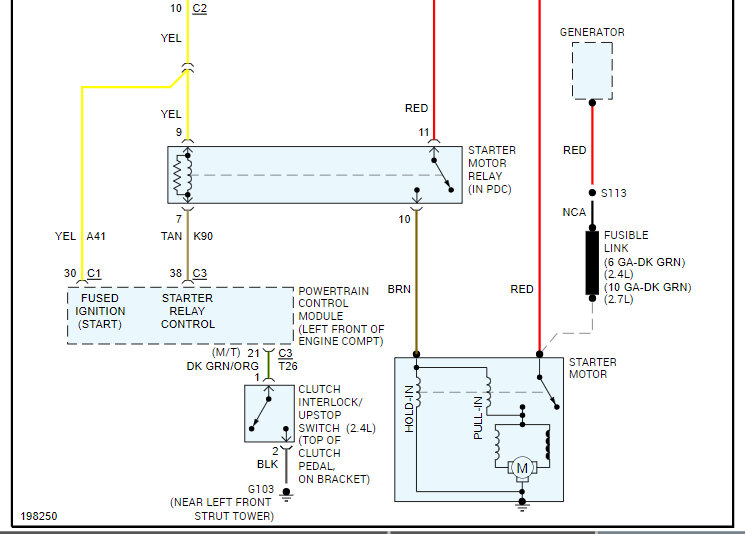

Before removing anything, we need to check a few things. This vehicle does have a sentry key transponder. If you change everything, it will need reprogrammed to work.
Don't take things apart until we confirm where the problem is coming from. Is everything still together? If it is, we need to start at the starter motor. At the starter, there will be a heavy gauge red wire directly from the battery that has power all the time. There will also be a smaller gauge wire brown in color. It will not have power until the key is in the start position. I need you to check if the brown wire is getting power when a helper turns the key to the start position.
I attached the starter circuit schematic below so that you would have a reference. Also, make sure the highlighted fuse is good and has power to and from it. Here is a link you may find helpful:
If the fuse is good, locate the starter relay in the power distribution center under the hood and switch it with a different one having the same part number. See if that makes a difference.
One other thing, shift the transmission to neutral to see if the starter engages.
Try these things and let me know the results.

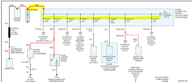

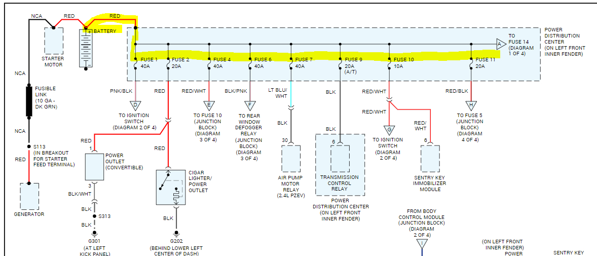

No problem. It sounds like you don't have any electrical components working. If that is the case, we need to check inside the fuse box to see if power is making it to the fuses. I attached the first set of fuses to get power. Using a test light, see if any have power.
See pic below.

If only a few fuses have power under the hood, it sounds like the power distribution center (PDC) is faulty. As far as the fuse box inside the vehicle is concerned, it receives power from the PDC.
Are the fuses I sent a picture of all without power? Keep in mind, the BCM (body control module) isn't responsible for power in the PDC. That comes right from the battery.

we do have power to the starter from the battery; to check the little wire do I need a relay in the starter relay position, in the PCM? Prior relays have been tripping. Ken, just to let you know this car has been sitting for a while. I managed to start it and turn it off, started again, drove it down the street and back, and it hasn't started since.

So, the engine is not cranking over, you must check for power at the small wire when in the crank position is sounds like the starter is bad. Please go over this video:
https://youtu.be/6YRW8fyNudY?si=NIHDaS_KxU3FwyhQ
Please go over this guide and get back to us.
