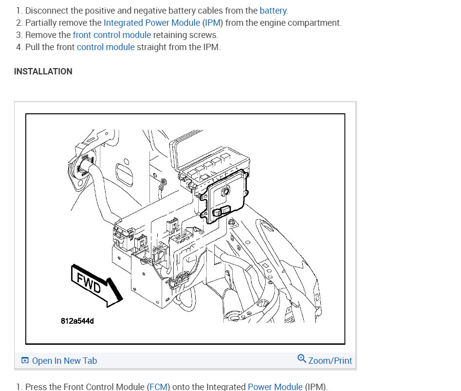

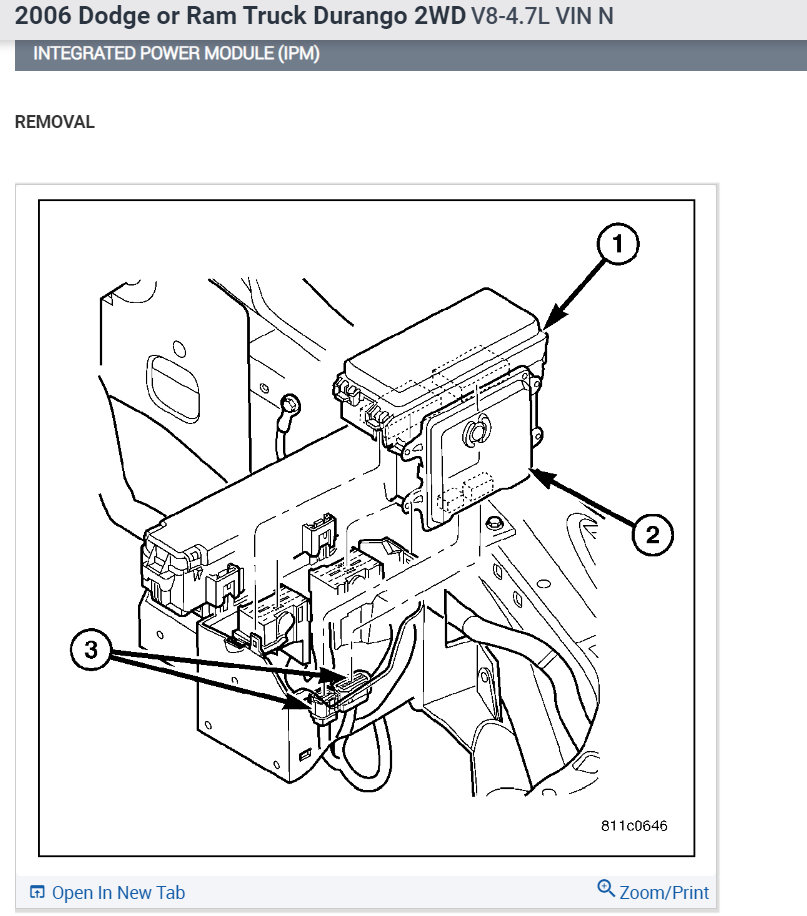

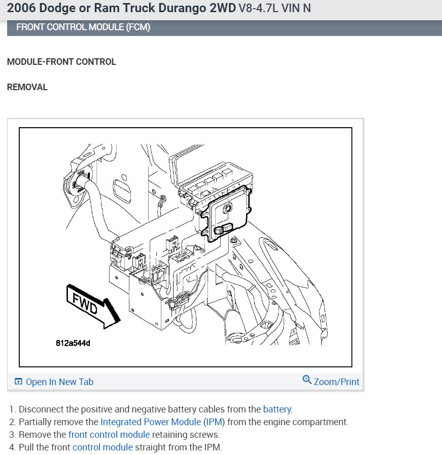

It sounds like the IPM is out, but to be sure we need to run a CAN scan which is easy to do. Check out this guide to help you see how to perform the scan. The scanner is about $45.00, and it does the entire car.
Here is how to change out the IPM unit which is easy as well because it-self learns. Check out the images (below). Let us know what happens and please upload pictures or videos of the problem.
