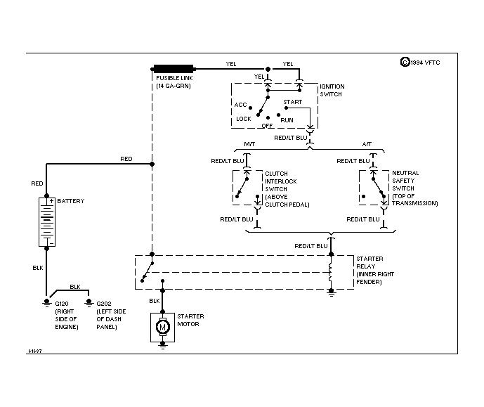

The truck listed above is a project truck (XLT model) I purchased a year ago. I have been doing major repairs on it. Finally got it running, took it to DMV, failed because they were unable to read the computer on the truck. It was stationary for a long time without a battery installed.
The following steps I have taken to get it to crank:
1- Battery is only a year old, I took it to AutoZone to have it charged up, now 13+ volts.
2- Replaced the negative and positive battery wires. No corrosion at all.
3- Replaced the starter with a new re-manufactured starter from AutoZone.
4- Replaced the starter solenoid on the fender next to the battery with a NAPA new.
5- Checked continuity for the starter to the solenoid to the battery, everything checks out okay.
6- Checked all the relay inside in the fuse box and in the engine compartment power distribution. Replaced some relays unrelated to the engine not starting. Also cleaned all corrosion from all the relay leads.
Still no change, truck will not crank. I need a checklist to troubleshoot further.

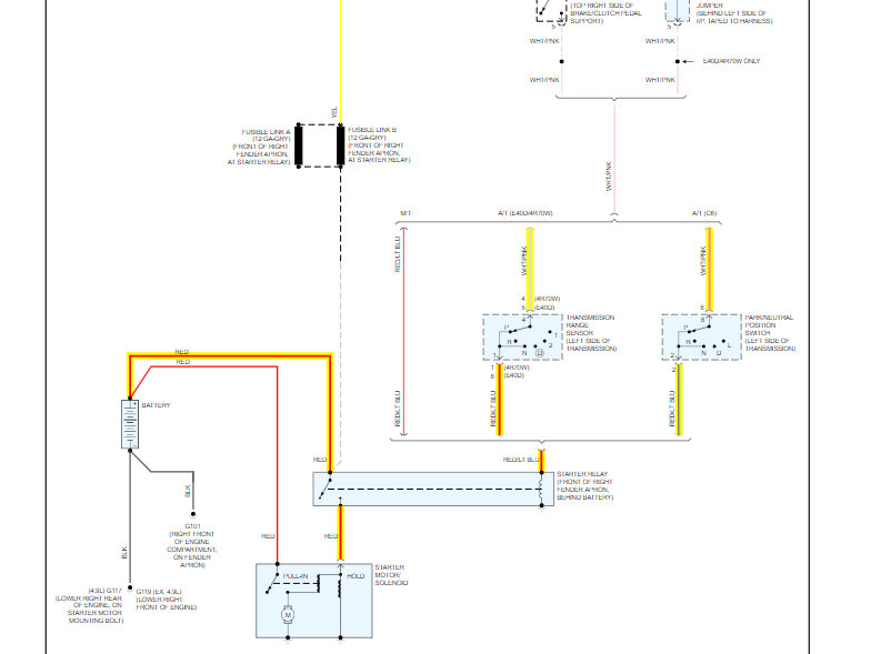

Good morning,
These guides can help us fix it
and

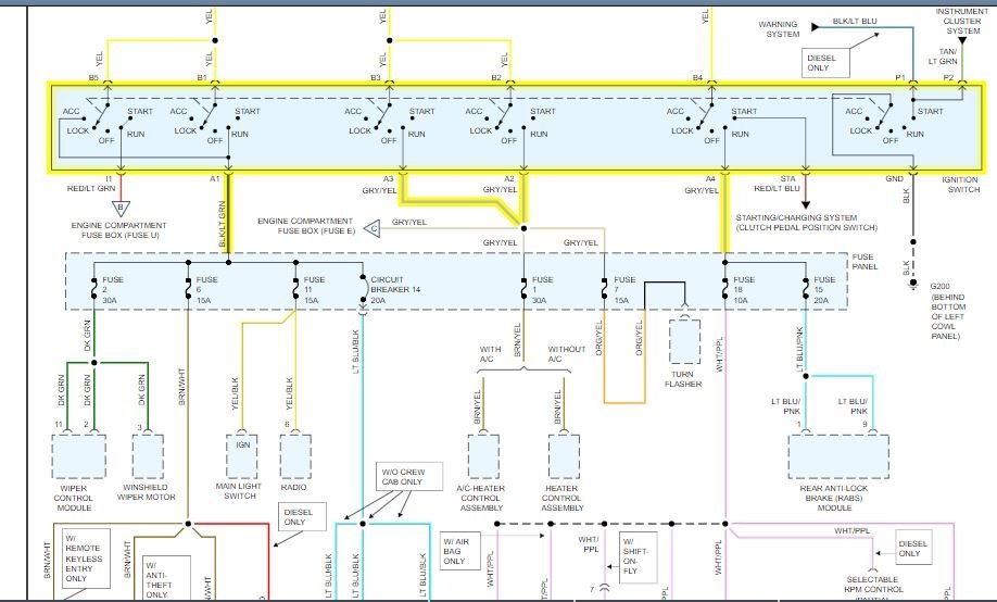

As far as starting, did you verify power to the starter solenoid in the start position?
Check out the diagrams (Below). Please let us know what you find. We are interested to see what it is.

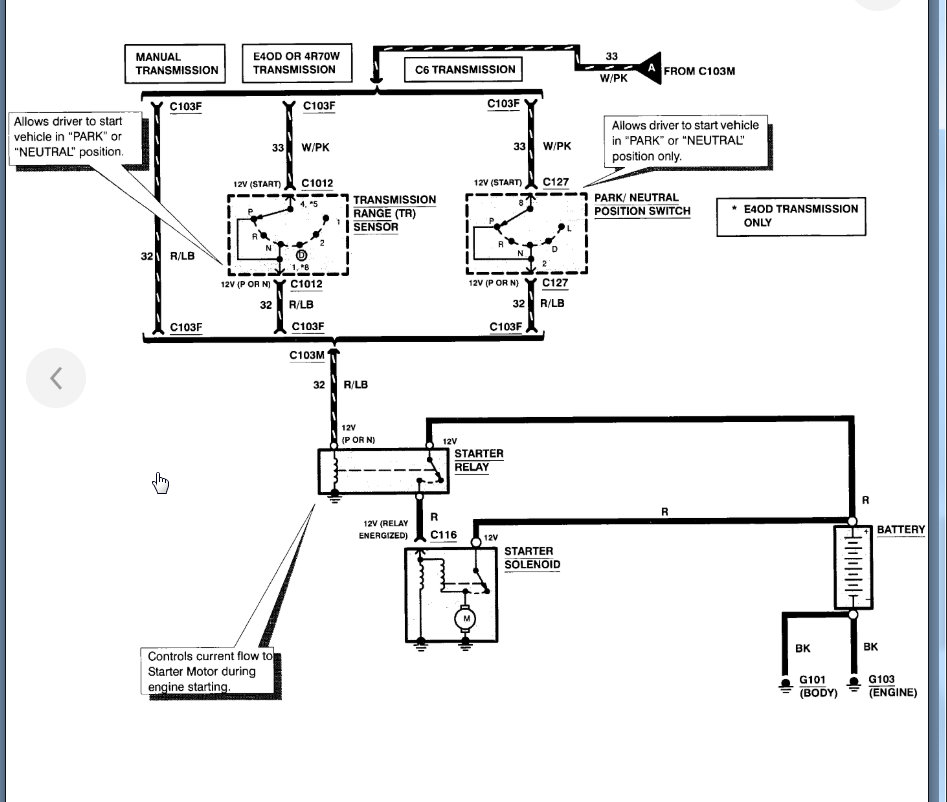

Okay. The solenoid, on the starter, on the two large post, has the same voltage as the battery: 12.98v
The small solenoid post and the large negative post has 0.0v initially and 2v when I turn the key to run. It goes up to 2.6v if i hold the key in the run position. If I hold the key on the run position for more than a few seconds the battery wires get very hot.
I un-screwed the starter from the transmission and turned the key: same results.
Jun 30, 2019 at 4:54 AM

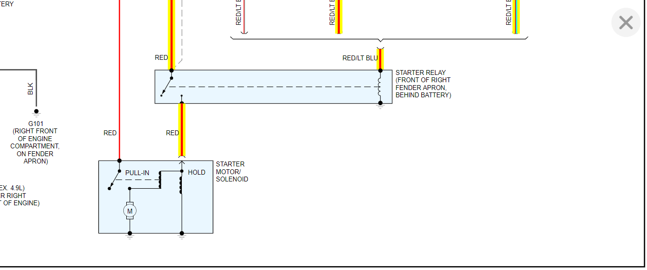

You need 12 volt there. That comes from the relay.
Jun 30, 2019 at 5:25 AM
WHITESHIRTSAMMY
  • 60 POSTS
If i put the test leads on the two large post, on the starter relay, I get the battery voltage: 12.98v. The relay post that has the cable directly from the battery gives me the 12v, the relay post that has the cable going to the starter solenoid has 0.0v initially and gives me 5v when I turn the key to the run position.
Jun 30, 2019 at 5:53 AM
On the starter relay, you need battery voltage to the relay.
One of the terminals should have around 12 volts in the start position only. That will energize the solenoid and send power to the starter solenoid.
Jun 30, 2019 at 6:30 AM
WHITESHIRTSAMMY
  • 60 POSTS
if I remove, from the starter relay and got a new unit, that fixed it thank you so much this site rock!

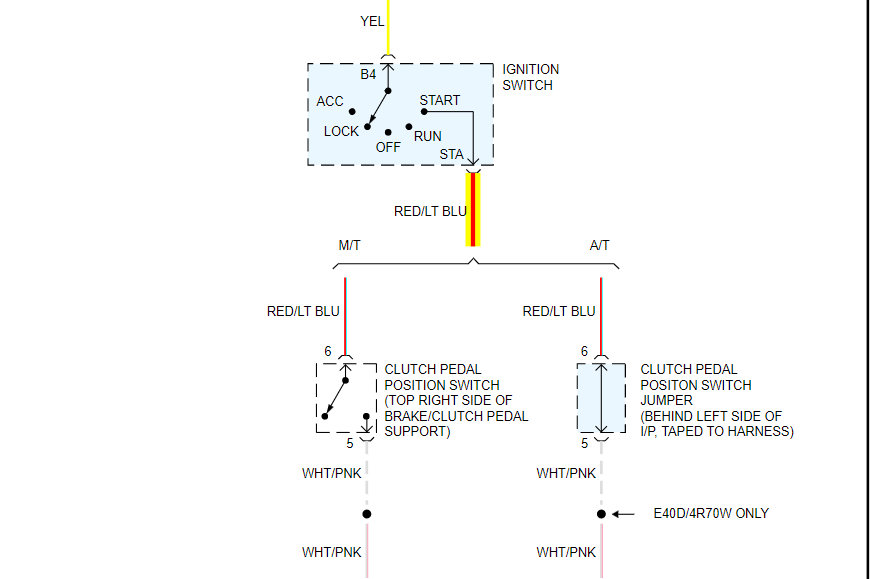

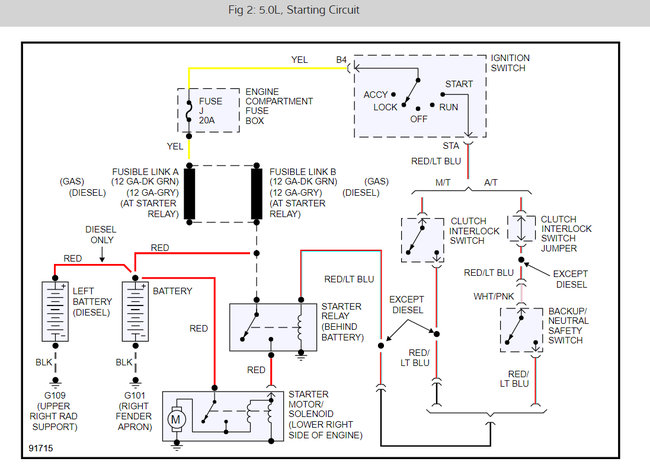

Do you have 12 volts on the B+ wire (red)? You should have 12 volts all the time on this wire.
If you do and you do not have 12 volts when cranking on the control wire then the first thing we need to suspect is the clutch pedal position switch. Basically this prevents power to the starter if the clutch is not pressed in. This switch is not adjustable and requires replacement if faulty. So I would test for voltage on both sides of the switch and you should have power coming in and then when the pedal is depressed, there should be voltage coming out.
If not, your switch is faulty. I attached the wiring diagram. Let me know what you find or if you have questions. Thanks.

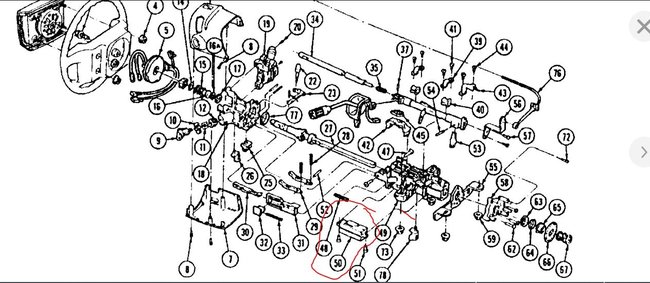

Had to replace shift tube in steering column, now truck will not turn over ? Any help would be awesome!
May 31, 2021 at 4:15 AM (Merged)
Good morning,
Did you verify the connections for the ignition switch?
Check the output at the switch with the key on. I highlighted the wires you need to test.
These guides can help us fix it as well.
and
Check out the diagrams (Below). Let us know what happens and please upload pictures or videos of the problem.
PSELL
it was the starter relay all fixed thank you.

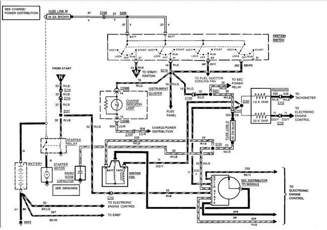

I'm having two problems.
1. No click when starting and no crank.
2. No gas pressure in fuel rail.
Truck has a new battery, new starter solenoid/ relay and ignition switch.
Relay on fuel pump and EEC work.fuses all checked.
The truck will crank (I have spark used a spark tester) if I by pass the solenoid. Wont start due to fuel pressure. I checked pump when cranking I can hear relays activate but don't hear pumps prime.If I place my hand on the pump I hear a thump when cranked.

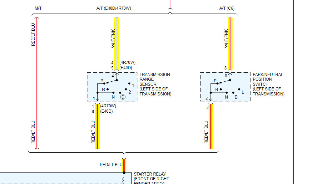

I checked the power to neutral safety switch only got one wire with power.Does that mean maybe I don't have power at the brake switch? lack of power to S wire on ? are these connected?
So I believe pumps bad.
(if I use a 12 volt battery could I bypass wires to confirm pumps inoperable? if so would I clip negative to negative on pump and positive to positive?)
I realized I don't have power going to the signal wire going to starter solenoid (located on fender wall) the S wire.
I have power to ignition switch STA / wire red/blue
I have power at fuel pump and EEC.
I have 12 volts going in and out on inertia switch but drops to 6 volts is that right?
i checked power at EEC module and i don't have power at the blue/red wire (32) at the relay. what am I missing or doing wrong?
figured I have power at ignition switch when in on, run a d start, power at fuses and relays.. then power goes to inertia switch right? from there power should go fuel pump?
or does it check with neutral safety switch? brake switch used? this is where I get lost..
so figured no fuel due to pump. I checked connector to fuel pump and got 12 volts.
so why no click when starting?

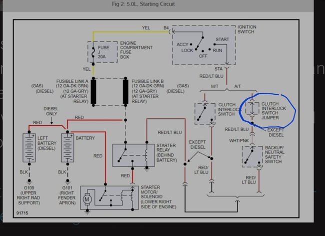

Hi Ken, I went ahead and check out the link you posted most of that stuff I've checked still need help when it says to test the trigger wire...mine would be the S wire on the starter relay (fender wall) correct??
Seems that the S wire that triggers my Starter relay that's found on my Fender wall is not getting power.... I get no clicks but everything turns on.
my battery is at 12.4.
new starter relay (fender wall)
new ignition switch
new neutral safety switch
If I cross the switch on the starter relay (fender wall)it does engage my starter and it starts right up.
I did notice a screw holding up the starter relay was missing...I'm going to put it on tomorrow figured could be not grounding ???
(wasn't sure if that could cause a no crank issue)
help....I just replaced the neutral safety switch because my last one was definitely bad. but still no luck.
May 31, 2021 at 4:16 AM (Merged)
  • 55,732 POSTS
Yes, the solenoid needs to be grounded. Here is a guide to help us check for power and the starter wiring diagrams so you can see how it works and what to check for power. I would check the fusible links.

is the interlock switch considered my my starter relay mounted on fender wall?
or is that only for manual transmission?
IVAN AZCUE
  • 25 POSTS

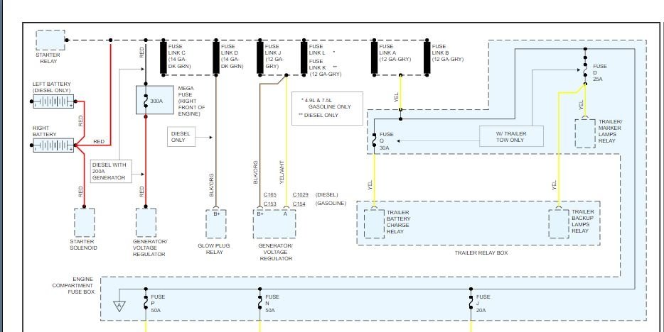

sorry just saw the starter relay is hooked up to the fusible links. still curious about Interlock switch.
  • 55,732 POSTS
That is a connector does nothing expect connect the circuit. Test for power to see where you lose it.

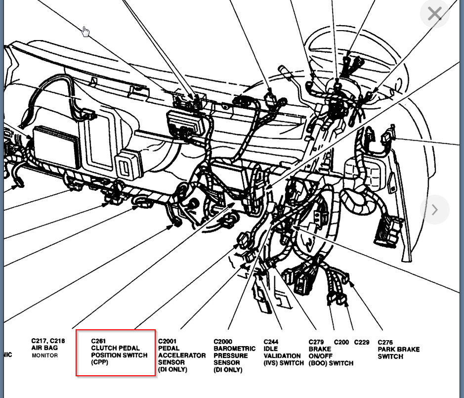

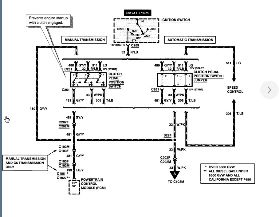

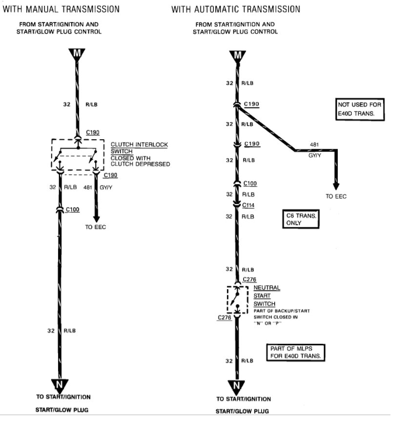

Truck turns over but will not start unless I push it and pop the clutch. Then it runs fine. I have changed all ignition parts, starter and ignition relay. I am completely out of ideas as to what could cause this condition. It has spark and fuel.
  • 55,732 POSTS
It sounds like you have a clutch safety switch that is out. It is located at the top of the pedal see if you can locate it and then jump it and see if the engine cranks over.

LUGNUT8
It was the clutch switch thank you.

here is the starter wiring so you can see how the system works. Check out the diagrams (Below). Please let us know what happens.
