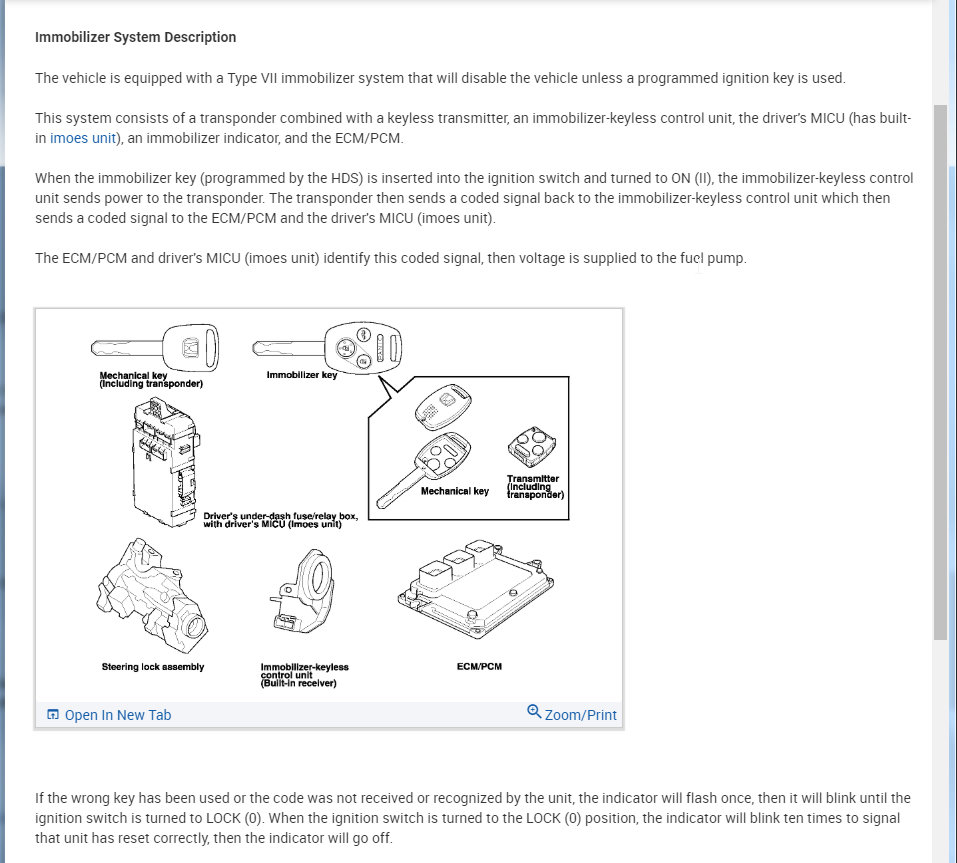

replaced fuel pump and all 4 injectors, car wont start.
Apr 22, 2020 at 11:16 AM
Sounds like you have an active anti theft issue. When the vehicle thinks it is being stolen or doesn't recognize the key that you are using it does not energize the fuel pump. Does the theft light stay on when you put the key in the ignition?
