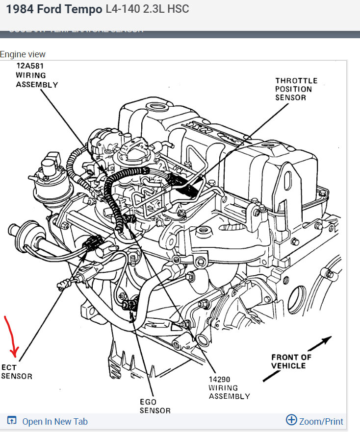

If the car sits for 7 hours it has to have help via a small shot of brake clean in the intake to get it fired off, until it reaches operating temperature there is a noticeable power reduction while driving. Once the temperature hits that goes away and it runs fine. Once warmed up restarts are no issue, only after a 7-hour cool does the problem resurface. I noticed that when I run my cold start procedure every morning I let the car idle until it reaches temperature, I know when it reaches temperature not by the temperature gauge, but by a 2 second long array of misfire that almost stalls the engine, then it catches up , clears up instantly and no problems again until a 7 hour cool. Any ideas?

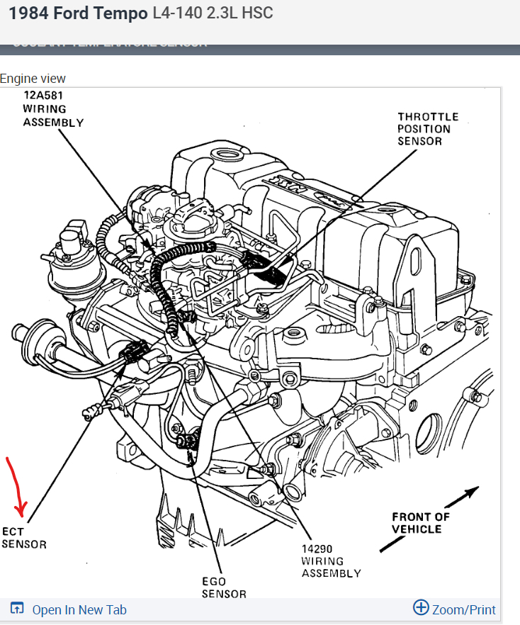

Yes, I would swap out the engine coolant temperature sensor which can cause these issues. Here is the location of the sensor, also we should run the codes to see if any are stored.
https://www.2carpros.com/articles/ford-lincoln-mercury-obd1-1995-and-earlier-diagnostic-trouble-code-definition-and-retrieval
Also, I would change out the fuel filter if it has not been done. Check out the images (below). Please upload pictures or videos in your response of any problems so we can see what to help you with.

Literally minutes after I hit the send button on that message I went out to my car and ran down 2 vacuum leaks and repaired them. The car started up this morning under its own power. Then I found 2 more vacuum leaks just a while ago.

May i ask why you would think a coolant temperature sensor would cause a motor not to fire off only when cold? I'm just trying to educate myself here.
Oct 3, 2024 at 4:09 AM
  • 55,433 POSTS
Because when the engine is cold it needs more fuel to run correctly, if the engine temperature sensor is stuck on hot all the time it will lean the engine out making it hard to start. You might want to unplug the sensor to see if anything changes.
