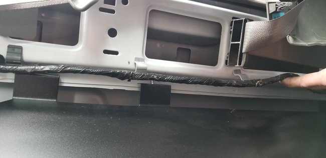

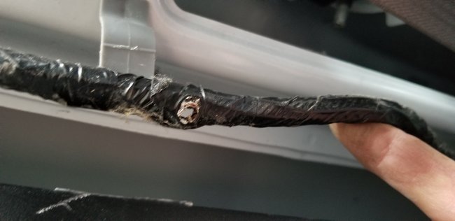

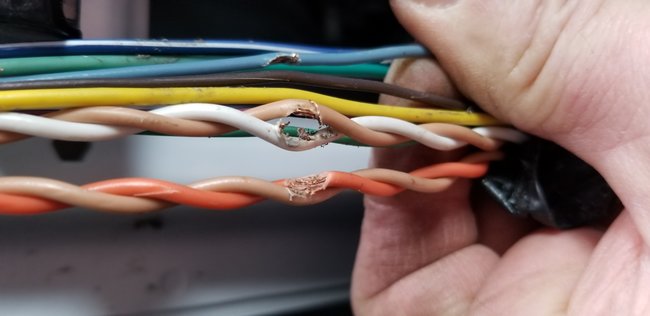

BTW, the damage was caused by the people who installed my partition two years and three months ago! I'll be having a chat with them!
Feb 24, 2019 at 4:30 AM
That's poor workmanship.
Feb 24, 2019 at 4:32 AM
DEACON DAN
  • 29 POSTS
Yes it is! Surprised it took that long for issues to surface.

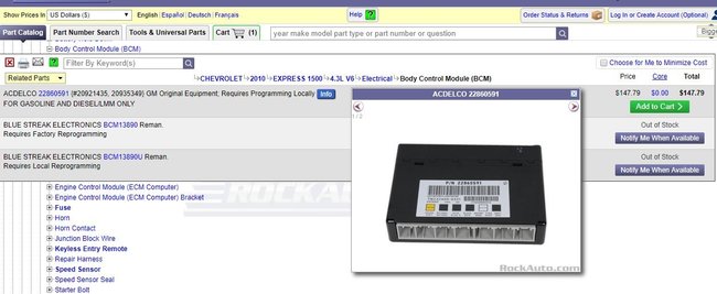

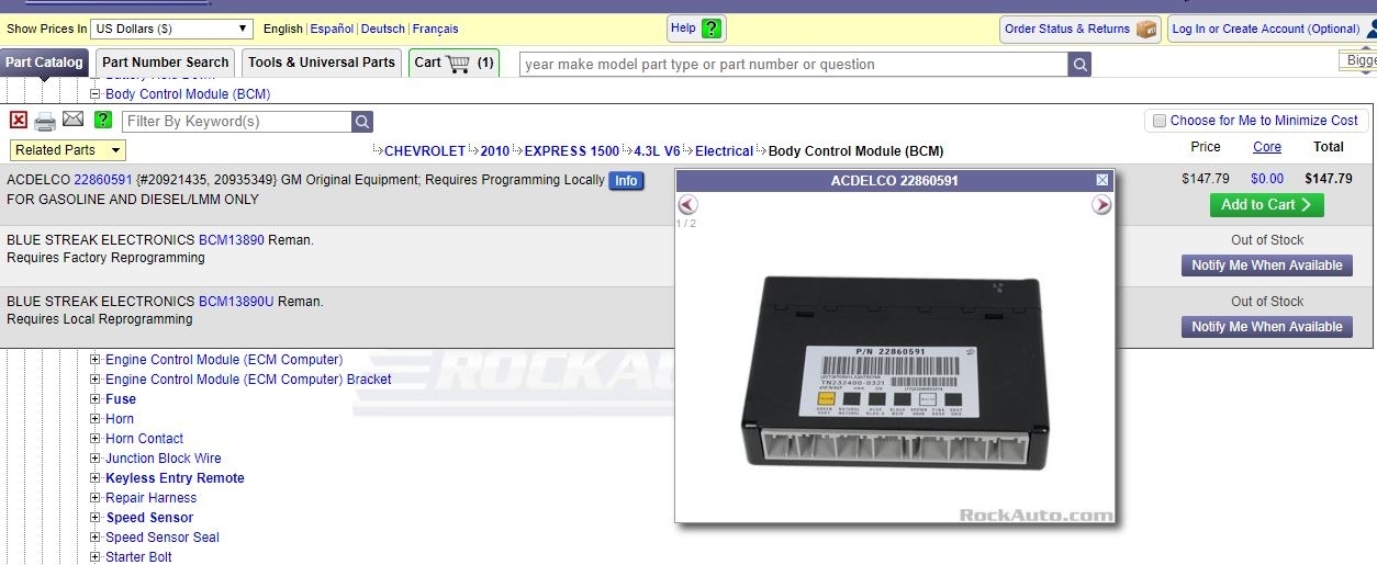

Hi again Roy. After looking at the legend of the fuse block, I noticed that there were more fuses labeled BCM. Sure enough, #9 BCM 4 was blown! Problem solved finally! Why it wasn't on the diagram is beyond me! Dan
