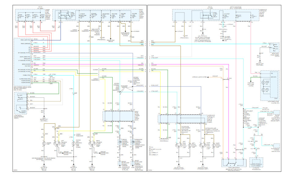

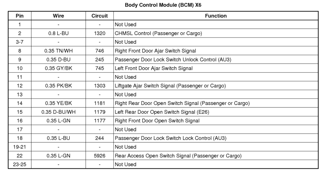

Hey Roy, can you send me a picture of the diagram in PDF format? It's hard to view when enlarged.
Feb 21, 2019 at 11:58 PM
Try this one.
Feb 22, 2019 at 12:03 AM

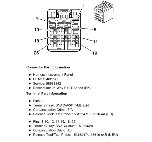

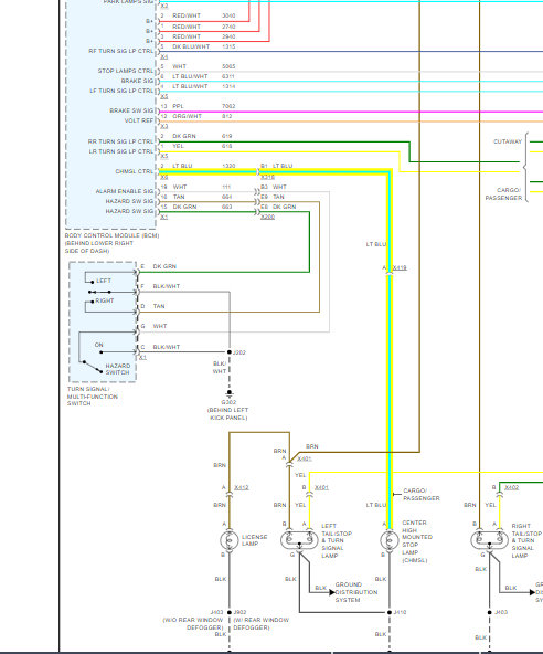

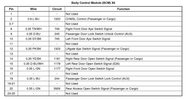

Hey Roy, can you tell me which color modular plug this wire is in? There are 7.
Feb 22, 2019 at 4:54 AM
It is marked as X6 pin2. It is a light blue wire.
Feb 22, 2019 at 5:11 AM
DEACON DAN
  • 29 POSTS
I do see some numbers on the plugs, but no x designations. I thought I could figure it out by process of elimination, but I don't see a light blue wire in any position 2.
Feb 22, 2019 at 5:18 AM
The pin arrangements are the same on all the connectors. There needs to be a light blue wire on one of them.
Feb 22, 2019 at 5:30 AM

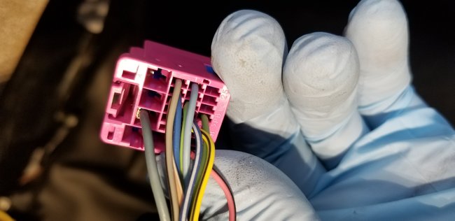

DEACON DAN
  • 29 POSTS
Based on the picture you sent me, I believe I found x6, but pin 2 looks gray...
Feb 22, 2019 at 5:40 AM
DEACON DAN
  • 29 POSTS
The wire at the light is light blue....?
Feb 22, 2019 at 5:41 AM

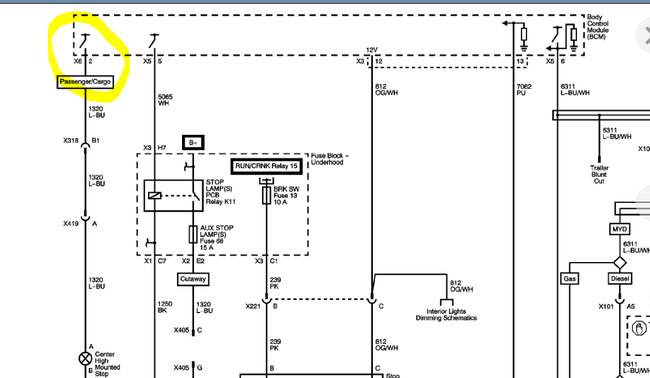

I see a light blue wire. Use an ohmeter to see if is the wire to the third light socket.
Feb 22, 2019 at 5:50 AM
DEACON DAN
  • 29 POSTS
There is a light blue wire on that plug, but it's definitely not position 2. And it has power now I just checked. Brake is not pressed.
Feb 22, 2019 at 5:52 AM
That is not it.
X1 has a light blue wire close to that one.
X1, X4 and X6 have light blue wires.
Feb 22, 2019 at 5:57 AM
DEACON DAN
  • 29 POSTS
What do you mean by "close to that one"? I do see other light blue wires, but not in position 2...
Feb 22, 2019 at 6:02 AM
I don't have a diagram of the connectors for markings of the X. You will need to do an ohm check from the third light to the light blue wire. You may have to check the ones on the connectors that have light blue wires.

Hi again. So, I was wrong, that wire was actually just a little different shade of blue. The diagram is accurate. I found a damaged wire and repaired it. Now with everything back together, I still have no power at that terminal number 2 leaving the BCM.
Feb 24, 2019 at 3:38 AM
Okay, if you found the wire from the BCM to the third light and repaired it and there is no power when the brake is applied, then the BCM is the issue.

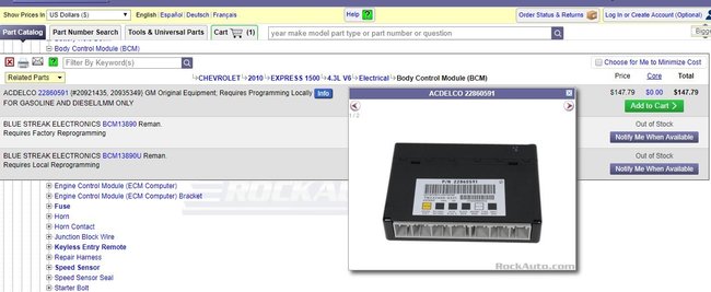

You need to replace the BCM and have it programmed to your truck. This is a module that must be programmed.
Feb 24, 2019 at 3:53 AM
DEACON DAN
  • 29 POSTS
Sounds expensive! I'll look into it. Thanks, Dan
Feb 24, 2019 at 3:54 AM
Found the part at rock auto.
Feb 24, 2019 at 3:55 AM
DEACON DAN
  • 29 POSTS
Thanks, but it's a 2500. Who does the programming? Dealership?
Feb 24, 2019 at 4:02 AM
Any shop with a Tech 2 scan tool. It can be any private shop and they will be much cheaper.
A dealer will be more than double a private shop.
